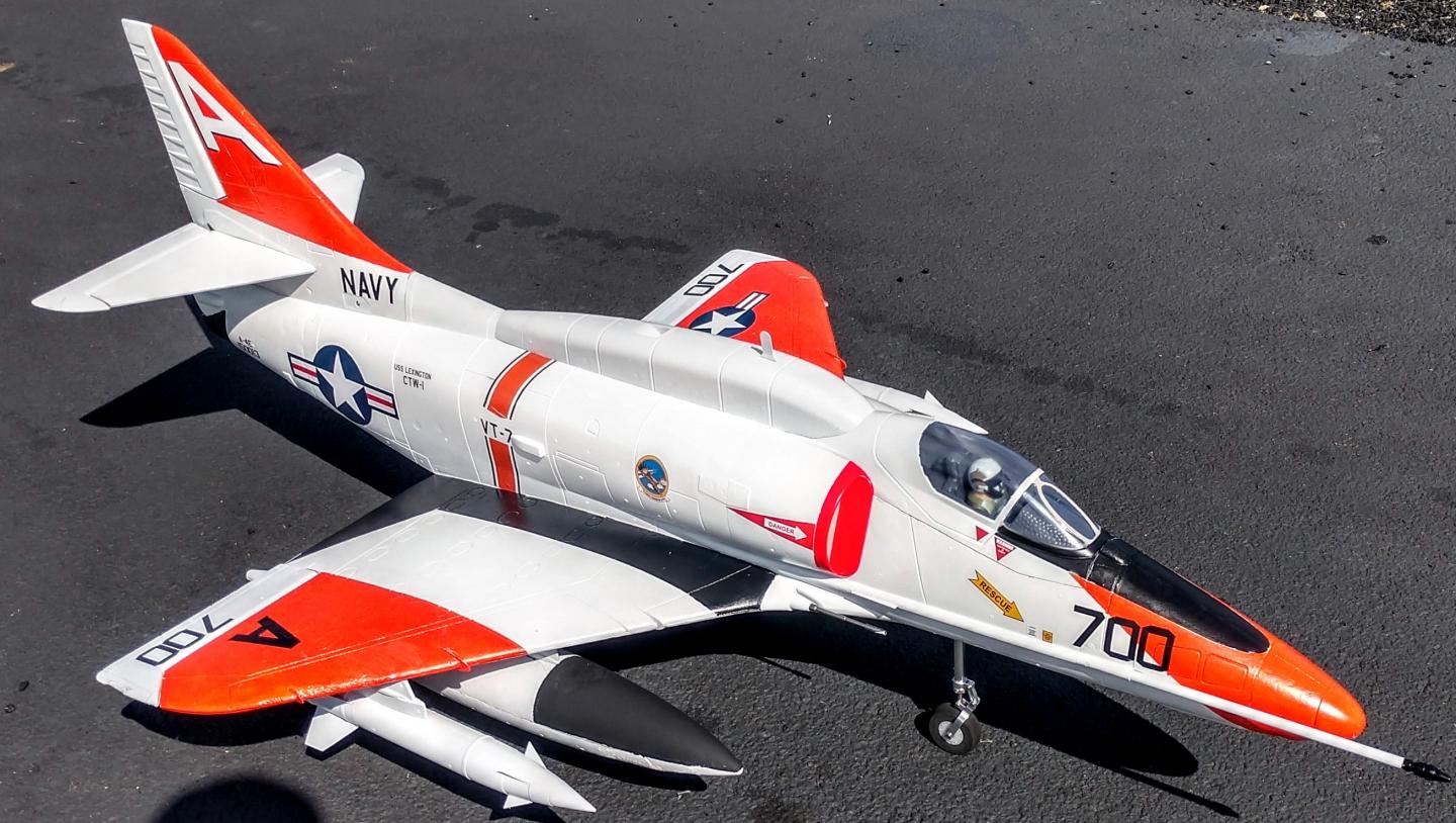

      Originally posted by Hardway
      Getting ready for a few flights after the weather clears a bit...
      Fantastic job on the livery Hardway. Greetings from New Zealand !!

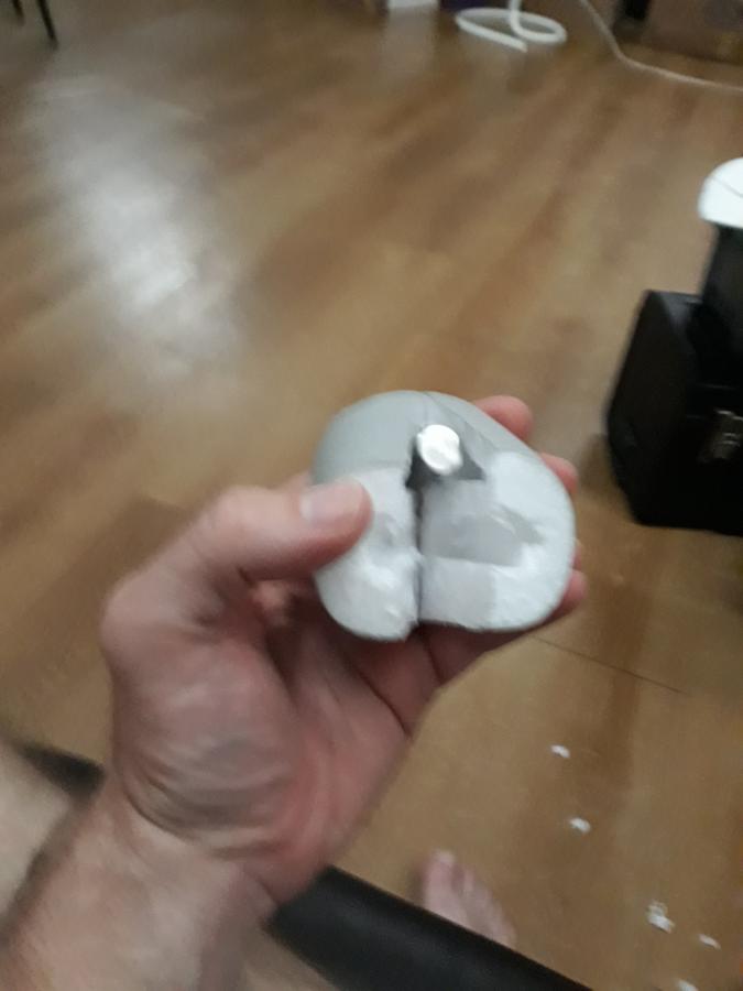

                          Anybody remove the nose weight? I don't have time to read through the 116 pages, so thought I'd ask...

                              Originally posted by CVA59
                              I have not.
                              I just did obviously, I've heard this birds power system described as being efficient, but my experience has been the opposite. So looking forward to hooking up two 4200mah 6s in parallel to get some decent flight times on her.
