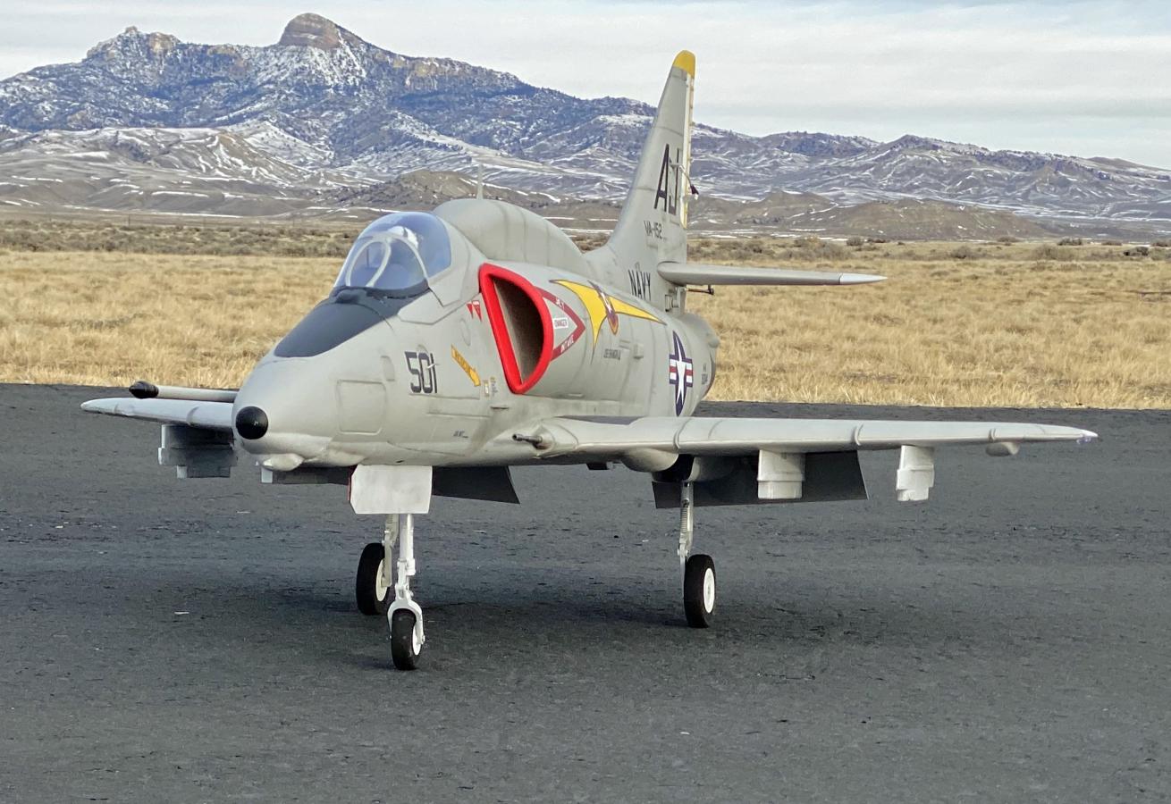

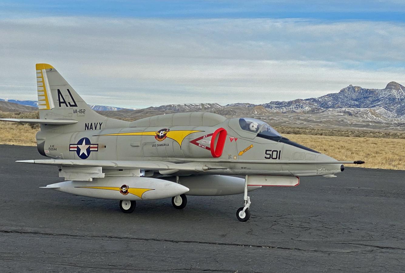

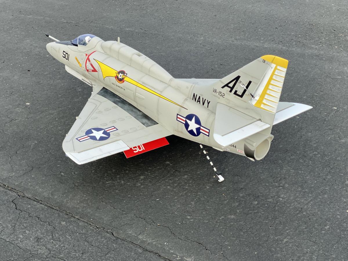

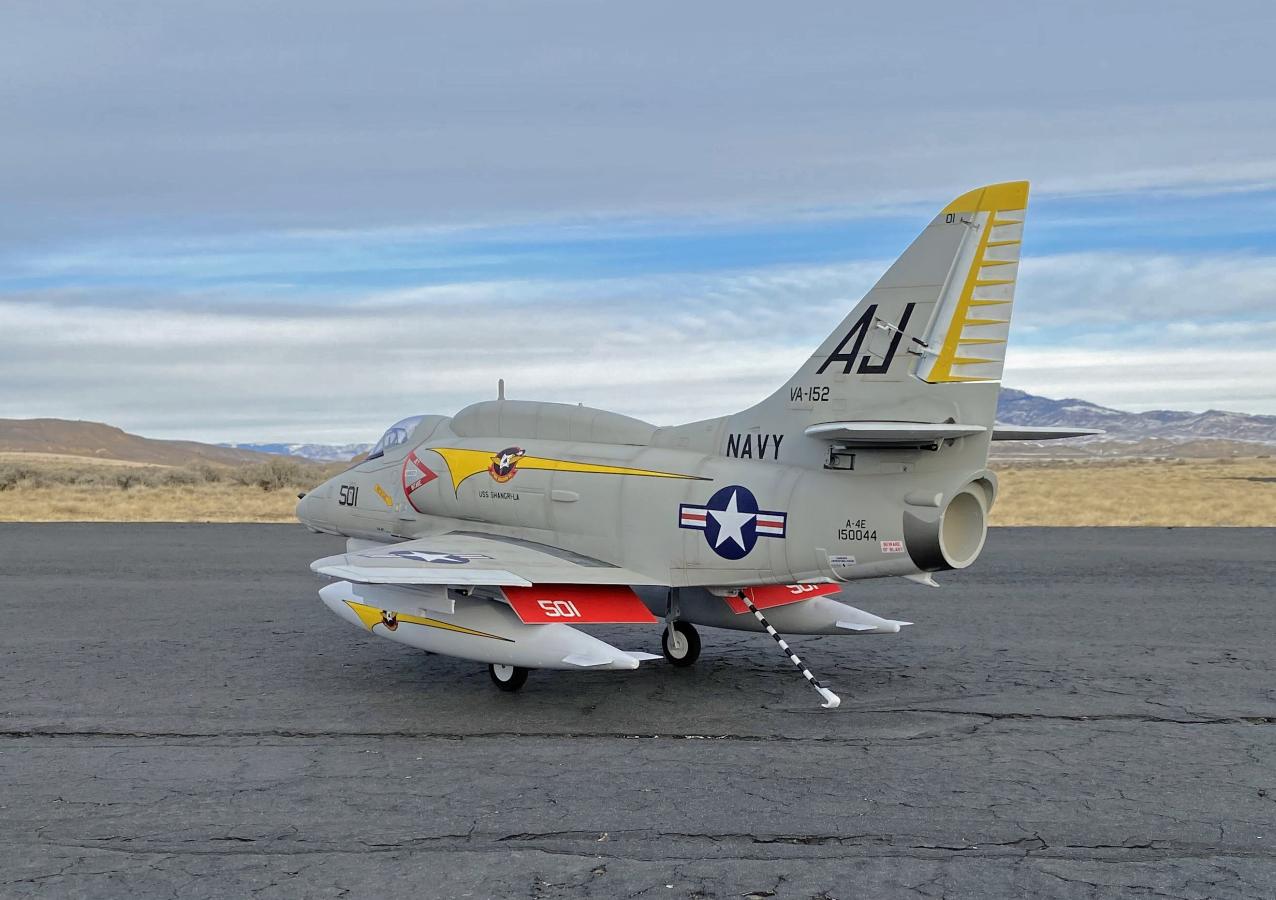

              Through a combination of high winds and now snow, my flight operations have ground to a halt for the time being. I still have a E Flite Timber on floats that works well on the snow, so that's probably a good near-term plan.
              During this down time, I have pretty much completed the extras and markings (Callie) for my A-4. I replaced the pilot with one from Chris Wolfe's RC Geek company, added some details like cockpit painting, and scratchbuilt ejection handle and gunsight. I also used his (Chris') example to make a functioning retractable nose gear door, which seems to work ok. Added a few exterior lights, as well. I have a three position tail hook that I might eventually try some "trap" tests as some others on Hobby Squawk have already successfully demonstrated, we'll see.
              I also added thin plastic sheeting on the inside of the flaps, which made them more scale, and also easier to put the aircraft numbers on them. I may to a few more things as time goes by, but this was just a fun challenge of doing a little detailing on a bird I intend to fly a lot. Only two flights on it so far, but it seems to be pretty much trimmed out now.
              Davegee
              Click image for larger version Name:	IMG-0803.jpg Views:	0 Size:	94.4 KB ID:	331727Click image for larger version Name:	IMG-0804.jpg Views:	0 Size:	99.2 KB ID:	331728Click image for larger version Name:	IMG-0807.jpg Views:	0 Size:	116.1 KB ID:	331729Click image for larger version Name:	IMG-0802.jpg Views:	0 Size:	107.5 KB ID:	331730Click image for larger version Name:	IMG-0809.jpg Views:	0 Size:	68.0 KB ID:	331731Click image for larger version Name:	IMG-0806.jpg Views:	0 Size:	148.4 KB ID:	331734Click image for larger version Name:	IMG-0805.jpg Views:	0 Size:	177.7 KB ID:	331732
              Finally got out to the field, as the winds died down and the snow melted off for me to try another test hop with my new A-4E. Looks much better with all the markings on it now. I first flew my reliable ol' T-Bird T-33 as a warmup for the A-4 or F-4 when I haven't flown for a while. That one went beautifully, then I flew the Skyhawk (this flight still without the drop tanks) and it went pretty well. Tail hook deploys and retracts just fine, the scratchbuilt retractable nose gear door (inspired by RC Geek Chris Wolfe) seemed to work ok, and it tracks better as I get more used to flying it. Landing could have been a bit better, nose wheel went off the side of the runway on the rollout a bit and the nosecone fell off, scratching it somewhat, but repairable.
              Took some photos, postflight, with and without the drop tanks.
              Davegee
