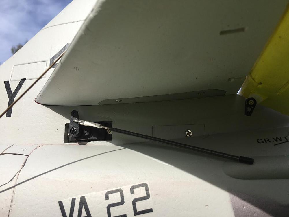

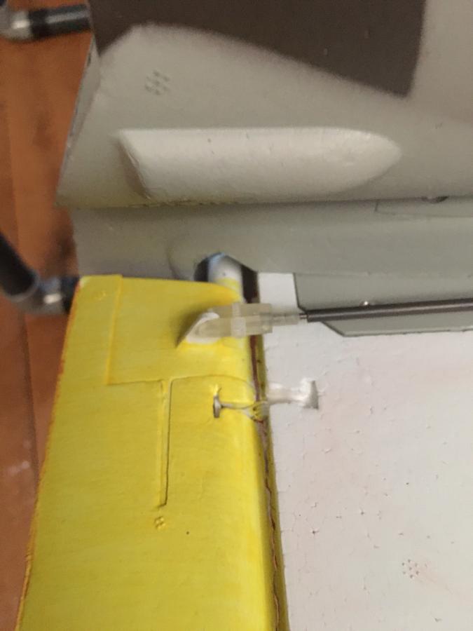

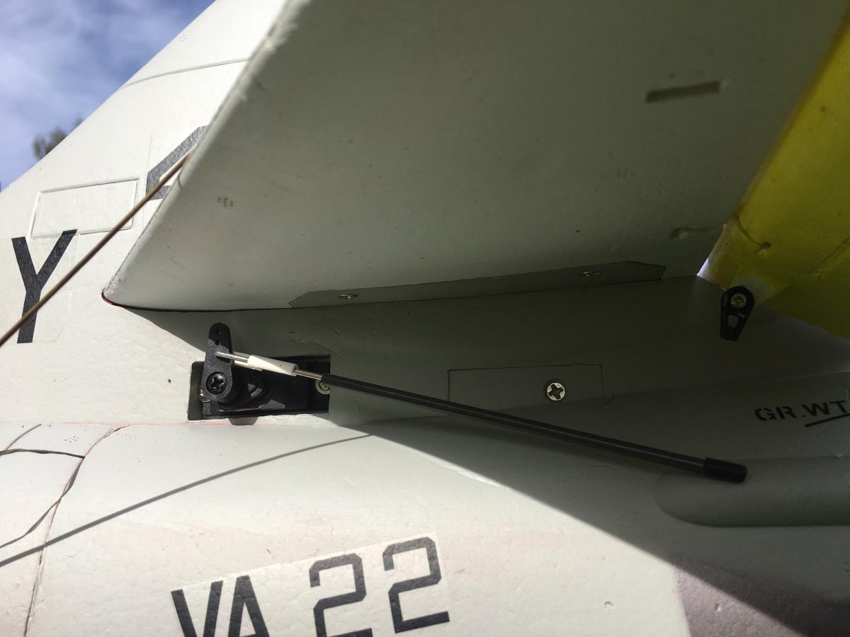

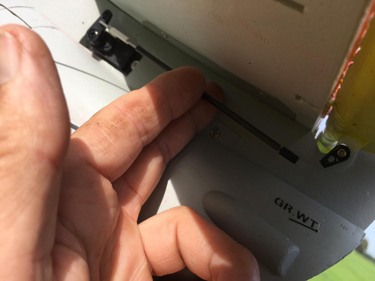

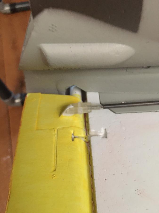

          • Crashed my Skyhawk A4
            Today during my second flight of the day my Skyhawk A4 went out of control after a looping.
            Just went into the bush, bad sound going in🤬
            At crash site it was in one piece, checking everything and found that elevator was loose.....👿
            I bought it second hand and this was my 3 flight with it performing rolls loops.
            Easy repair but see pictures of crash reason.
            Grts Hans

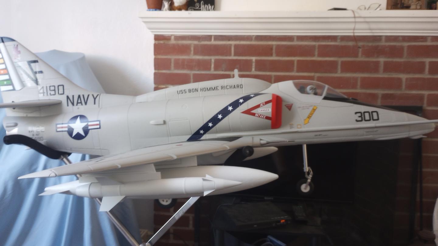

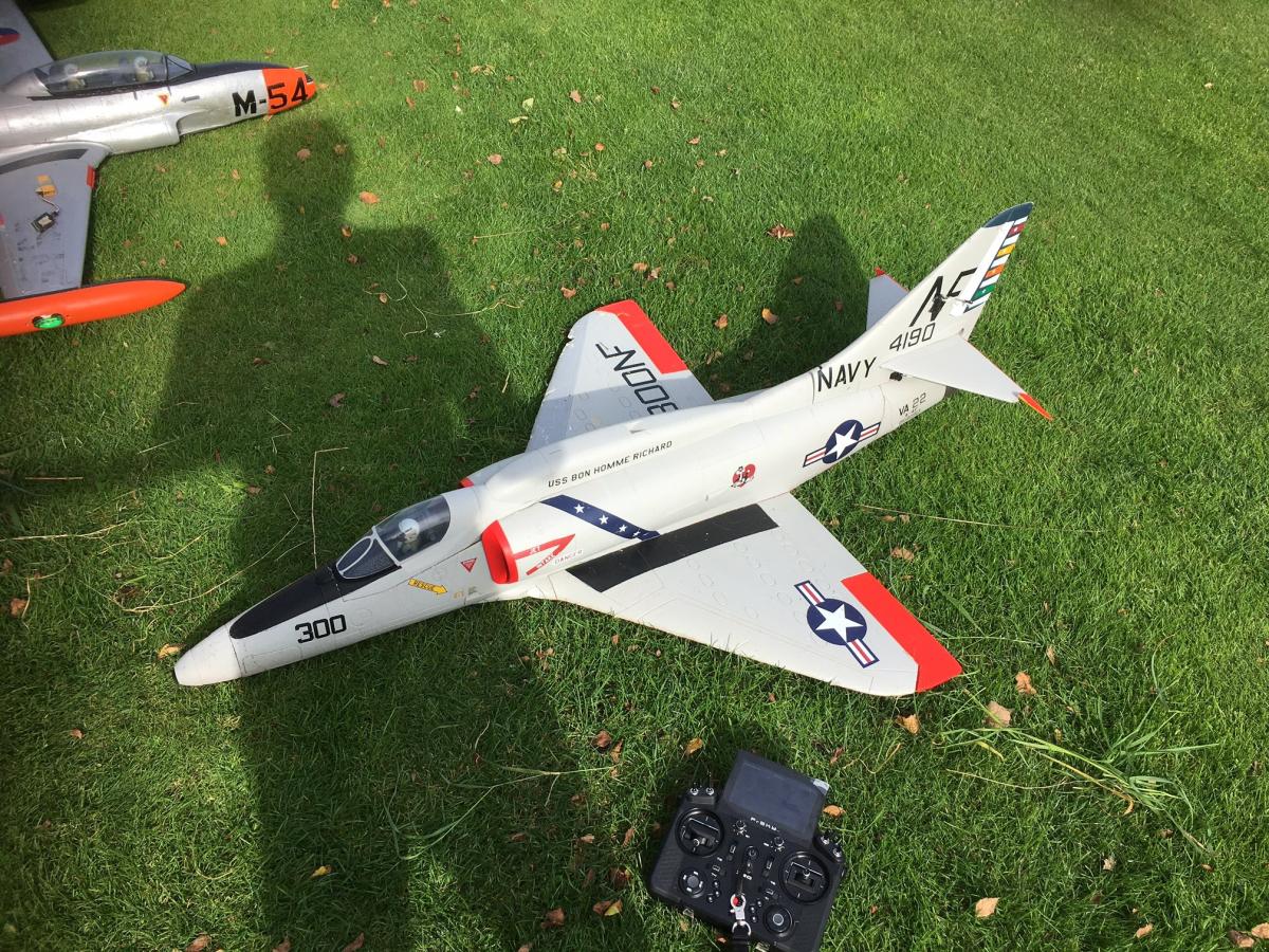

            • Just picked up an A-4 from a friend at our field. Click image for larger version
ID:	389141 Click image for larger version
ID:	389142 It was the Older version with the out-runner EDF. Waiting on Callie Graphics to complete. So far have ungraded the EDF to the 80mm 2150Kv in-runner with a Freewing afterburner. Also upgraded front nose gear with an Avanti nose shaft, 5.1 Retract servo (stock was 4.1) New nose gear steering arm (part#N527) freewing light controller, with a nose light from an F-15. Will be upgrading elevator servo with a Hitec HS5085 as soon as I get it from Motion. Then of course she will be coated with Matte Min Wax Poly to protect her.
              Hope the weather holds up here on Cape Cod to maiden when she is completed.

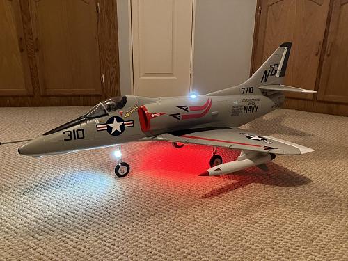

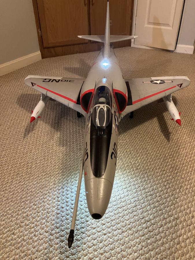

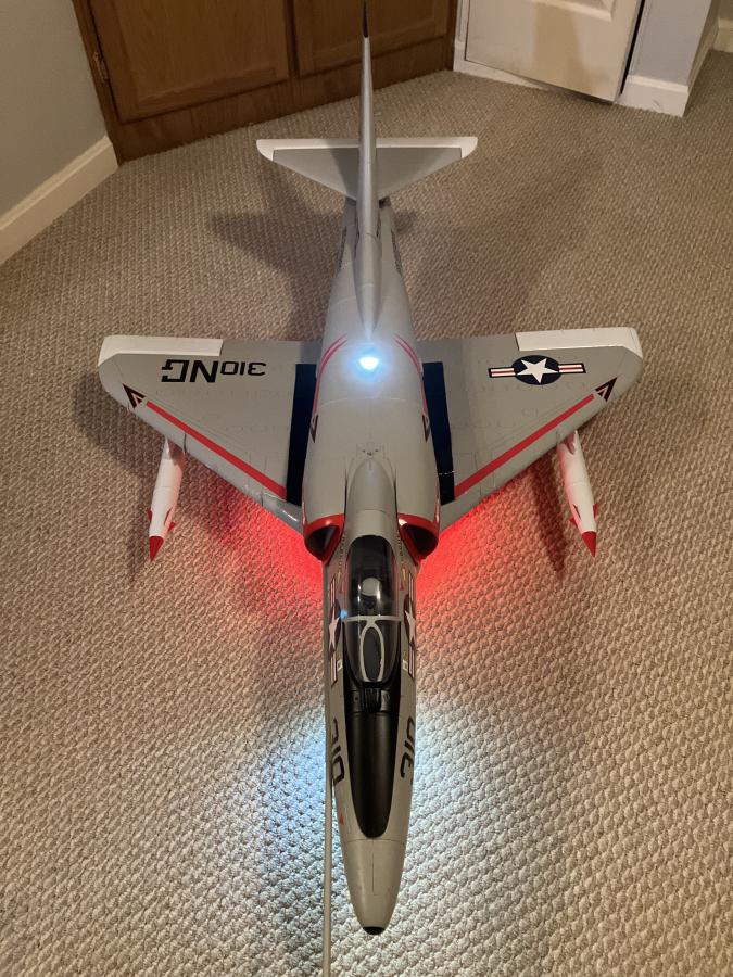

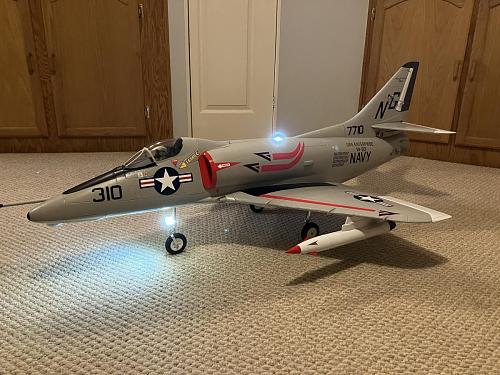

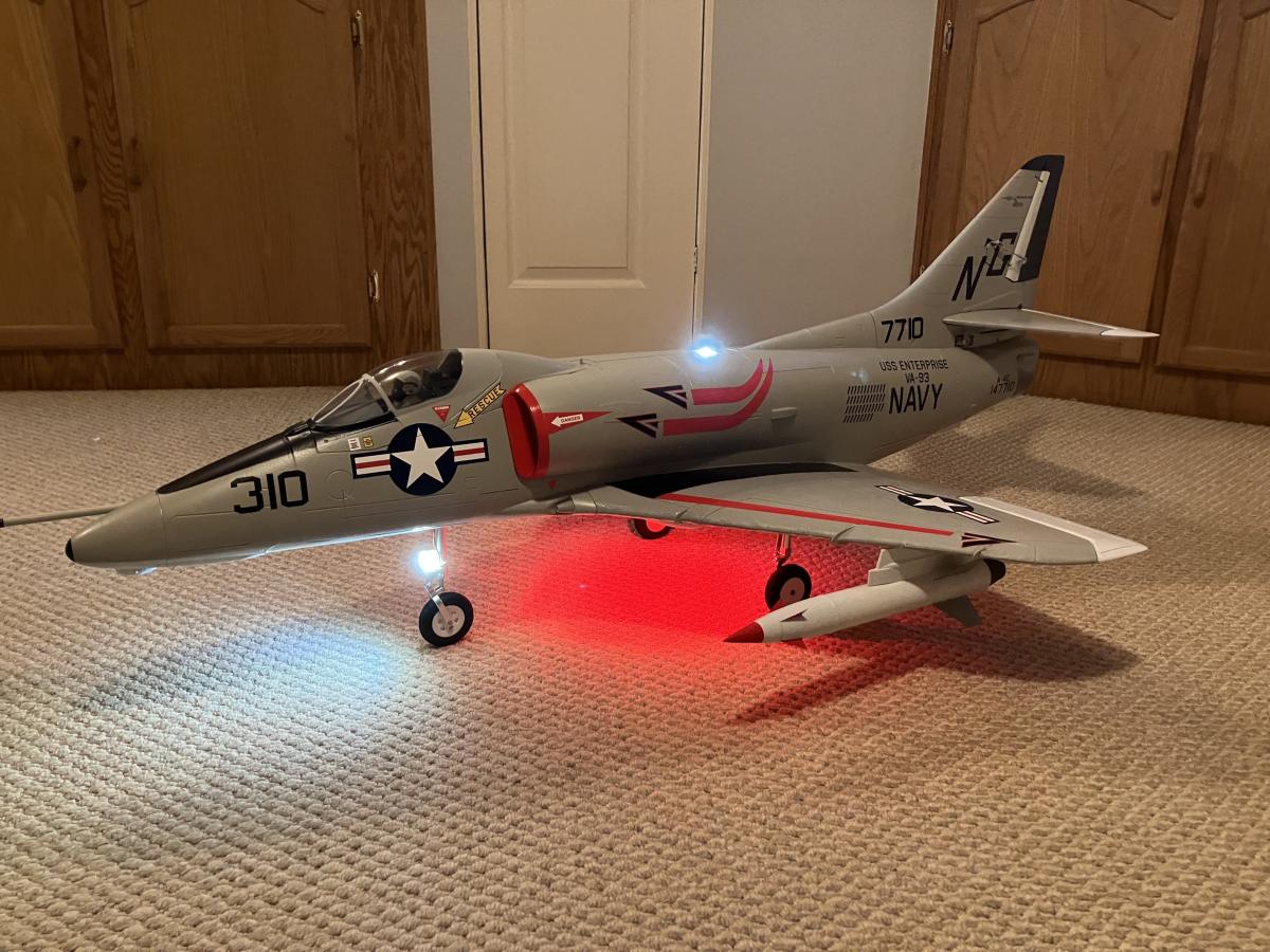

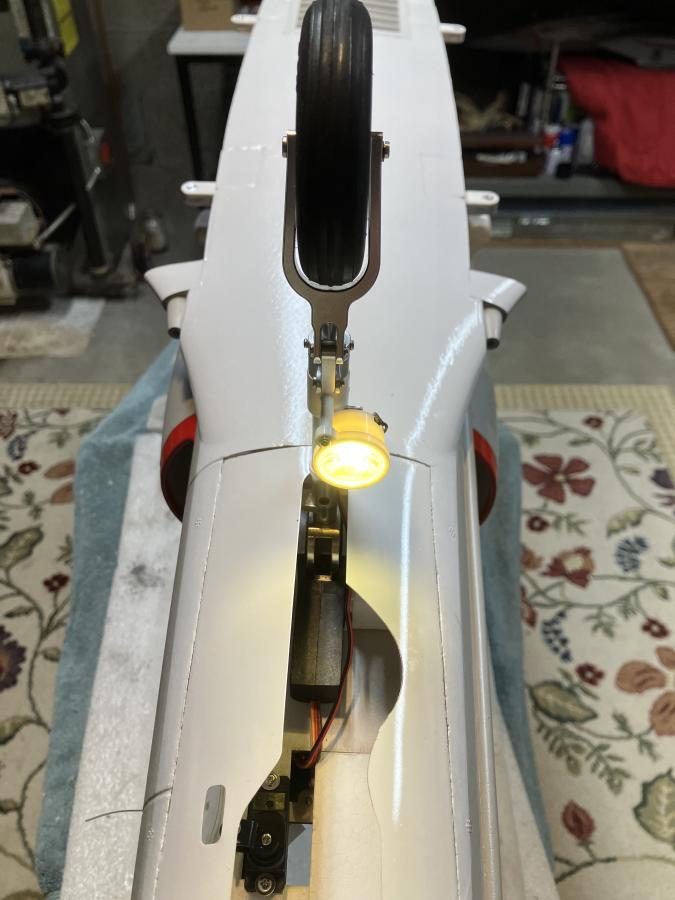

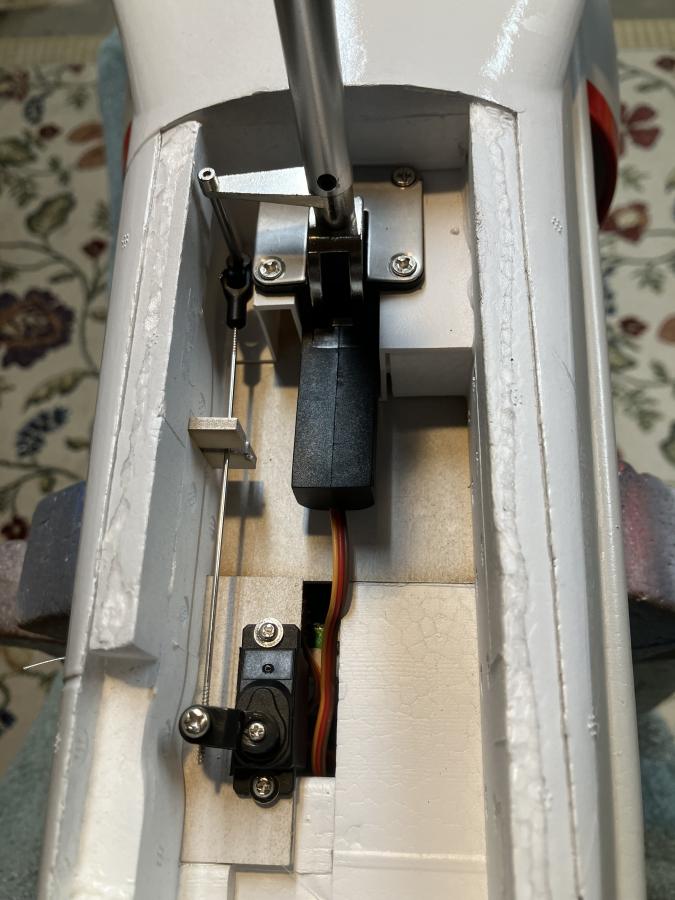

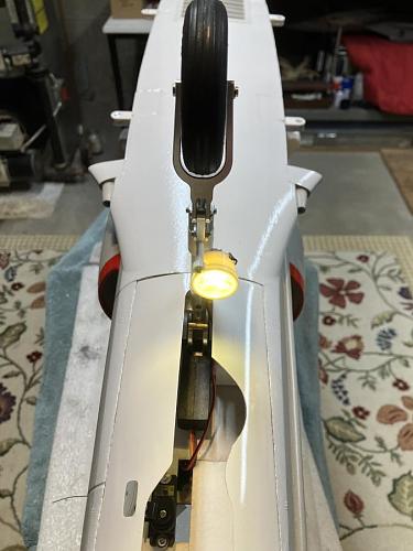

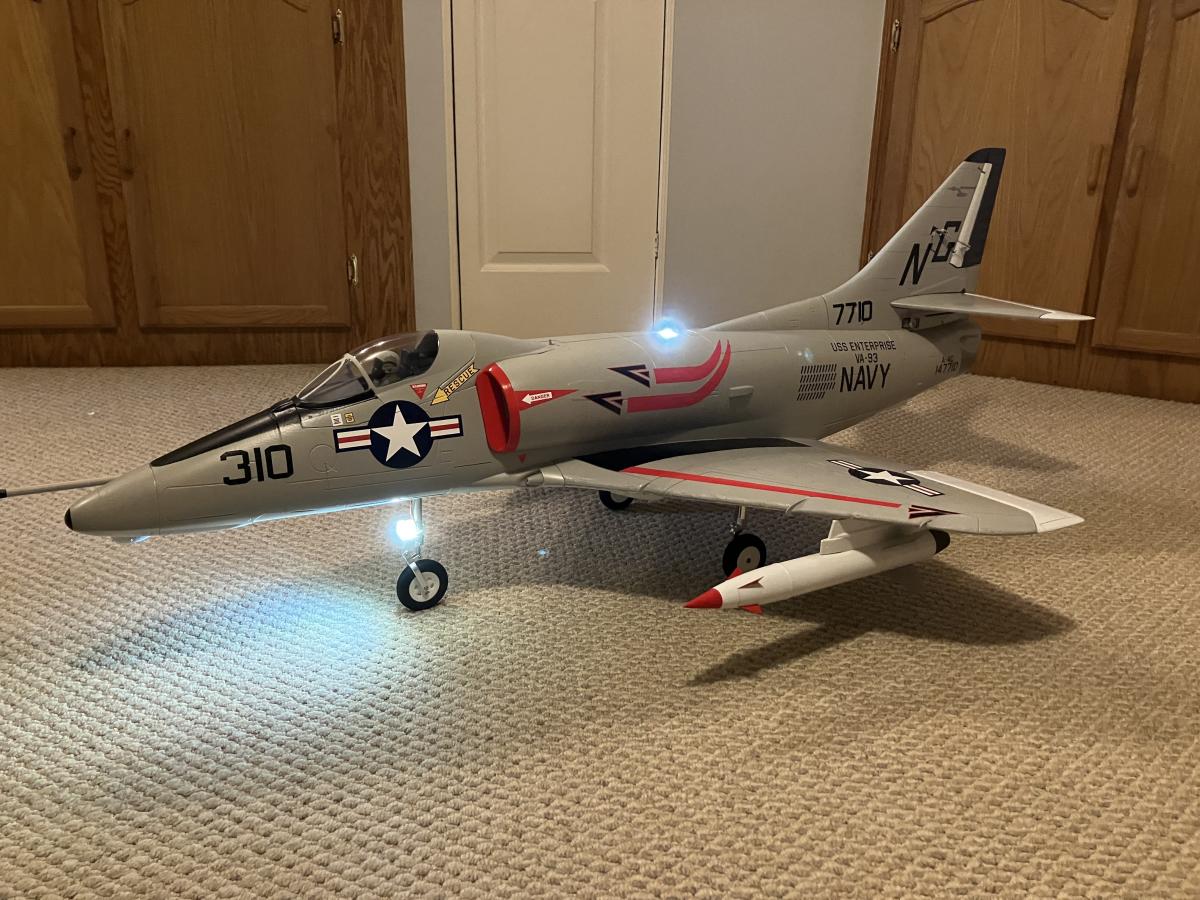

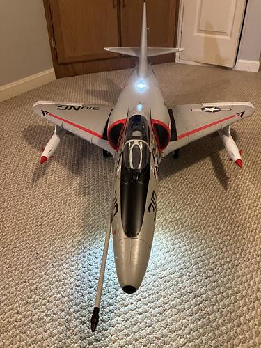

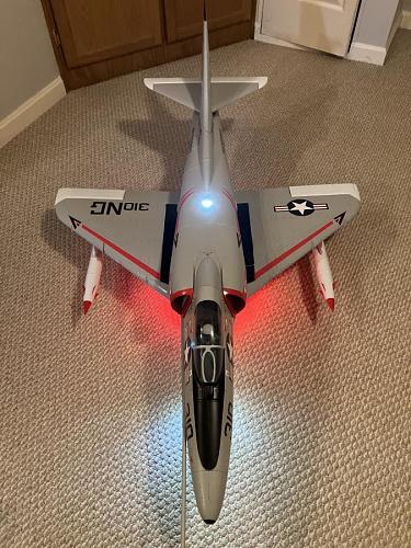

              • Completed the build of my new A-4 Skyhawk. This was the older version that I got from a friend at our field with the 1850Kv out-runner EDF. Upgraded to the 80mm 2150Kv In-Runner with
                AR 10360T 10 Channel Receiver, Avanti Front gear with F-15 landing light. Also added some nav lights on the fuse, Hitec Elevator Servo - HS5085MG with a Freewing Afterburner. Of course applied 3 coats of Min Wax Matte finish poly to protect her.
ID:	390450 Click image for larger version
ID:	390451 Click image for larger version
ID:	390452 Click image for larger version
                Thanks to Callie Graphics for the VA-93 Blue Blazers "USS Enterprise" livery.
                Cold and windy weather has set in her on Cape Cod so she won't see the air till the spring. Until then I will look at her on the storage rack........​

                  Looks great, but no hump, that's the best part...
                  I also put mine up on the storage rack, not because of winter coming but I have two other projects I'm flying for now, the scooter is always a blast to fly and the high alpha landings are a thing of beauty. Good Luck on your flights with her.
                  • Cape Jets WOW, beautiful repaint. Bravo Zulu, Sir.. Best, LB

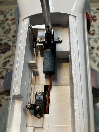

                    • Hello

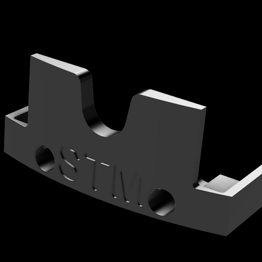

                      a friend of mine designed a good fitting NOSE GEAR BRACE PLATE
                      maybe someone needs one
                      I designed this stop for the nose landing gear on behalf of one of my fellow pilots. All the parts I had found so far did not really meet my expectations. The part can be printed directly without support and installed directly without further post-processing. The part was designed to allow access to the chassis screws.
                      Have fun

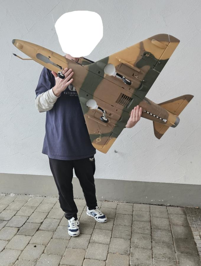

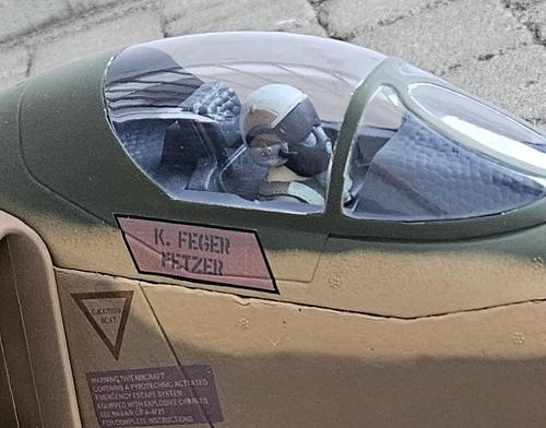

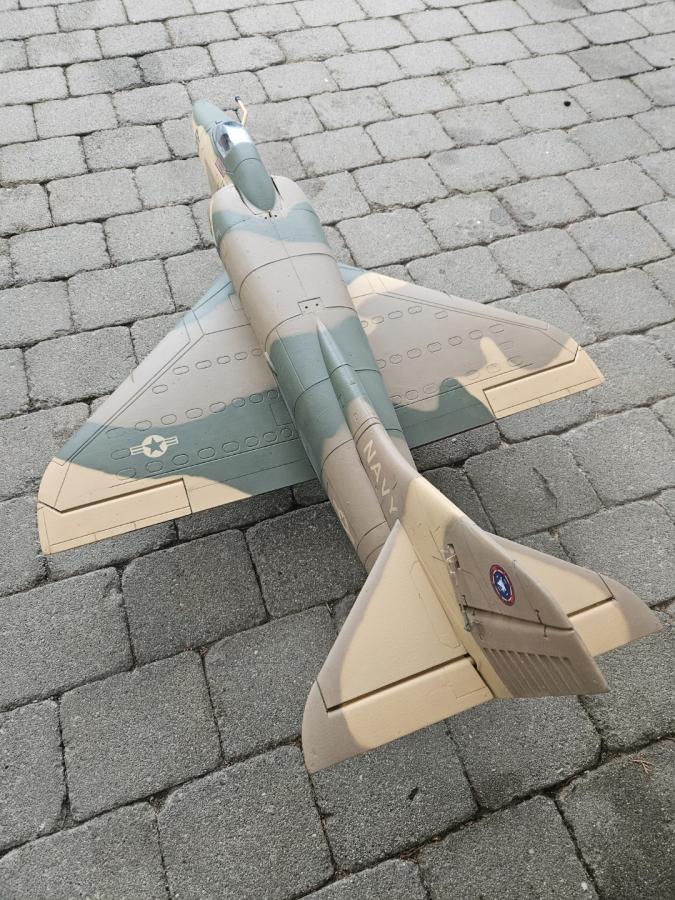

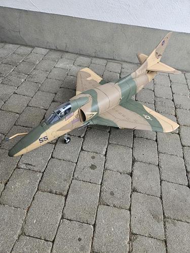

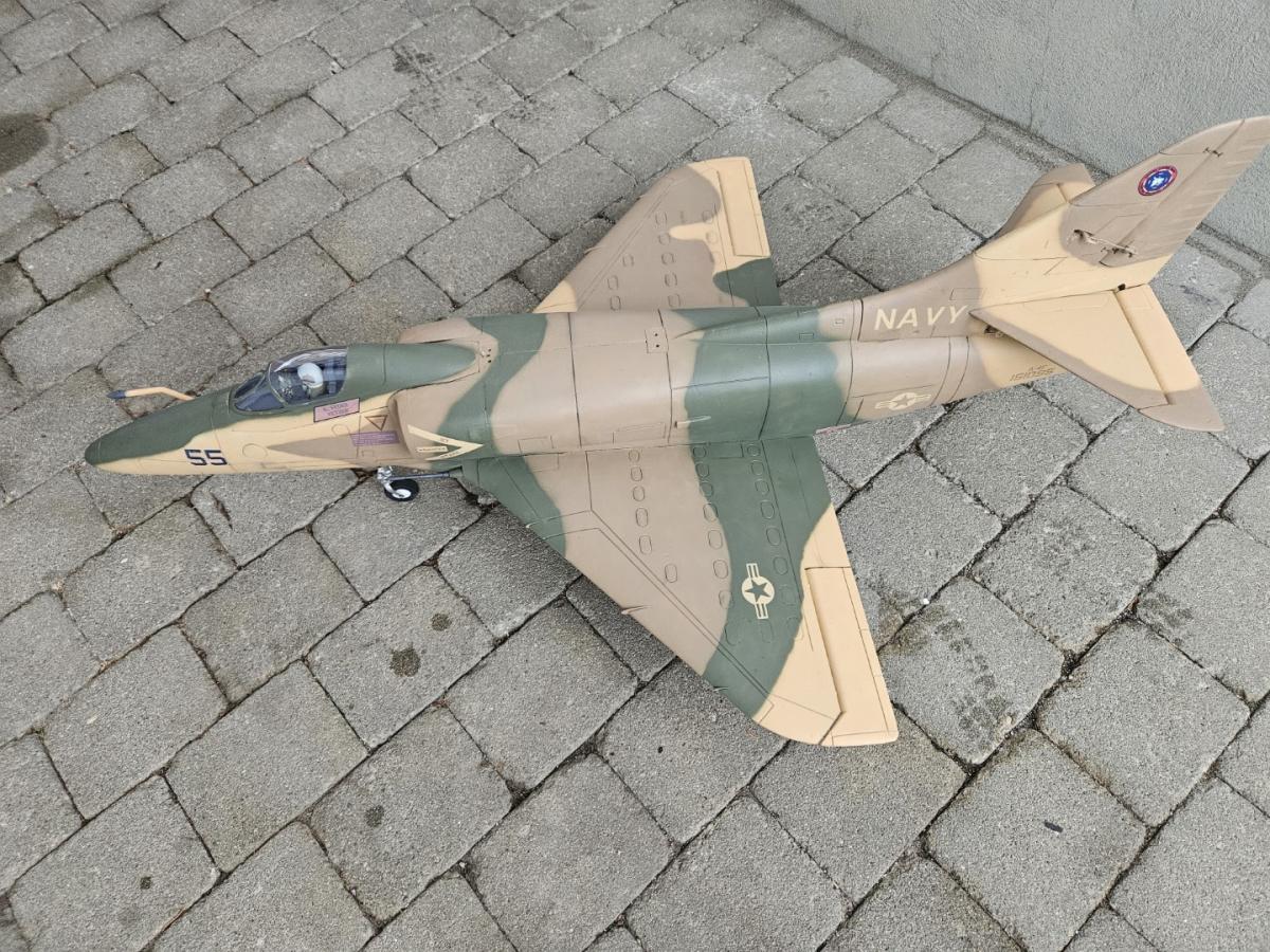

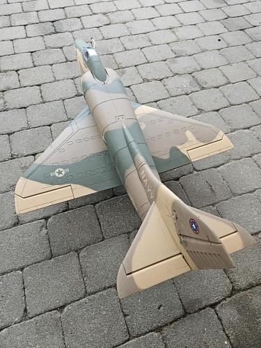

                                        • Hello everyone.
                                          The conversion of my Skyhawk from the standard Freewing paint job to Jesper's TopGun machine is almost finished.
                                          😀 I still have to adjust the wheel arches. It's not 100% scale e.g. pilot's name 😁but definitely 100% inspired by TopGun. The tank trunk is 3D printed (thanks Mike for the help with the design) and the stickers were created with the help of Frank Born (thanks for the masks and stencils). Don't be surprised, it's sleet in Germany, I'm in my Sunday afternoon outfit and the pictures were taken under the carport - pictures of the Skyhawk in its natural environment weren't possible today, but I didn't want to wait to share the results with you.​
                                          Thanks to Veronika (dragonfly-art) for teaching airbrush basics 😄
