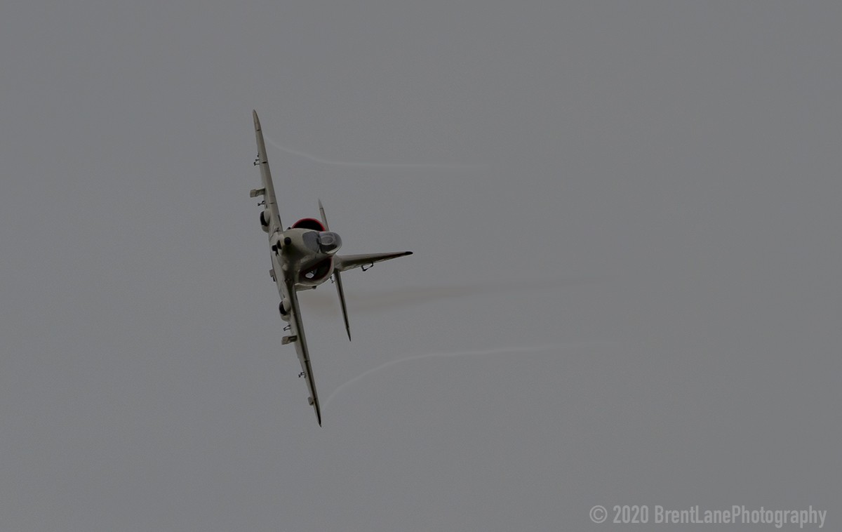

    • My friend Brent took this pic when I was flying my Scooter last weekend, and added some wingtip trails and exhaust. This little plane cooks!]

        Love it, looks scale for sure, can't wait to get back into EDF jets again, took a break and went to scale helis for a bit, I will return one day and one of the first jets I will purchase will be the A-4, love flying the Scooter....!!

          • Your friend Brent took a fantastic photo! Love the added effects. Man, that's what this hobby is all about! Can't wait to get mine going. Too many planes in line!

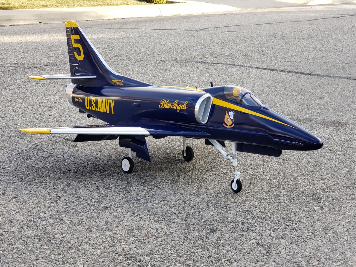

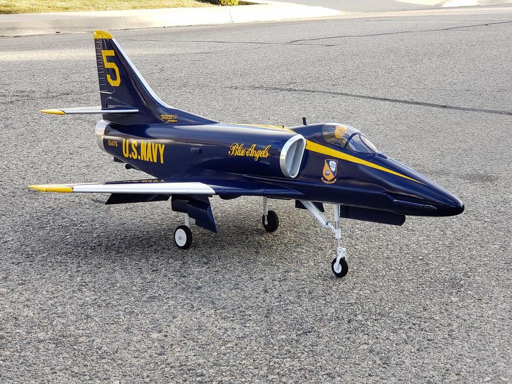

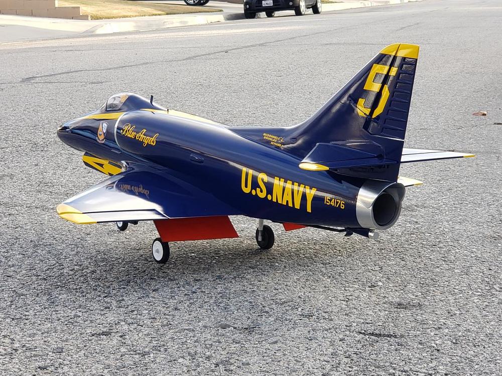

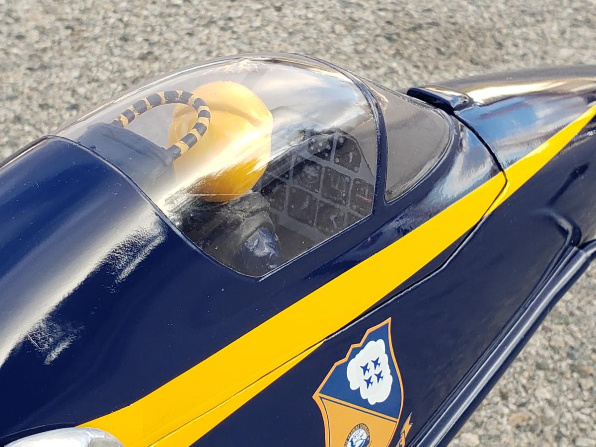

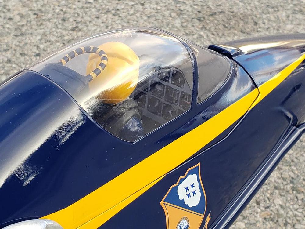

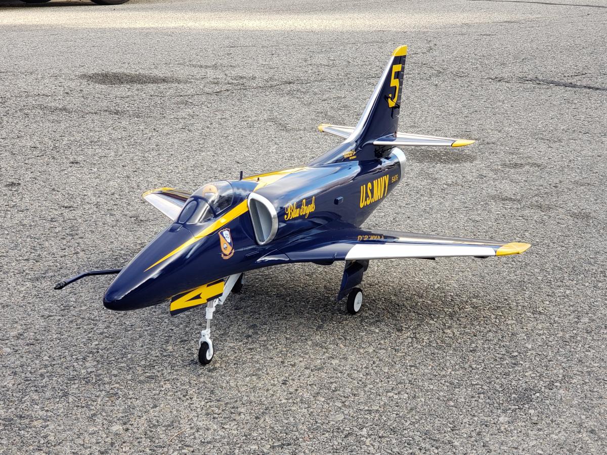

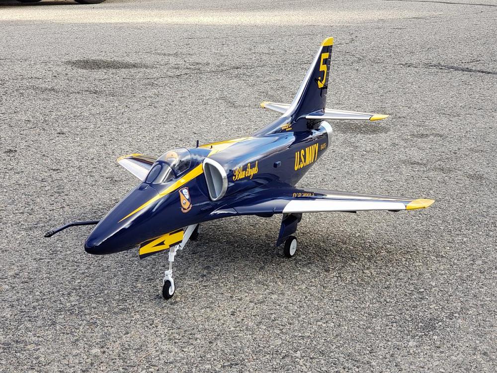

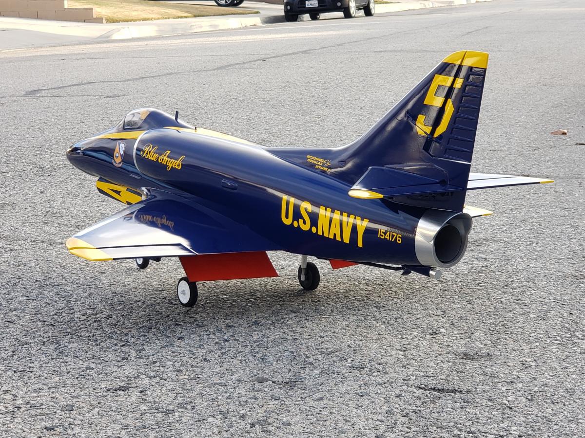

                    • And here's Brent's absolutely stunning Blue Angels tribute ship, flying recently out at Rabbit Dry Lake in SoCal...😎:
                      Seeing an A-4 in classic Blue Angels colors just brings back so many great memories...Enjoy the show everyone 😁!

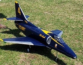

                      • Love it. Great Scale detail. I did mine in BA also but not to thhe level of excellence Brent has here. I'm #4

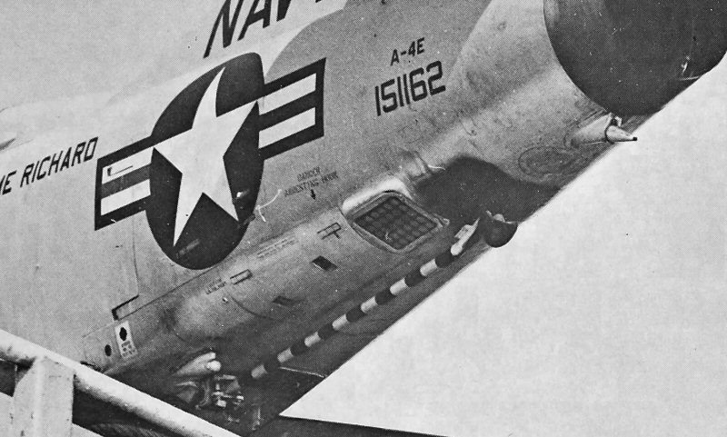

                        • Hi all. Just got my A-4 today.
                          on the underside of the a-4 on the left side of the tail hook is the AN/ALE 29 chaff/flare dispenser. Cir 1967.
                          has anyone found a good reference pic not black/and white to get a paint detail on it. It is a dark grey or metal?
                          TYIA.

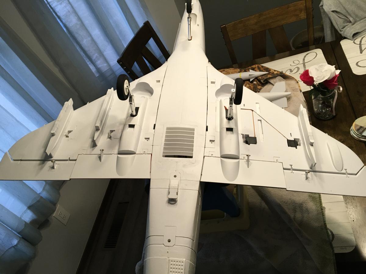

                          • Right wing sanded, filled painted.
                            Center mold line sanded, filled and painted.
                            filling in the hinge points.
                            1quart of flat color matched paint was on sale at our local hardware store for ..... 70 cents!

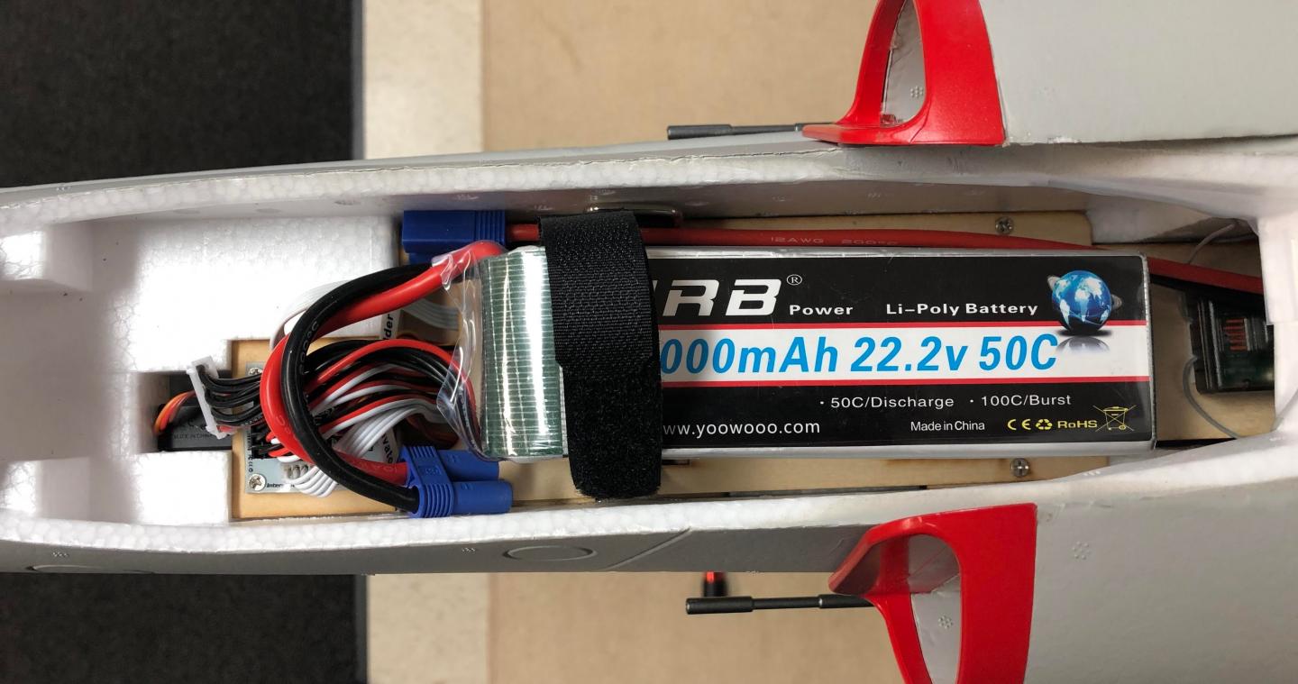

                              • Hey guys can someone advise if this looks about right? CG is at 195mm with a 6000mah battery. I tried to set CG at 185mm but could not get there even with the battery all the way forward. The only way I could get there is put weight in the front and I didn't want to do that.

                                  It should perform perfectly with the battery there. From the pic it looks like you might be able to get the battery just a bit further forward and that will be OK too. Your pic looks just like mine.
                                  Couple of tips - this plane is very sensitive to aileron, start out with very small throws and then dial it up to where you prefer. Most of us are using less than 1/2 of full throw.
                                  The ailerons will look like they are tilting upwards a little at the tip when the ailerons are level, this is normal.
                                  Nose steering needs to be dialed back as well, as this plane sits pretty tall and will tilt over if you turn too sharp when taxiing.

                                    Hey, really appreciate your confirming my battery placement and also the advice. I Will definitely dial down the aileron throws. I have the Hobby Lobby A4 from back in the day and was amazed how little throws were required, can't even imagine the real plane LOL. Thanks again!
