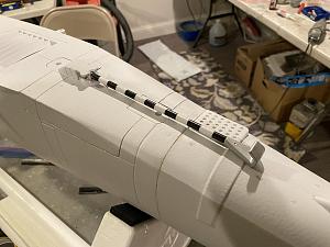

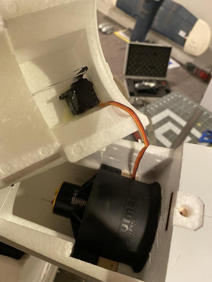

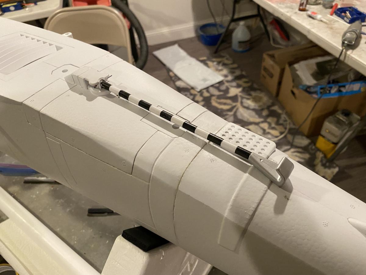

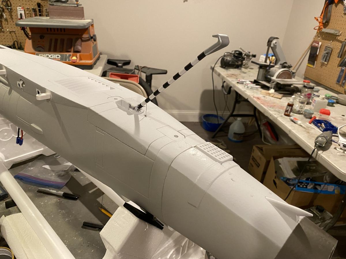

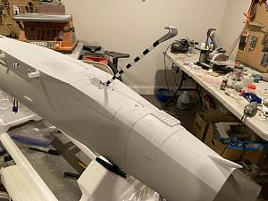

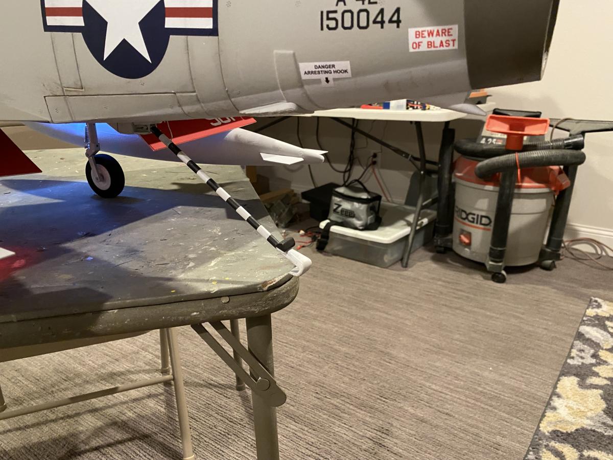

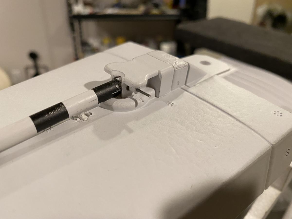

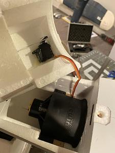

                        • I bought a new Freewing A-4, arrived via Fedex in just three days from Chicago to remote Wyoming where I live! I used to have an A-4 for years, loved flying it, but decided to sell it a couple of years ago when we moved.
                          Whenever possible, I like to figure out some way to make tail hooks usable, or at least moveable. I did on my last A-4, but sorta forgot how I did it years ago. I was surprised and delighted to see that on the motor cover on the bottom of the fuselage, inside, there is a deep formed pocket just perfect for putting a servo and connecting rod to the hook.
                          Others have already done this moveable hook thing, so I guess it's pretty common now, but I thought I'd include a few pics of what I came up with, in case there is anyone thinking of doing the same thing. It's pretty easy to do, and I think will work well. I did make a small channel in the foam to route the servo wire away from the motor and air blast. I decided to do some different markings than the stock ones this time, so I chose a set from Callie, depicting VA-152, circa 1968.

                          • Thanks so much for sharing Dave!
                            • Originally posted by SanExup View Post
                              My pleasure! With an old servo lying around, some stiff wire and a little glue, this is an easy functional addition to this legendary airplane. If you have any questions if you or anyone else decide to do it, drop me a line.

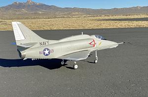

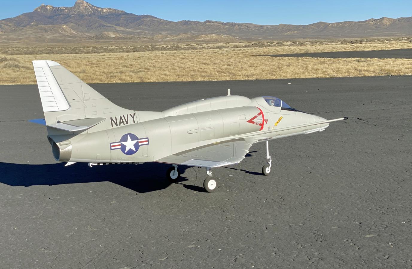

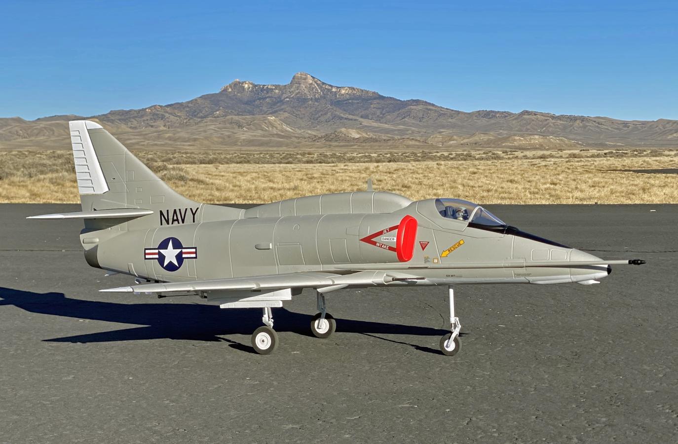

                                      I got the maiden in this morning with my new A-4F. It is in standard markings for the moment as I await Callie's sheets to finish the plane as one from the VA-152 Mavericks, circa 1970.
                                      I used most of Chris Wolfe RC Geek's suggested flight control settings and they worked well, although it is still very sensitive and I was probably over controlling it. Also, I added one oz. of weight in the nose to move the CG forward to 185mm aft versus the manual suggested 195mm, due to some pitch up issues Chris encountered on his initial flights. No real unexpected issues, just need to fly it some more to feel more comfortable with it.
                                      It will take several flights to get it where I want it. I used to have one of these for years that I sold, but it was fun to get back in the saddle again with a new Scooter!

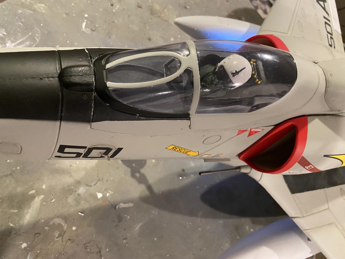

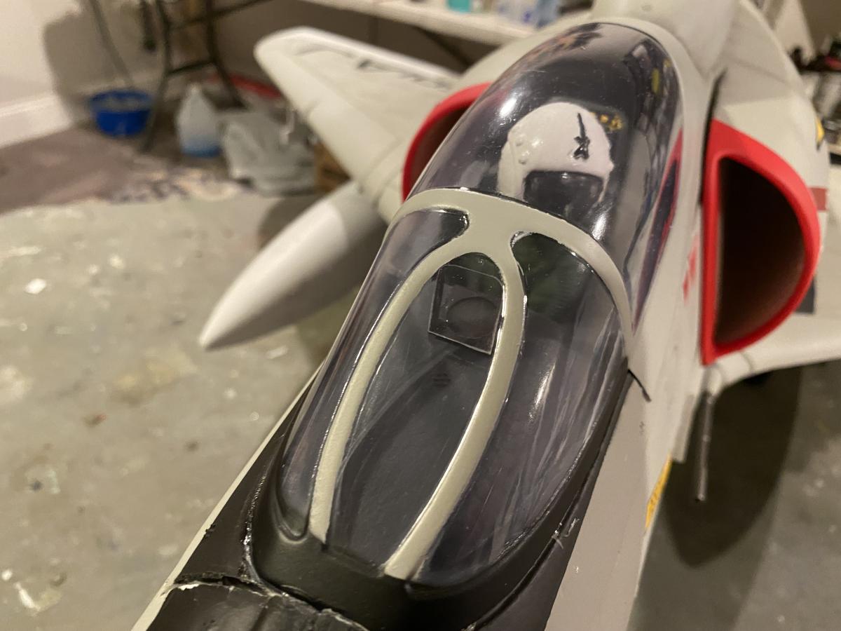

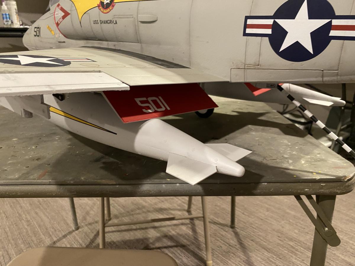

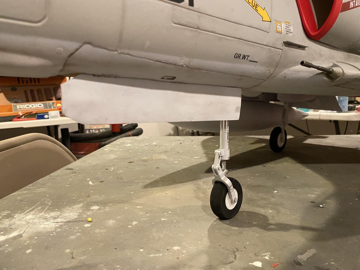

                                      • Through a combination of high winds and now snow, my flight operations have ground to a halt for the time being. I still have a E Flite Timber on floats that works well on the snow, so that's probably a good near-term plan.

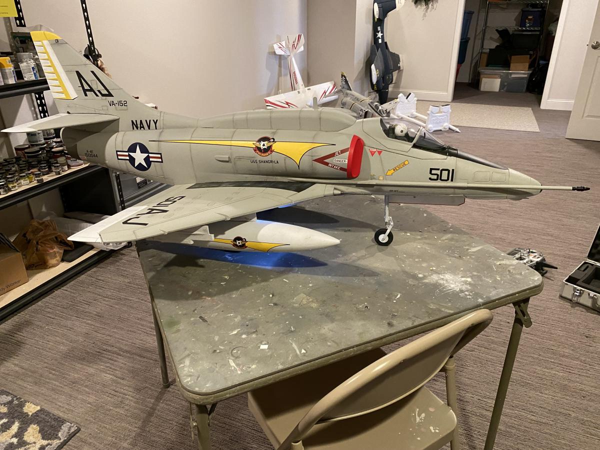

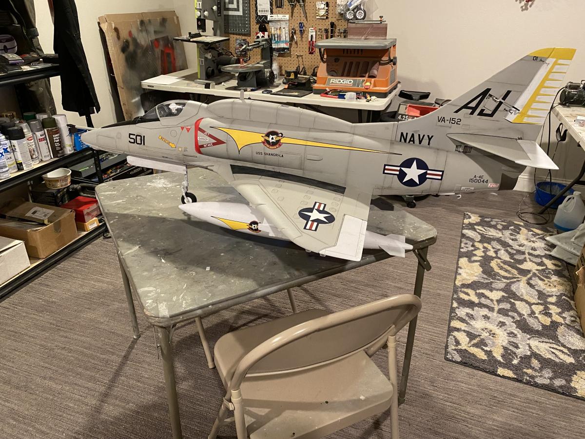

                                        During this down time, I have pretty much completed the extras and markings (Callie) for my A-4. I replaced the pilot with one from Chris Wolfe's RC Geek company, added some details like cockpit painting, and scratchbuilt ejection handle and gunsight. I also used his (Chris') example to make a functioning retractable nose gear door, which seems to work ok. Added a few exterior lights, as well. I have a three position tail hook that I might eventually try some "trap" tests as some others on Hobby Squawk have already successfully demonstrated, we'll see.
                                        I also added thin plastic sheeting on the inside of the flaps, which made them more scale, and also easier to put the aircraft numbers on them. I may to a few more things as time goes by, but this was just a fun challenge of doing a little detailing on a bird I intend to fly a lot. Only two flights on it so far, but it seems to be pretty much trimmed out now.
                                        Davegee

                                        • Looks good. I haven’t put mine together yet and am considering different markings too.
                                          Did you remove the dark blue paint on the rudder or just put Callie’s decal over it?
                                          Thanks
