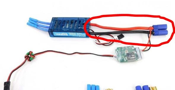

      I need to lengthen the EC5 connector wires, ESC wires (red/black). My initial thoughts were to simply make an extension. Would this work?

      • Yeah don't worry about it. You are not adding excessive length. But be aware that the F-86 was one of FW first EDFs and the motor/ fan in that made quite a bit less than the stock A-4 unit. The F-86 unit in mine made 1624W and the A-4 made 2124W, over 30% more.

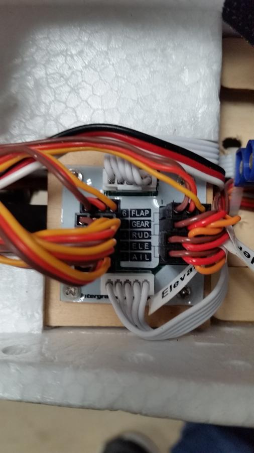

                      • What are you guys using for CONSERVATIVE control throws on the ailerons, and elevator?
                        Can you guys also show me where the nose gear retract servo lead plugs into the control panel board?

                        • Originally posted by CVA59 View Post
                          <sigh> - I had to haul my plane out of the storage rack, but here you go! This is a pic taken looking inside the nose compartment with the nose pointing to the left.
                          You'll see the nose gear retract wire Is plugged into the board at the top right position of this picture. Look very closely and see that the little diagram printed on the box is marked "gear" for that position.
                          The white wires on the top and bottom are the cables from the wings.
                          I found the throws were way too sensitive for my liking, so I reduced it. On my radio, I've reduced the control throw to 54% on aileron and 67% on elevator.
                          I am also using 45% expo on aileron and 38% on elevator. This is what I did, but its really a matter of your preference and flying style. I like flying smoothly and scale-like, at least I try to do that. This model will roll like a g-d drill bit - it rolls so fast that you can actually induce a stall at high speed. (Mine starts to snap-roll after about 2 high-speed rolls) Where I have it set now, it rolls very quickly but nicely and the expo allows me to be smooth. So that's just me, you'll need to find what works best for you.

                            Got it, works perfectly now, thanks
                            I will also use your settings to start with. I am a scale flyer as well.

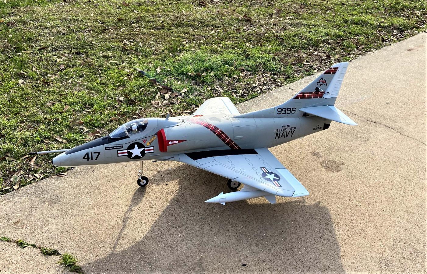

                                • Well, after several weeks of repairs, paint and Callie graphics, here she is ready to fly again. Still have to get the CG correct and setup the control throws but otherwise she's all set. I did her up in the VA-46 "Clansmen" squadron that was aboard the USS Forrestal on July 29th 1967 when it caught fire. One of the pilots who was strapped in awaiting launch while sitting tip to tip to John McCain that day is my friend, Dave Dollarhide. I have used Dave's photos and such to replicate the plane he was flying that day. Dave was very impressed that I chose to replicate his A4 for my R/C version. Dave has an incredible story for those who have an interest. I have attached the PDF of Dave's story to this post as well. There is also a video of Dave's last flight in the A4.
