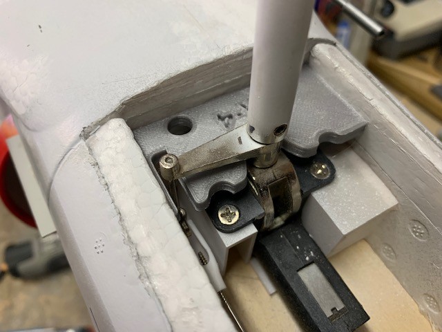

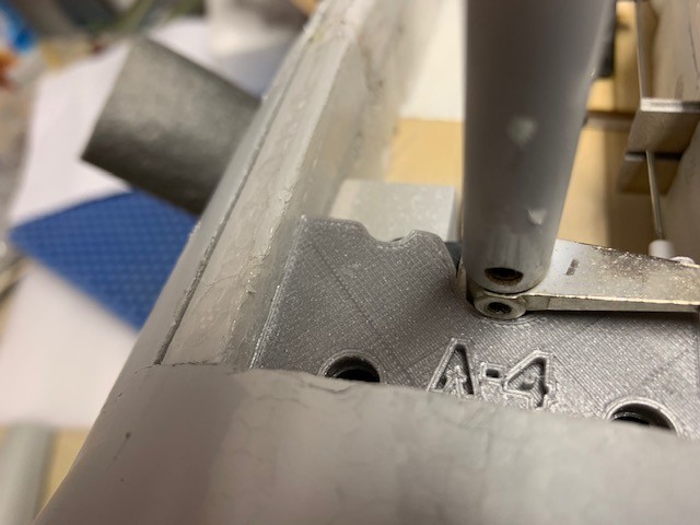

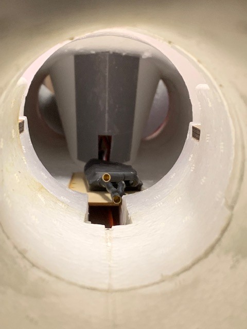

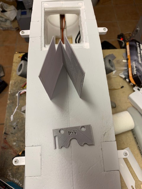

              While exchanging the stock fan with an FMS unit, I discovered the blunt joint of the inner walls of the intake ducting. Such design creates a lot of undesired turbulence. I made a simple 3DP part to create a sharp joint to improve the airflow. In addition, a nose gear brace was made. Both stl. files are attached.

                Great ideas, both! At this stage of our technology with batteries and such, efficiency is the name of the game. I see more clam shell type construction these days with wood and plastic components sandwiched into the foam mold process. If I were involved with design I would consider a one piece, smooth, plastic/laminate or similar thrust tube from beginning to end with an appropriate space to insert your fan shroud, etc. I know there would be issues with cheater holes and the attached consideration for power systems, short vs long field ability, and all of that stuff... not even suggesting it would be the way to go. Just saying it would be an avenue I would investigate thoroughly. I'm not a scientist and have no data to even suggest the increase in efficiency would be enough of a benefit to outweigh the change in design and manufacturing costs. If anyone has done thorough thrust tube testing it would be cool to see the data. I tend to agree with your idea that every little bit helps. :Cool:

                  Thanks, those look very useful !
                  Have you done any tests, does your "low-turb splitter" seem to produce better thrust? Does it change the sound?

                    No tests with the A-4 yet. But I made a similar mod on the FW F-4, F-22, Lippisch, Avanti and L-39. On the last three, I did a ‘before and after’ comparison, and there is a noticeable higher top speed (GPS measured on the Lippisch). The question regarding the sound is hard to answer, I feel it sounds smoother at top revs.
                    I’ve no idea, why the intake ducts are designed with the “high-turb” rounded splitter. Just google “skin friction drag”.
                    If you look at well-designed wooden or composite EDF models with bifurcated inlets, you will always find such a design.

                      The last three don't have split exhausts, what are you doing and what is "significant"?

                        Correct, but this is about the intake section. The mods to the Lippisch (incl. closing cheater holes plus wing spar fairing) resulted in about a 10% higher top speed. For the others, the term “noticeable” is probably more appropriate. Please excuse my poor English!

                          Looks like he is putting the sharp edge on the rear of the inlet splitter just before the inlet air hits the fan spinner/blades. If you look at well designed EDF flow paths both inlet and exhaust flow paths are optimized --- see Bob Violet's models.

                            That’s what I was trying to say. Thanks!
