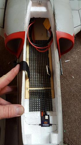

        mine...
          #2144
          Originally posted by RC30Flyer
          I may be a little OCD with my wiring... ;)
          You have too many wires there.... LOL

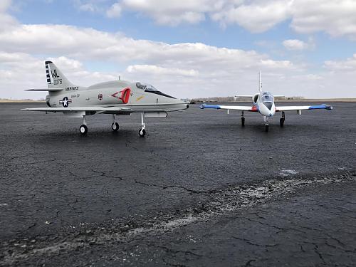

ID:	185266Click image for larger version
ID:	185265 ​ Finally the weather cooperated and was able to get out for a few flights. First flights of the year. Flights 4 and 5 on the A4 today. Took the opportunity to push it more each flight as my flights to this point were more familiarization in nature. Right about 3 min flights on the Admiral 5000 pack landing at 3.78 per cell.
                                      L-39 maiden flight today as well.
                                      Was as a good day for flying.

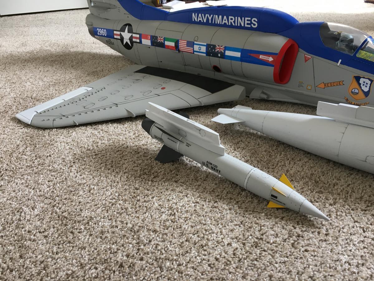

                                        The lastest update on my build. Things are coming along. The weathering on the drop tanks and rudder scaling.
