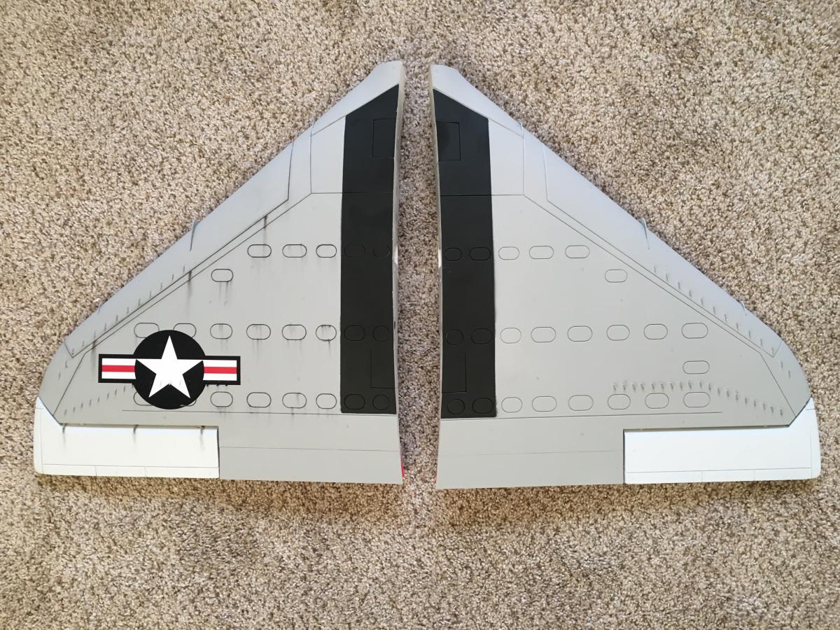

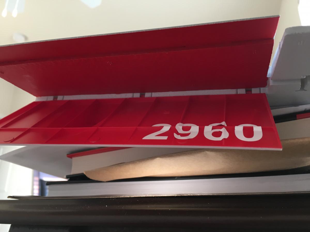

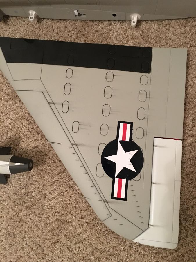

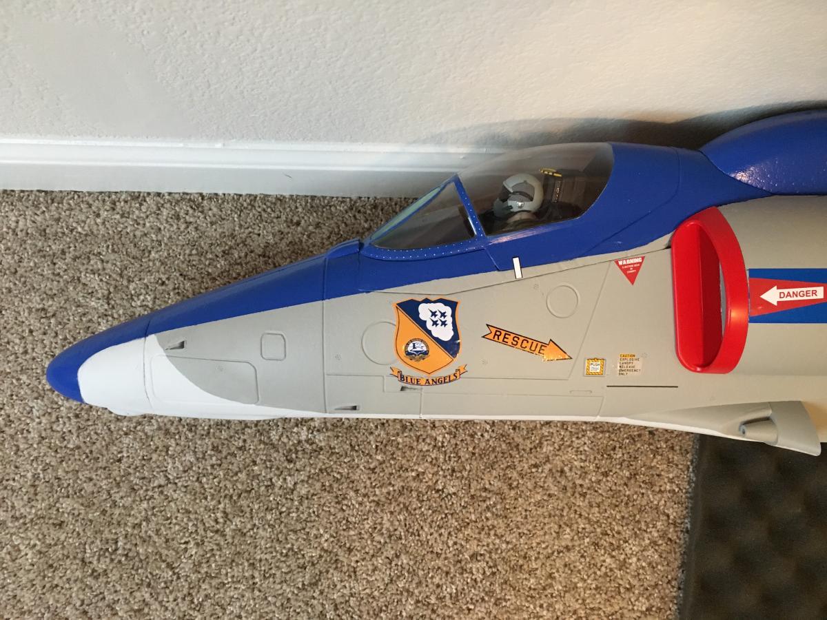

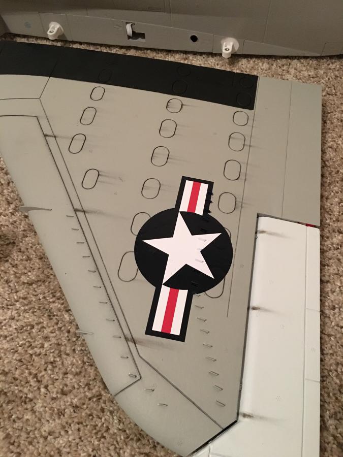

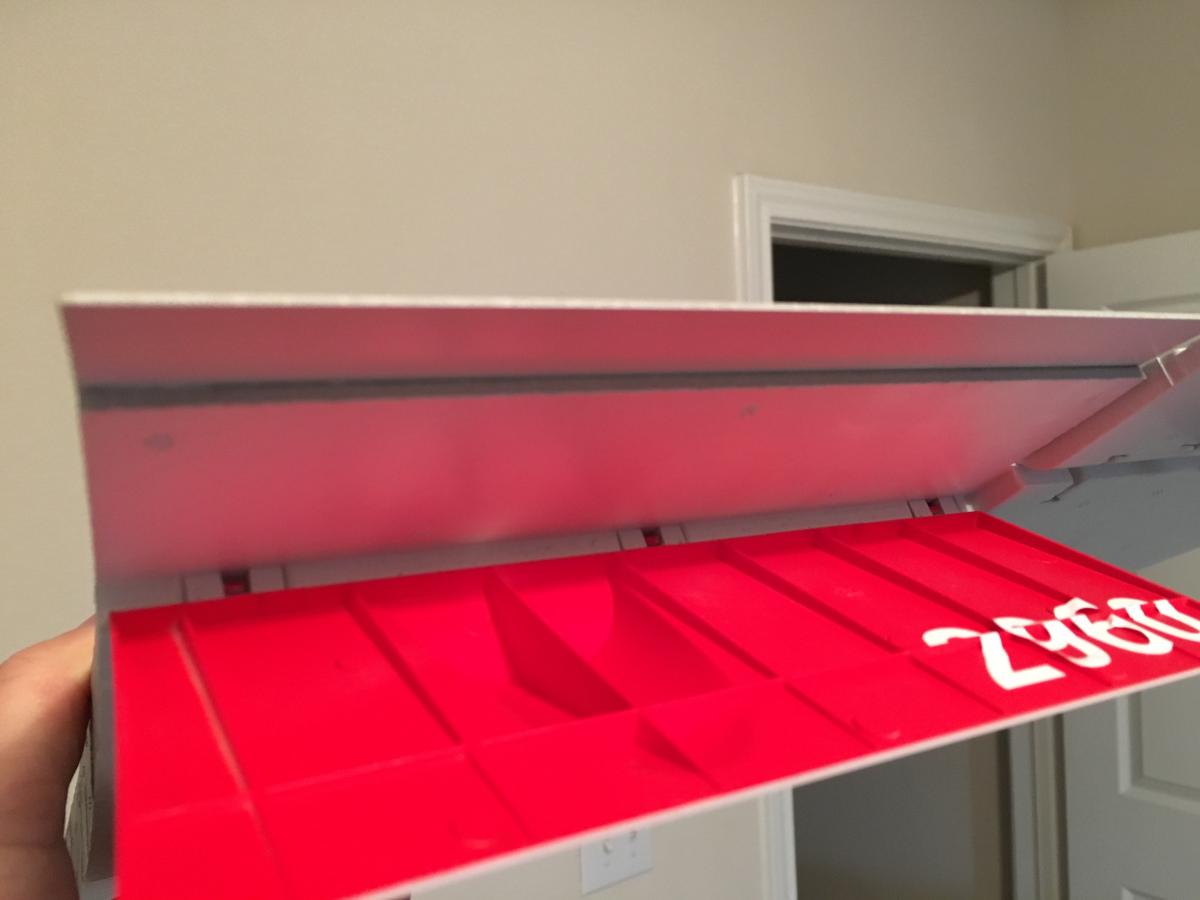

              Getting some more work done. Painted the under side of the spoilers, added detail to a wing and added Naca vents on the nose area.

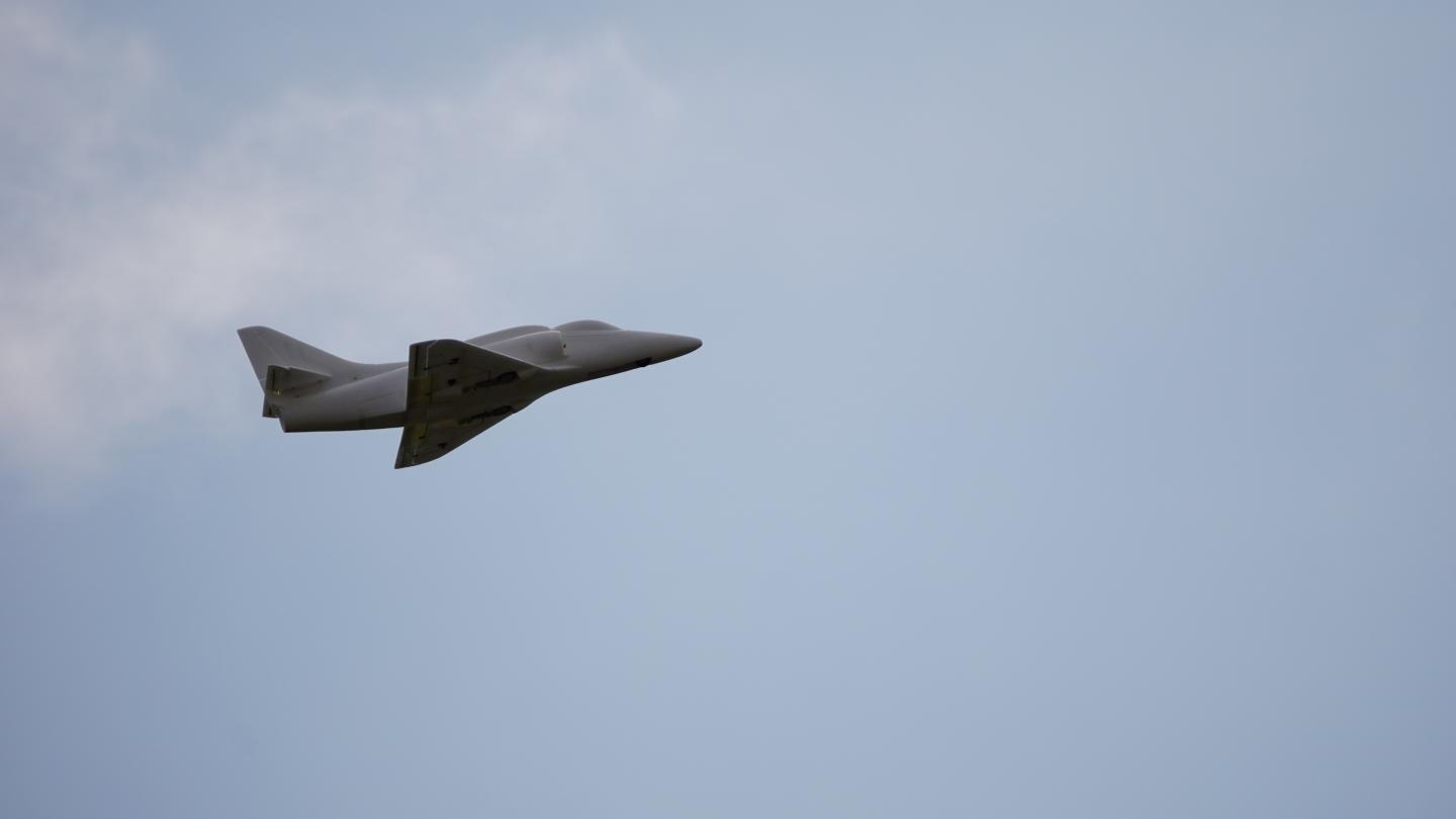

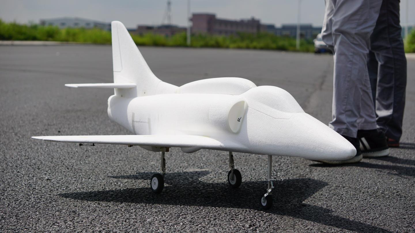

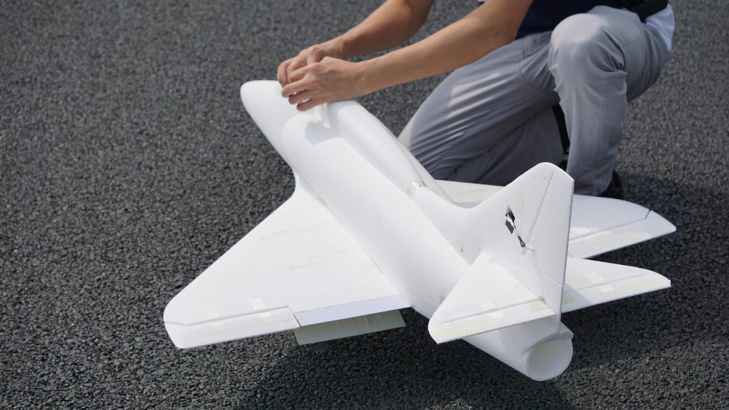

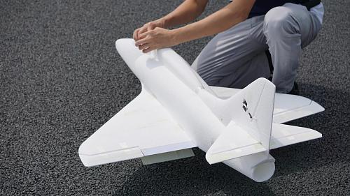

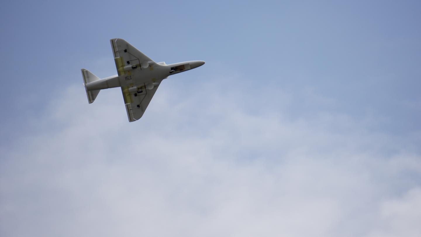

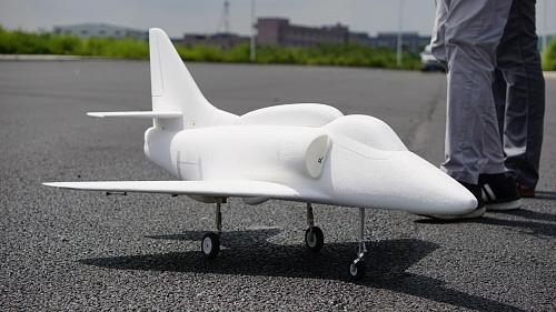

                Your scooter is looking magnificent, Thmprusmc! As a bit of a "blast from the past", here are some photos of our later stage A-4 prototype back in 2016. This is after we had upscaled it from the initial 70mm prototype. Even back then, we knew that split flaps were a must-have, even though they were plastic and expensive. From this CNC'd foam prototype to your customized production bird, all of us at Motion RC are very gratified to see these labors of love find loving homes and hangars.

                  I am curious to know the main reasons that it was decided best to scale up the A4? Just want to know the determining factors in RC development.

                        After testing the 70mm prototype, our development team all agreed that the overall behavior wasn't what we wanted in a mass market Scooter. Upscaling to 80mm resolved our concerns in terms of :
                        Performace: The 70mm was fast, but the wing loading was higher and landings were less forgiving. The 80mm sized airframe was still quick but landed much more slowly and stalled more gently.
                        Proportions: The rotating undercarriage required a thick wing, which looked badly disproportionate on the 70's wing. Even then, the 70's wheels were too narrow. An 80mm sized wing allowed both thicker wheels and better model proportions overall.
                        Price: Short grass capable rotating retracts required a new design and be part which means added cost. It's easier to offset that cost with a larger 80mm sized airframe. Controlling cost while balancing feature set is always a critical consideration.
                        Precedence: The foam A-4s from Blitz and LX in years past were 50mm and 70mm, respectively. Our development team wanted to do something different, so we chose the larger undercarriage, larger 80mm EDF, larger overall size, and the modular magnetic avionics hump.

                              Is the foam CNC'd in the prototype?

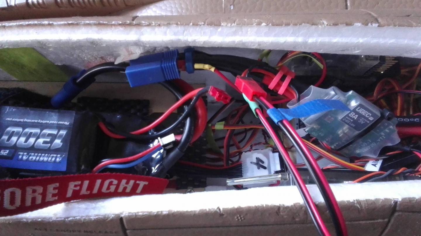

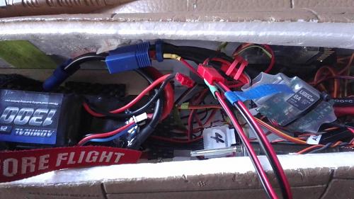

                                        I may be a little OCD with my wiring... ;)

                                          Possibly !! Hahahaha
