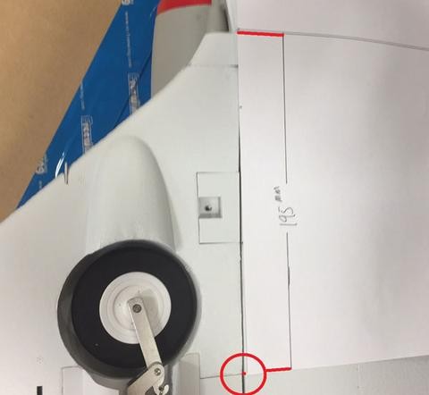

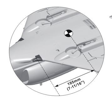

                  First, thanks for all of your great responses. After reading everyone’s ideas, I reviewed the starting point for measuring the CG from the MotionRC “Updates” doc for the A-4. It stated measure 190mm to 195mm from the “flat spot at the base of the cannon fairing”. And there it was: “base”. To me the “base” was where the wing meets the cannon fairing, but after reviewing the picture, the “base” of the cannon fairing is at the leading edge of the cannon fairing – go figure… That fact and the heavy weight of the Turnigy HD battery explains why it was coming out nose heavy. All is well now!
                  Thanks again!
                  Nick
                    #1389
                    Just for the record, I tried my CG at 195mm from the base of the cannon fairing and the maiden was a bit hairy. Got it down safely but my CG is now at 180mm from the same point.

                      Just to be clear, are you measuring from the point shown in the MotionRC updated docs (see attached)?

                        Yes. I also check it wheels down and inverted but I am at 180mm from the base of the canon mount pictured.

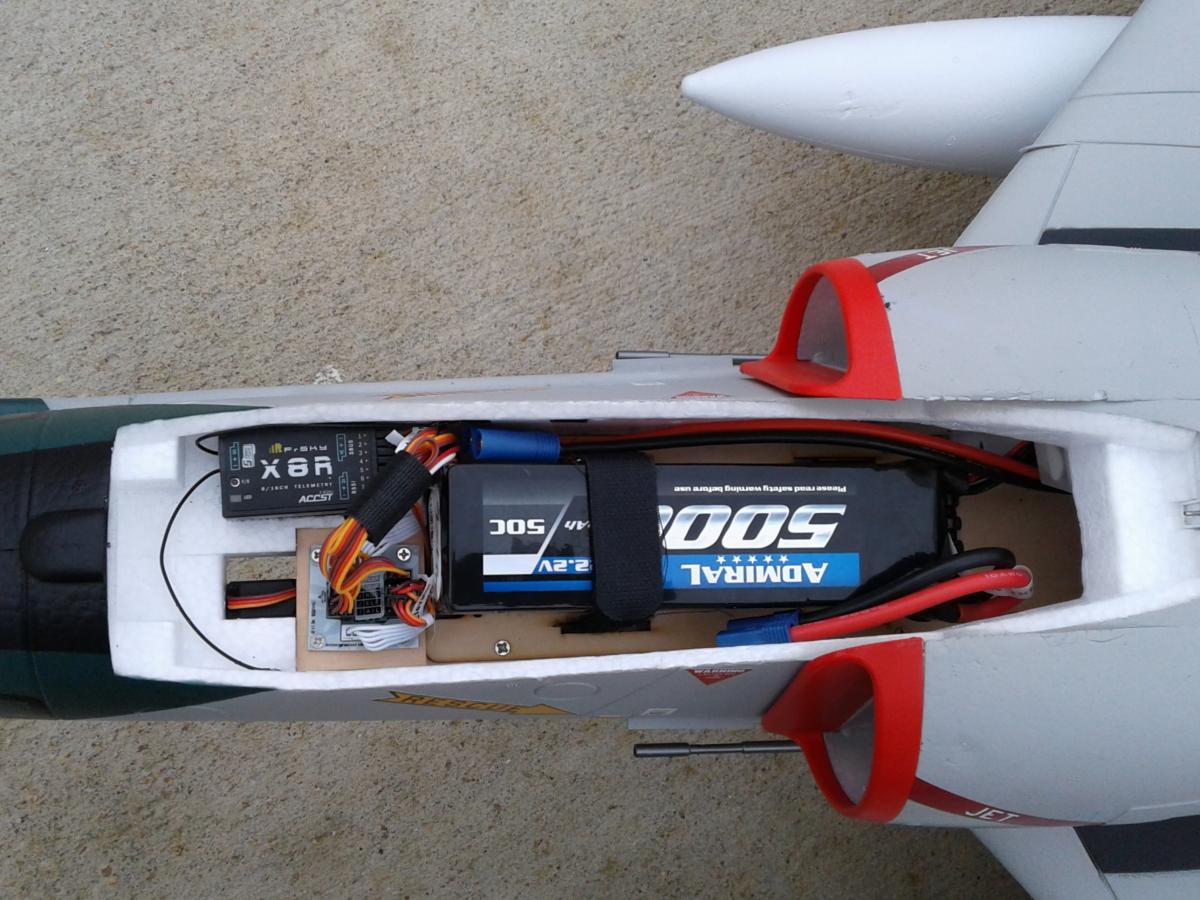

                          This is where I run my Admiral 5000 in the A4. Hands off no trim required. Elevator up mix as directed in manual.
                          34 flights so far on the A4. She still looks new. Rugged bird and a lot of fun to fly.

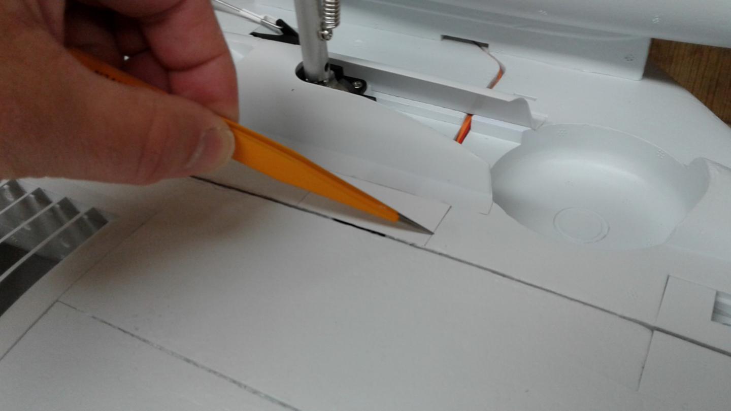

                          The Cg works out to this seam on the wire cover aft of wheel well. See photo.
