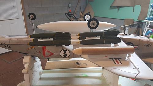

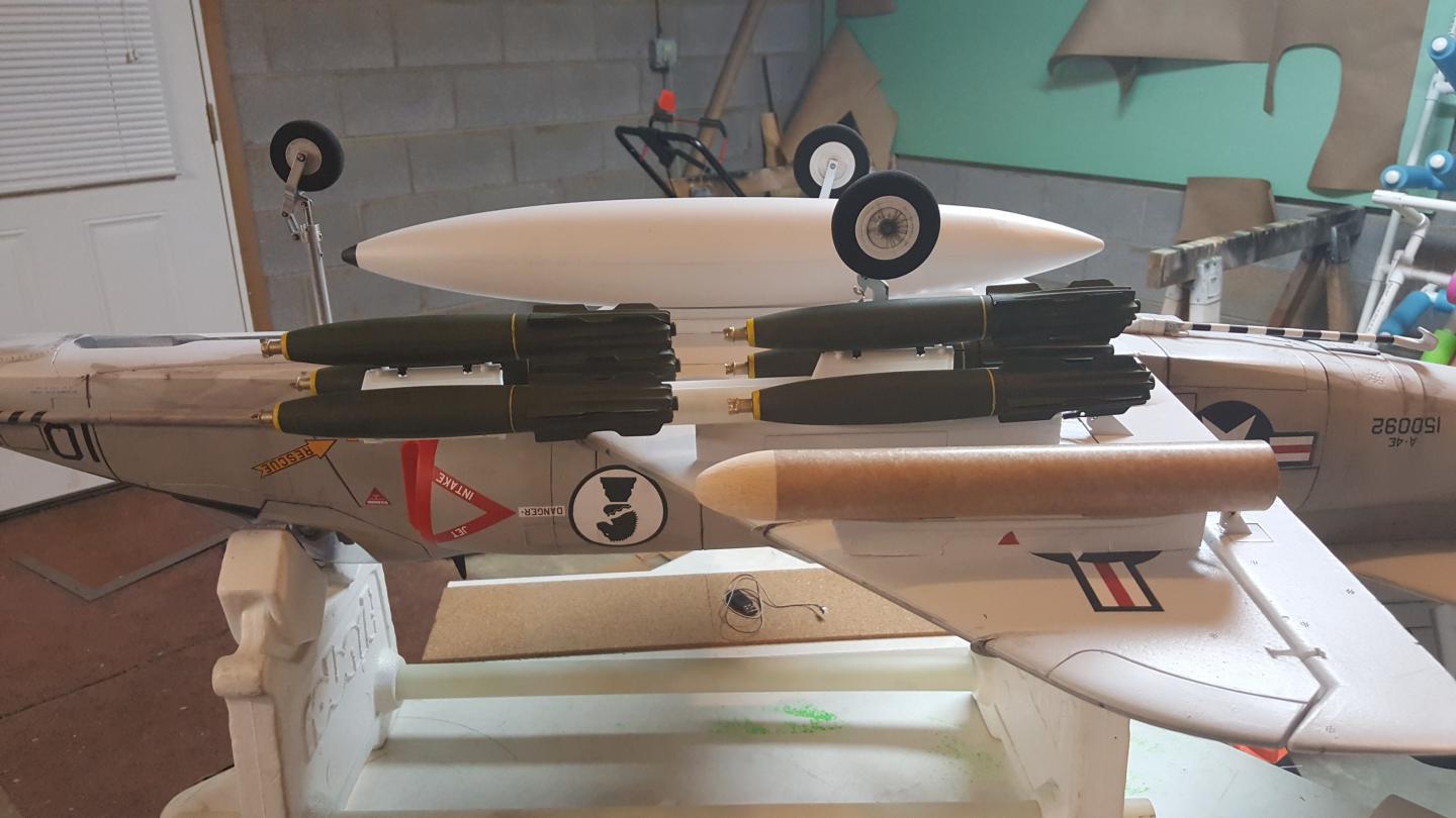

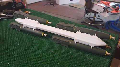

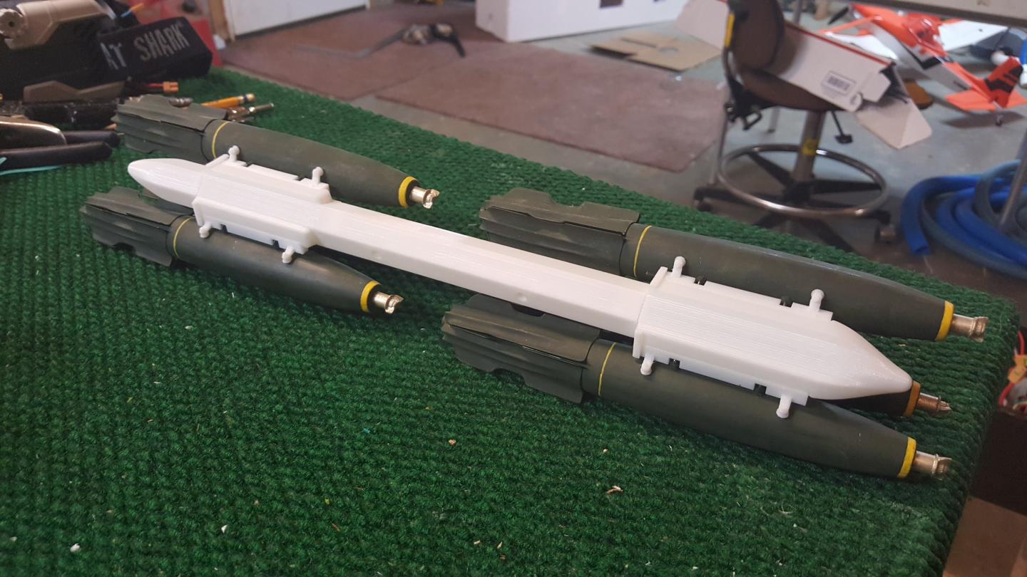

        Big shout out to Chris Wolfe, the RC Geek, for 3D printing some MER's for the Mk82's I am putting on my A-4. I modelled this plane back in the early 80's (BVM, ducted fan) but never completed the load out for it. Now I am getting to complete it with the Freewing A-4. He had to do some slight tweaking for the JHH 1/10th bombs to fit but they turned out exactly how I was hoping they would.
          They are SWEET :Cool:

                    Wow Spectacular! I am currently doing the the Diamond Back livery. I am very interested in that centerline tank. Did you modify the one of the large wing tanks that comes with the Freewing A4?
                    Now I want 3D printer! :-)
                        Yes. I cut the back off of one and the nose of the other and glued them together. It is close enough for what I am trying to do.

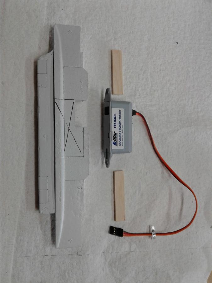

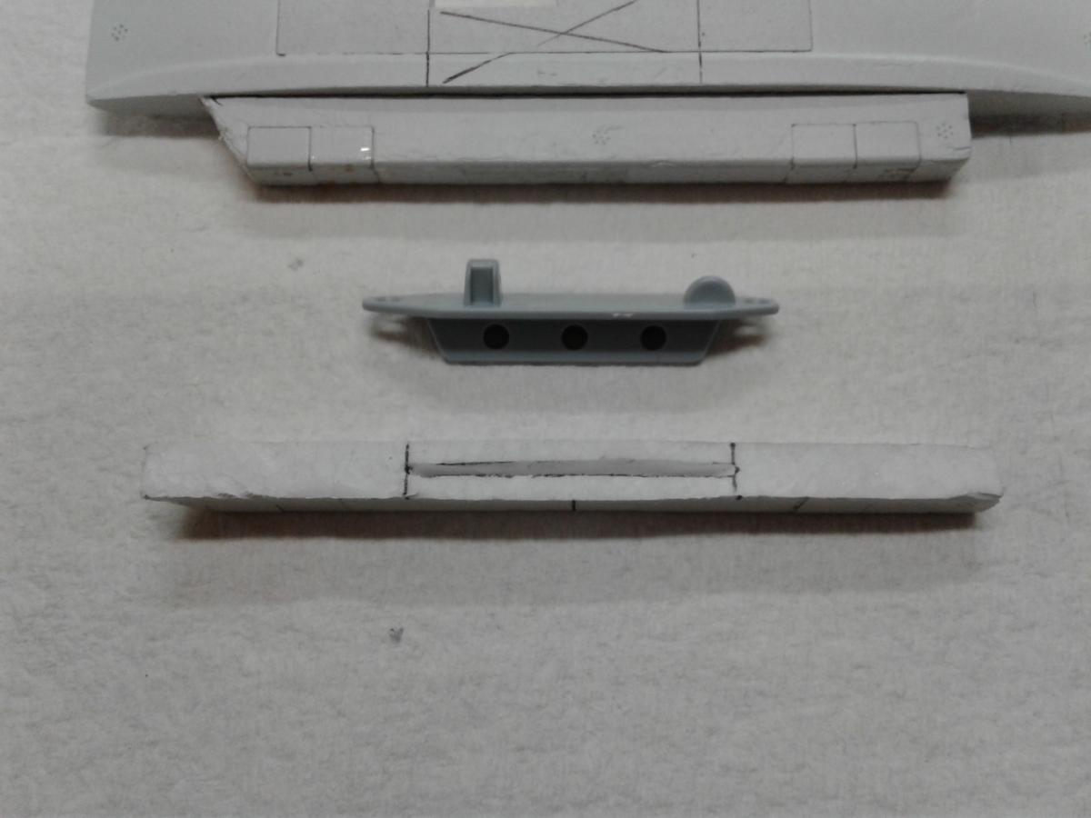

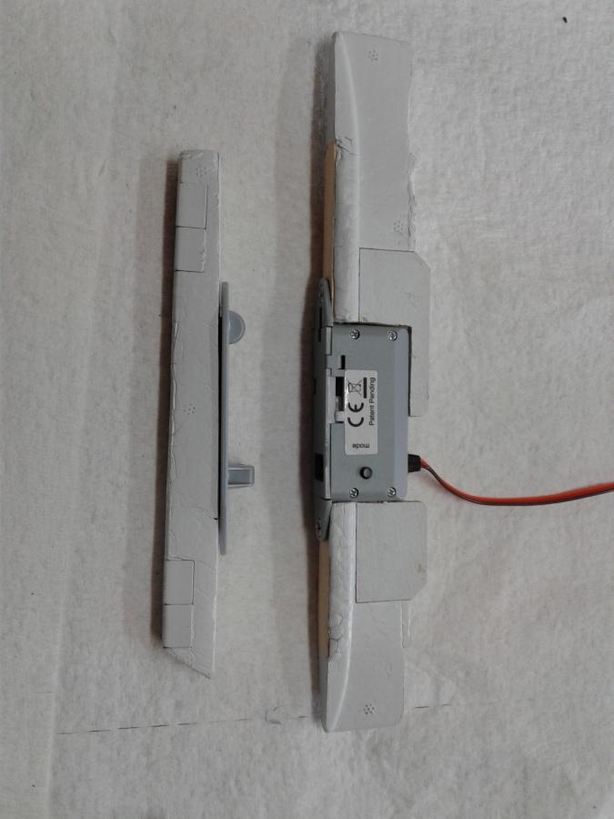

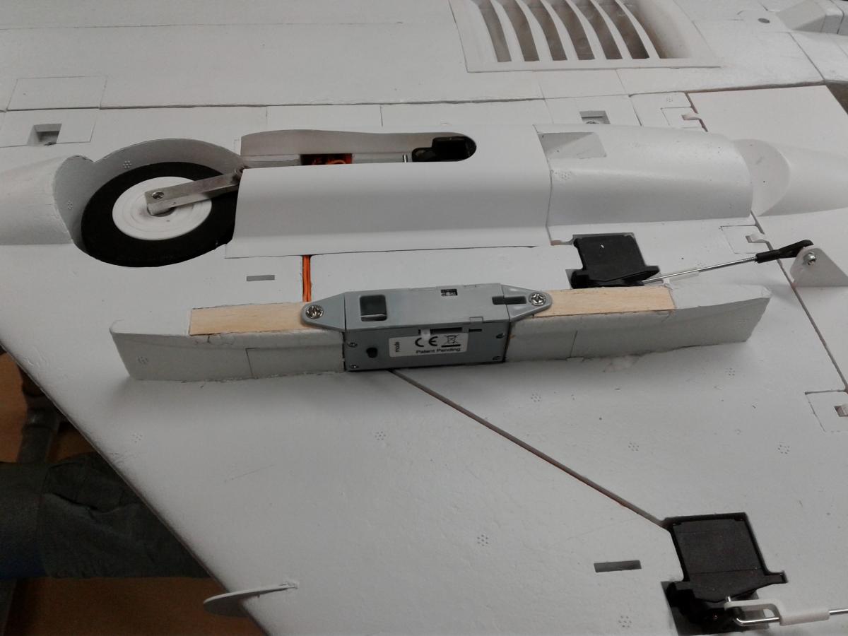

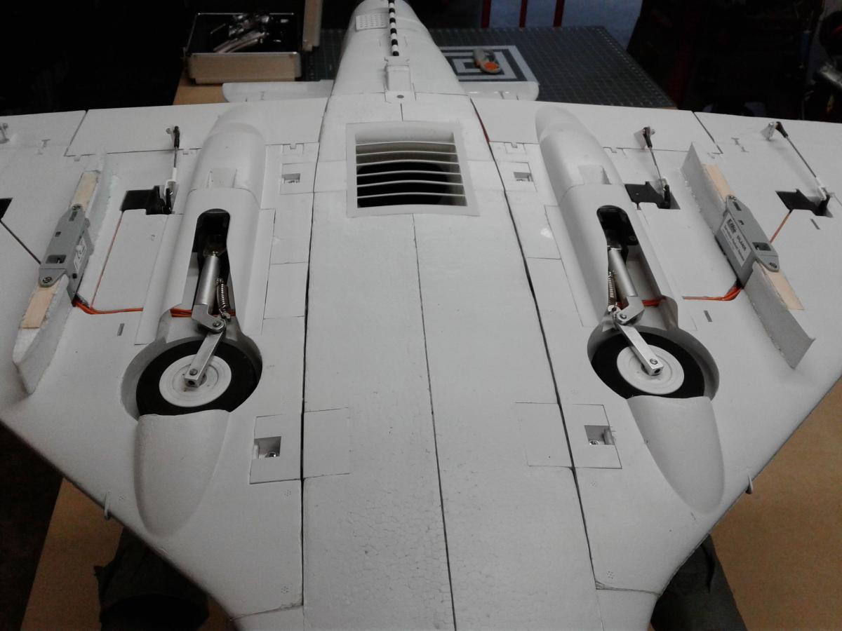

                                    My scoot can jettison ord now

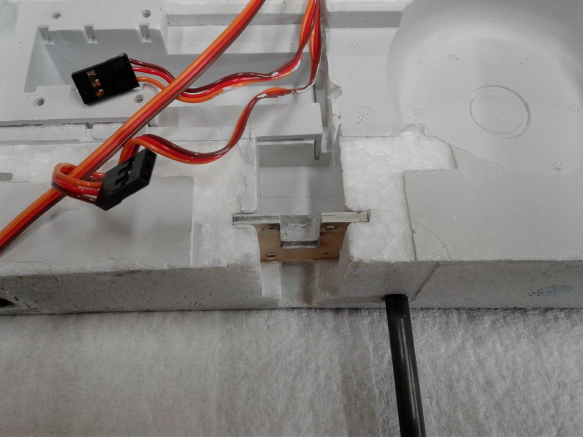

                                          The payload release units are just screwed in and therefore easily replaceable. They seem to be pretty nice. And they mount very close to the CG. The area where they mount is lined with 1/16 balsa (not shown). The screw mounts are 1/8" ply. I hogged out a small channel under the pcb in order to get the cable outside. A simple y connects the two units to the receiver.
                                          The payload release is programmable via a small pushbutton and led setup. You can daisy-chain other units and program the order of release.
                                          So far the only testing I've been able to do has been captive carry on the driveway.
                                          I'm gonna test fly this mod as soon as the rain quits here. If successful, then the little scoot is going in for a complete tear down, rebuild, and re-paint. She has acquired a bit of battle damage over the past six months.
