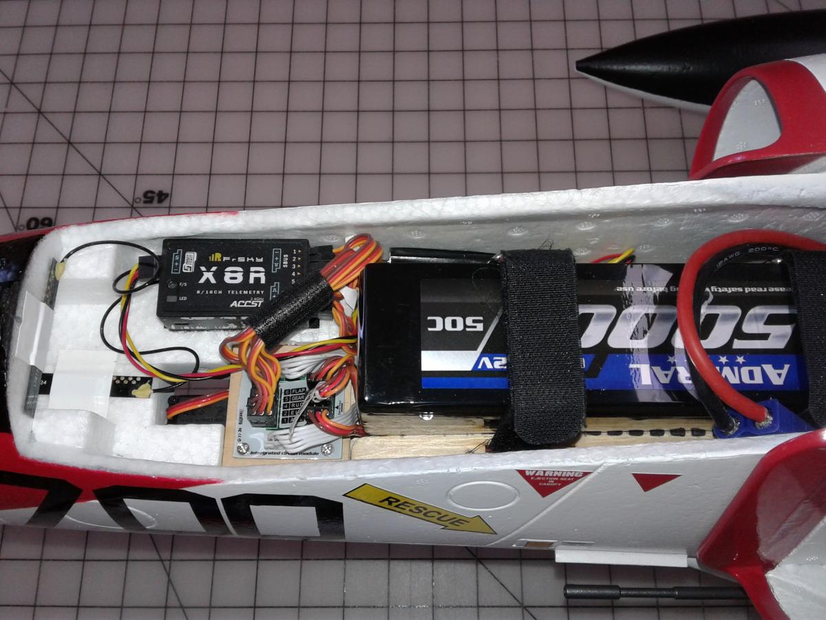

                                • seaviper, where are you measuring your 195mm CG from?
                                  • Actually if using the new Admiral 5000, you don't have to measure. Just push it up to the circuit board and go.
                                    Click image for larger version  Name:	20180314_145304.jpg Views:	1 Size:	138.4 KB ID:	122941
                                    If using the Turnigy 5000 brick, I move it back about a quarter inch.

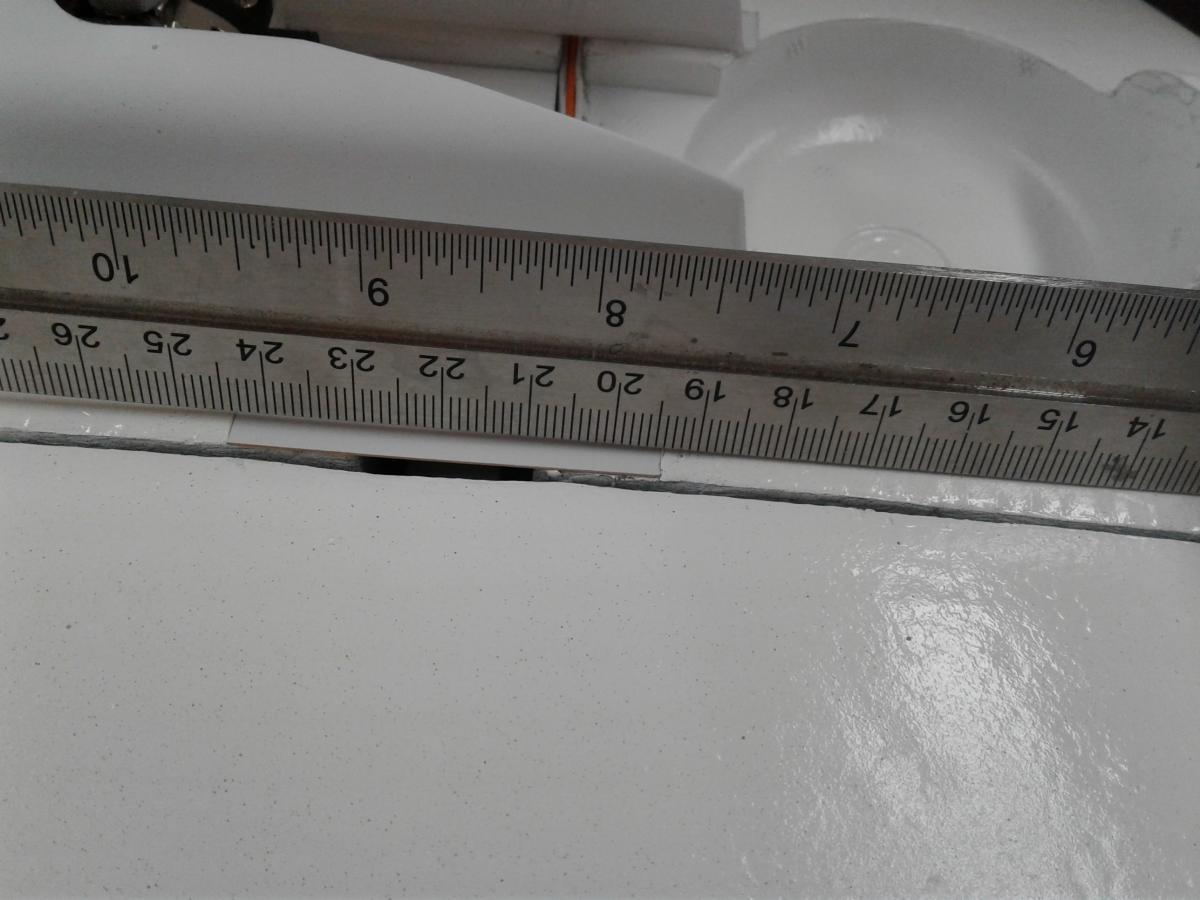

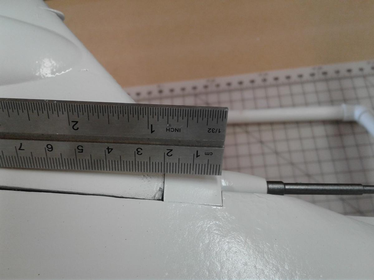

                                    The 195 is measured as in the photos. Same as in the update. BUT I get that CG wheels down. When wheels come up, the cg moves a little forward. Closer to 185 like Chris mentioned.
                                    Click image for larger version  Name:	20180314_144934.jpg Views:	1 Size:	91.8 KB ID:	122940Click image for larger version  Name:	20180314_144910.jpg Views:	1 Size:	72.2 KB ID:	122939
                                    If you set it up with 195mm and wheels up, then you may be a little aft when wheels down. This could lead to pitch problems at low speed.

                                    • Hmmm... I initially balanced mine at 195mm (with gear down as well) from the same point and nearly lost it on the first flight for being too tail heavy. Interesting.
                                      • Did you check you elevator neutral point? Was it level? What is your CG now?
                                        That sounds like it could have been a trim issue..just a guess. I assure you mine is not tail heavy. If anything it is a little bit nose heavy. I had moved the Admiral 5000 (newer lighter one) back a little some flights ago and she seemed almost perfect there.
                                        So, I don't think the bird is all that CG sensitive.

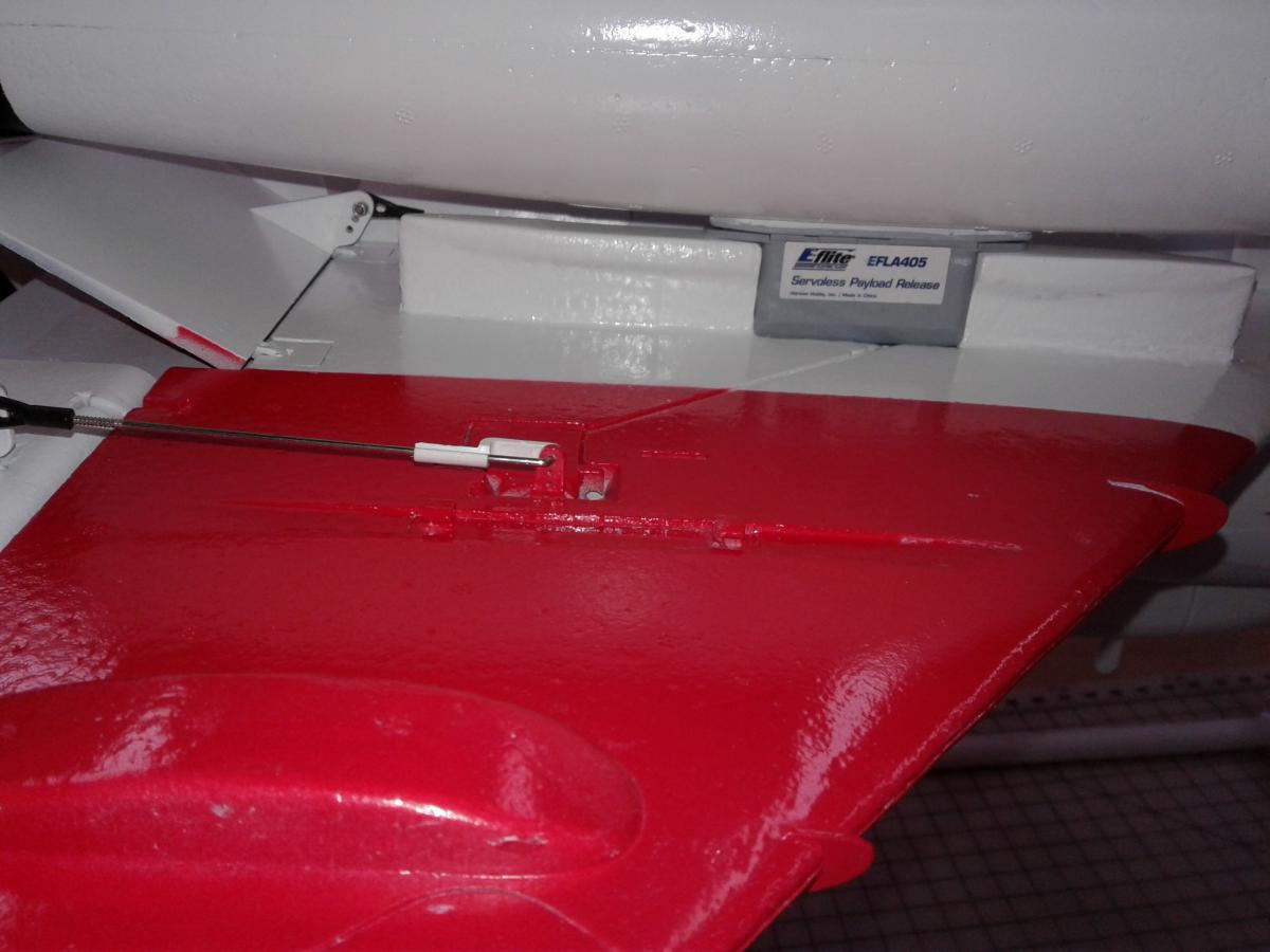

                                        Also she is very lightly wing loaded. So much so that I got the Turnigy just to give her some more weight. The payload releases added a little weight aft of the CG. So I moved my Admiral back up to the circuit board again.
                                        • I am at 180-185mm. Elevator is at neutral even at this point. At 195 it leapt off the ground almost straight up but I was able to get the nose down before it stalled. I believe you that yours is not tail heavy but I also know mine was. I just find it odd.
