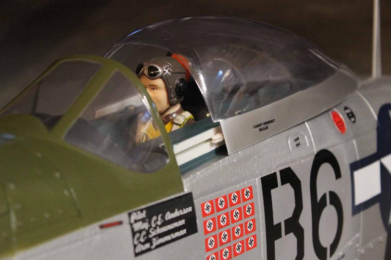

    How does the cockpit open on old crow 1400 p51
    • 7430
    It's tight, I usually use a flat head screw driver down near the base of the canopy to unlock the pins.
    Slide it in and twist.
    • Waldopepper
      • Mar 2018
      • 4
      • Baltimore Md
      Okay great that all it was just stubborn I didn’t want to force it
      thanks
        • 7430

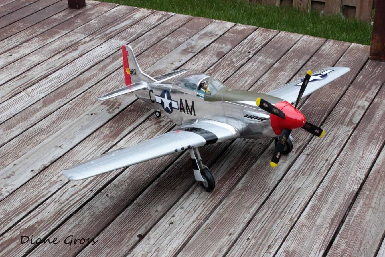

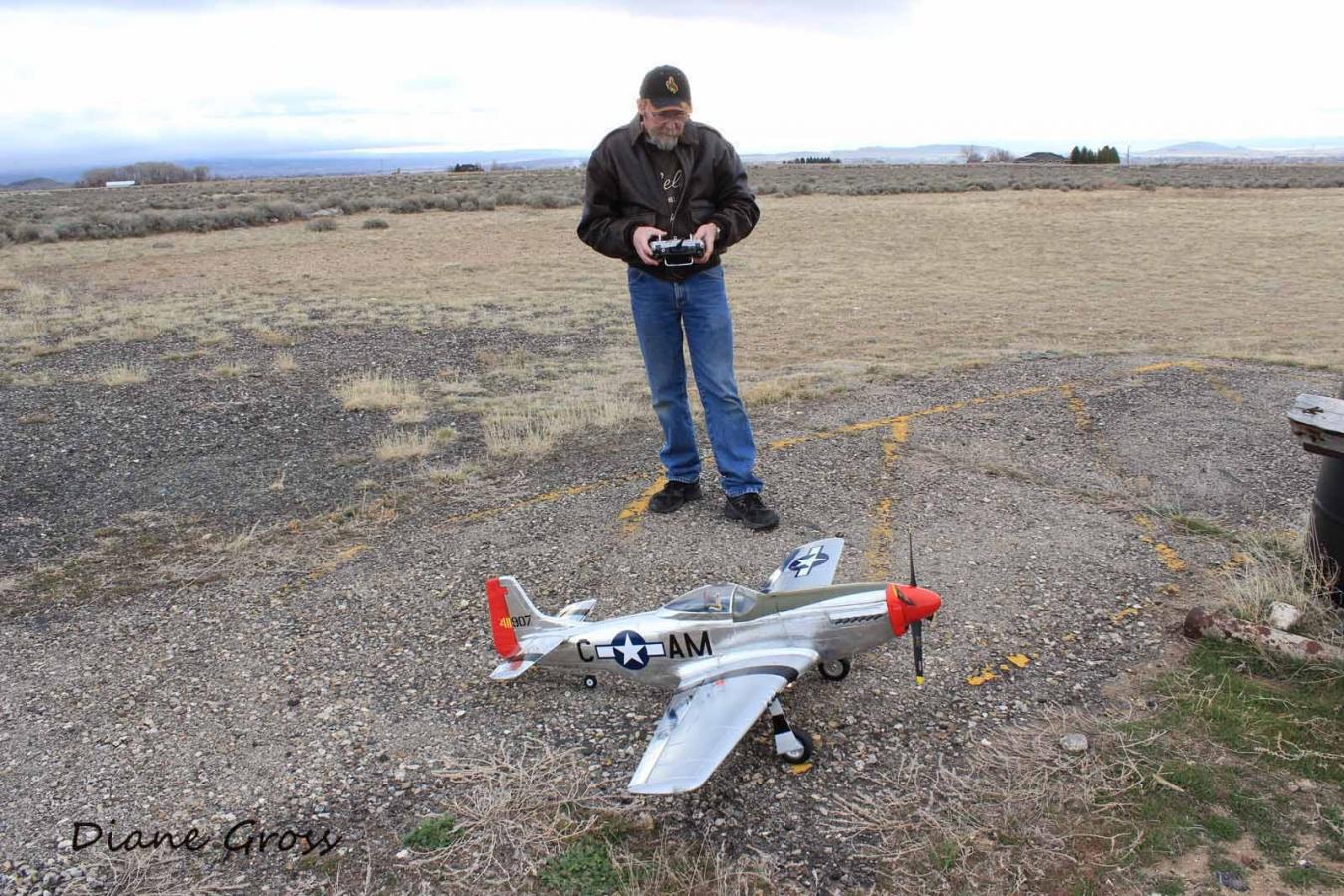

        they're pretty sticky, but it does look cool when they're open.
ID:	169028Click image for larger version
ID:	169029Click image for larger version
ID:	169030Click image for larger version
ID:	169031Click image for larger version

          Nice Picts, Gman. She looks beautiful!
          Woody

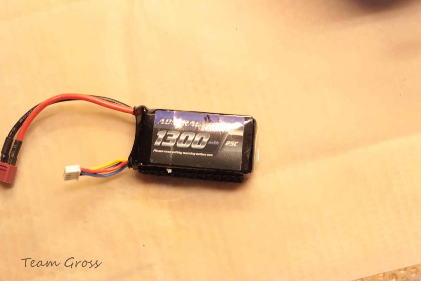

                Both my P-51's are originally 'Iron Ass' versions. My Little Gal II
                Click image for larger version  Name:	IMG_7047.JPG Views:	1 Size:	153.7 KB ID:	264137
                Click image for larger version  Name:	IMG_6934.JPG Views:	1 Size:	101.8 KB ID:	264138 was covered with Flight Metal everywhere but the wings themselves as the actual wings on a factory P-51D were sanded and painted. She was a rebuild of My Little Gal I (duh) who, unfortunately crashed. Shown above before the Iron Ass decal was removed and the 'My Little Gal' one was applied.
                I did all the extra riveting with a pin on both planes.
                Now, I had some success with with My Little Gal II until she augured in too. She spent the next year and a half in a junk box until one of the fellas here on HobbySquawk asked how the light and landing gear boxes were positioned on the wings. Click image for larger version  Name:	IMG_4050.JPG Views:	1 Size:	127.7 KB ID:	264139 I dragged out her wing and took a pic of it. I got to looking at the wings and decided that they were in good enough shape to at least attempt a rebuild. The fuse was a little rougher and the nose had to be realigned which involved removing the Flight Metal and literally staking the nose straight with skewers. Click image for larger version  Name:	IMG_4060.JPG Views:	1 Size:	134.5 KB ID:	264140 with the resurrection complete, I decided to repaint the nose in the way the original "Iron Ass' was painted. The wife asked me not to rename it My Little Gal so I didn't, but I still call her My Little Gal, simply because that's who she really is Click image for larger version  Name:	IMG_4102.JPG Views:	1 Size:	139.1 KB ID:	264141 Everything on that rebuild with the exception of some screws is original!
                What I ended up doing is permanently installing a 1300 3s battery where the speaker would be, under the battery hatch. This was the same battery that I use in Old Crow to power the sound system, which, BTW, I never use but you need the ballast so the battery is always in her as well. Also, I installed 5x1/4 oz sticky weight pads on the forward wall of the battery hatch as well. I run an Admiral 3600 PRO all the way forward, using a 650kv and an 85A Mantis ESC. This made her fly very well.
                Click image for larger version  Name:	IMG_4082.JPG Views:	1 Size:	148.4 KB ID:	264142 Also, note the difference between the stock prop shaft and the replacement one, can't remember what it was, but it was an FMS and bolted on and sucked that prop right back to where it should be. Check back through this thread as Charlie Brown (OV-10) was the one who recommended it if you're interested. Most of us agree that the CG is right on the aft end of the squares on the topside of the wing. Click image for larger version  Name:	IMG_6984.JPG Views:	1 Size:	138.7 KB ID:	264143 The extra added weight may have shifted it a bit but not much. I'm pleased with the way she handles now and have added some extra weight to the nose of Old Crow as well as she's been a handful. Hopefully this will tame her down a bit. She's a tough old gal and has had her share of incidents as well, such as wheels suddenly coming off on take off roll, so much fun!! Still in one piece though, after 6 years!

                  Wow! That was a lot of work but very well done. Let me see if I got it right
                  1.- Will have to add the 1,300 3S battery plus the 5x1/4 oz sticky weight pads somI get the right CG
                  2.- The condensed CG is located @
                  3.- Recomended to upgrade to a 650kv Motor and an 85A Mantis ESC.
                  4.- Power is from an Admiral 3600 PRO all the way forward
                  What are your experienced thoughts If I wanted to fly it with the stock motor,ESC and an Admiral 3,600 And the Four blade propeller set up after I add a MrRCSound V4.1 with speaker to the battery compartment and thinking to use your advised 1,300 3S battery set up? Will this (literally) fly well?
                  I can weigh the sound system and substracct it to the goal weight of the sticky weight....
                  Thoughts?
                  can you share the silver paint specs? Dis you use any kind of paint prep color beneath?
                  Thanks for sharing!
                  Stay safe!
                    • 7430
                    You got it, but the FMS 4258 650 kv motor is now a Predator motor and it has 4 mm wires. I used a ZTW Gecko 85 A ESC from Motion in the P-40

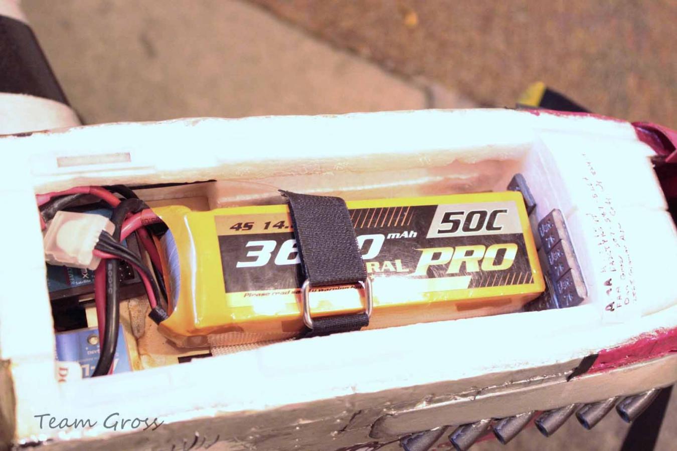

                      They say a picture is worth a thousand words, so here you go!
                      The battery in its flight position...
                      Click image for larger version  Name:	IMG_5139.JPG Views:	0 Size:	114.2 KB ID:	264334 The weights I added...
                      Click image for larger version  Name:	IMG_5140.JPG Views:	0 Size:	85.5 KB ID:	264335 the position of the receiver and the A3L. BTW, I extended the floorboard to include space for these...
                      Click image for larger version  Name:	IMG_5141.JPG Views:	0 Size:	56.2 KB ID:	264336
                      And last but not least, the same size battery that is permanently installed under the hatch floorboard, directly under the 3600...
                      Click image for larger version  Name:	IMG_5142.JPG Views:	0 Size:	56.6 KB ID:	264337
                      My theory is that the front speaker isn't there, so the added weight plus the small amount of extra weight from the bigger motor makes up for that. It mellowed her out and now she flies great!

                        I cannot thank you enough, these pics are MEGA HELPFUL🙏🏼, now, Remember I am installing the MrRCSound system in it so, I love your advice on the separate 3S pack . I plan to fly it it with the scale 4 blade propeller. Will I still need the extra weights? Where can I find them? Amazon? , thanks again

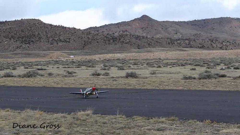

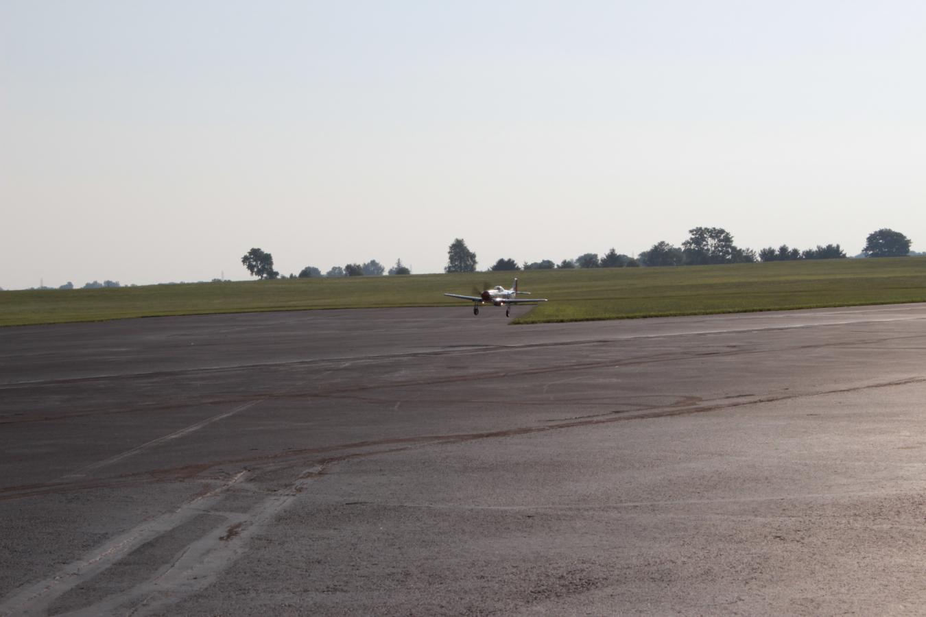

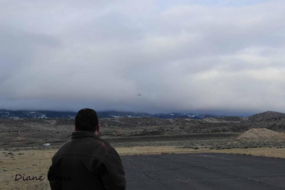

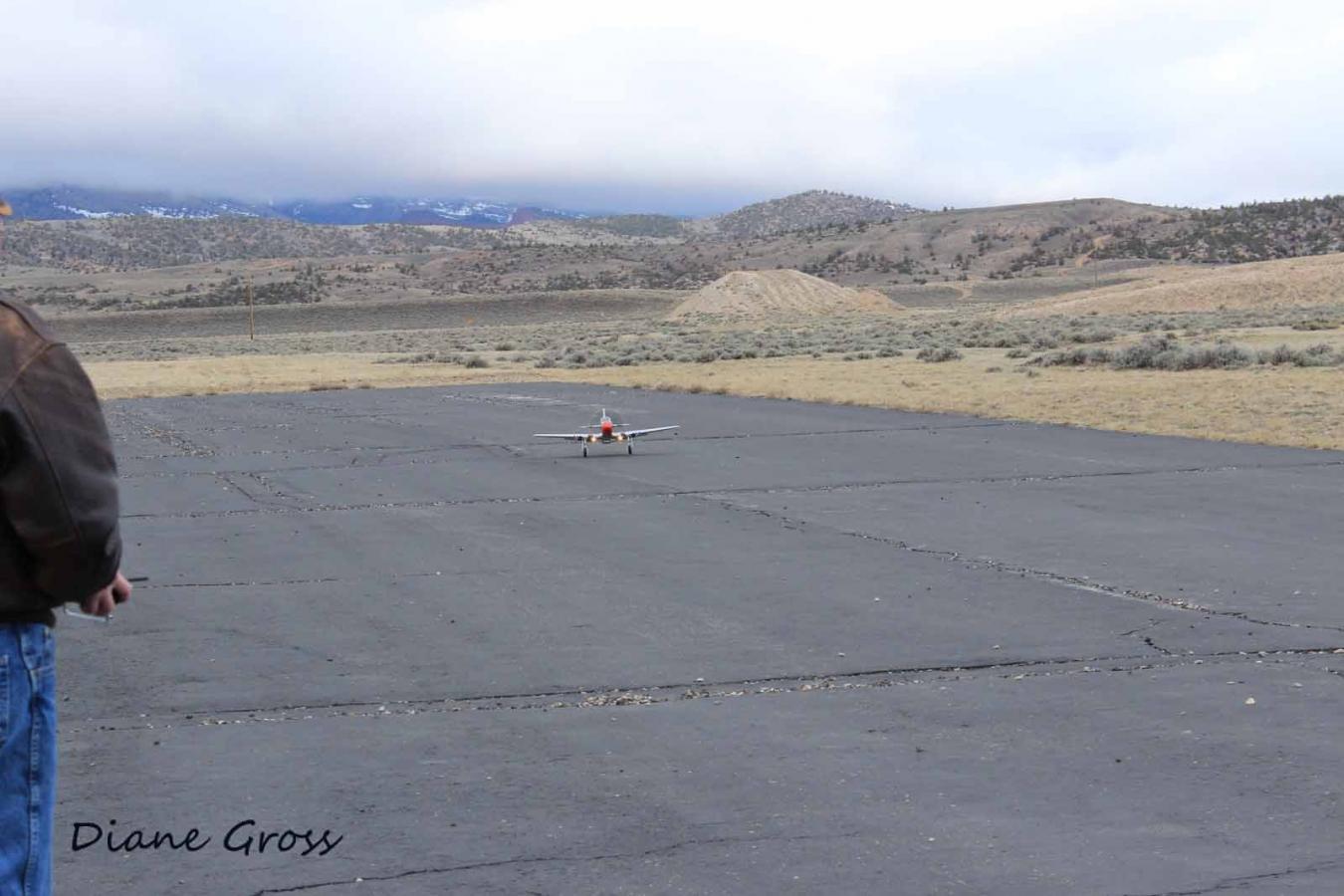

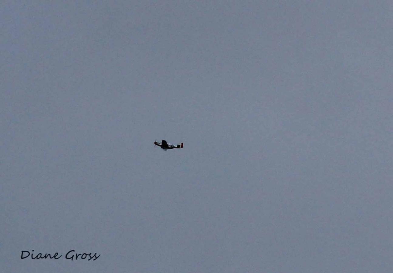

                                      I don't have any videos of her flying, but the wife is powerful deadly with the camera....
                                      Click image for larger version  Name:	IMG_9504.JPG Views:	0 Size:	156.8 KB ID:	265011Click image for larger version  Name:	IMG_9506 (2).JPG Views:	0 Size:	129.0 KB ID:	265012Click image for larger version  Name:	IMG_9507 (2).JPG Views:	0 Size:	104.5 KB ID:	265013Click image for larger version  Name:	IMG_9508 (2).JPG Views:	0 Size:	46.2 KB ID:	265014Click image for larger version  Name:	IMG_9510.JPG Views:	0 Size:	48.6 KB ID:	265015Click image for larger version  Name:	IMG_9511.JPG Views:	0 Size:	41.5 KB ID:	265016Click image for larger version  Name:	IMG_9519.JPG Views:	0 Size:	38.6 KB ID:	265017Click image for larger version  Name:	IMG_9521.JPG Views:	0 Size:	74.7 KB ID:	265018Click image for larger version  Name:	IMG_9522.JPG Views:	0 Size:	103.8 KB ID:	265019Click image for larger version  Name:	IMG_9523.JPG Views:	0 Size:	111.3 KB ID:	265020Click image for larger version  Name:	IMG_9526.JPG Views:	0 Size:	252.8 KB ID:	265021
