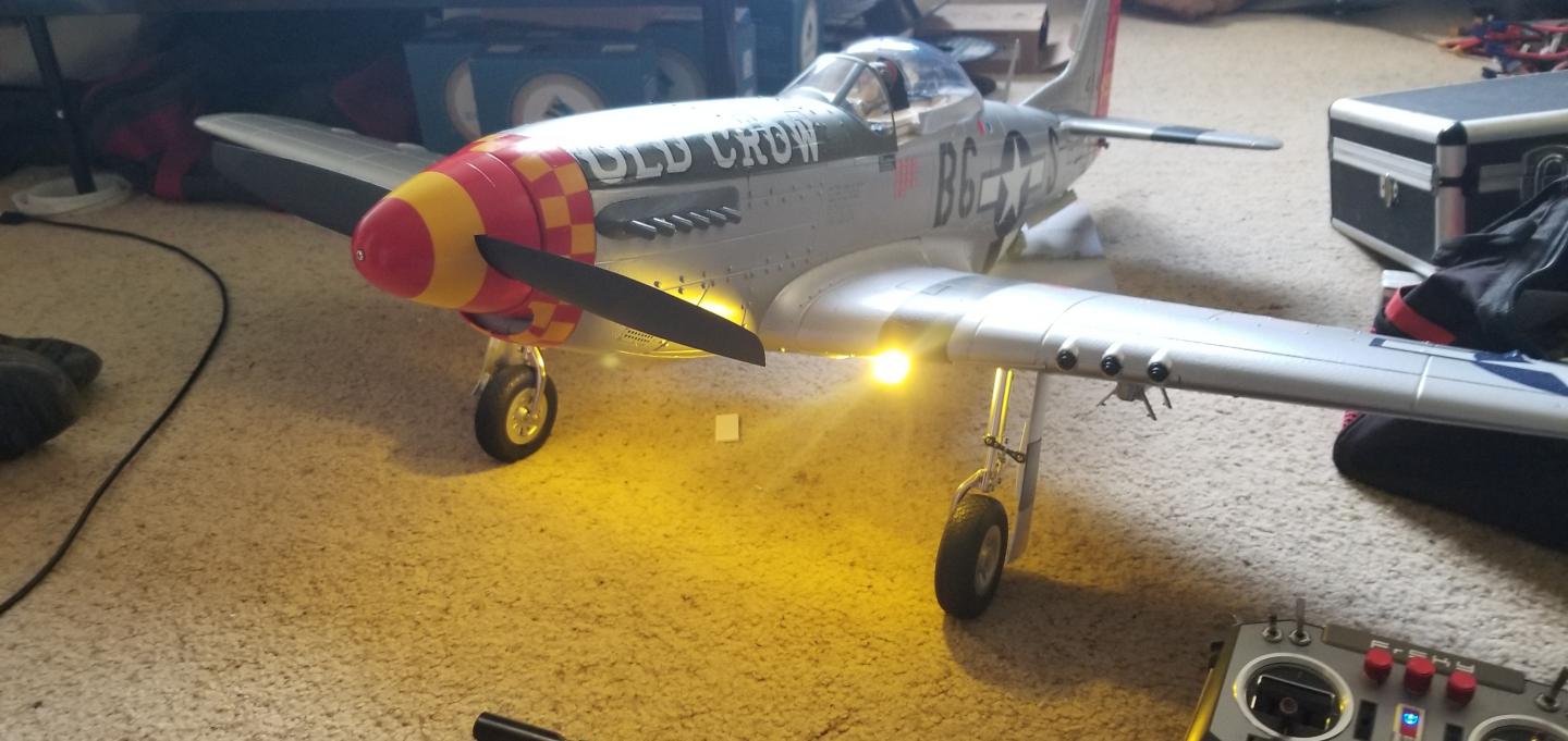

Well I finished her up, stabilizer is programmed, balance set, now just wait for the weather. This weekend is gonna be horrible unfortunately.
Freewing Old Crow
Seems like the 4500mah pack is a good pack for proper cg pushed all the way forward to the firewallComment
