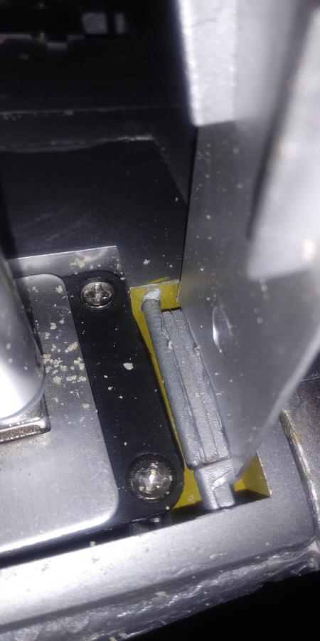

                  I know what you are saying about the doors. I figured out a way to repair my broken pins with a nail and a balsa block. Paint it all silver when I’m done and you never know the difference. It seems to work pretty well.

                    I see what you're saying, I'll try that! Last time I went looking for a door that still had the pin that I needed and actually found one. I cut out a square around the pin then used the cut out piece as a template to cut the door with the missing pin. Glued the cut out piece onto the gear door with the piece I just cut out and lo and behold it worked!
                    Hopefully you understand that! But when pins are missing, I like your idea !

                      This is my fix Click image for larger version

                        Looks good, I'll try that, I was downstairs cleaning up a bit and now have a big drawer dedicated to gear doors. I'm sure I can do the same as you did. What glue did you use btw.
                        • #92
                          Gorilla CA
