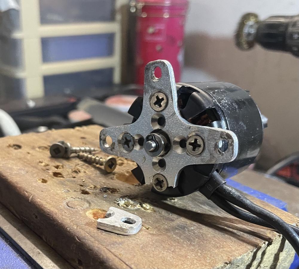

                                  #116

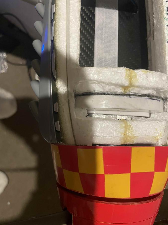

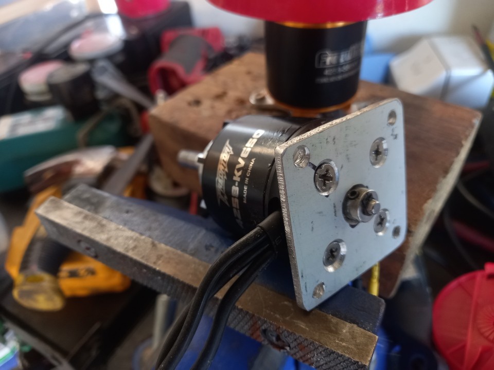

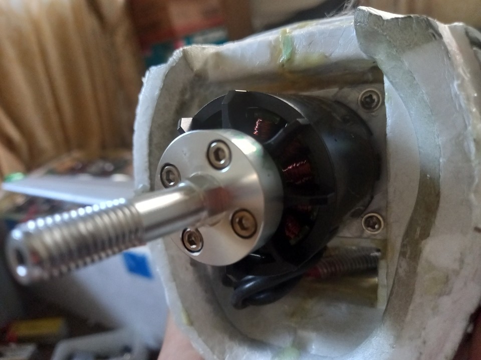

                                  Grossman, I follow your advise to replace the OEM motor with 650KV Predator motor. I run it on 5S from the very maiden flight. Very impressed with power and speed, but on the 5th flight all of a sudden the plane vibrates, battery hatch flew off. Went home and reinforced the firewall with gorilla glue. On the 6th flight, the X motor bracket loose. When I bench tested the motor, apparently the stock 2 bladed propeller flexes and vibrates so much on full throttle, and it managed to crack the X motor bracket (must be a brutal power). Has anyone had this experience? Going downgrade to 4s set up will suck, and slow. I'm thinking to try the 4 bladed propeller on 5S, since it's shorter blades
                                  • SanExup
                                    • 912
                                    • Western Wy.
                                    #117
                                    st3ntor Sir, looking at the motor mounting plate and the screws you used, to me that's the culprit. I would suggest buying a new plate, probably one that fits the motor. So that you don't have to drill it out. You'll probably have to do something to fill in the holes at the motor mount in the plane. And also check it for structural integrity and make sure it's still solidly attached to the fuselage. Your screws look big. My guess is that the plate cracked from over torqued screws. I'm thinking if you remounted the motor and assembly, In addition to balancing the prop, that you shouldn't have an issue.

                                      #118
                                      My buddy Lon Louvar ran his with the stock motor and 4 blade prop on 5s for years. I run both my FW P51's with the 650 kv a Mantis 85A ESC and four blade prop. I was never a fan of the 2 blade as its far from scale. Try it with 4s at first, then try 5s. My only concern is that the prop doesn't have the reinforcement like the 1600 mm Spitfire does, so I'd go easy on the power. My Old Crow is actually an Iron Ass that I converted and with my 4s setup she goes!!

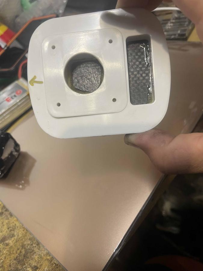

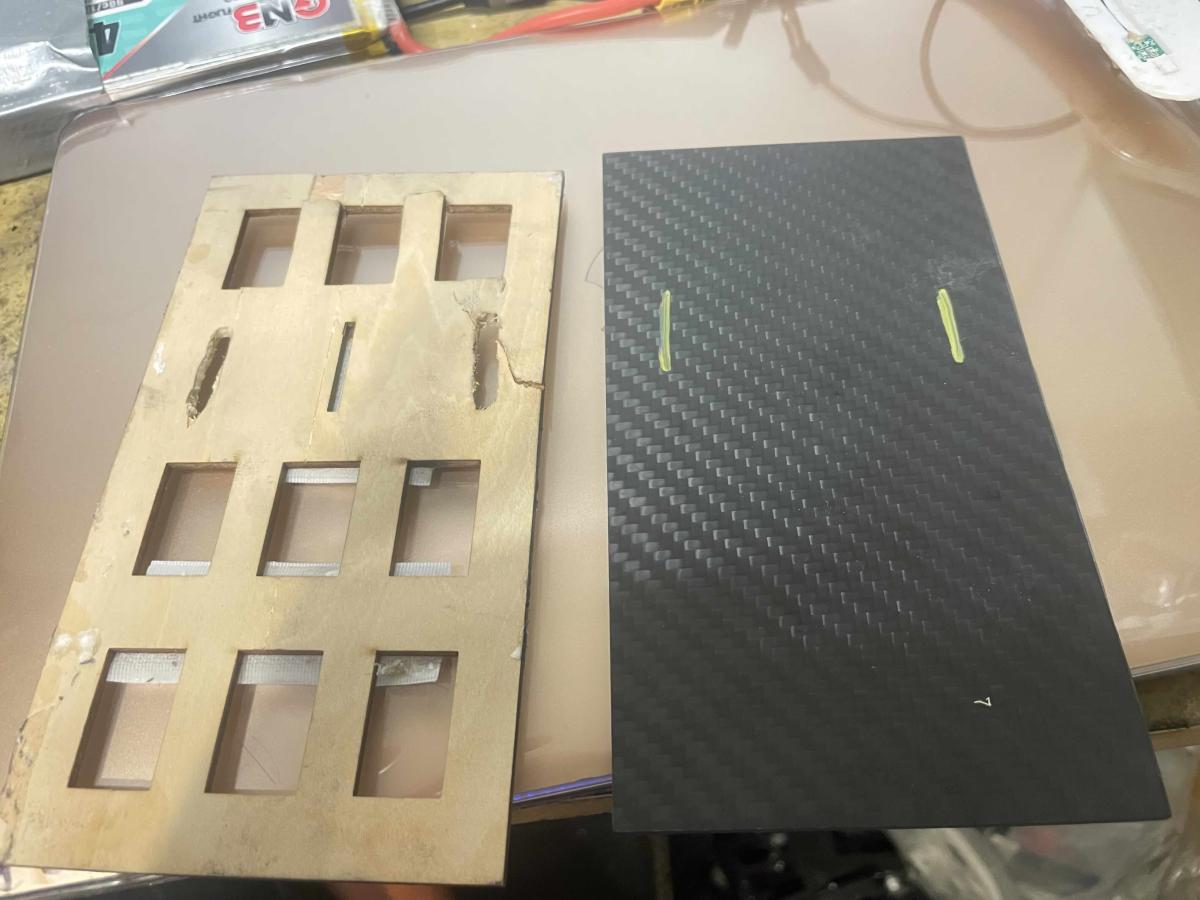

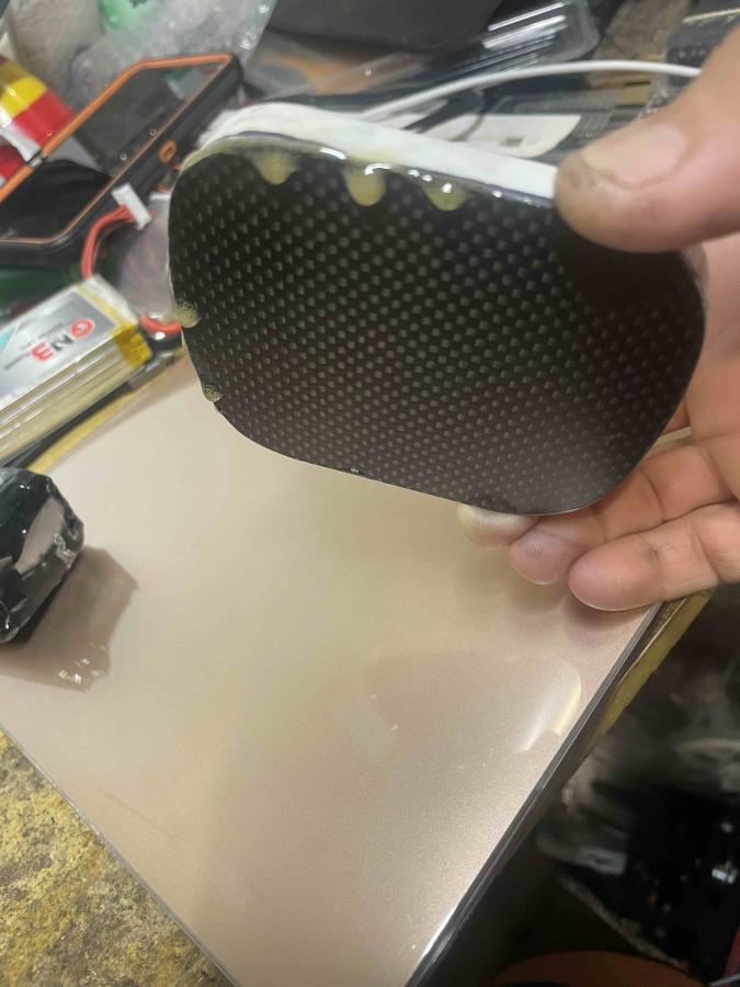

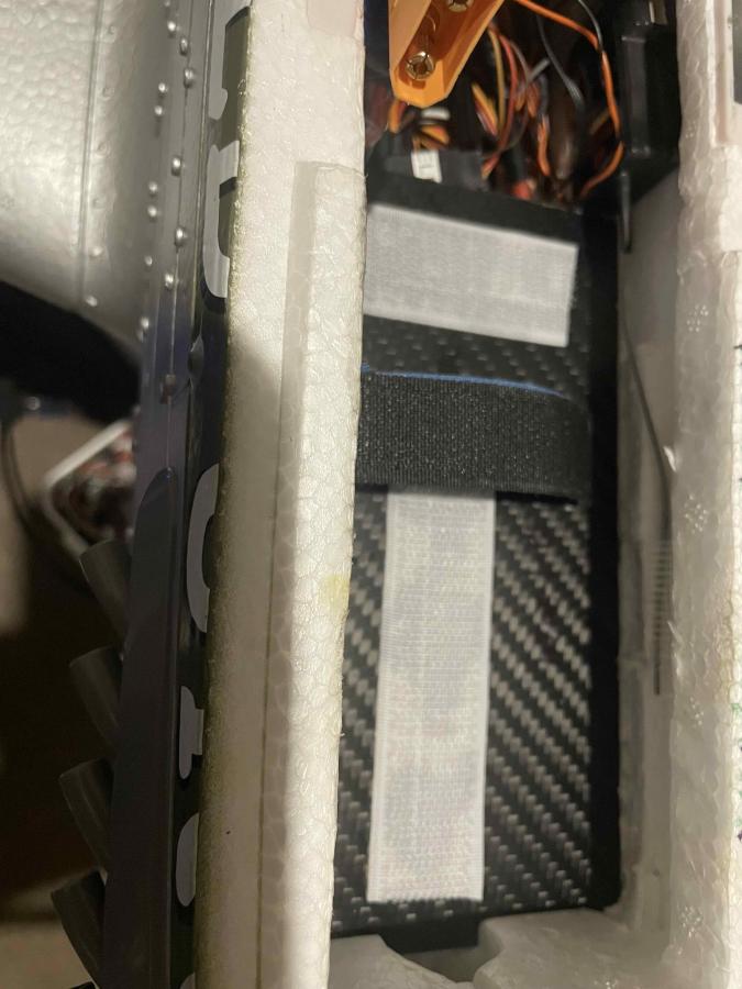

                                        #119
                                        Hi, Peeps. Happy new year...happy flying and all that happy thing for you all first of all.
                                        A bit update of my previous flying mishap.
                                        Grossman, I tried flying it with 4s, and swapped the motor back with original freewing motor and its mounting. No luck, the motor was still vibrating in the air and made an emergency landing.
                                        Out of desperation, I made a few modifications and I have had successful flying at least 6 times.
                                        First I made my own motor mounting with square shape instead of typical cross shape.
                                        Second, I gorilla glued a 0.5mm carbon fiber plate on to the firewall and shoved it into place, just to make sure the firewall has more surface to grip on the foamy.
                                        I found the battery mounting balsa plate apparently has cracked from the propeller vibration. I think this the main cause why I could not get rid of the vibration after initial repair.
                                        So third modification was replacing it with 3mm carbon fiber plate. I sanded the bottom plate and epoxy glued it on the foamy.
                                        So far so good, no issue with vibration anymore, but I'm also more careful on the throttle. I don't do sudden throttle up, I just gently increase the throttle.
                                        But next issue, I have a faulty port side retract. Jesus...this hobby is a money pit and time consuming to repair...happy days 😖😖😖😢
