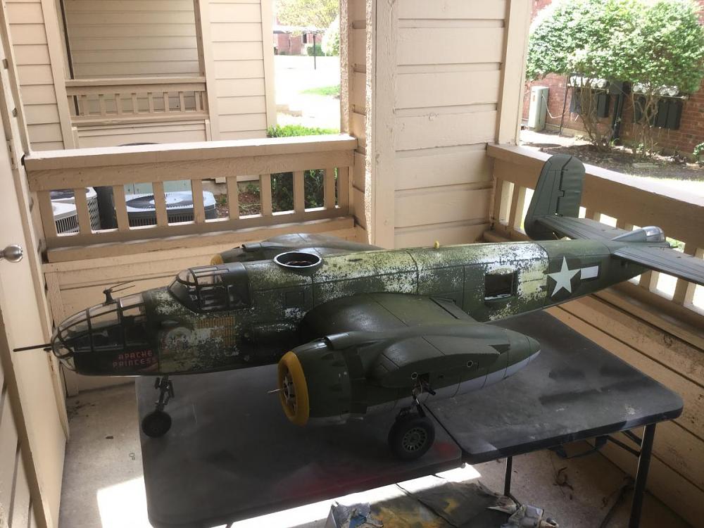

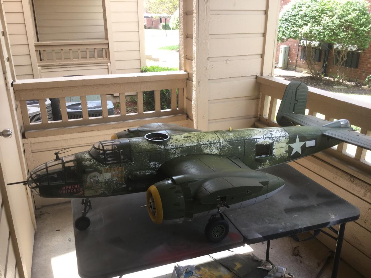

    Over the last few months or so. I’ve been working on a complete rebuild of the LX 2M B-25. I got this from a friend about a year ago, and it was in pretty sorry shape. Paint was flaking off, guns broken, stripped servos, and surfaces damaged.

    I’ve since cut off the chin gun pods, filled in the surface damage and panel lines, and smoothed the surface out with some high build primer.

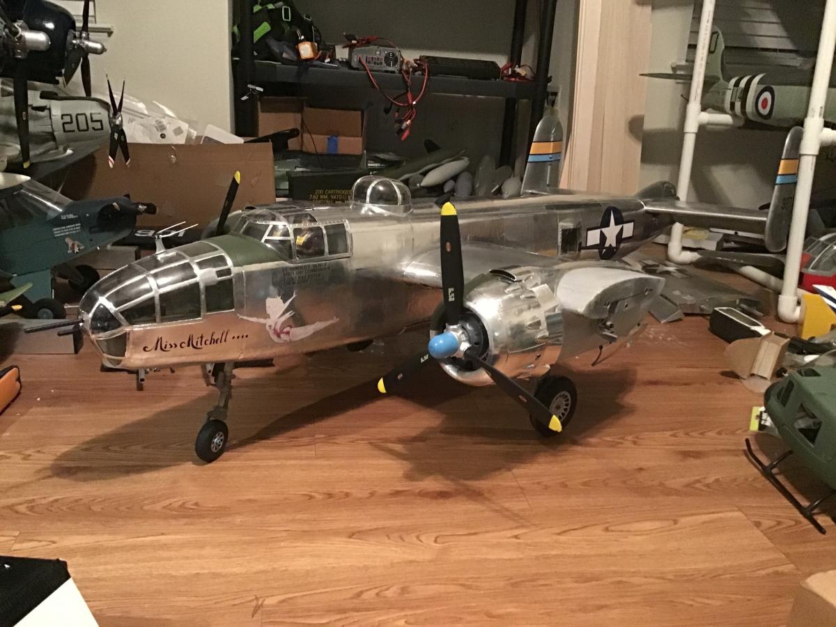

              One more photo indoors with a bit better lighting
                • 2818
                • Arlington, TX
                More progress; top and sides of the fuselage are covered, still need to finish the bottom. Then it’s on to the nacelles and center wing section!
                  • 2818
                  • Arlington, TX
                  Still more progress. It is going slower than I predicted, so it won’t be ready for this weekend. Still probably 4-5 more days of effort to go.
                    • 2818
                    • Arlington, TX
                    Nose Art is on! Getting closer..

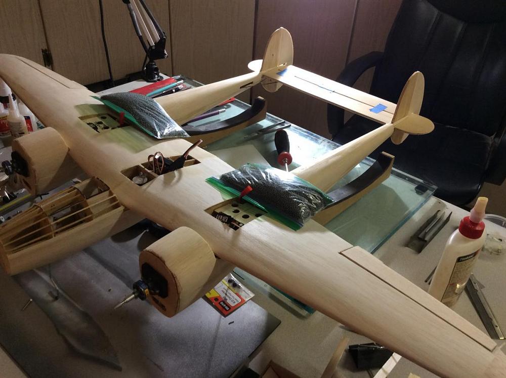

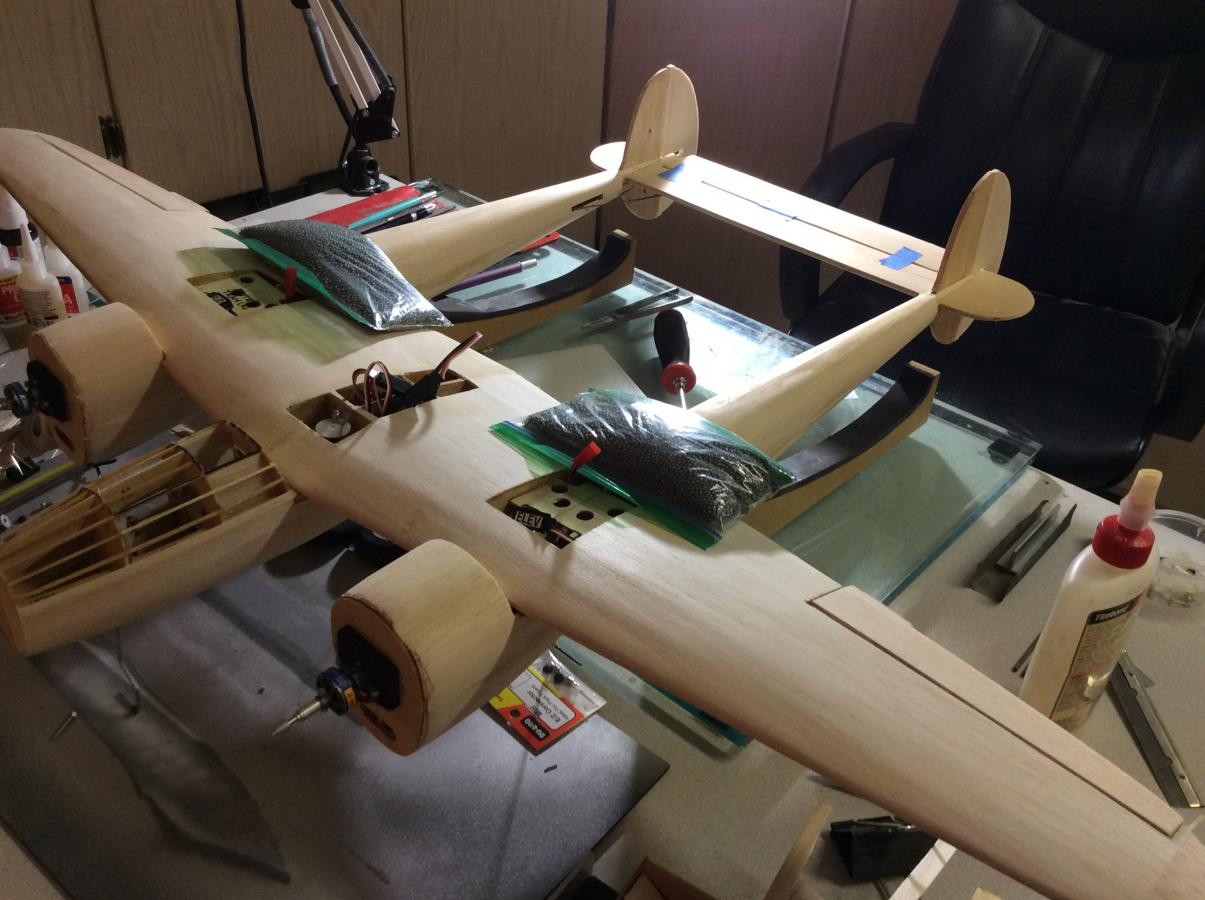

                      looking good, may consider the same technique with a P-38...

                        Very cool! Is that the Guillows P-38 kit?
                        • F22trainer
                          Piper PhD
                          • Mar 2018
                          • 1484
                          • Sun City, Az
                          Yup! She flew...briefly.

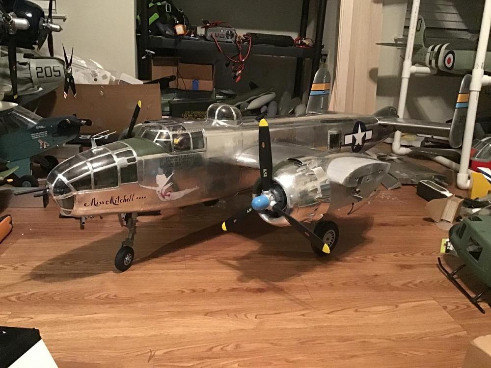

                            Update: Fuselage is finished and graphics applied! Still have to finish the bottom of the nacelles and right outer wing panel.
