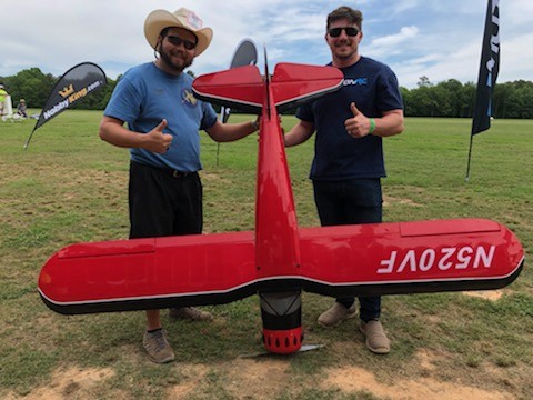

        Absolutely loved flying this beautiful model at Joe Nall this year she was an absolutely beautiful flyer. Guys that enjoyed the videos from Nall ( I was The Pilot) amazing experience and a big thanks to Motionrc for the opportunity we did shoot a video with the model at Nall check it out. https://youtu.be/-LrT16kkuJg
