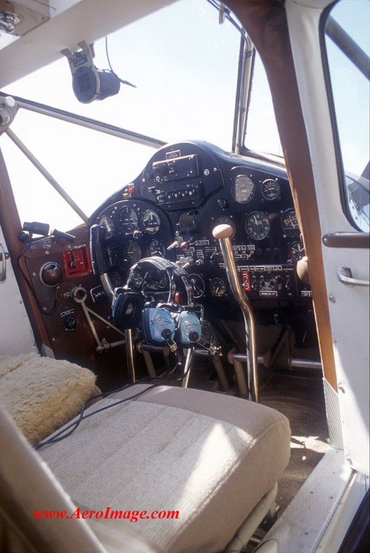

            I don't plan on doing any dress-up of the interior, since it is not all that visible without close-up scrutiny. I do, however, plan to get Callie to make me some registration numbers for it. I didn't much care for the semi-translucent, italicized decals that came with the kit. And the pictures show them incorrectly applied, with numbers on the fuselage sides AND the rudder, and the wing decals on the wrong side. I was relieved to find that they were not pre-applied.
            By the way, I tossed the seats in my scrap bin. The floor is too high in the cabin for them. They didn't look right all perched way up high, and they seem too small for the scaling anyway, so I didn't bother to mount them. Look at an interior shot of a full-size Fairchild and you will see what I mean.

                                      Hi Guys, New to Squawk but have recently coming to the end of my build of Fairchild 24 Argus and was wondering if anybody has any photos of inside the cockpit, so I have some reference where to position Esc, Bec and Receiver and batterie packs. I'm new to the hobby and was hoping for some advice. Maybe Alpha can put me straight
