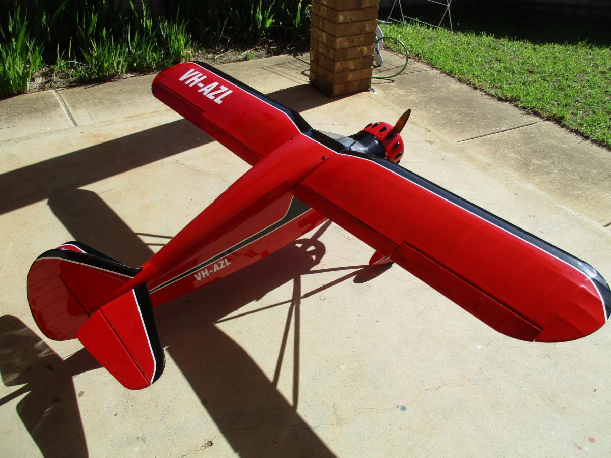

                    Here's my Fairchild
                    Just need the model club to open now to maiden it :(
                    must of been a Friday build - missing 2 of the strut attachment pins and the Rudder was bent - had to fix and recover
                    using Hanger 9 True RED covering HANU866 which matched
                    Powered by Eflite power 160 on 10s 5000mah
                    had to add 8 ounces of weight to get the CG right,

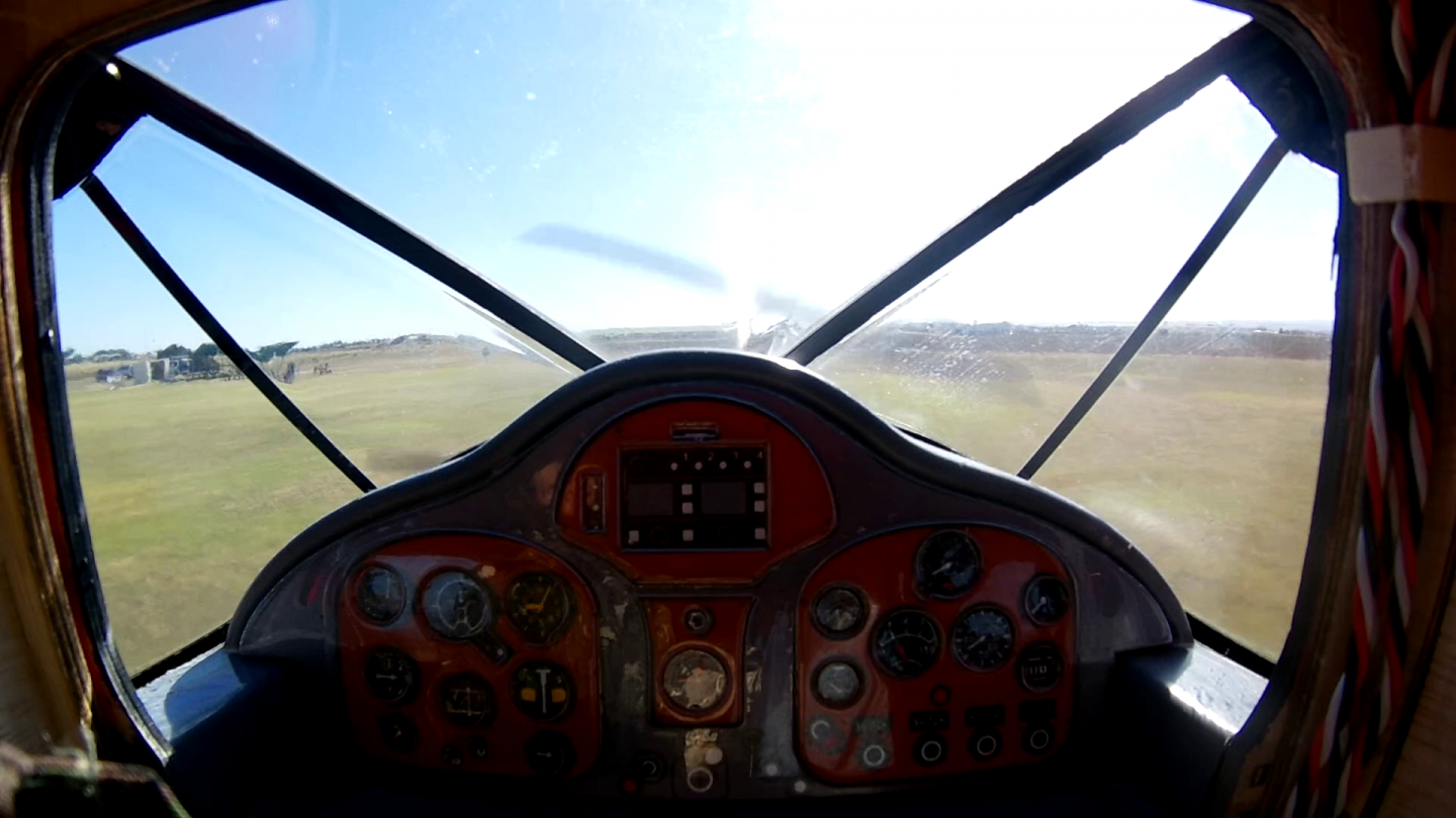

                              • #75
                                I made up a removeable mount for a Runcam behind the Seats looking over the pilots shoulder on my fairchild , just a light ply box bolted to the cockpit floor which the suppled runcam mount Velcro's too. only a single bolt so it can be rotated.
                                heres a screen shot
                                Click image for larger version  Name:	vlcsnap-2020-12-18-08h31m47s707.png Views:	0 Size:	1.05 MB ID:	290708
                                • #76
                                  heres a screen shot
                                  Looks good. But you will definitely want some kind of dampeners to minimize the shake/vibration. We mounted a go pro in the same spot a year ago but the Go Pro 7 has built in stabilization which you can see in this video.
