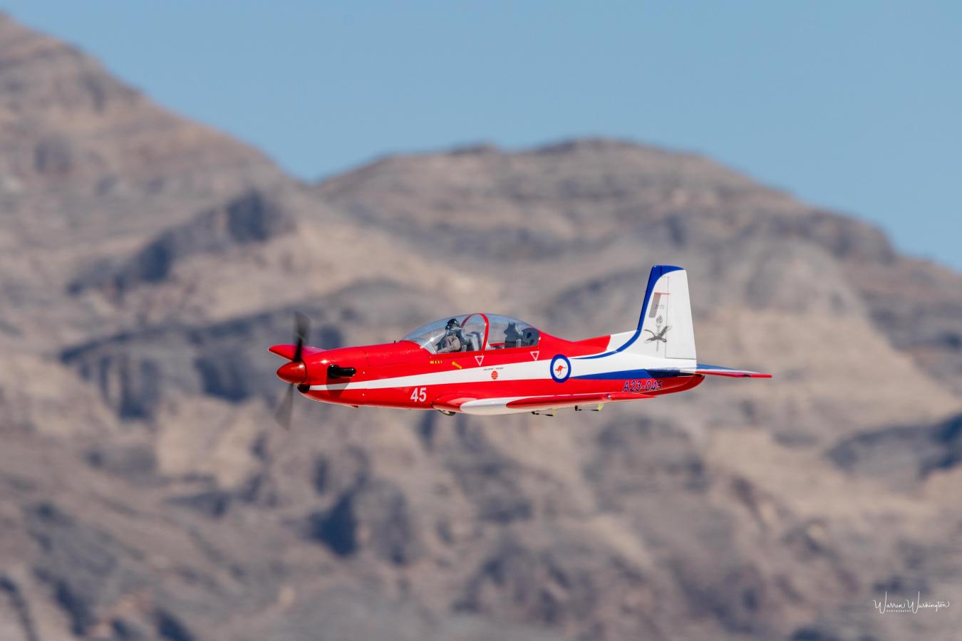

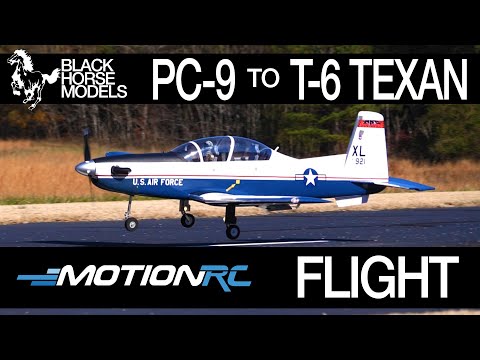

            Pilot Patrick Croasdale whose a member of my club converted his PC-9 to a T-6 Texan and it looks absolutely gorgeous. Check it out.

              I'll quote myself from May, but I still think this PC-9 should be offered as a Texan out of the box . Patrick's conversion shows why, the look is outstanding and I would hope it would sell well (maybe the current and only livery it already comes in has sold well too) in the US.
                Wow, that certainly looks spectacular, a very well done covering job indeed.

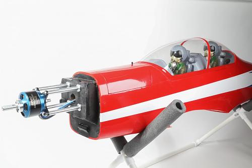

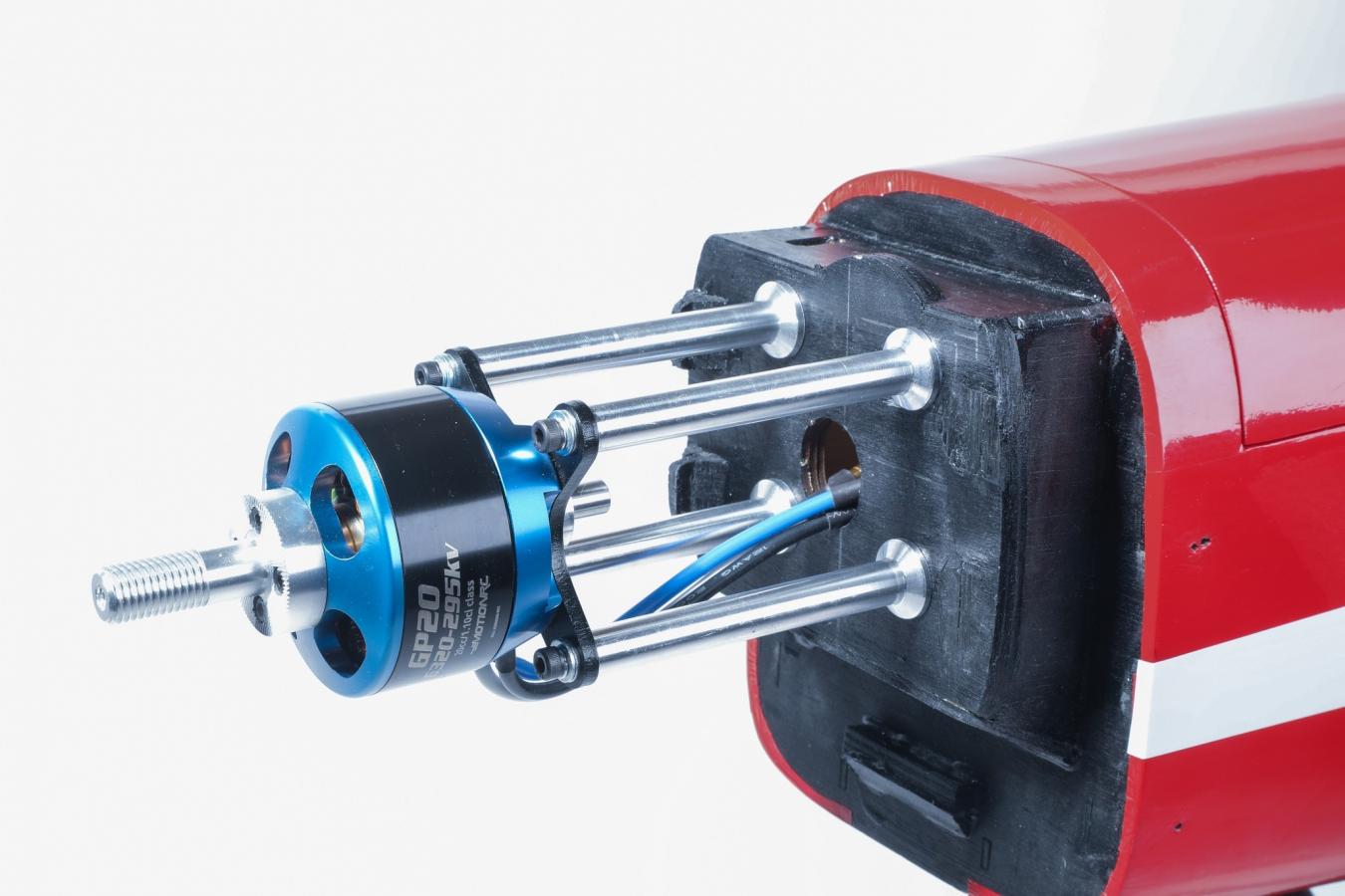

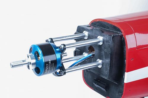

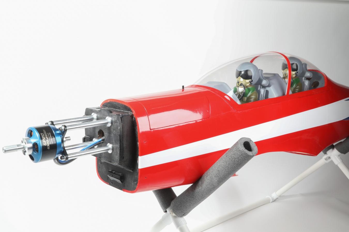

                My PC-9 is coming along pretty good. I tried to find longer bolts and nylon standoffs blah blah blah but after a long search on Google I found "SteveT" on RCGroups who makes custom aluminum standoff's so I'd like to give a shout out to Steve and show off my mounts :)

                  Canada Goose Hi Mike, nice photo! Are "SteveT"'s mounts custom machined to a specific length and tapped with your specified thread? If so, I need to contact him...

                    Yes, they are completely custom. I gave him the desired length and the thread size needed. He uses aluminum stock and turns it on his lathe. In my case the length was 83mm and the thread size 4mm. His product is excellent. Please tell him Mike from Canada referred you as it will put a smile on his face! His email is Draknkep@pacbell.net
                    A tip for anyone putting together the PC-9 is that there are some small vertical and horizontal marks on the firewall to help with aligning your motor mount. They are quite hard to find due to the black paint and they are quite short but if you have a good light source you will find them etched into the wood. Using a ruler and a pencil between the marks will greatly help.

                              Had a chance to get mine out again along with Patrick Croasdale who reskinned his to a T-6 Texan II which is the aircraft he trained in (He flies C-130's now!) They really looked stunning together

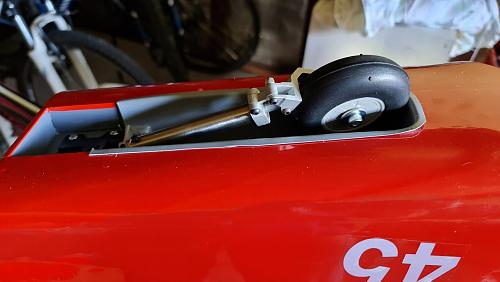

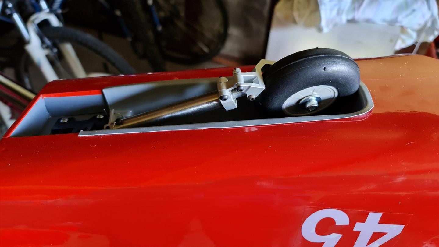

                                        Hi everyone. I got aot of work done on my PC9 yesterday but have a couple of minor issues I'd like to check with the brains trust.
                                        The mains wheels rub on the strut (stock wheels and struts) did anyone else experience this?
                                        My nose gear strut seems to be too long so the nose wheel hits the plastic wheel well (doesn't just rub - it won't fit in the space provided) I'm using the motion rc recommended and supplied electric retracts. Any tips from fellow owners would be appreciated

                                          Wow, very quiet in here, no responses in 4 months.
                                          Anyway I worked out my issues and bought slightly smaller wheels.
                                          She's all done and ready to maiden this weekend hopefully.
