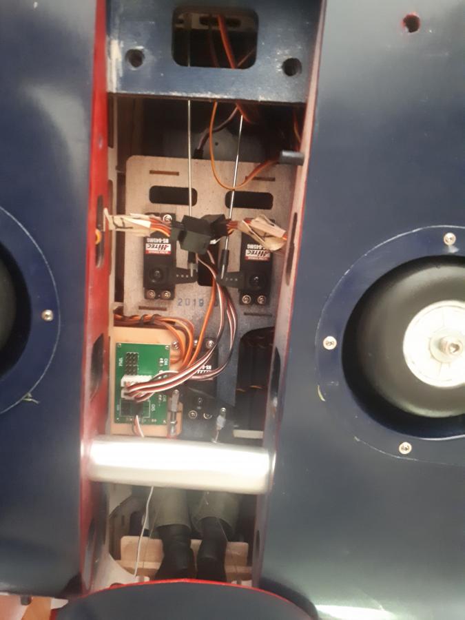

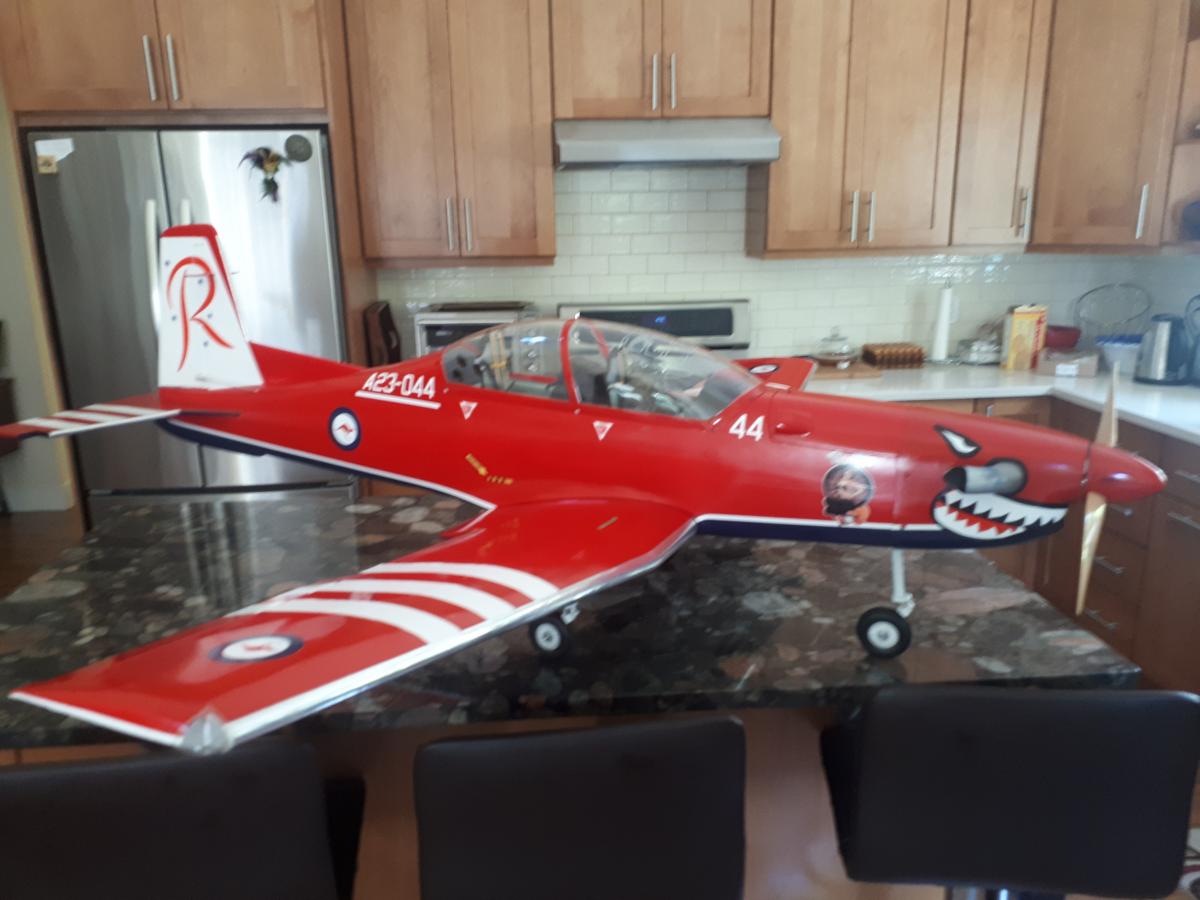

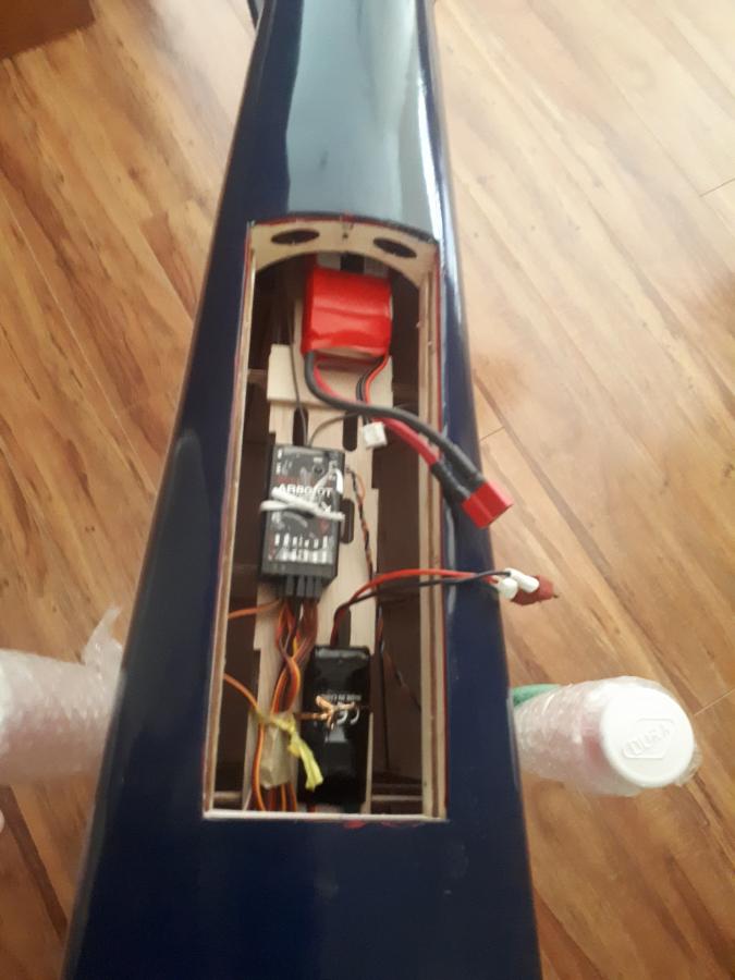

                        Here is my PC-9 from motion rc I added an FMS multi plug connector to cleannup the wires. I needed to add ply battery trays aft of the supplied trays to get the cg correct with 10cell 5000 and rimfire 1.60 and electrifly 8amp esc 17 x 10 to 18×10 prop.
                        Please update the hardware package to get the best out of this fine model.
