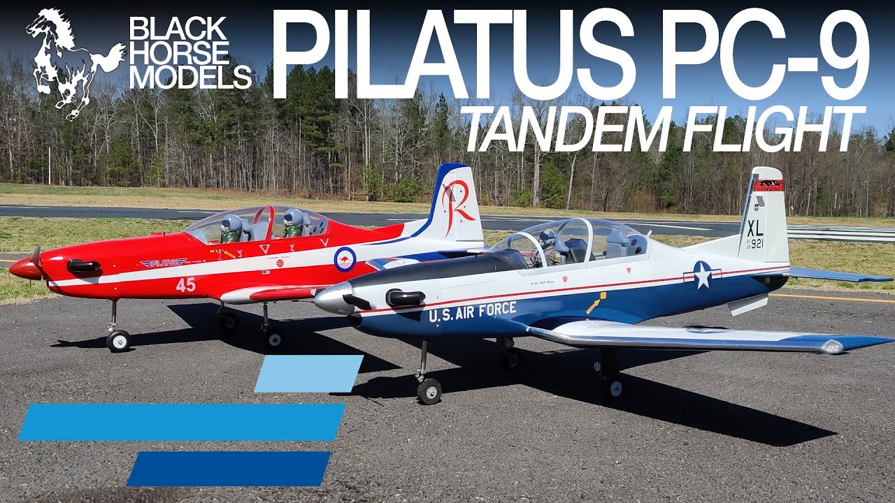

    Hey Dogbait, Welcome to HobbySquawk by the way. Our PC-9 is back in stock too!
    Had a chance to get mine out again along with Patrick Croasdale who reskinned his to a T-6 Texan II which is the aircraft he trained in (He flies C-130's now!) They really looked stunning together

    Also, I agree, the Texan II livery is solid!
