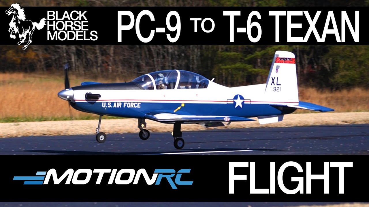

    Pilot Patrick Croasdale whose a member of my club converted his PC-9 to a T-6 Texan and it looks absolutely gorgeous. Check it out.
    Wow, that certainly looks spectacular, a very well done covering job indeed.

    I've always loved the PC-9, so this is fantastic to see. Although T-6A Texan II derived from the PC-9 and there are many differences between one another, are there any plans to offer this PC-9 in the color scheme of the T-6A Texan II?
    That would be the ultimate for me. It can always be recovered in that color scheme, but of course it would be better to have it already covered in the T-6A scheme from the factory to eliminate tearing off the beautiful covering job they did on the current color scheme.
    I'll quote myself from May, but I still think this PC-9 should be offered as a Texan out of the box . Patrick's conversion shows why, the look is outstanding and I would hope it would sell well (maybe the current and only livery it already comes in has sold well too) in the US.
  • James
