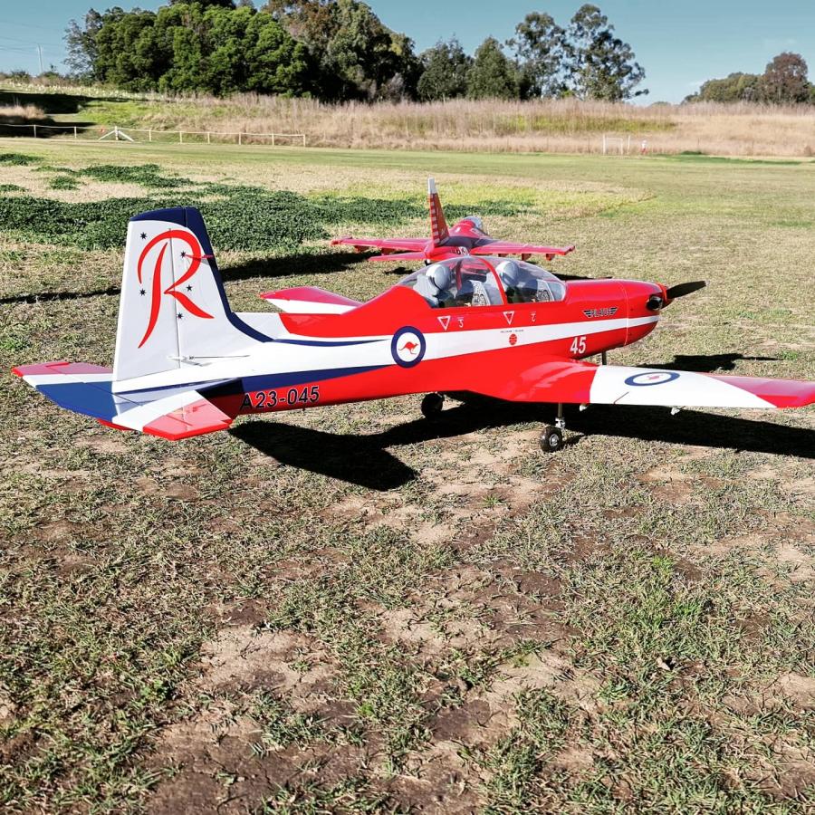

    The maiden went very well. She flies beautifully scale like and was just like watching the real ones at airshows in previous years before they replaced them with the Pc21.
