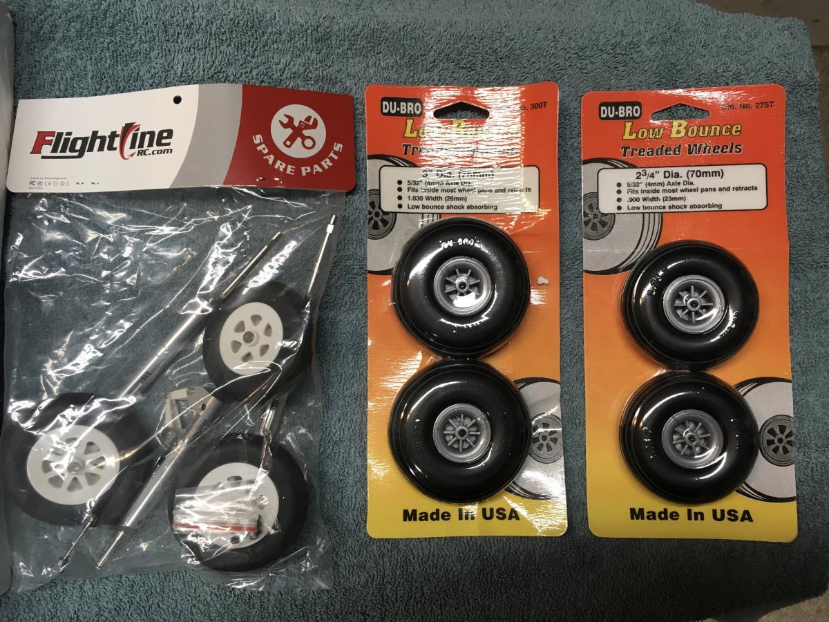

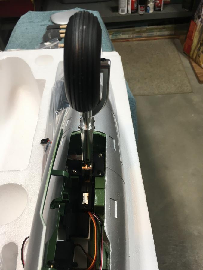

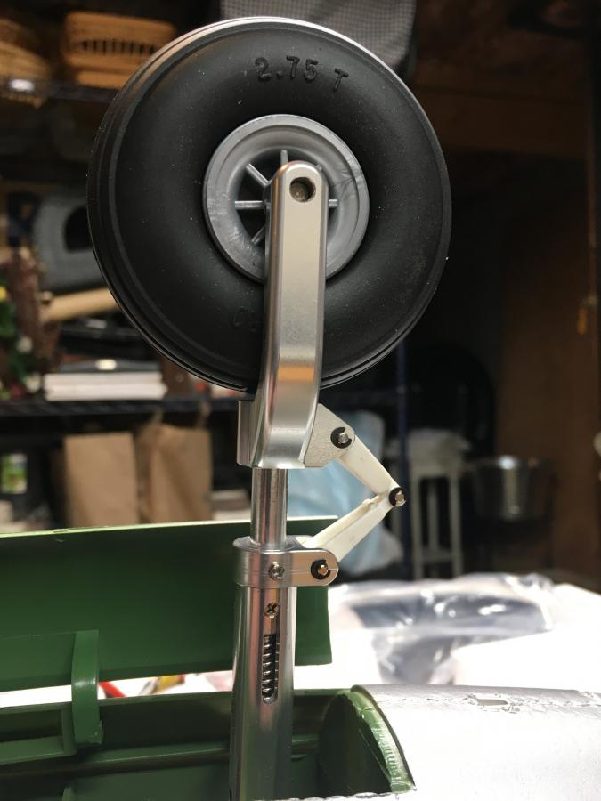

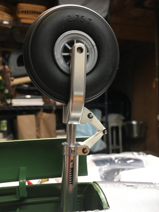

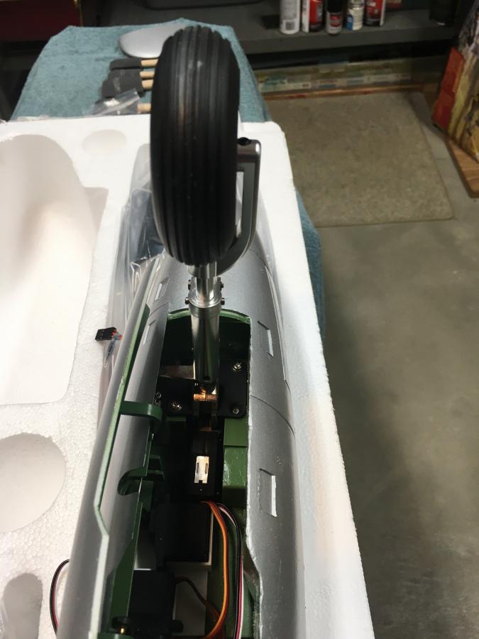

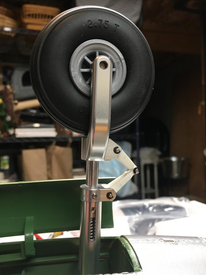

    I've installed the strut upgrade and Dubro wheels on my P-38. Has anyone else had an issue with the nose wheel hitting the gear door hinge at rear of the door?. It is not allowing the gear door to close completely. Is there a simple solution without sanding on the hinge?. The mains are closing properly without interference. Thanks for any suggestions.

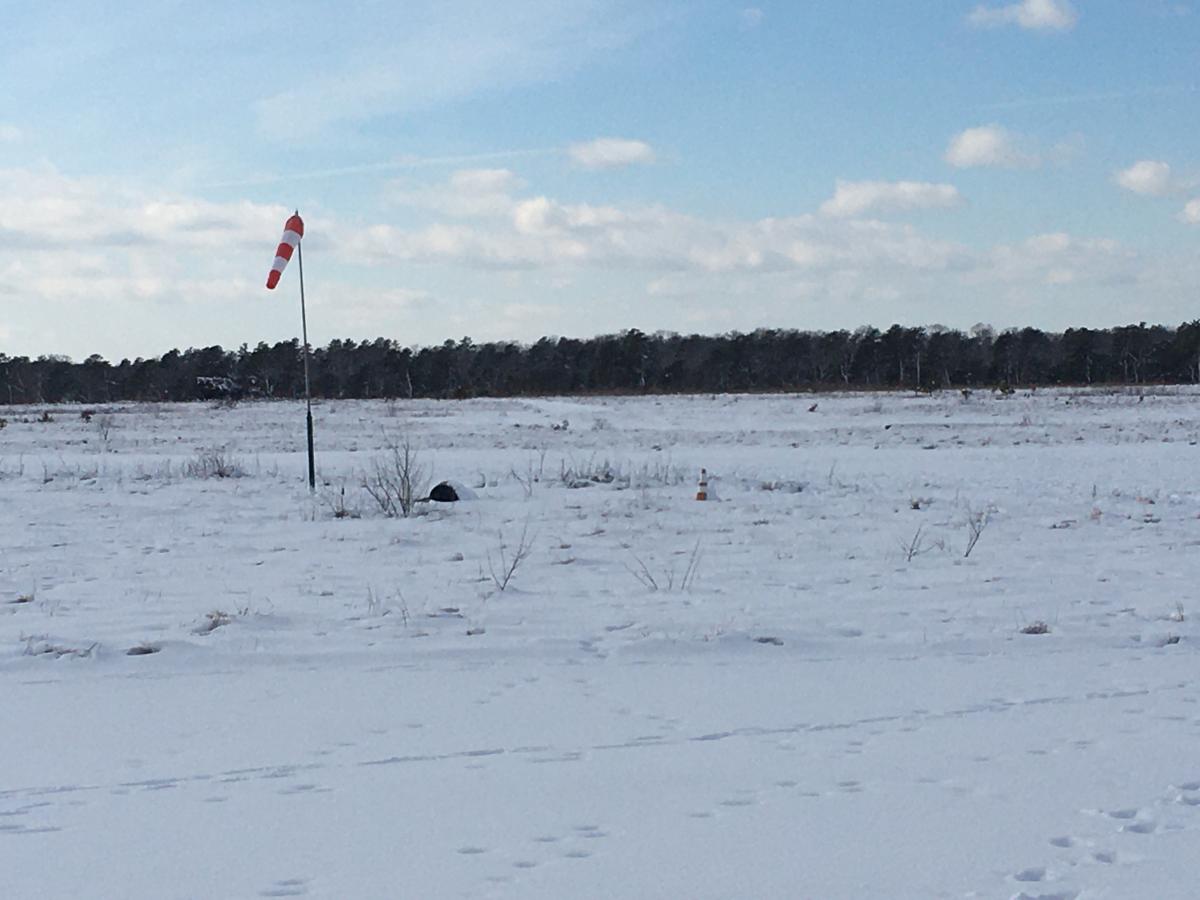

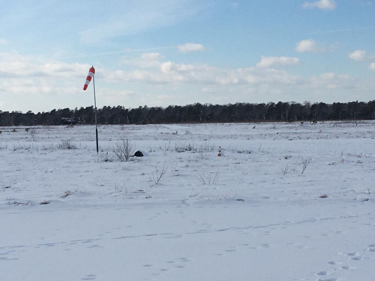

    Starting to get ready for the P-38 build. As you can see we cant do much flying with the snow on the field. Click image for larger version
Name:	Snow Field.JPG

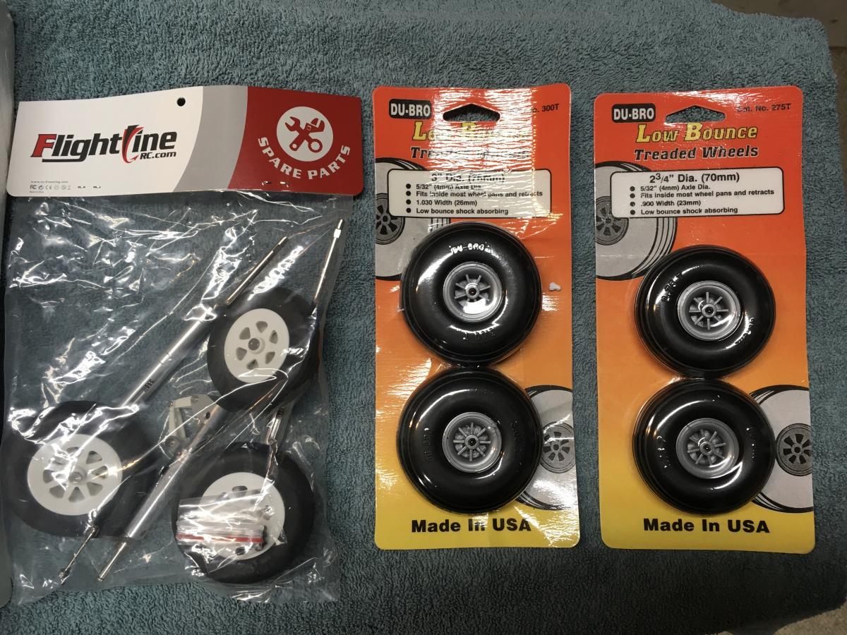

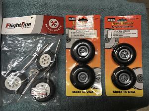

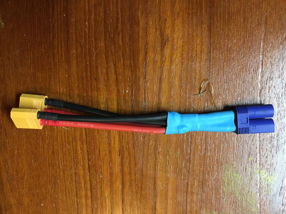

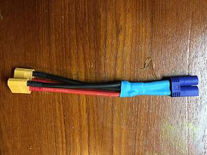

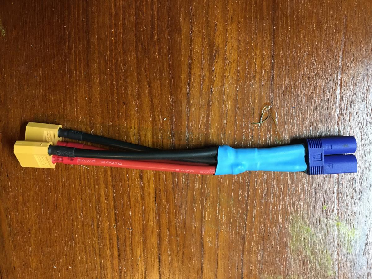

    Made a y connector for the 6S conversion, got the Up-graded gear struts and Du-Bro tires to go on the struts. Found needed to shim out the Main tires about 3mm so they would not rub against
    the strut. Some slight foam removal from the gear bays so the doors will close and the retracts seat all the way in the bay.
    Next will modify the spinners and backing plates for the 11x7x3 props for the 6S conversion.

    No, just make a Y to connect the ESCs to the battery.
    Thank you!
  • jseese
    I am going to use one battery for both motors, other than wiring up an adaptor do I need to do anything with the ESC's (like pull a wire out)? Thanks!

    Im getting ready to order the same plane. Birthday gift from me to me😉 I fly alot of 6S jets and not looking forward to buying more batteries for the P-38. You mentioned that you changed some wires on the left motor. Was that to change rotation of the blade from clockwise to counter-clockwise (or vis versa) If both props are now spinning in same rotation don't you get the thrust pull to left? Did you go with the 11x7 3 Blade props?
    Yes, switching two of the motor leads around was to go normal rotation on both motors. The counter-rotating 3 blade props are cool, but it's just easier to find a range of pitch and diameters in 2 blade normal rotation APC E props. I don't expect to really be able to notice any torque effect, as this is a pretty large wingspan relative to the size of the props. I just went with 11x7 2 blade props for now; testing with a watt meter showed those pulling just a little over the motor's rated wattage at full throttle while restrained on the ground. That will unload significantly in the air, and should be safely in the motor's operating range. Of course amperage through the speed controls is now ~30% lower than it would be on 4S.

    Already have the dubro wheels and the suspension upgrade setup and ready for install.
