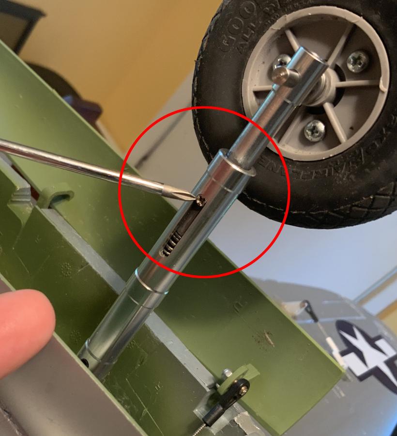

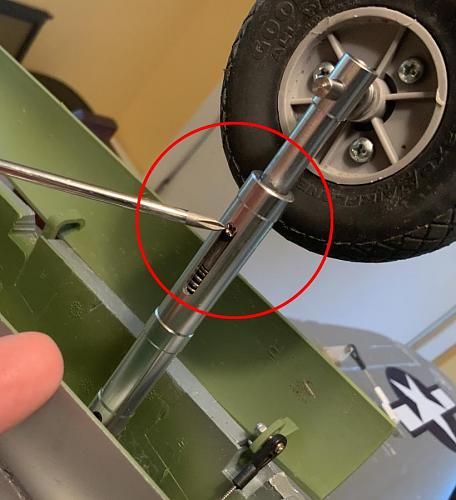

  • GliderGuy
    Originally posted by Beeg
    This is if you have the "FlightlineRC P-38 Complete Shock Absorbing Strut and Tire Set"
    https://www.motionrc.com/products/fl...re-set-upgrade
    It's been about 4 years running the above upgrade struts with non stock Robart wheels on the FLRC P-38 operating off a variety of runways some being a little rough with lots of landings.
    I noticed the other day that the wheels had a very noticeable toe out going on and my first thought was I'd bent my gear with too many less than perfect landings. After putting it in the maintenance hangar I started going over the retract, strut, wheel axle, etc..it took a minute to figure out where the excessive play was coming from that allowed the wheels to pivot and toe in and out so much.
    What I found was the two little screws on each side of the strut had worked themselves out quit a bit allowing the inner strut to pivot excessively in the main outer strut.
    Thankfully it was an easy adjustment to tighten all four of the screws as both screws on both struts had become very loose.
    So, if you're running with the upgrade struts you may want to periodically check the little screws and make sure there isn't too much play.

  • Beeg
    Click image for larger version  Name:	StrutMTX.jpg Views:	0 Size:	73.0 KB ID:	257542
