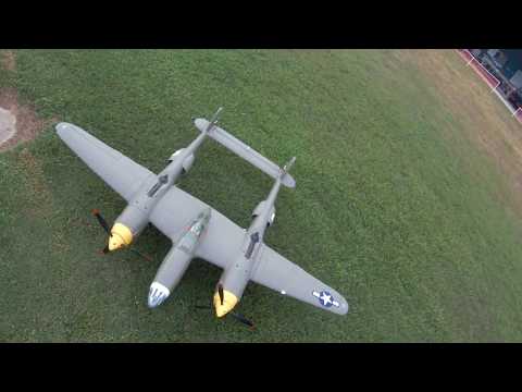

    The weather is finally cooperating! Friday night was perfect and I had three nice flights with the Lightning, got the trims sorted out and adjusted the flaps. What a cool plane!
    Couple of things I noticed: I moved the batteries back a bit and I didn't need as much "up" trim. I did need to crank in some aileron trim, which is a bit odd but not a big deal. (On some models I have added small clear plastic "trim tabs" to help, I may do that later so that I can even out the ailerons). But this plane flies so nice... really stable and I can do these really gigantic "power loops" which is so awesome. I am finding that it reallty likes a tiny touch of coordinated rudder in the turns.
    The only adjustment I made was to was to program in a little down elevator trim with the flaps, and now the model doesn't balloon at all and handles really well for landing. I did find that I have to land with the throttle cracked open just a bit, or I lose elevator authority for the flare. After three five-minute flights at various power settings, the batteries were at 3.8 volts each time which is just about perfect. (I am using twin 2500mah admiral-pro packs).
    I imagine that after two years, everyone else on this thread already knows all this stuff..... but I'm excited since this plane is new for me. :P I am looking forward to tomorrow, its going to be a great day for flying.

    Hey guys,
    Yes I started with the surfaces all dead even. On the video the takeoff looks normal but ti didn't want to come up at first, and during the flight I did need to apply some u p trim because it was pushing down. But the amount of up trim needed was slight... like, 4 to 6 clicks, something like that. It was just normal adjusting for the first flight.
    Its possible it just may have been a little nose-heavy - the batteries were in the middle position on the tray, Unfortunately I didn't have enough flight time to test for that using the flight techniques that we're used to doing, but I'll try again when I have another chance to fly it for longer than 1 minute and will report back.
    I will say that I do have experience with a number of FL planes and the CG in the manual has been nose-heavy on virtually all of them. I'm fine with their recommendation as a starting position, since the planes are more stable that way, but most of these planes seem to fly more correctly with the CG moved back a little. The big A10 is a perfect example. When its balanced correctly its a lot better at flaring for the landing (and easier on the nose wheel). T
    he Marauder on the other hand, needed the entire stab adjusted - it had nothing to do with the CG.
