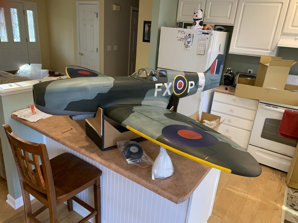

    Well, I've finally pulled the trigger on this one, been considering it for a while. It arrived today, it may be a while before I start on it, but I have done an unboxing, fit check and still have more checking of parts to do. I don't like to wait until I building/assembling, the sooner I find an issue, the better as there is a 30 "warrantee".
    So far, things look very good, a few very minor cosmetic flaws on the covering. Wings fit good, wings to vertical stabilizer perpendicular. The fuse felt really like to me.
    I have a 40cc SunnySky 190 KV motor, will use a 19x12e apc or 20x11e apc prop. 12s with 6000mah batteries. The motor is a bit more than needed but this plane needs nose weight, so this does add weight and gives me power options. Looks a little smaller than I expected but it's a nice manageable size for me.
