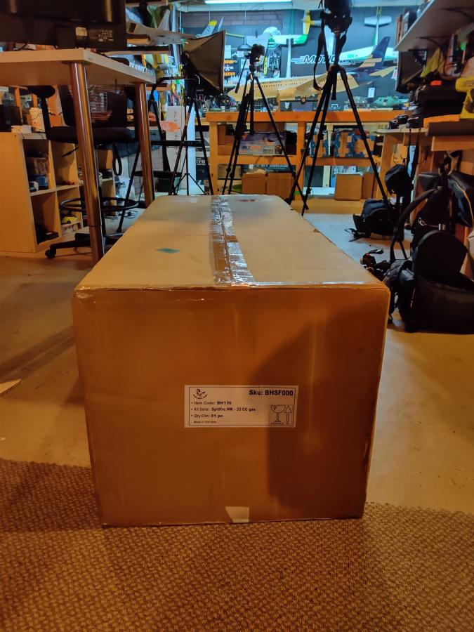

                  Hey guys, look what just came in! This is a serious box!
                  I will be opening this box and going through its contents LIVE on your new Friday weekly live YouTube show. If anyone has any questions about this one that you want to make sure I cover, by all means, head over to this thread here and ask away

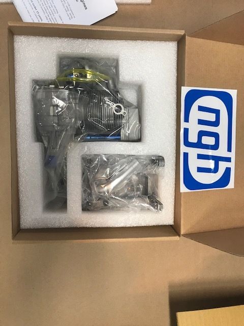

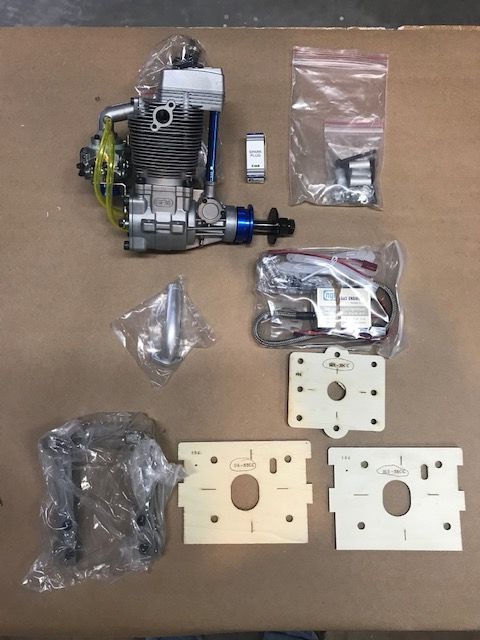

                                I have started going thru the box that James opened yesterday and have to say that pictures don't do it justice. This is a beautiful airplane. I started to weigh each item as I opened. Click image for larger version
                                Comes with three back plates for firewall mount. DLE, OS and standard 30cc mount. Engine weights 2lb 13 oz, ignition box 4.6oz, motor mount 7.6 oz, muffler .6 oz, spark plug .6 oz, OS/ DLE firewall .6 oz and the 30cc firewall is 1.0 oz

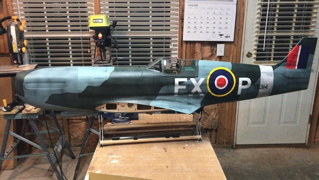

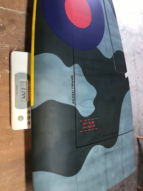

                                Fuse weights in at 2 lb 10.6 oz without the cowl. Cowl is 8.2 oz.

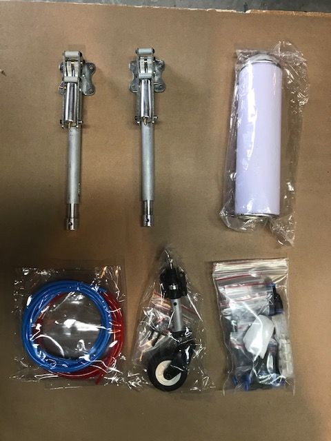

                                Landing gear looks to be sturdy and comes with everything you need to plumb.
                                Struts (pair) 13.4 oz, air tank 2.6 oz, tail wheel assembly 3.0 oz, retract hardware 4.4 oz, airline is 1.8 oz, wheels (not pictured) 5.8 oz,

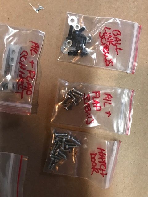

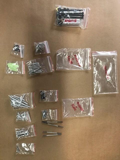

                                Hardware package comes in one baggie separated into each "system." Total hardware package weighs 7.6 oz.
                                Each wing weights 1Lb 14.4 oz
                                Not pictured. horizontal stab and elevator 8.2 oz and rudder 2.0 oz

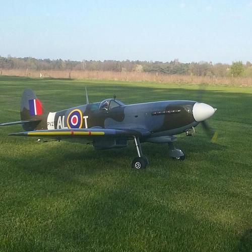

                                    #18

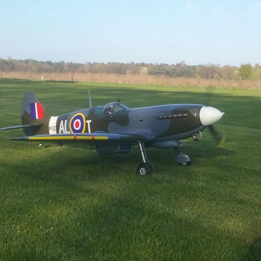

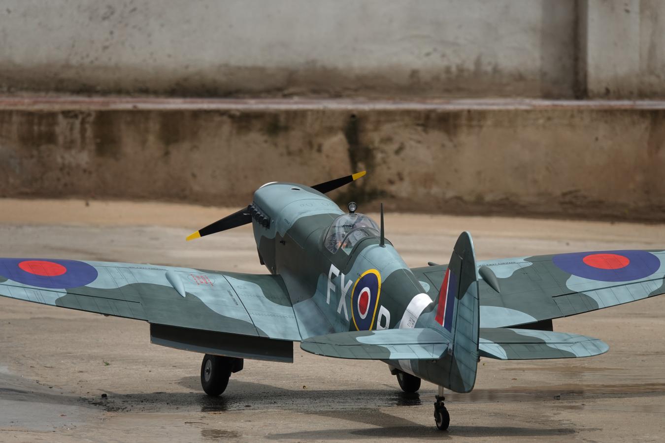

                                    Click image for larger version  Name:	spitfire mk IX at flying field.jpg Views:	0 Size:	90.7 KB ID:	232187
                                    Building,
                                    Keep posting some more pics,
                                    I build also BH136 Spitfire, see my build on RCgroups link posted in previous post.
                                    I use a DLE30, but to set my CG I needed almost 1kg lead.
                                    So tail should be as light as possible, if I new it before I removed as much balsa,plywood from tail.....
                                    Flying it is easy it flies almost as a trainer, it has a lot of lift.
                                    I converted to electric retracts, using only struts and wheels from kit.
                                    Only after some flight I had a hard landing and stock wheels broke, plastic is not that strong.
                                    Good luck with building this beautiful plane.
                                    grts Hans
                                    ps I see that struts looking better quality than in my KIT

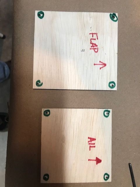

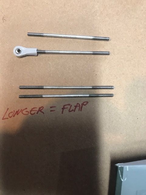

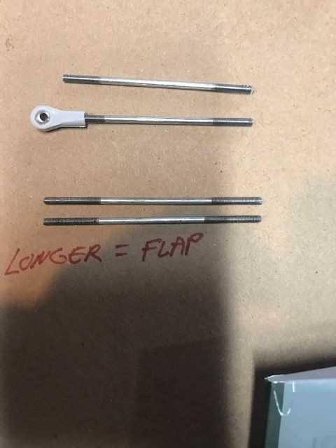

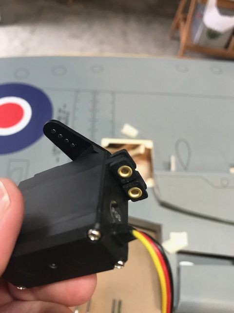

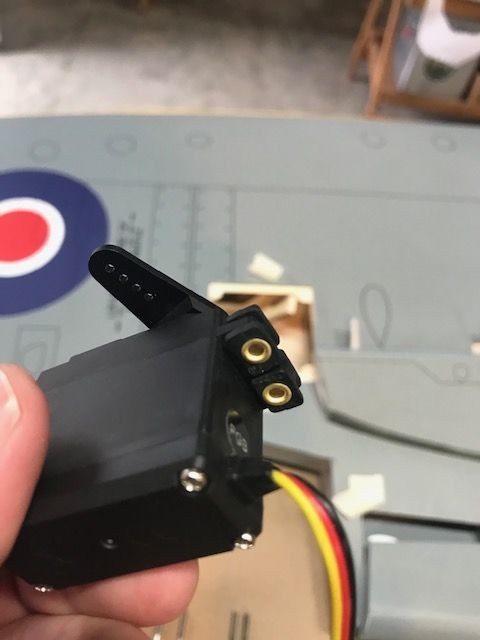

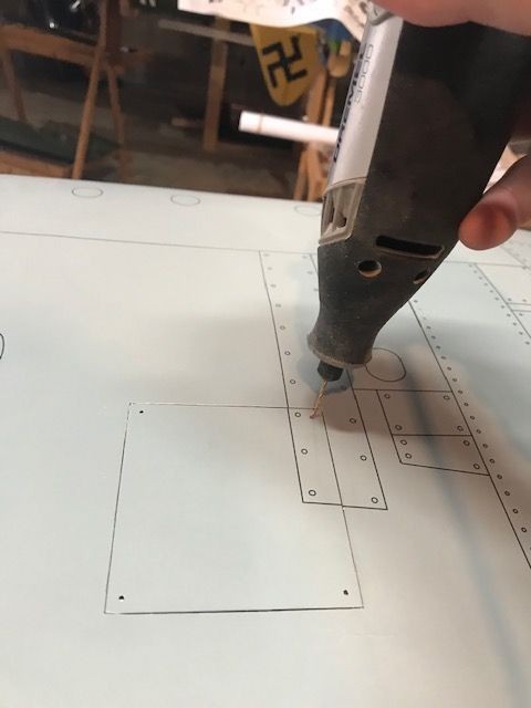

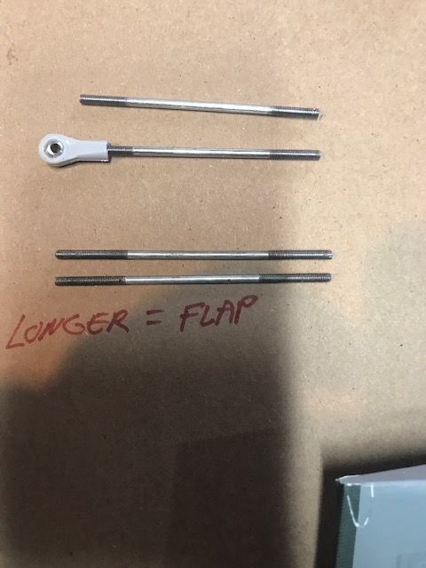

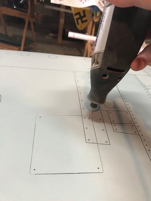

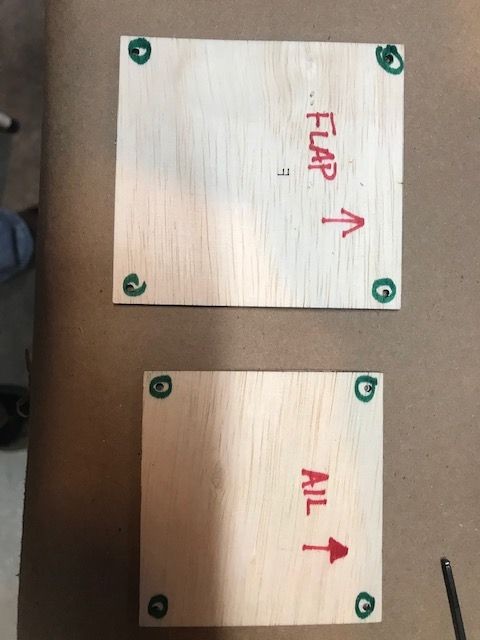

                                        Started on fitting the aileron & flap servos as well as hinges. All seems to fit really well. The servos hatches are pre-drilled. Just line them up and drill into the hardware once in place. I am not using the screws supplied, I like hex head screws better. As you can see I added the grommets to the servos and inserted the brass fitting. Notice the correct way to insert, I had been doing this wrong for a long time. Next I will be putting the hinges in place and attach the wing surfaces. Click image for larger version
Name:	Ail &amp; Flap hardware.jpg
Name:	Ail &amp; Flap pushrod.jpg
Name:	Drill servo hatch.jpg
Name:	servo gromet placement.jpg
Name:	Servo hatch pre drilled.jpg
