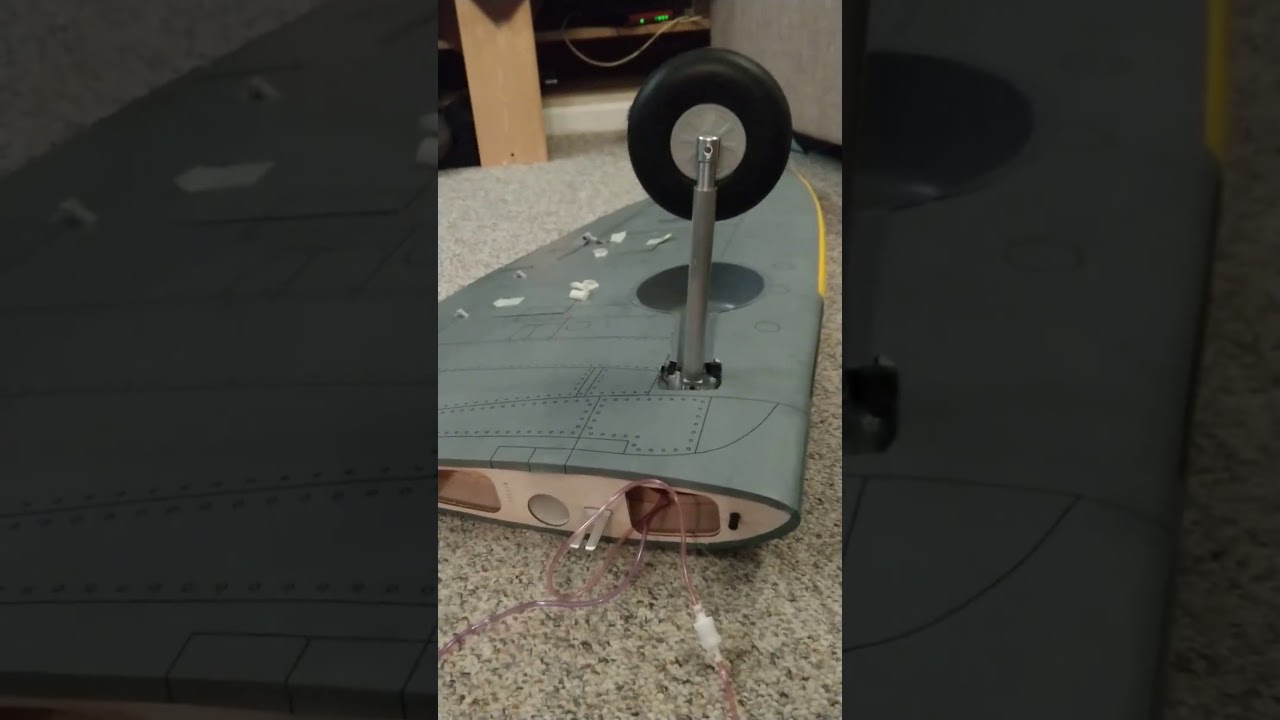

      As is. I have the stock retracts installed, will post pictures soon. Not too difficult but the tubing is hard to work with.
      Thanks for the feedback jasmiller , I'm also going to do the same as you. Going to use the stock gears, but with robart valves.
      Do you have the full list of valves you used ???
      I decided to just use a wheel collar on one of the tube lines to slow the air down and thus offset the gears a bit.

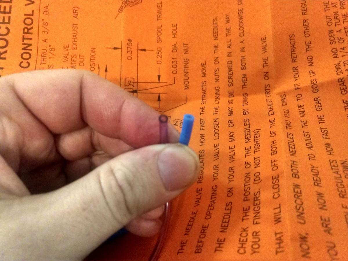

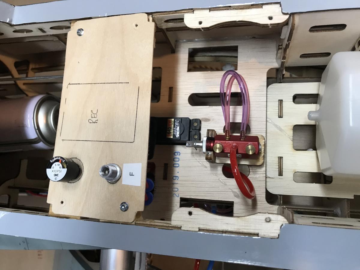

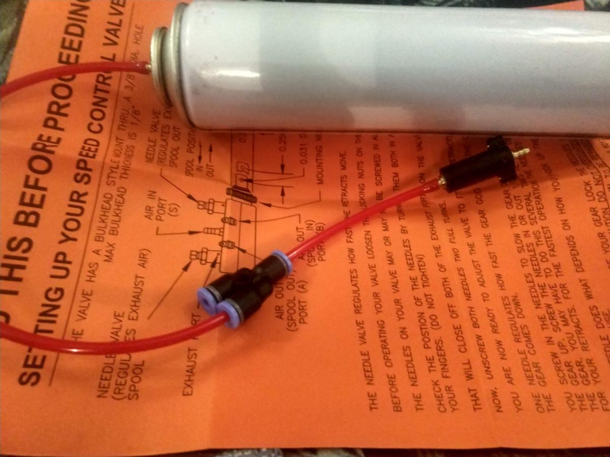

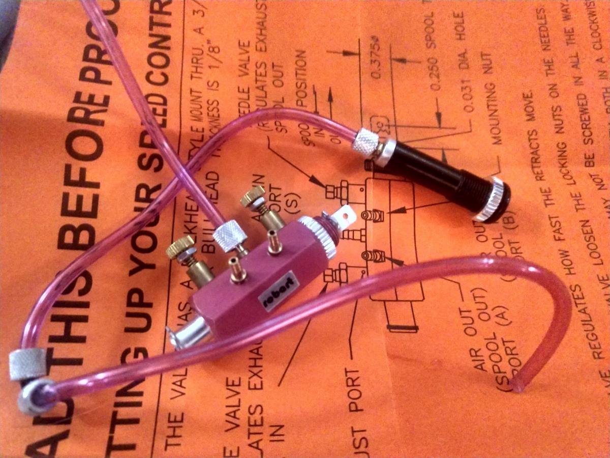

              I have that part... See pics...
              I opened the retract box today, i'm not happy to see that they did not include a fill valve stem or cluck. I'm probably going to pick up the robart one at the hobby store tomorrow.
              So it took my almost 1 hour to figure out how to get this hard plastic tubing onto the stems. They were a complete pain, i'm not a fan and really tempted to toss everything out.
              I love those quick disconnects though. I'm sad that they don't work with the soft tubing.
              Click image for larger version  Name:	IMG_20200205_234634923_HDR.jpg Views:	0 Size:	110.6 KB ID:	235247

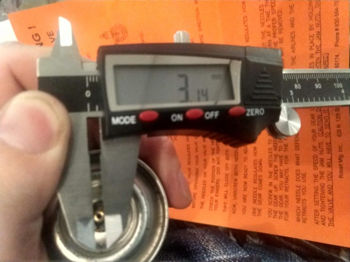

              The problem is , I would love to re-use the tank with the robart 1/8 tubing. However,
              The tanks stem is slightly bigger @ 3mm. so it will fit, it will stretch, and it will have a tenancy to slip off , unless its secured down somehow. I have to get creative on this, OR just buy the robart tank that has the stem that fits the 1/8th tubing. I'm trying to save $$$ where I can and re-use parts. so i'll try to spend some time and figure it out.
              Click image for larger version  Name:	IMG_20200205_235035980_HDR.jpg Views:	0 Size:	97.8 KB ID:	235244
              These robart parts, went together in less than 5 minutes.. a little ear wax and the tubes went right on the T connectors... and I locked them down with the Line Retainer Nuts, Tomorrow i'll go out and get the brass fittings , you're not supposed to use the retaining nuts on plastic, i just wanted to see how it worked out.
              Click image for larger version  Name:	IMG_20200205_234705441_HDR.jpg Views:	0 Size:	153.3 KB ID:	235245
              Here is a pic of the difference in tubing, robart on the left and stock tubing on the right. the pic aint that great.
              Click image for larger version  Name:	IMG_20200205_234813705_HDR.jpg Views:	0 Size:	121.2 KB ID:	235246
              So, good news is the Robart, 1/8th tubing will fit over the retract cylinders, again, need to secure it somehow as the retaining nuts won't work since it's not a robart part. I may go see if the hobby store has cylinders that would drop in.... will see.... more to come!

                I used stock tube from retracts and then Robart tube to connectors. Works great.

                  Connected

                    I ended up going out and buying the rest of the Robart Parts , but used the stock retract cyclinders. Everything works great!

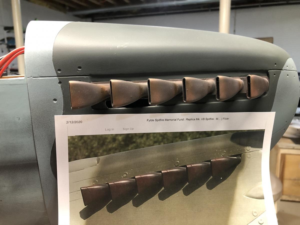

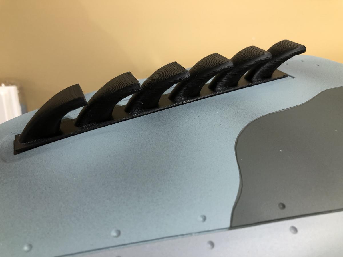

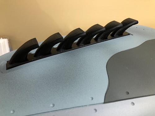

                          If you have the ability to 3D-print you may like to check out this collection with several Spitfire accessories: https://www.thingiverse.com/rcmodelstl/about
                          I printed out the exhaust stacks scaled up to 113%.

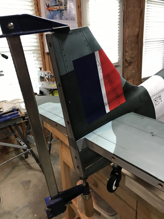

                                Horizontal stab is now attached. I cut off some covering on the top to help secure. There was a gap at the very rear so I have a clamp for compression.
                                the push rod for the rudder is too short. I had to order additional push rods. Elevator is good.
                                Not much left now. Get fuel tank installed, break in engine, mount and fly. I’ll take some additional photos of my set up using a power box and spark box.

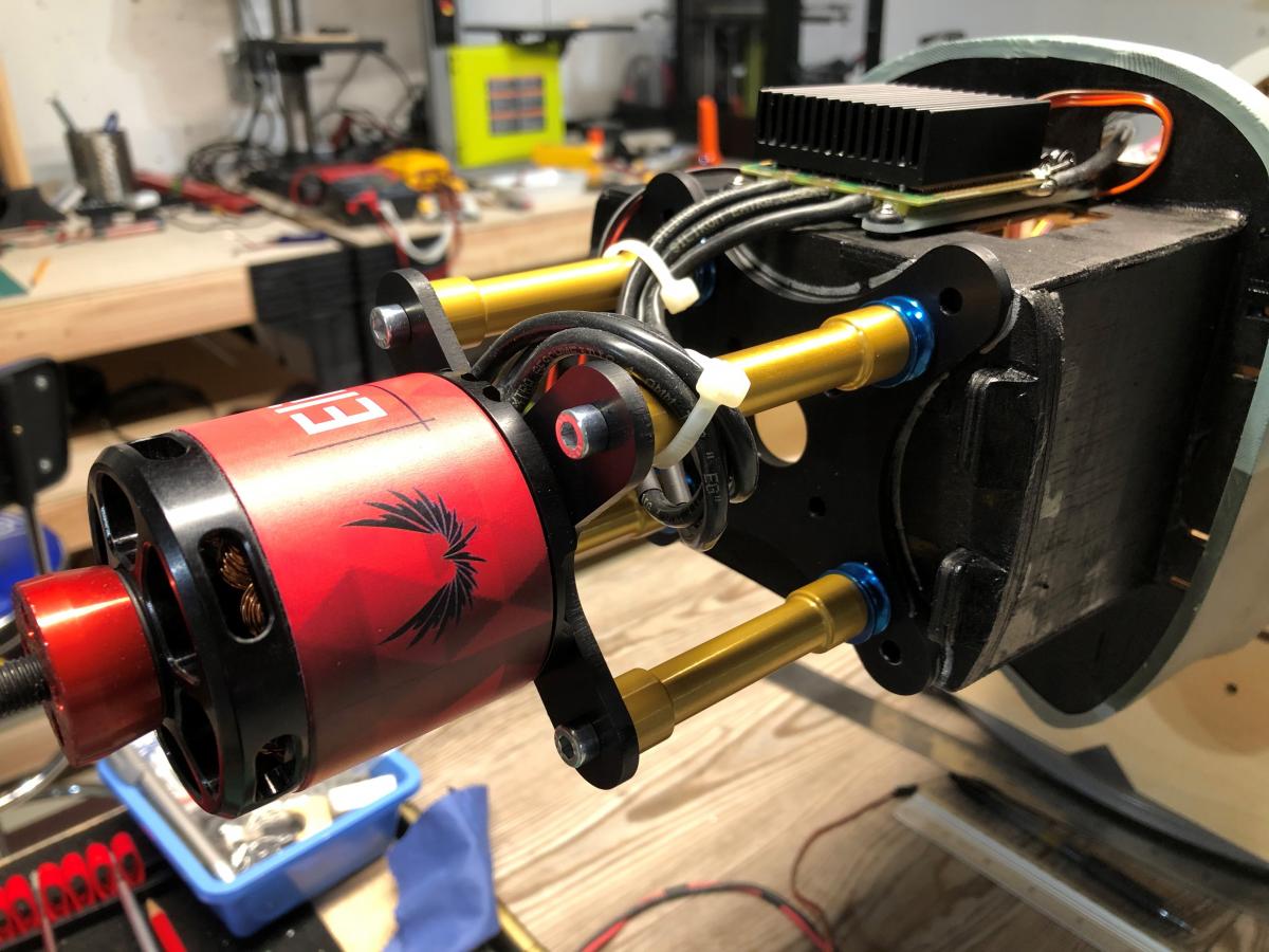

                                    Motor mounted.Click image for larger version

                                      What's your motor/esc combo?
                                      • downwind3zero
                                        I am the Warranty.
                                        • 50
                                        • Horsecountry, NJ
                                        #119
                                        Espritmodel Elite 35cc, Elite 125A, 12S.

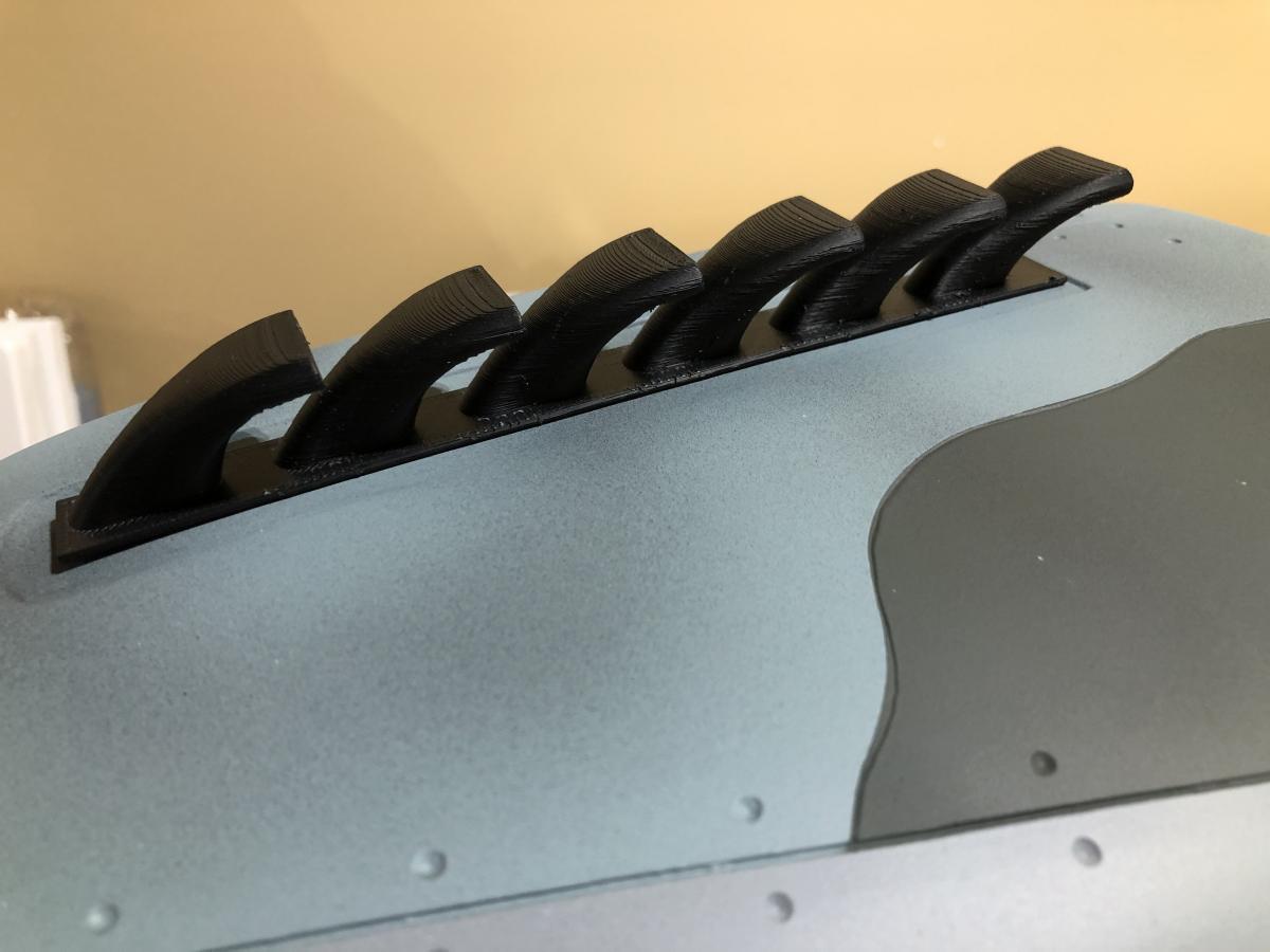

                                          Processed 3D-print of stacks with pic of full scale original.Click image for larger version
