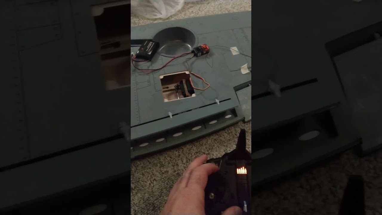

    Hi, has anyone had any luck with the geometry of the aileron servo and linkage? Any way I turn it or angle it, it doesn't seem to line up even closely. pic shows max elevation of pushrod.

      I had the same issue. Once I connected I shaved a little from the side. Seems it will work fine.

        I noticed that too.
        I'm using Dubro Ball Links, and had to trim a little to get the servos to fluidly move the rod without binding.

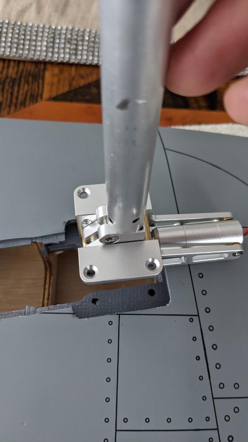

                  I haven't even really started to assemble it, but I'm already facing a couple challenges. First, the struts are a horrible fit for my retracts. The insert pin is 4 mm too small, so I'm increasing its diameter with layers of brass tubing and metal epoxy. Then the main strut is too thick and it runs into the motor of the retracts, but I remembered that these units can be switched to open outward instead of inward. That solves the clearance issue, but I'm sure I'll have to modify how the unit sits in the wing. Oh well, I'll clear that bridge when I get there. I also noticed that the supplied retracts are NOT 90 degrees, like alpha had mentioned. No big deal, honest mistake. I'm sure I can shim mine a bit to make up some of the difference. Retract installs are always a pain in the ass for me.

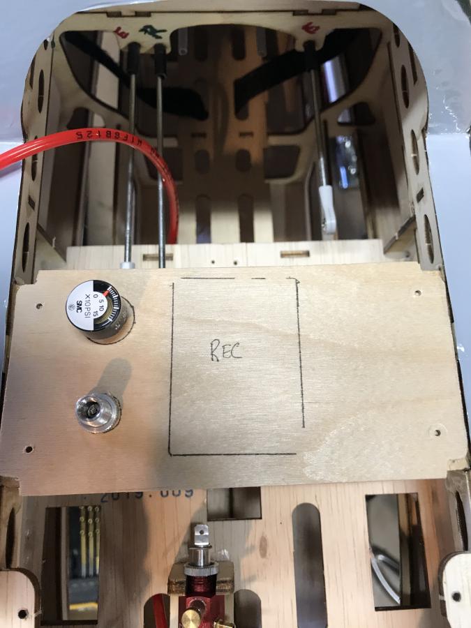

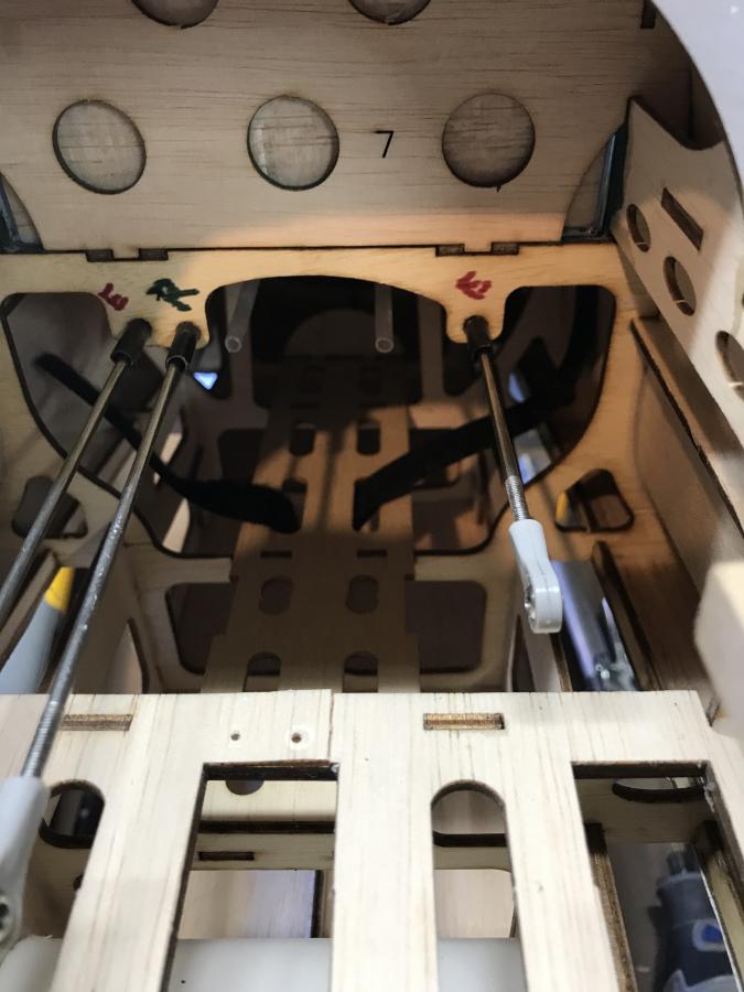

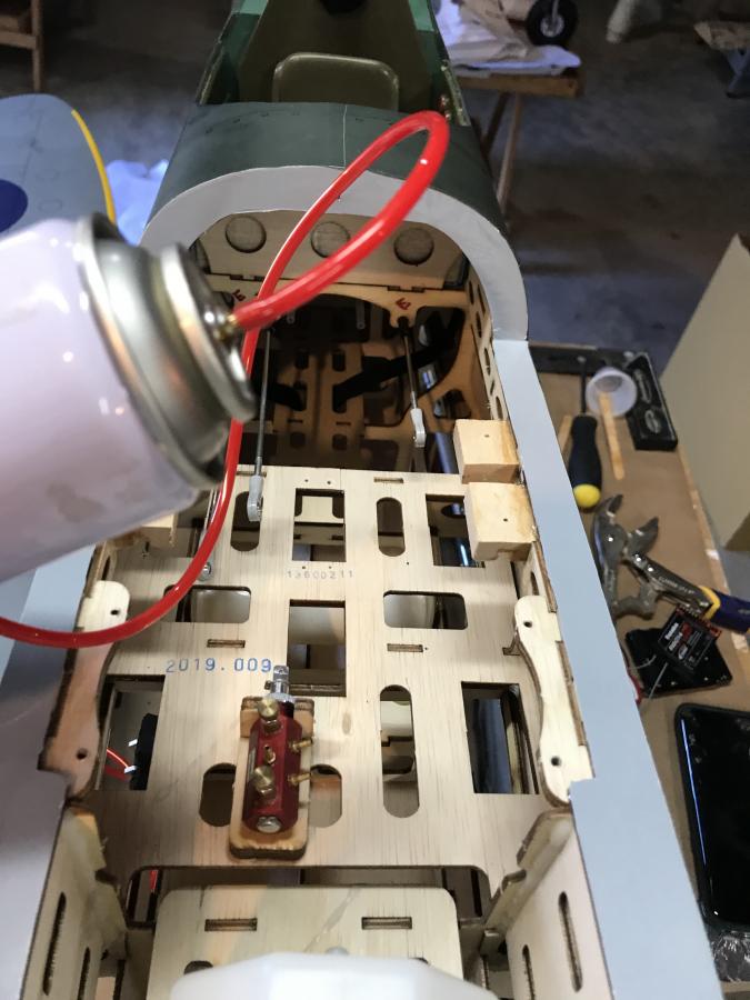

                      Retracts going in. Seem to be sturdy. I’m combining the stock retracts with a Robart valves and pressure gauge from Chief aircraft. I installed an additional trey and will run all plumbing below so it will not be visible.

                            I managed to get the struts to fit my retracts by increasing the diameter of the insert pins with brass tubing and metal epoxy. The retracts will have to open outward to avoid contacting the motor of the unit, so the next job is to clear out some material from the wing spar. Shouldn't be too difficult, I'll try to reinforce the supports some more to make up for the damage I'm doing. So far it hasn't been as difficult as I expected.
