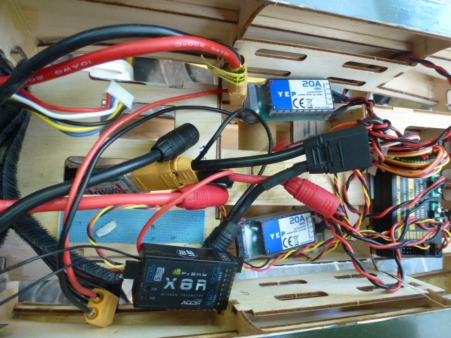

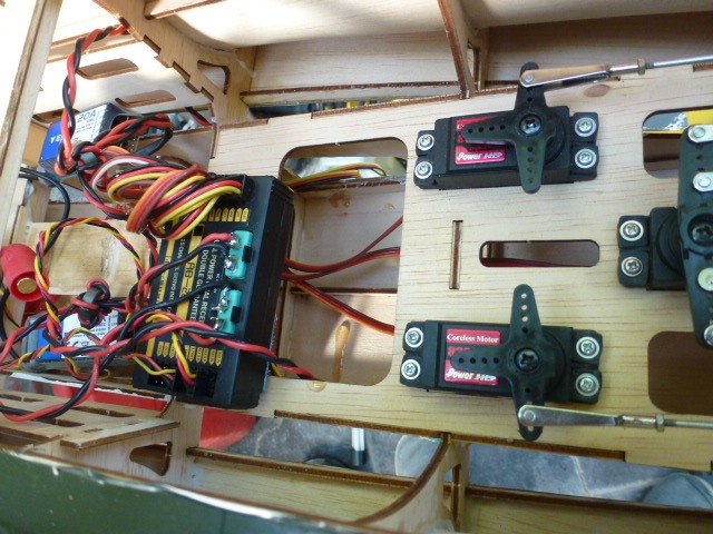

      Still waiting for the propeller, but spent my time wisely :-)
      • tightened the pull-pull cables for rudder and tail wheel
      • programmed control surface deflections and expo in 3 flight modes
      • soldered the battery connectors for 10S combo (6S XT150 + 4S XT90)
      • added velcro and straps to secure the flight batteries
      • added two 20A SBECs
      • moved the RB-20 further aft, still need to reroute some servo wires
      • configured telemetry: added the RB-20 sensors and the FAS-100 current sensor, added a calculated sensor for consumed capacity and for total power drawn
      Now I still need to connect and bind my second X8R receiver, then test failsafe and do a 360° range check (in search of possible "blind corners of reception").
      And clean up those wires all over the place.

        Hey HangarQueen, don't you just hate wire tangles?? You might want to add some hot glue or something over those bare mpx solder joints to help with strain relief and also to prevent something coming in contact with them and shorting out!!
        Cheers, DSA

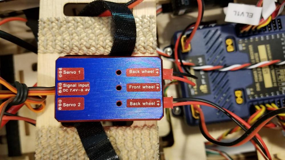

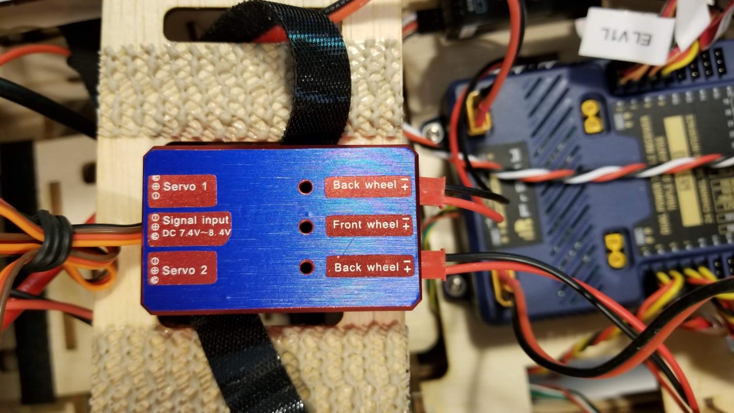

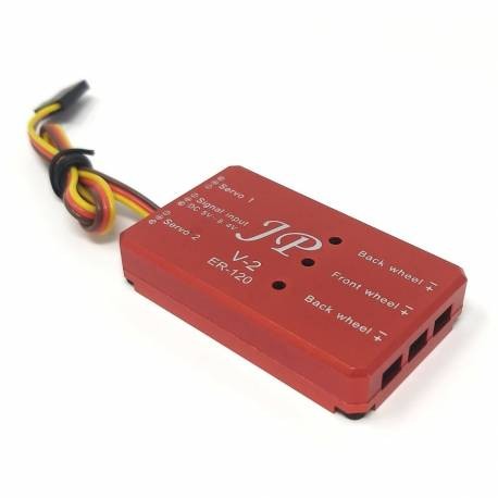

          For any interested parties in addition to TimmyBeetle, ... Click image for larger version
ID:	316066 The retract controller comes with the new version electric retracts. The controller connects via standard servo plug to your RX, and has a JST power tap for 2s Lipo. Those connectors are bunched together on the left of image. Each retract has just a 2 pin power lead to plug in via a JST tap, note polarity. It looks like the controller will also control a third retract unit ("front wheel") and also looks like it will control servo-operated gear door covers. ("Servo 1 and 2") although I have not tested those at all or even know if there is a delay built in either direction.
          Cheers, DSA

            And that gear controller looks oddly familiar to this one: https://www.aliexpress.com/i/32987936614.html

              Yes they are similar, I think all these rc electric things are clones or rebrands of same unit!

                #247
                timmybeetle showed me one of those when I bought my Spit from him. I had never seen one of those before, so I researched about them.
                To use one of those, he had to connect the motors of the retracts directly to the controller, and thus bypass the limit switches (which had started failing on his)

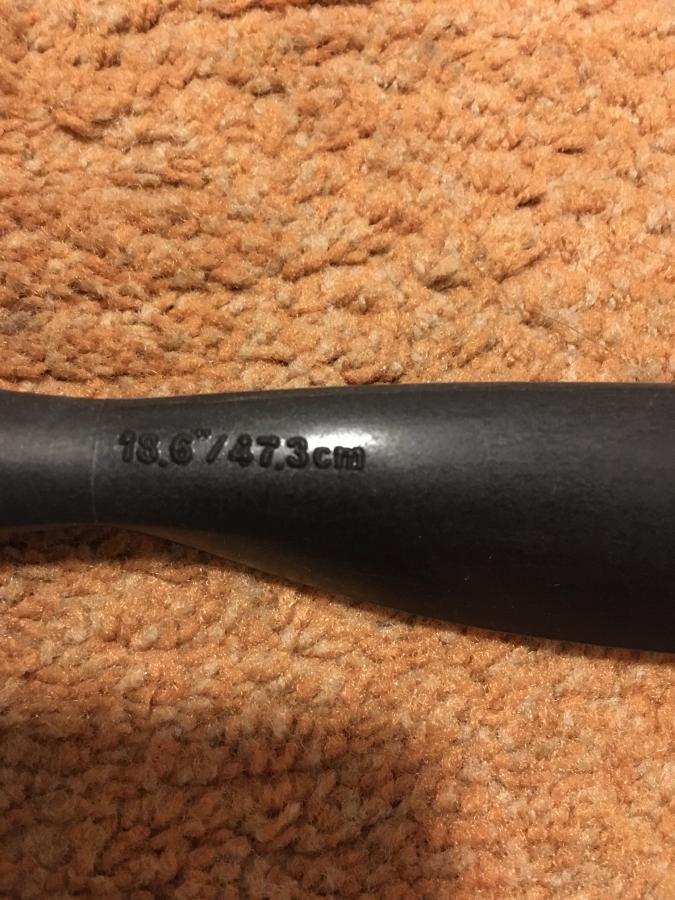

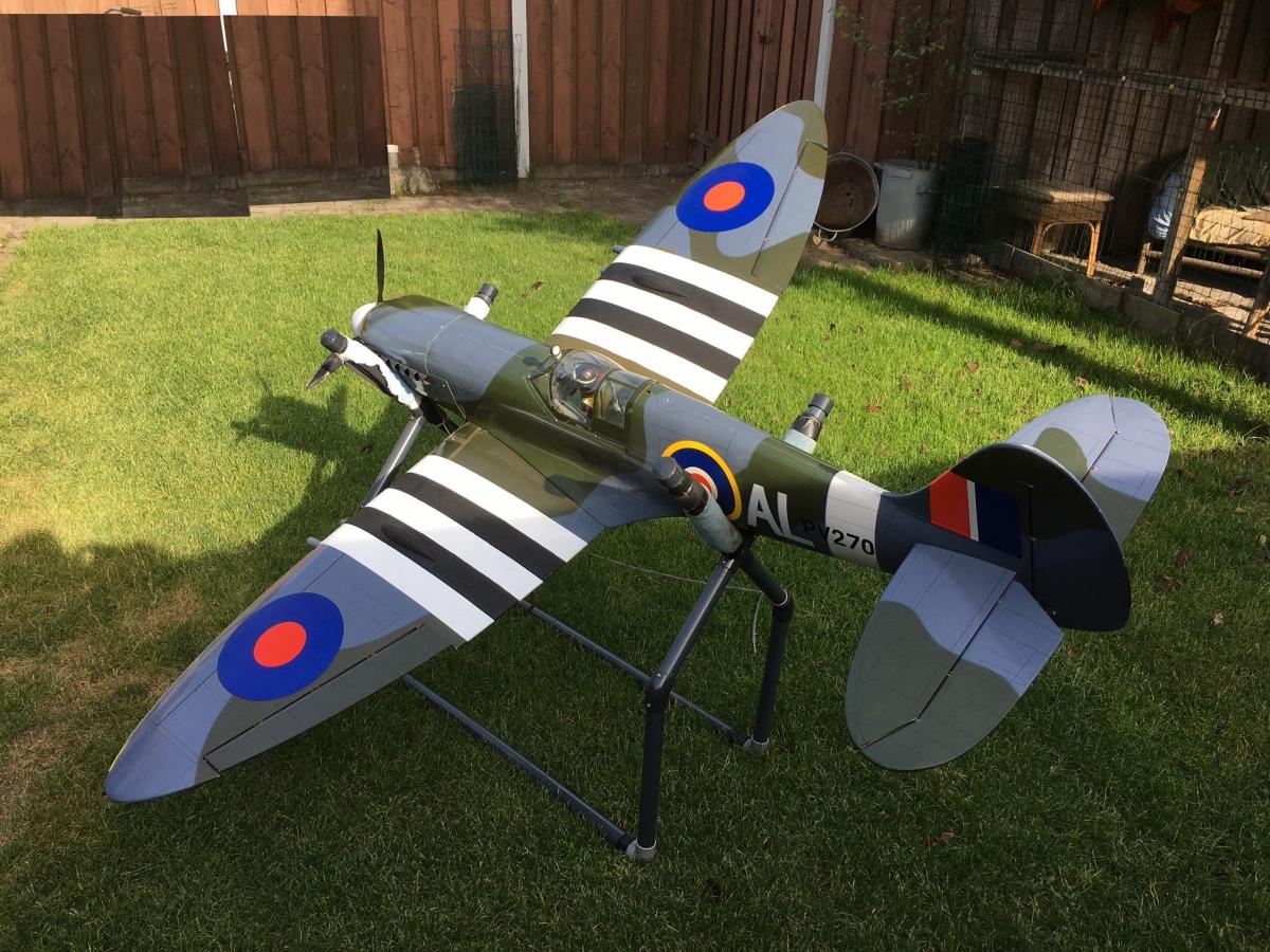

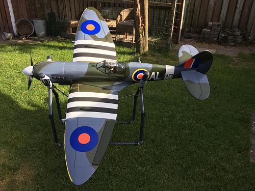

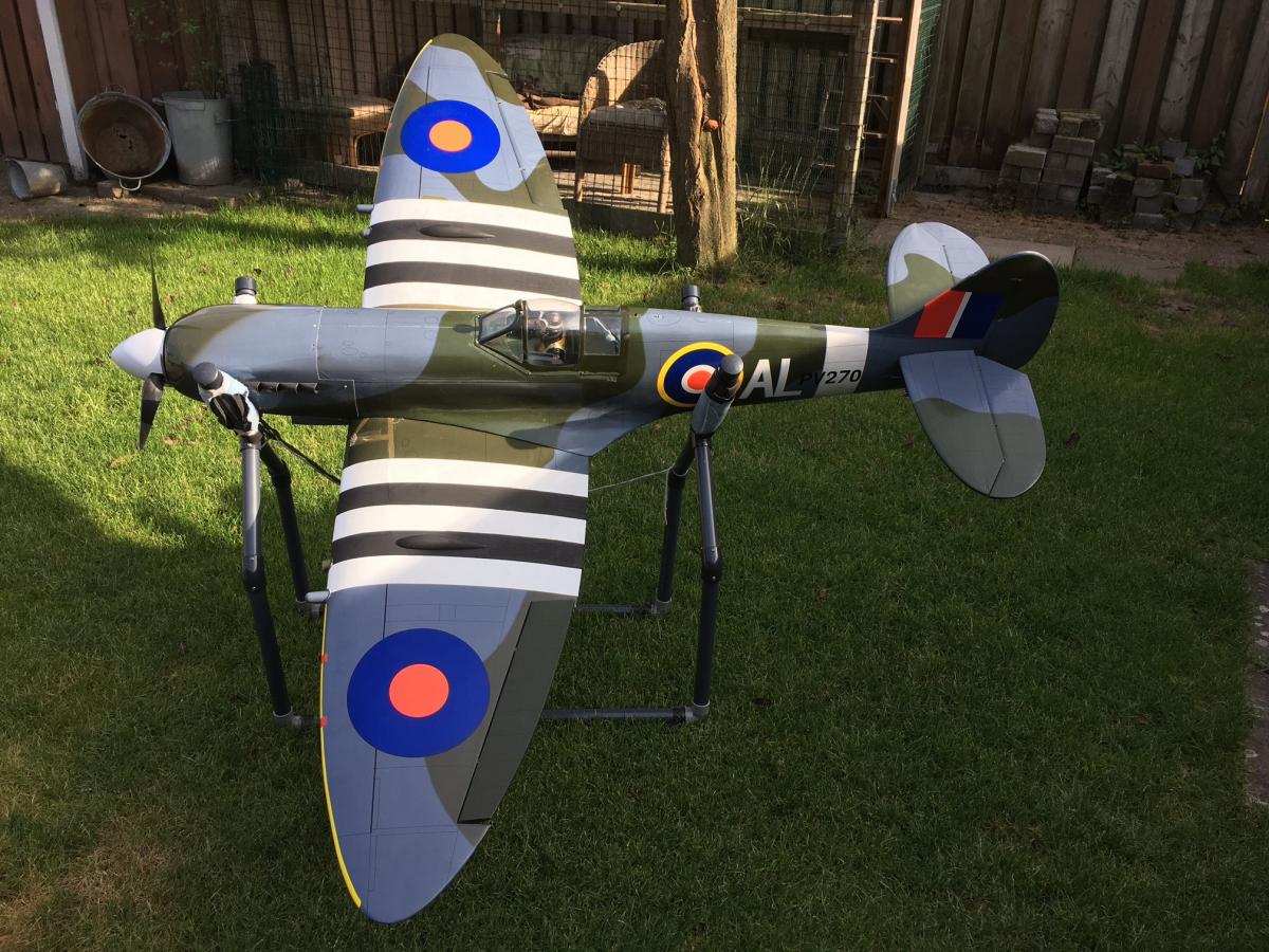

                  I have the old version of BH, that retract controller I have a similar one in my Elektro Spitfire, brand is JP.
                  I modified my retracts from HK, removed circuit board with switches and soldered wires directly to motor and connect them to controller.
                  Motor is Turnigy SK3 6374-192KV, ESC is Turnigy Sentilon 100A.
                  Prop is from Ramoser 3 blade 17 inch, adjustable, I adjust it to 23-24 inch.
                  10S LIPO.
                  Power measurement:
                  Amp draw 82.5
                  Voltage 36.6
                  3000 watt of static trust, resulting in a 7Kg static trust.
                  Plane weight is 8,4 Kg
                  After test flight I will update because I use Taranis telemetry and see what I get flying this plane in the air.
                  Plane is ready for flight.
                  ps: made invasion stripes with oratex white and painted black with Tamiya XF-1.
                  Grts Hans

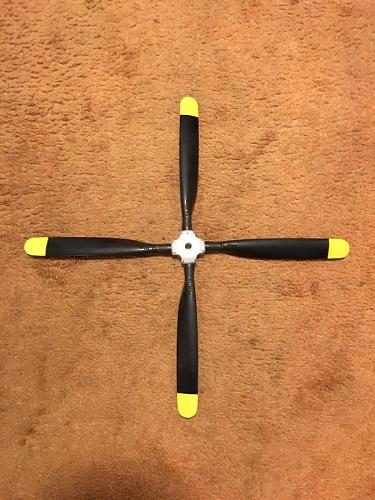

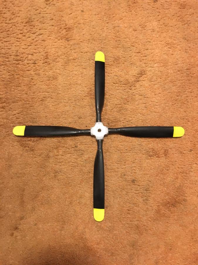

                  found me a 4 Blade spinner at Aliexpress, so I can use finally my Ramoser 4 blade I have lying around ha ha

                    I like those invasion stripes! Reminds me of my (may she rest in peace) old TopRc spit.
                    I like that ramoser prop, I was thinking of doing a scale 4-blade, but not sure what size, maybe the 17.3 inch with 10s and eflite 160 equivalent motor..... (right now, will maiden with 18x10 2 blade)
                    What spinner is that?
                    Cheers, DSA

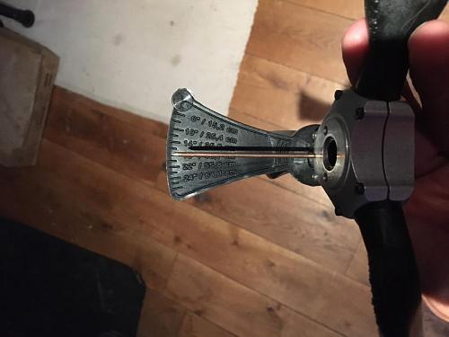

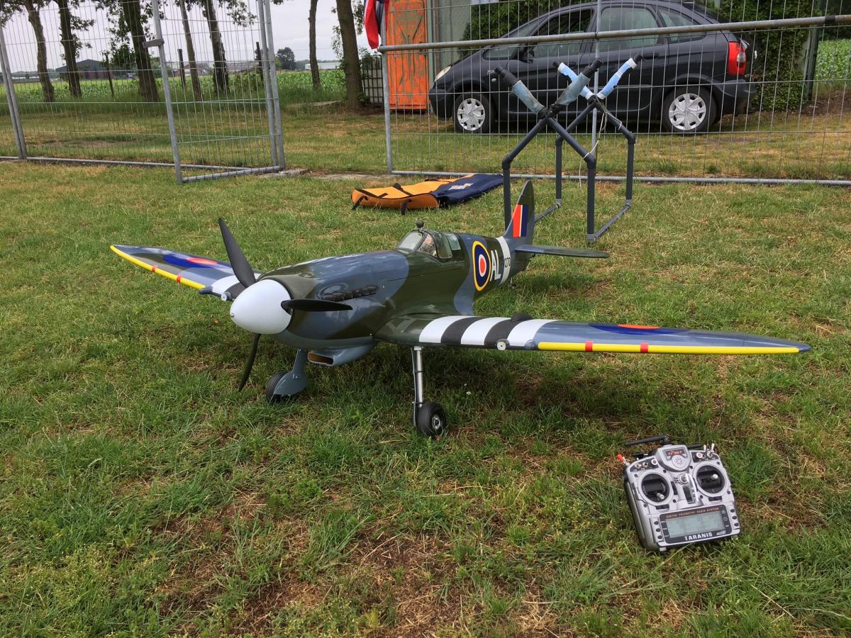

                        Test flight Elektro Spitfire BH136
                        On 23 of June 2021 I performed test flight of my Elektro Spitfire.
                        First flight I had my elevator not adjusted right, to much up so had to land and re-adjust it.
                        Second flight my left leg from LG fell out due to set screw gone during take off.
                        Luckily spring was still there after landing on belly and repaired it on the flying field, after that I flew 4 other flights with no problems.
                        During flight I go full throttle just once to test power load, to discover that my Ramoser, pitch was way to high.
                        I set pitch at 23-24", flew this setup with my other elektro Spitfire which I sold but there I got only 65 Amps, now I got 83 Amps.
                        Well different motor (same SK3 192Kv 6372) and other ESC, also throttle calibration at Castel ESC is a pain in the butt, my thoughts.
                        So at home I re-adjusted Ramoser prop to a pitch of 18" and will test it again next time flying this great plane.
                        grts Hans

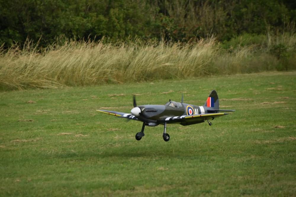

                            Landing with half flaps,
Name:	BH Spitfire Landing 24-06-2021.JPG

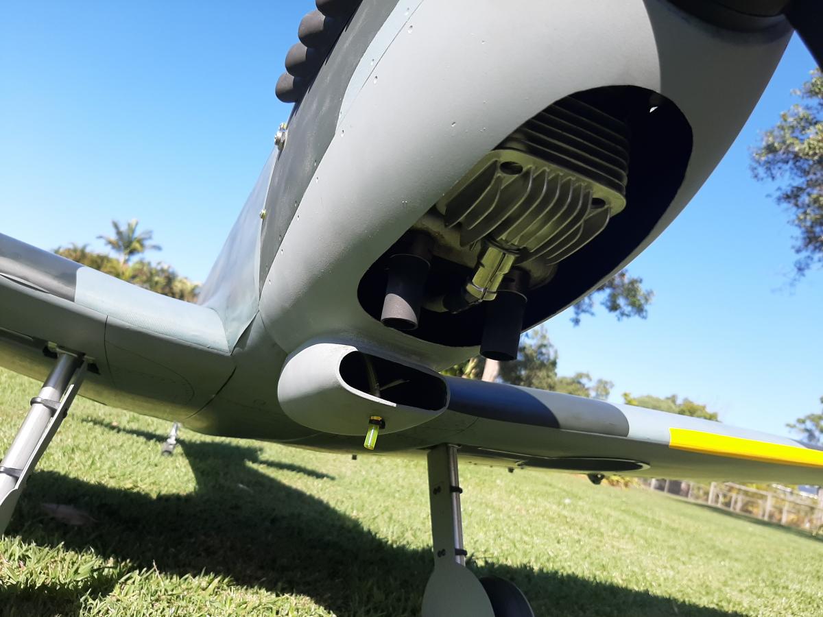

                              Before assembly i have cut the cowling where the exhaust stacks go and opened up all the stacks mainly to let heat out of the cowl. Worst thing with DLE engines is the carb is at the rear above the exhaust
                              so apart from heat shielding letting the hot air out is just as important.

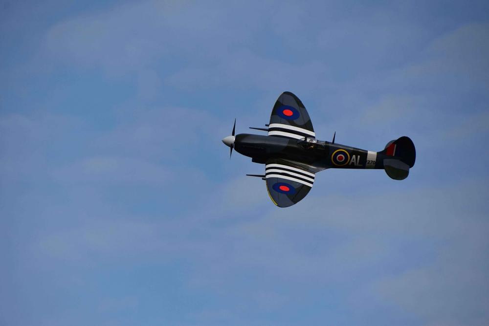

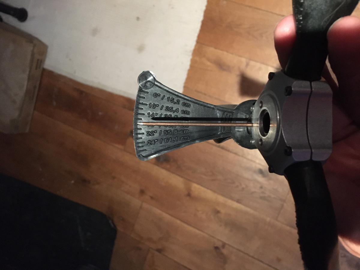

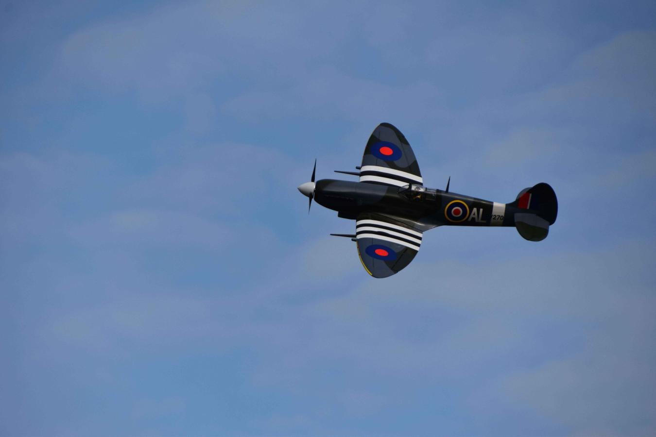

                                Update about power setup
                                Today I flew my Spitfire with 4 blade Ramoser prop and new 4 blade spinner.
                                I had prop adjusted to 14 inch pitch but after flying it, I had to adjust it to 10 inch pitch.
                                amp draw was 100A so way to much, with adjusted pitch I got 70A.
                                Flew great and a much different sound flying bye compared to 3 blade prop.
                                Grts Hans

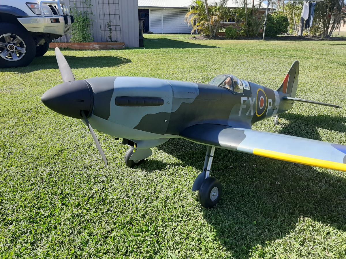

                                  So these are the latest retracts with controller, looks slightly different from previous post .
                                  The retracts are nice and solid with minimal movent and work very smoothly.
                                  There are no instructions for the controller but i have it working for basic up down operation. Requires its own 2s 7.4 volt power supply

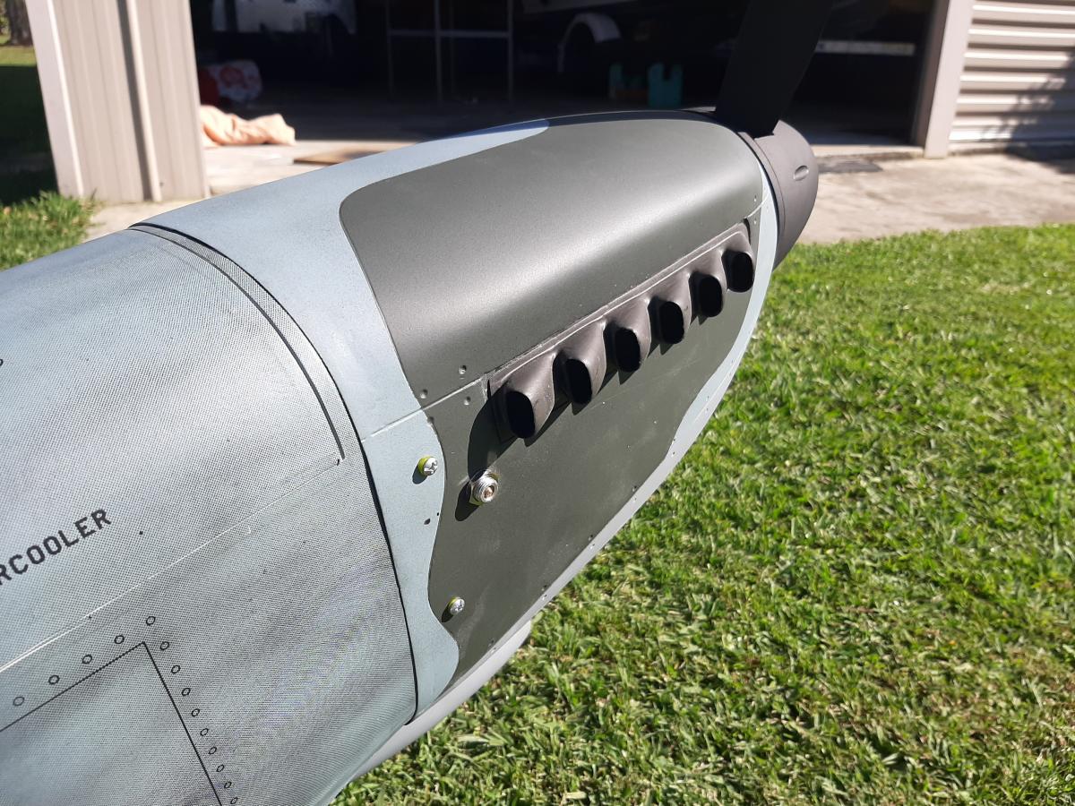

                                    Have opened the upper cowl where exhaust ports glue on and also opened exhaust outlets . Im using a DLE35 ra so hopefully will help with letting hot air out of cowl. I will also make a heat shield between carby and exhaust.

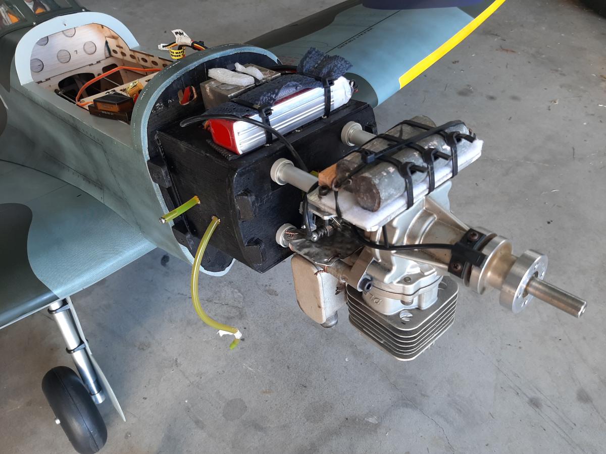

                                      #258

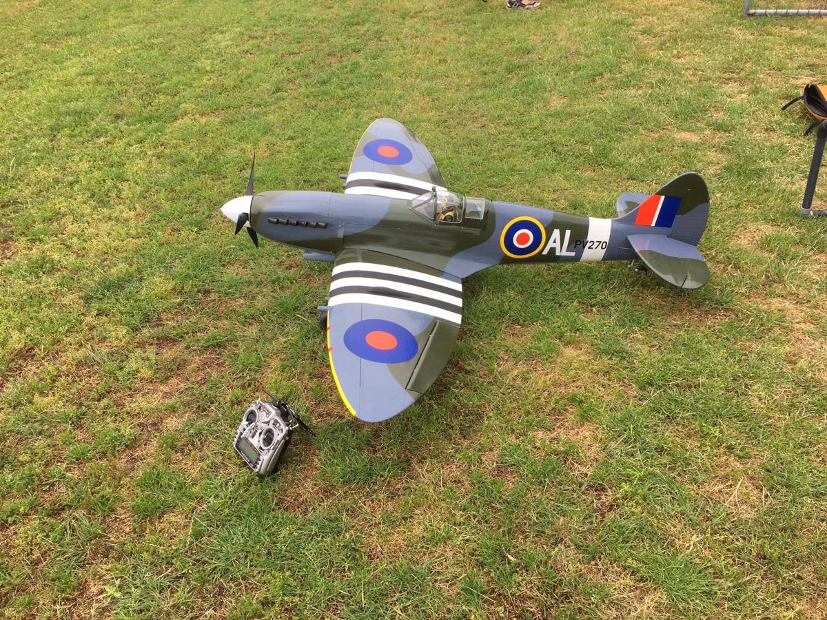

                                      So its finished and ready for maiden
                                      Total weight 8kg with with 500 grams of lead up front to achieve 100mm COG.
