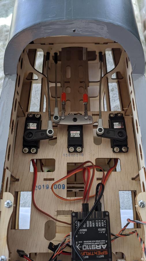

    I think I know what you're talking about. Let me guess... The control rods from the servos to the horns. ???
    You have to cut away some of the balsa to get them to move freely without friction , you end up covering the holes with those plastic covers though.

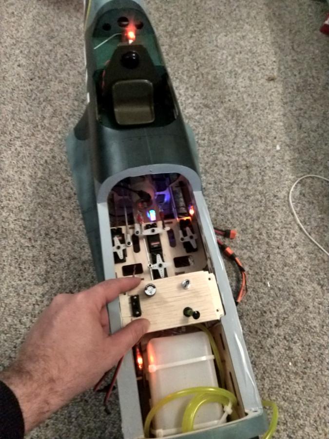

    ​​​ I ended up using the stock retracts , just replaced all the lines and valves with robart and a few restrictors to get that scale deploy. It works great , 100psi gets me about 3 cycles , I got a little Milwaukee pump to fill her up with.

      yeah there was an issue with the aileron control rods, which was an easy fix, but I also had an issue with my flap hinges not fitting right. I had to re-drill the holes on the wing to make them fit right.
      Oh well, all of it is complete and it seems to function.

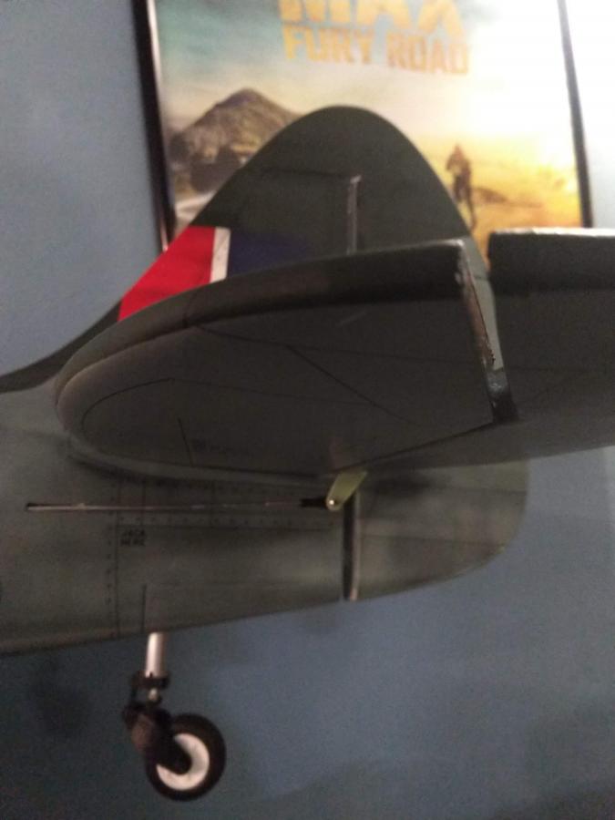

        ohhhhhhhhhh
        No no, cut the hinges!!!! jasmiller mentioned this in his post #49 , I debated drilling too, however cutting the hinges ever so slightly worked out much better. and I was able to cut each one so that the flaps fit just right.
        I think you are ok though, it's one of those Either/Or type of things. I think drilling may have been a little more frustrating, so i can relate. IMO, that's nothing really. Saying that the quality to price point is not up to snuff is moot.
        Just take your time on the tail section, get everything aligned

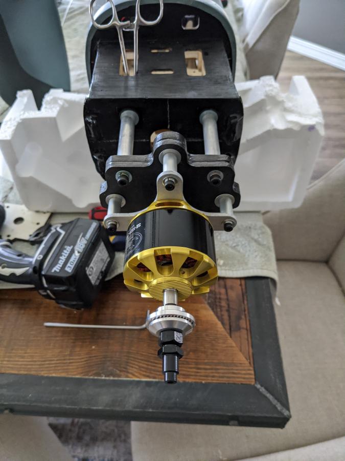

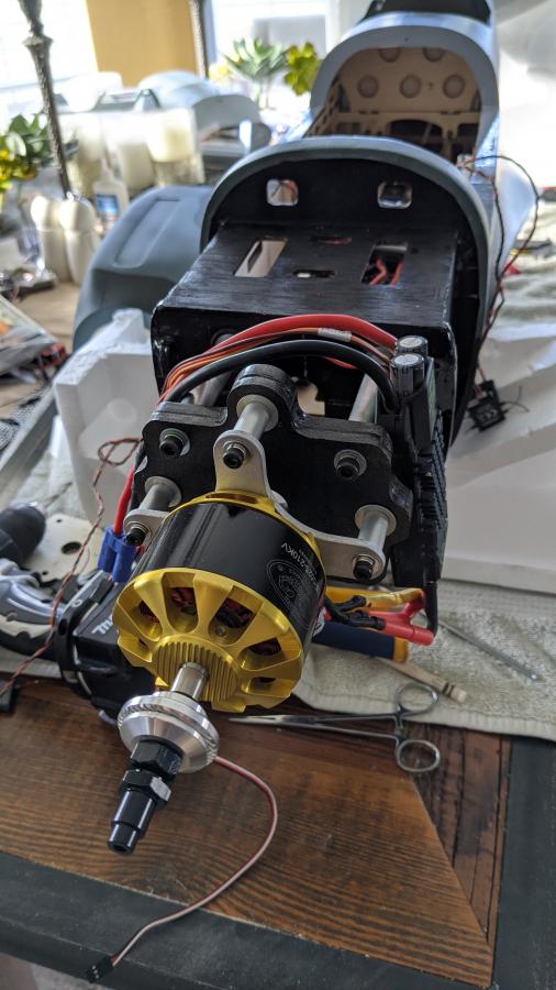

            #145

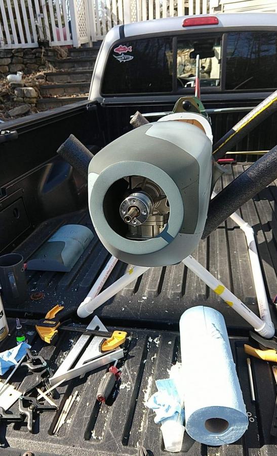

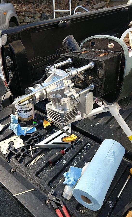

            Motor mounted and installed ,
            If you're using the templates , take your time. Ensure that the lines on the template line up with the lines on the firewall, DO NOT TAKE THE MANUAL IMAGES FOR GRANTED.
            The manual shows a picture of the templates fitting perfectly against the firewall. It does NOT. , use the lines on the template, that are Etched in the center. The lines that look like you're looking through a rifle scope.
            Match those lines with the lines against the firewall, you will see they are etched in softly.

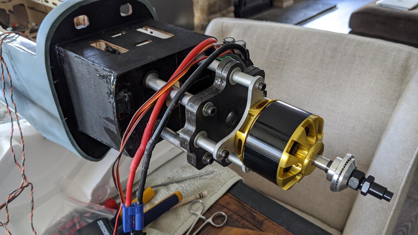

              #146

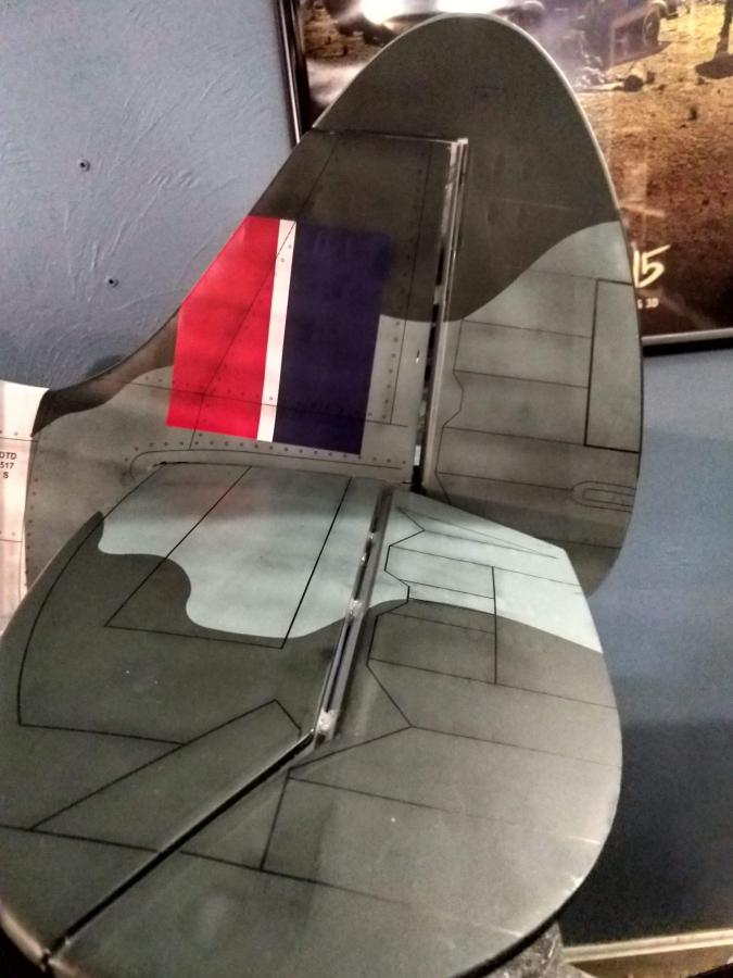

              ​​​​​I've been slowly working on the fuselage, and everything has gone together nice and clean. Things seemed to for better here, my only issue was that the tail wheel pull pull guide tubes weren't accessible from the rear and I didn't realize this until I had already connected the wires to the wheel control arms. I was able to feed a push rod thru the guides and pull the wires towards the servo bay, it worked out. I'm currently working on the motor installation, I had to create a new mount plate because the motor I chose doesn't match the included plates, and I'm going to have to shim the stand offs to get an additional 3 or 4 mm of length out of the apparatus. My motor is a tad shorter than what the stand offs were designed for. Nothing terribly difficult, I'm managing it ok.
              Has anyone noticed that the printed smoke pattern running down the side doesn't match the height of the exhaust pipes?I didn't notice that in the publicity photos, and it kind of bugs me. I think I'll paint some smoke on the cowl to blend away some of the discrepancy. Click image for larger version
              • downwind3zero
                I am the Warranty.
                • 50
                • Horsecountry, NJ
                #147
                Looking great cfreuen20! Nice and clean motor install!! Yes I also noticed the exhaust pattern, only needs a minimal touch up behind the stacks though. To be honest I don't think anyone but us modelers would even notice.
