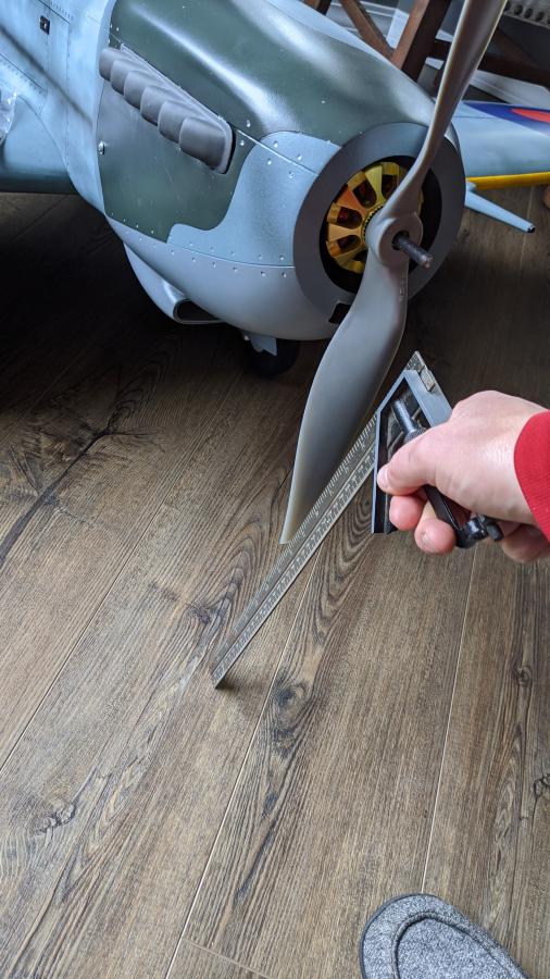

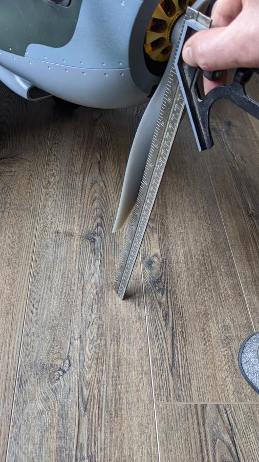

        Here is a 19" prop. In a parked position, it has 8" of clearance and in perfectly horizontal landing position it has 5" of clearance. That means my 21" prop will have 7" and 4" of clearance, and I can live with that - especially if this bird lands with a bit of an alpha angle.
          Looks Good, and Sounds about right on the prop clearance. I just got settled after work. Glad you got that figured out.
          I have a 18x10 prop on mine, it looks funny on such a big plane and figure I should return my 19" and get a 20x10. I'll ream and get it set on the jig and measure the RPM, between the two.
          I did manage to get it started up last night with the 18x10 prop on the DLE35, i will say that prop has no problem at all moving the plane.

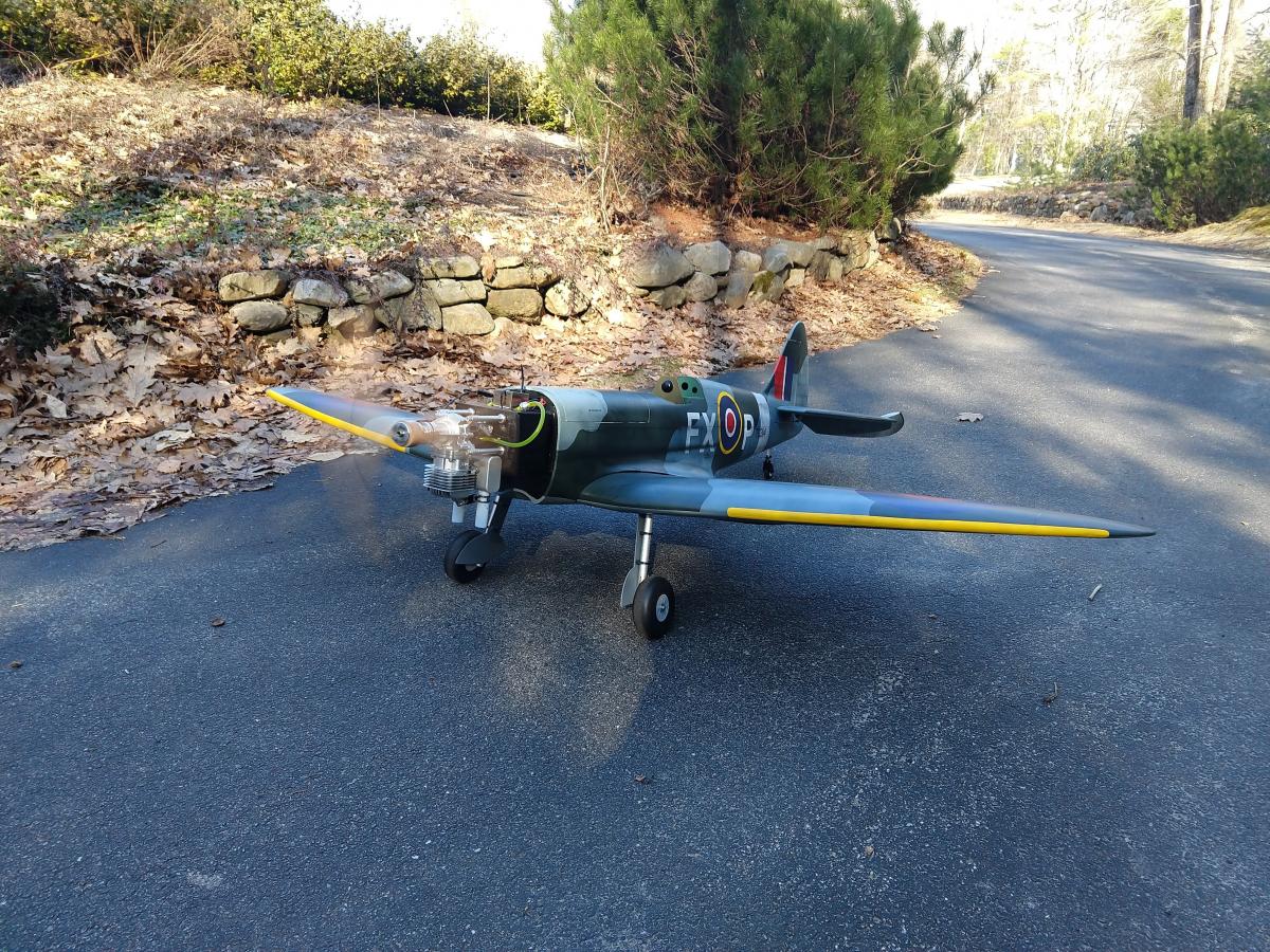

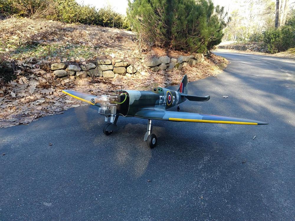

                      Was a nice day outside say i got er done....

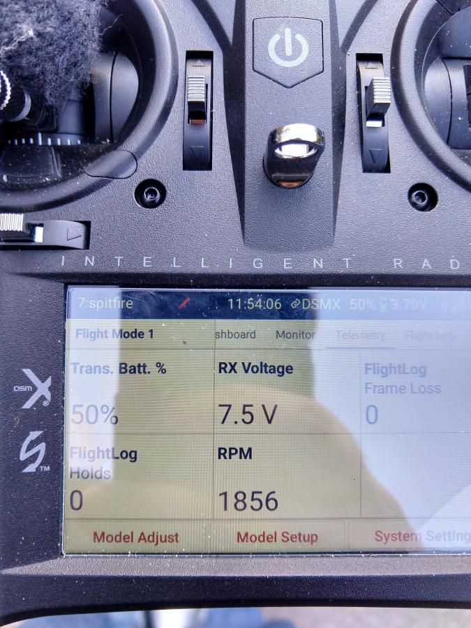

                      I have a 18x10 Prop XOAR, I'm pulling about 1850 @ IDLE. Which I believe is fine for the DLE35RA break in, however, @ half throttle, i'm already revving at 6000. So i'm interested to know what a bigger prop may yield.
                      Click image for larger version  Name:	IMG_20200331_163017015_HDR.jpg Views:	0 Size:	123.1 KB ID:	246066
                      I think I'll be able to get the RPMS a little lower once the engine is broken in.
                      Was thinking either the 20x8 or 20x10 ....

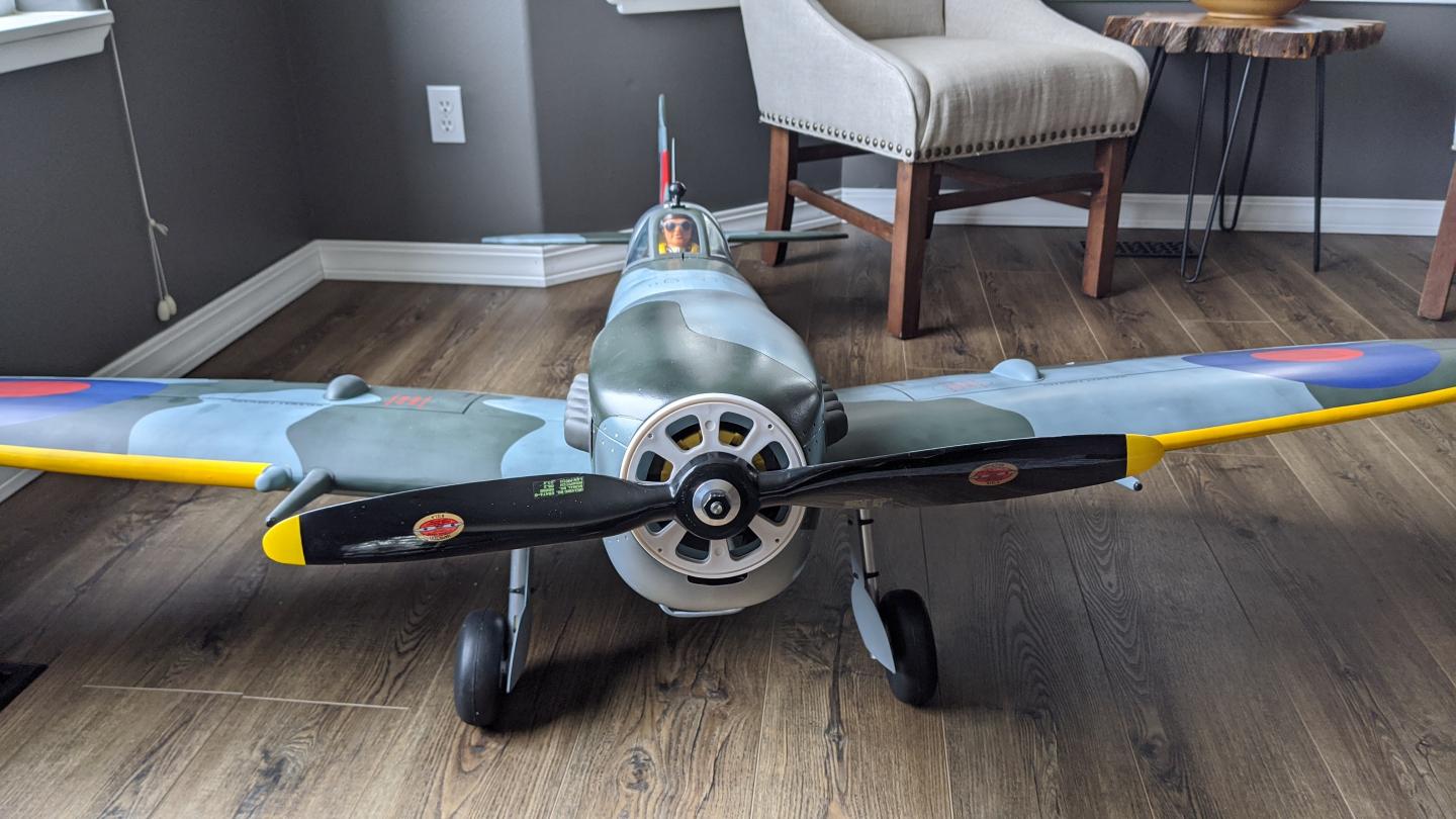

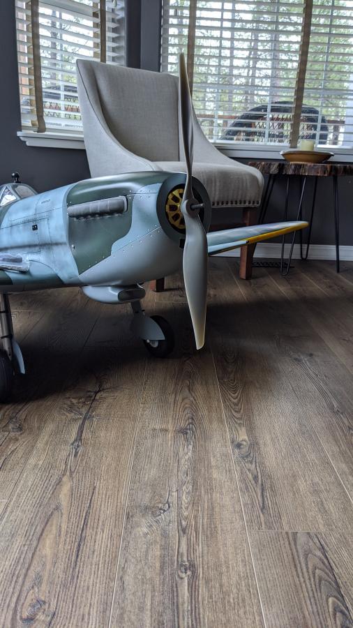

                        I've read that these biela props suck for performance, but damn it looks good! This one is 21x10 and I'm happy with it's size and appearance. I still have 3"+ clearance on a level landing.

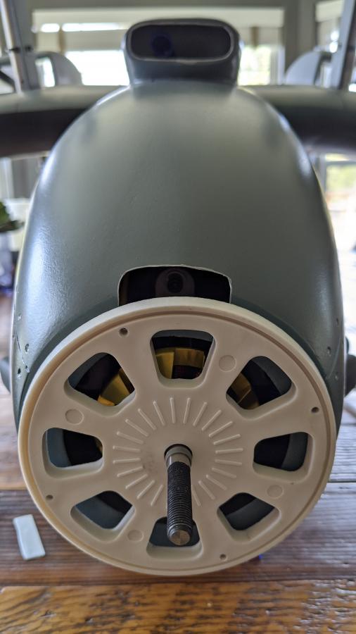

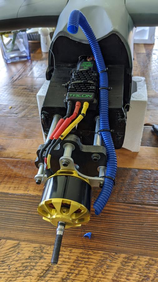

                          I needed a little nose weight, and I've been concerned about the airflow/cooling of my motor, so I came up with this silly solution. I couldn't vent the cowl in a way that gave me direct airflow to the motor - only the ESC. My hope is this brings cool airflow around the motor, and the vent hole creates a flow that pulls that air out past the ESC and out a hole in the rear of the cowl. It's all pretty well concealed.
                          Do you think it will work?

                            #173
                            Even if it doesn't work it's bloody brilliant!

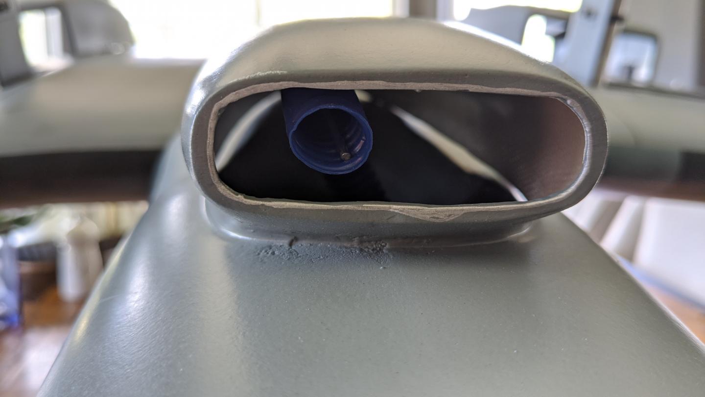

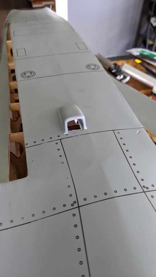

                                  I wasn't sure what to do with the extra aileron linkage cover that came in my kit, so I created a little cooling exhaust for me electronics. It can't hurt.

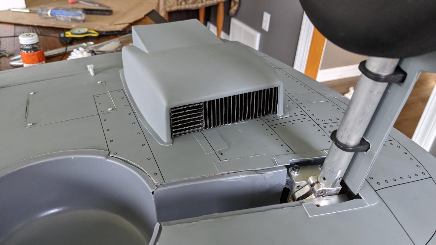

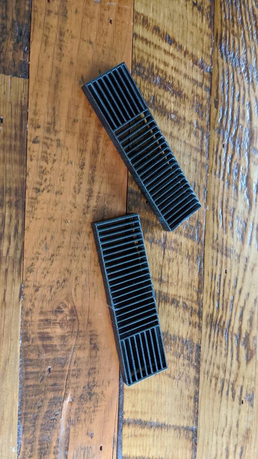

                                    I didn't like the look of the scoops, so I printed these grills, I think they turned out pretty well.

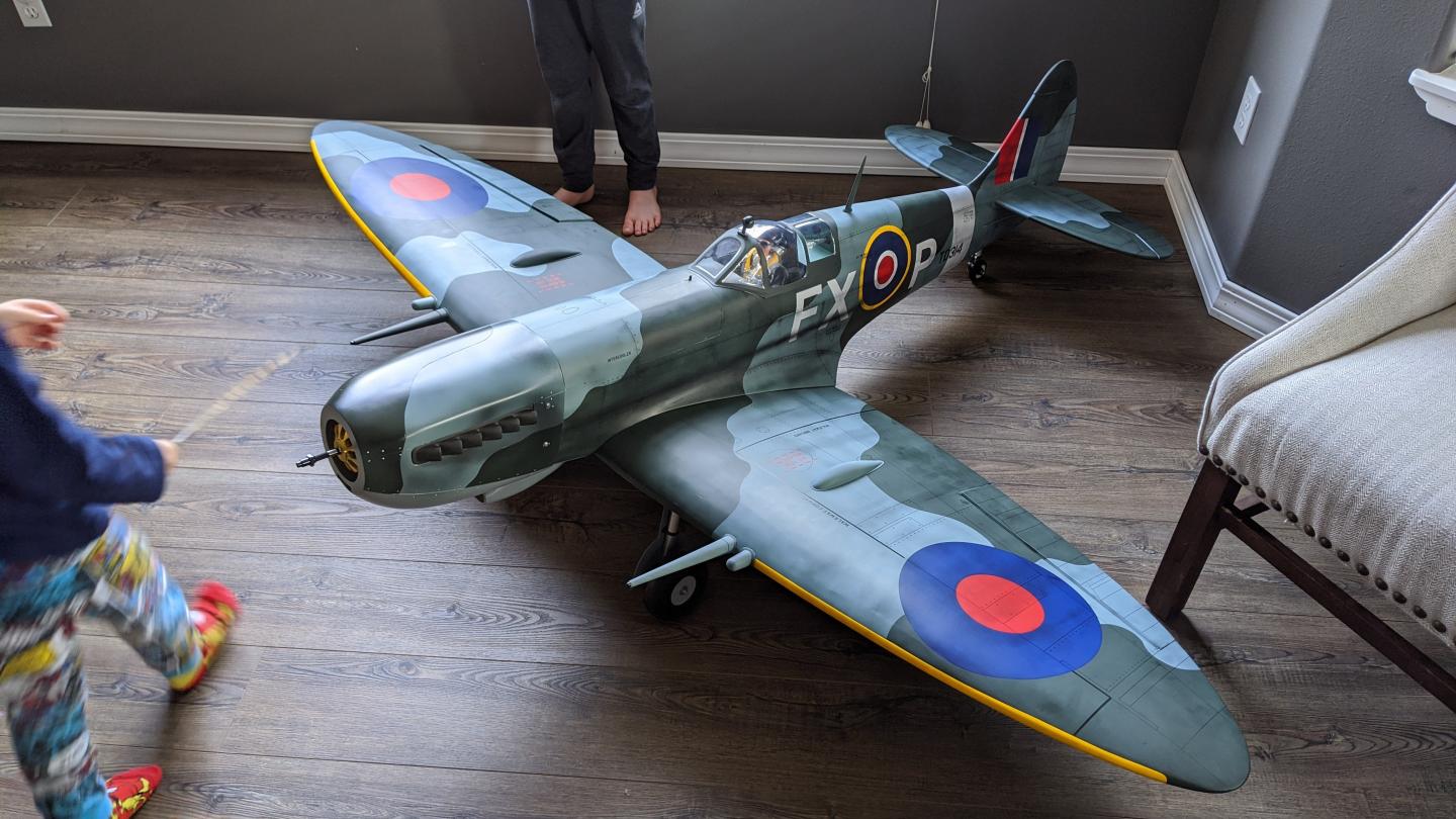

                                      My flying weight comes in around 18.5 to 19 lb, how does that compare to what others have gotten? I expected this thing to be around 17, but with all this Corona virus stuff forcing me to wait I just kept adding crap. Idle hands.
