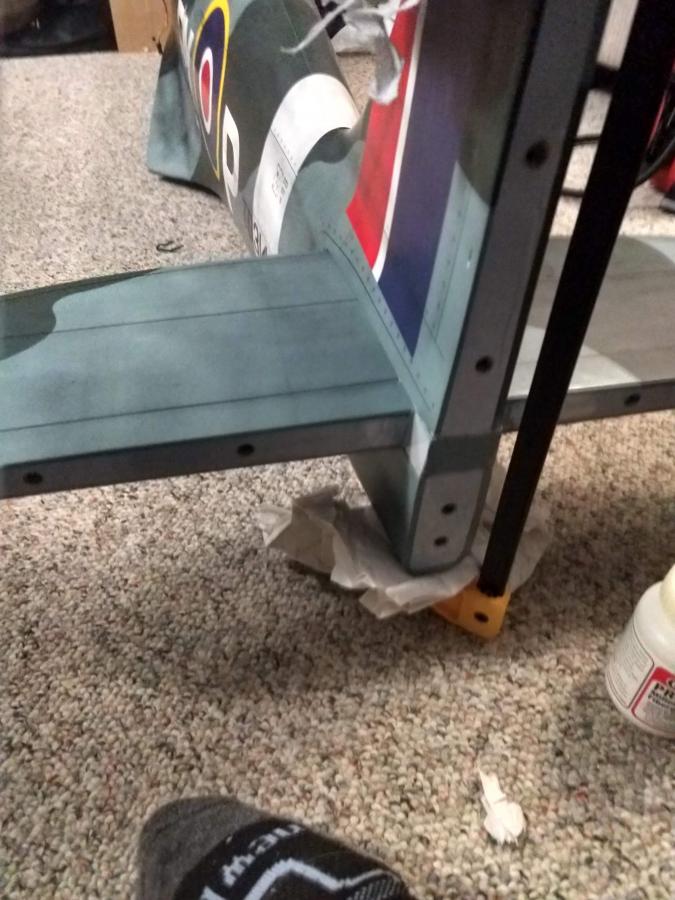

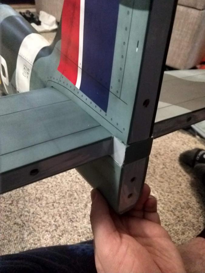

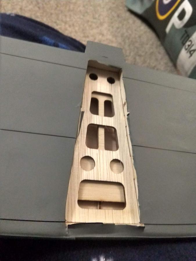

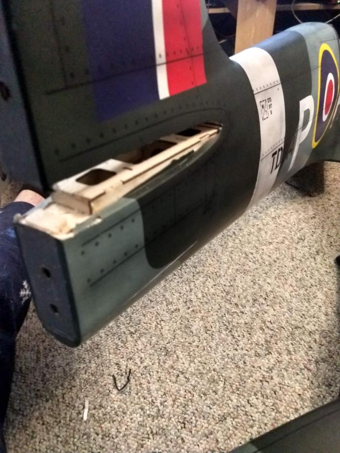

    Also got the stabilizer on. Took my time, about 2 hours prepping the cover , cutting away the bits. Dry fit about 6 times. it's straight and level. glad to see it all come together so easily. I also cut away at the top of the stabilizer so that it would have a wood to wood connection when epoxied. Setting with a clamp.
    Click image for larger version  Name:	IMG_20200218_224619886_HDR.jpg Views:	0 Size:	52.2 KB ID:	237165Click image for larger version  Name:	IMG_20200218_223815640_HDR.jpg Views:	0 Size:	95.0 KB ID:	237166​
    In these pictures, not the overhang of the covering. All of these jagged edges must be removed in order to get the stab, flush and level. I ended up trimming away the covering completely, all the way to the edge , The same for the bottom of the stab itself. Unfortunately , I never took pics of the finished solution, i was too eager to get it all together.
    Click image for larger version  Name:	image_50972.jpg Views:	3 Size:	65.2 KB ID:	237163Click image for larger version  Name:	image_50971.jpg Views:	2 Size:	100.1 KB ID:	237162
    Mixed up some epoxy with fiberglass resin and everything is great!

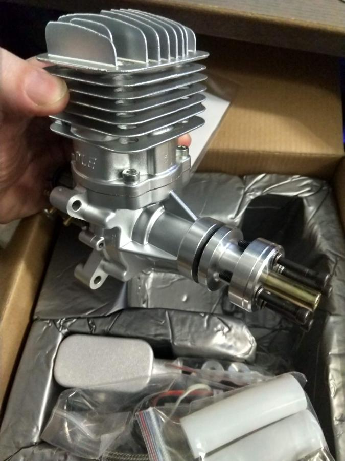

      I also started to check out the DLE 35RA, I picked one up , this will be the biggest gasser that I have in the hanger. Very excited!!

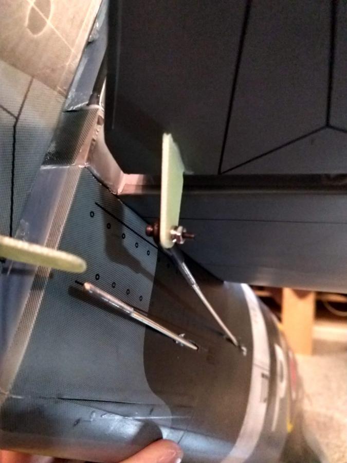

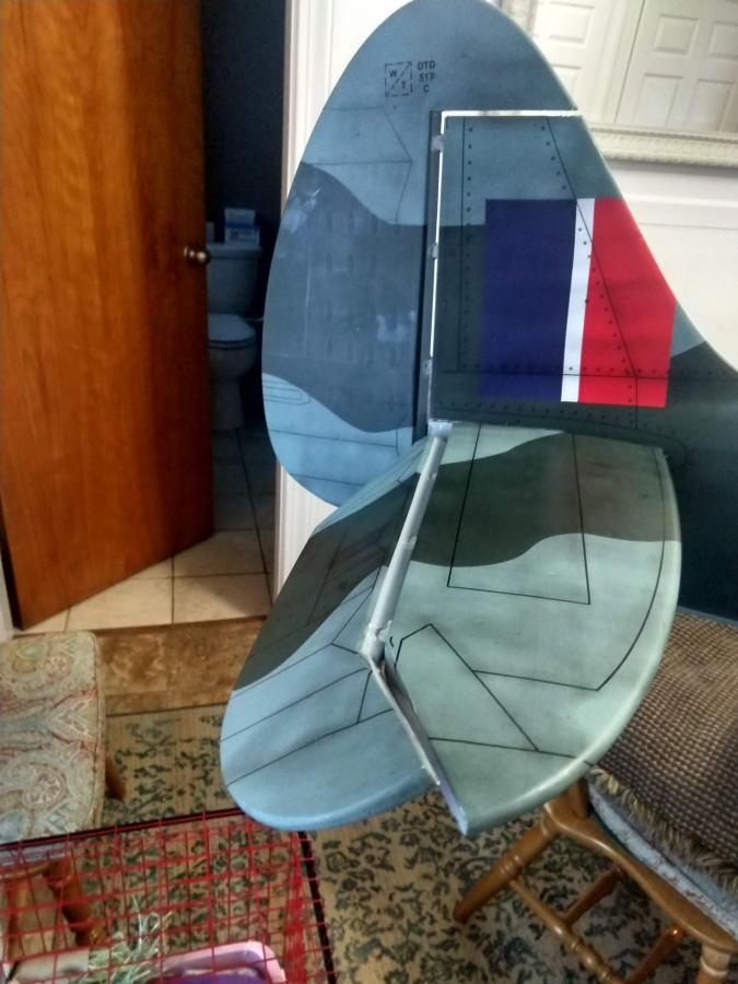

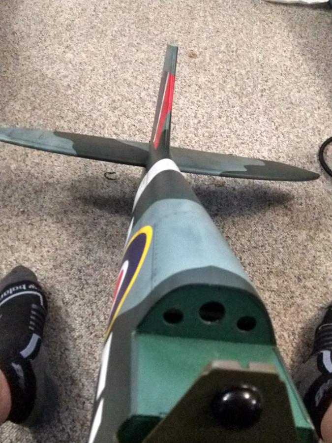

        Got the Stab and Rudder finished Thursday night .
        Click image for larger version  Name:	IMG_20200222_170807387_HDR.jpg Views:	0 Size:	70.8 KB ID:	237742​
        tonight I linked em up with the rods. Took my time, about 2/3 hours while watching the Midway Movie.
        I used Dubro ball links on the outside since they have more flexibility and left the stock ball links on the servo. I noticed that both inside and outside ball link should be rotated and tightened to its full extent, ( Until you can't rotate them anymore )
        I ended up using pliers to hold the rod while turning the links. Once snug they both line up pretty close to perfect. I didn't have to use any subtrim on the left elevator, but the right elevator I ended up sub-trimming about .15 - .20 not much..
        Click image for larger version  Name:	IMG_20200223_002208325_HDR.jpg Views:	0 Size:	61.9 KB ID:	237741
        Click image for larger version  Name:	IMG_20200223_002004916_HDR.jpg Views:	0 Size:	82.3 KB ID:	237740
        This is a quality plane again looking forward to the spring. I would love to have it ready early spring and perhaps bring it to Joe Nall this year!

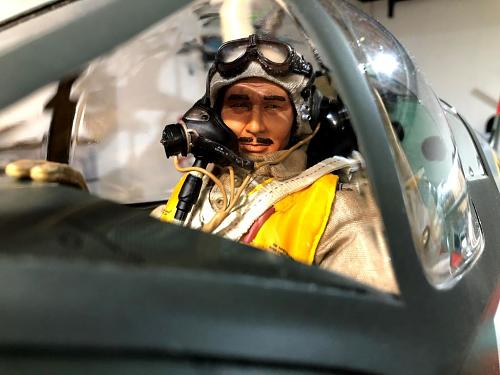

              Pilot signed up for duty Click image for larger version
                #127
                Nice!
                  #128
                  Nice is an understatement. DW3Z ........... Who makes that figure ??
                  • downwind3zero
                    I am the Warranty.
                    • 50
                    • Horsecountry, NJ
                    #129
                    Hey, I get them on eBay. Look for Blue Box Toys Elite Force WWII RAF Flight Lieutenant "Donald Moore". I use the same but the George Bush pilot for my turbine jets.

                        omg.. that pilot downwind3zero LOVE IT! ordering myself one. Did you have to chop his legs off?
                        • downwind3zero
                          I am the Warranty.
                          • 50
                          • Horsecountry, NJ
                          #132
                          Lower abdomen looks best for height.

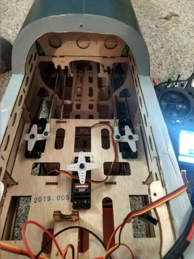

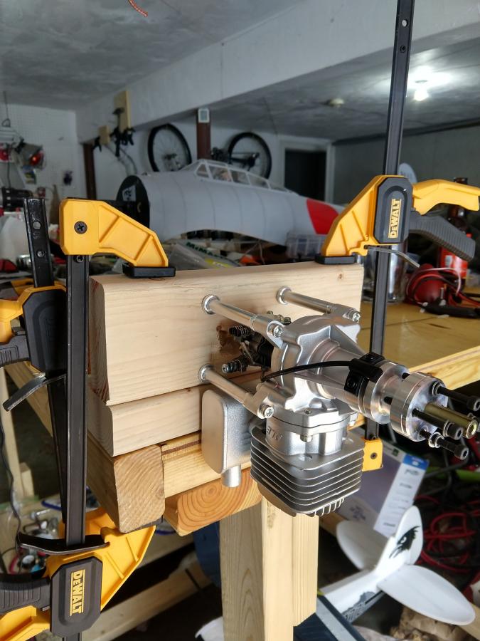

                                      I just finished the gas tank and got the engine mount d on the bench for break in tomorrow. I need to finish the rear pull pull rudder. , And that's pretty much it for the plane . Just get the motor in there and focus on the electronic from there. Click image for larger version
