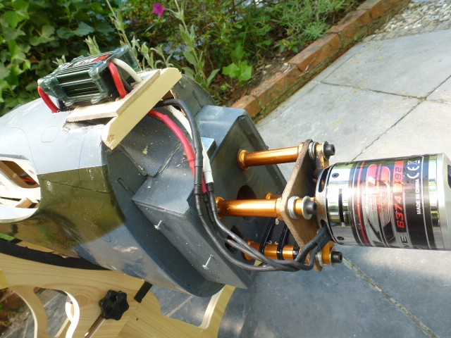

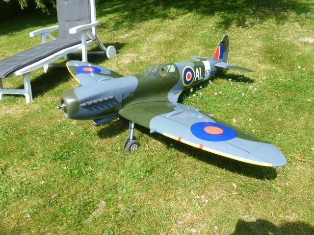

                                      I recently bought the older version of this model from another member of this forum, "timmybeetle". It is an electric version, with the Turnigy SK3 motor and a 120A HV ESC.
                                      He sold it without the propeller, and so I had to order one. I decided to order the 17" 3-blade Varioprop from Ramoser, and I later added 3 18" propeller blades to my order, to do some testing and measuring of power and current with the different setups. I will be running it on 10S. This combo was used by the previous owner, which made it easier for me to choose.
                                      I couldn't resist assembling it when I came home, just for admiration.
                                      Click image for larger version  Name:	P1100501.JPG Views:	0 Size:	137.9 KB ID:	315733
                                      As always, with any model that I buy, I started inspecting everything. And as usual, I started modifying some things.

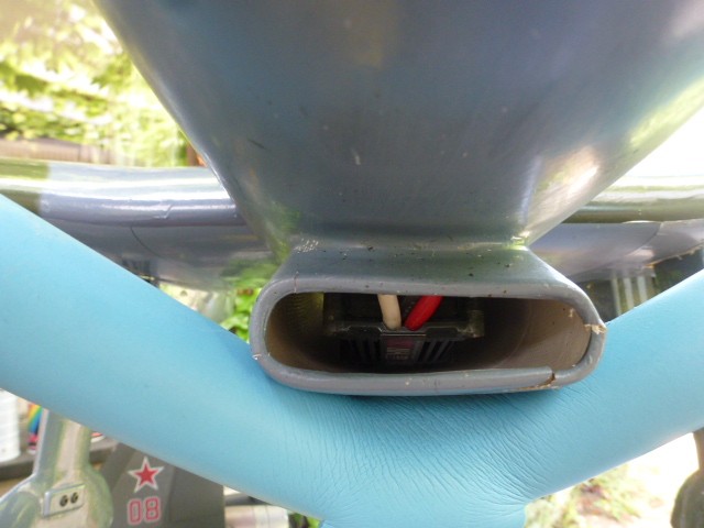

                                      The original owner/builder (it is now third-hand actually) mounted the ESC right underneath the motor, which wasn't very interesting in terms of cooling, and it required longer battery wires.
                                      I moved it to the bottom of the fuselage, positioning it right into the airstream of the air inlet below the nose. The motor wires were more than long enough for this, and it means that I don't have to make the battery wires any longer.
                                      Click image for larger version  Name:	P1100499.JPG Views:	0 Size:	99.9 KB ID:	315735
                                      When seen from the inlet, it is now sitting perfectly into a direct ram air stream:
                                      Click image for larger version  Name:	P1100503.JPG Views:	0 Size:	54.9 KB ID:	315736

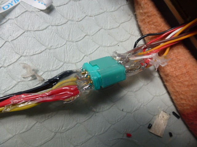

                                      I also soldered some new mpx plugs for the aileron, flaps and retracts, and put some hot glue over the solderings for isolation and mechanical tension relief
                                      Click image for larger version  Name:	P1100500.JPG Views:	0 Size:	77.3 KB ID:	315737

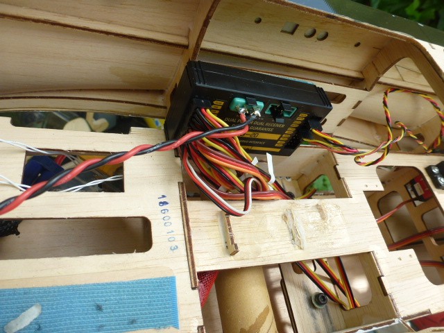

                                      To add dual power supply and dual receiver, I added the usual RB-20, which will also provide overcurrent protection for each individual output channel
                                      Click image for larger version  Name:	P1100504.JPG Views:	0 Size:	94.6 KB ID:	315738
                                      The very roomy fuselage makes cable management a breeze, and gives me plenty of room and choice to place the receivers.
                                      Awaiting the delivery of the propeller and spinner, I already programmed all flight controls, now I need to solder wires and connectors for the 10S setup, and add the telemetry.
                                      The RB-20 already provides me with a wealth of information on voltage and current of receivers and servos, possible lost frames, signal strength and such. I will add my trusted FAS-100 current sensor and calculate consumed mAh, and have it call out every 500 mAh consumed. I might add a cell voltage sensor, so I can cross-check the voltage at rest after landing with the measured consumption. I'm not a fan of measuring cell voltage in fight, as it is too dependent on motor current, making it hard to judge the state of the battery.

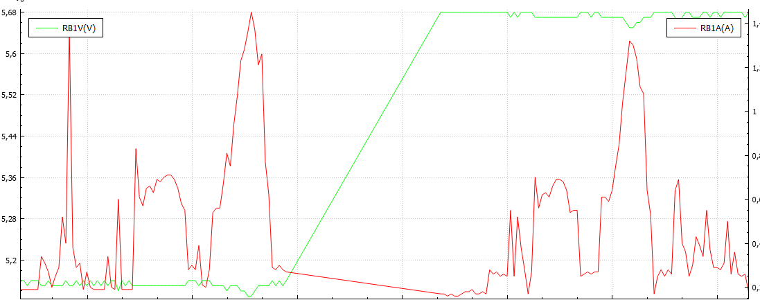

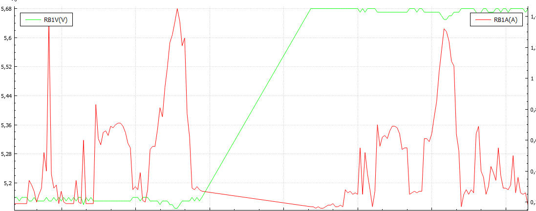

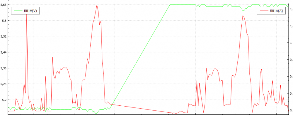

                                        While waiting for parts, I also researched whether or not I could run everything on a voltage larger than 5V. When I retract the gear at 5V, you can really hear it struggle.
                                        It seems that all servos and the retracts can handle 6V, so I took the plunge.
                                        The Yep 20A SBECs that I am using (one on the flight battery and one on a separate 3S receiver battery) can be switched to 5V, 5,5V, 6V, 7V and 8V.
                                        I first did some trials with 5V and 5,5V, enabled telemetry logging, then wiggled all servos and deployed/retracted gear:
Name:	Spitfire 5V-5,5V.png
                                        The current peak for gear retraction is 1,45A at 5V, while it decreases to 1,32A at 5,5V. The increase in torque can be heard: the retracts clearly struggle much less at 5,5V. As can be seen (verified with a voltmeter), the actual BEC voltage is almost 5,7V when set at 5,5V.

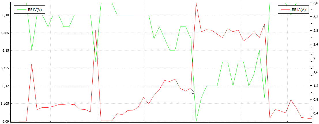

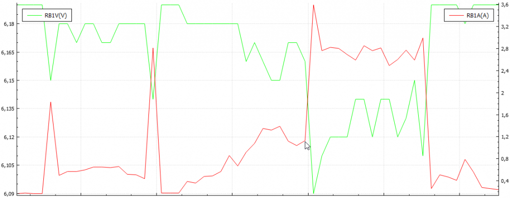

                                        I then switched the BEC to 6V, and the results were unexpected:
                                        For the same operations, the current almost doubled! The BEC output voltage is slightly over 6V (6,2V), which is clearly not appreciated by the servos and retracts. I didn't expect this.
                                        It is clear that I will be running at 5,5V.
