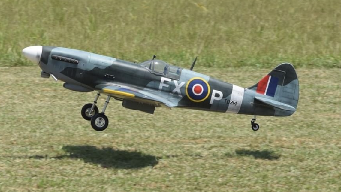

            Maiden today. NGH 38cc.

              [QUOTE=timmybeetle;n232186]Click image for larger version Name:	spitfire mk IX at flying field.jpg Views:	0 Size:	90.7 KB ID:	232187
              Building,
              Keep posting some more pics,
              I build also BH136 Spitfire, see my build on RCgroups link posted in previous post.
              I use a DLE30, but to set my CG I needed almost 1kg lead.
              So tail should be as light as possible, if I new it before I removed as much balsa,plywood from tail.....
              Flying it is easy it flies almost as a trainer, it has a lot of lift.
              I converted to electric retracts, using only struts and wheels from kit.
              Only after some flight I had a hard landing and stock wheels broke, plastic is not that strong.
              Good luck with building this beautiful plane.
              grts Hans
              ps I see that struts looking better quality than in my KIT

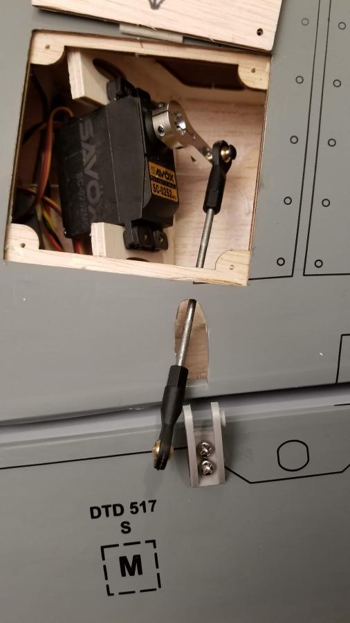

                                        Guys, I am dry fitting together and having a devil of a time lining up the aileron connection. What did you do to get this aligned? Move the aileron mount? Widen the hole towards the outside? Anything else to consider?
                                        Thx all.

                                          #200
                                          Try mounting like this
