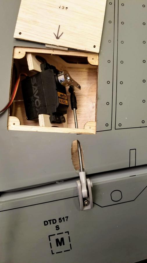

    Brilliant T007! Thank you! Remounted the ball link on the underside of servo arm and alignment much improved.

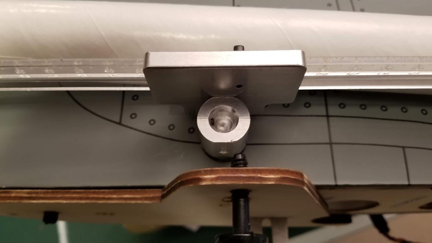

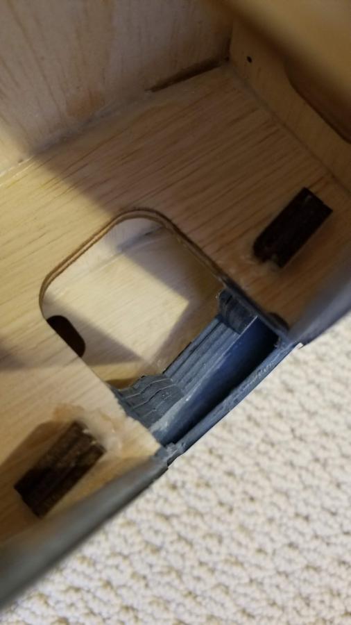

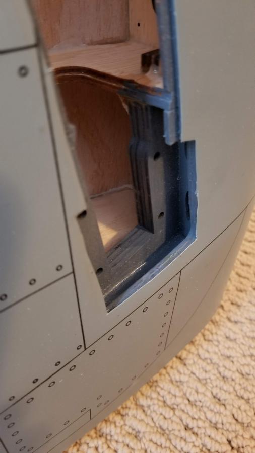

          While I am here, did anyone do any sort of reinforcement of the gear mount? If so, what, how? Cheers.... Click image for larger version

              Am currently building a Hostetler 34% mong racing bipe so this will be a nice plane to get together from a relaxation standpoint (but with frustration mixed in as well regarding anticipated fitment issues and supplied hardware)— still nice to get a plane like this in the air and not spend a few years building it. I have not started my build but reinforcing gear area in gear box area is always a good idea so long as weight is kept in mind. Lots of guys who have built the Mick Reeves Spit and The Meister Me109 reinforced the gear area beyond what the plan showed. Here, the manufacturing process probably went with lightish ply (am only guessing). At minimum maybe triangle stock and or CF fiber mat—-weight gain is minimal. I would also use Hysol 9462 vs regular 30 min epoxy— just my 2 cents without having really looked at this plane

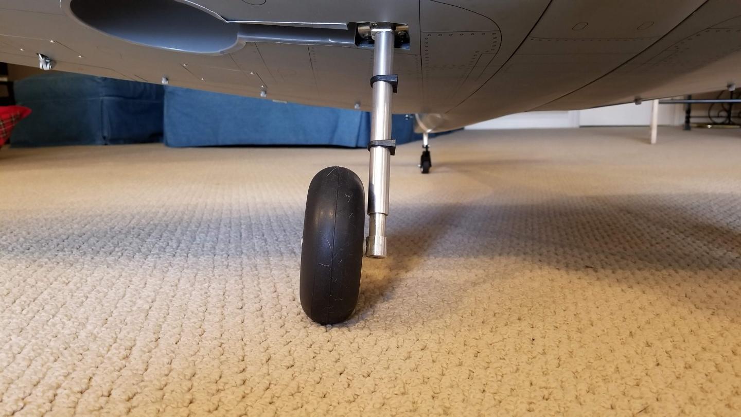

                          Guys, are your gear axles angled like this? Wondering if I should shim the retract unit to get them more parallel. Probably not worth the effort though.
                          Thx. A few more finishing touches and should be ready to go....as soon as the field dries up! Click image for larger version
