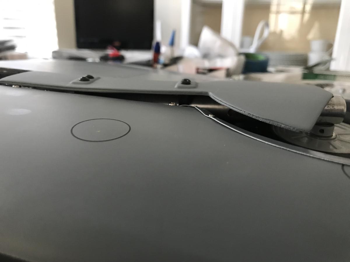

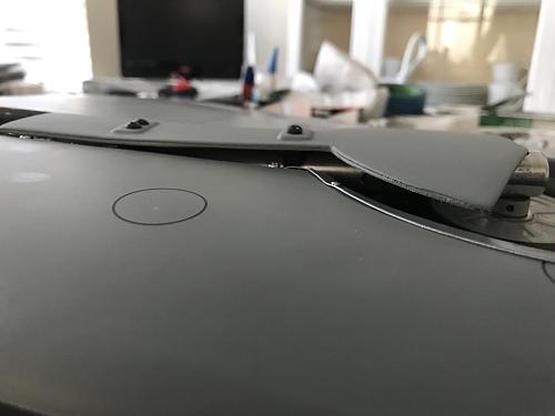

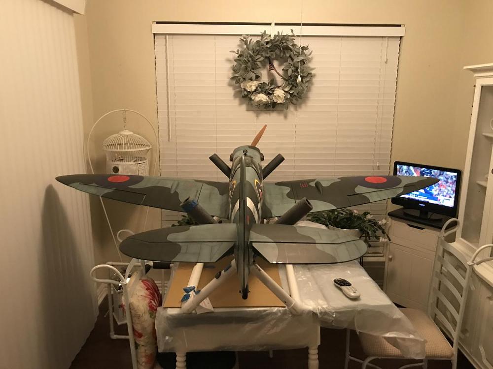

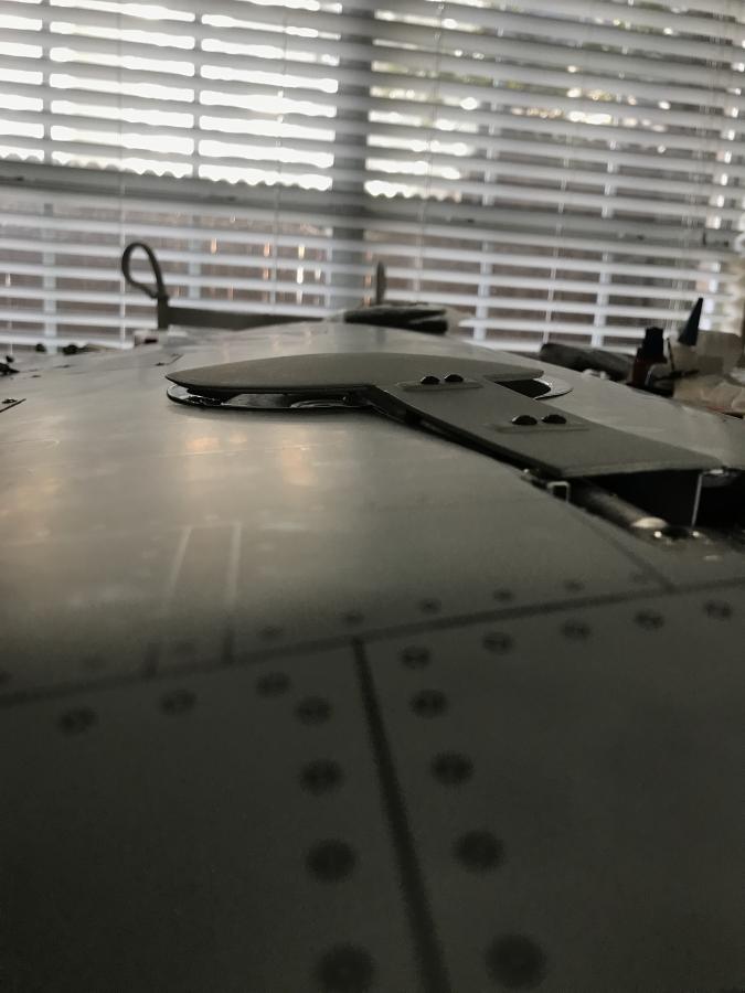

              Click image for larger version  Name:	IMG_4203.JPG Views:	0 Size:	54.4 KB ID:	326497 Worked on the wings some more tonight....laid in the Wheel wells and mounted the electric retracts and installed the Strut covers.....noticing they are riding really proudly from the wing surface. I have flown kits with similar issues (Gap)...a washer would set them closer to the wing but then that raises the retract flange from a nice flat support surface of the retract mounts.
              Did you guys have the same issue.....shimmed up the retracts and no issues from that?
              TwistedGrin

                #287
                Hi.
                I can't remember having an issue
                But i did put a spacer at the rear of the
                Unit to rake the wheels further forward
                Maybe cycle the retracts a few times just to make sure they are closing fully
                Ian

                  10:4 Thanks Ian - Hoping I don't have to resort to usung a spacer to close this gap.....it's a little more than I'd like to fly with. I am surprised the wing still performs with the faux scoops in front of the flaps. With all this hanging down from the wings I guess the gap of the strut covers means little to nothing regarding airflow anyway

                    #289
                    Ah yeah,
                    I opened my scoops
                    Ian

                      #290
                      Originally posted by North14
                      Ah yeah,
                      I opened my scoops
                      Ian
                      Ian - I am glad you mentioned this....I too was thinking about this....opening up both back and front ends of the air scoops. The 1600mm Flighline Foamie Spitfire has them open as well......makes much better sense to me to have them flowing through !!!
                      TwistedGrin

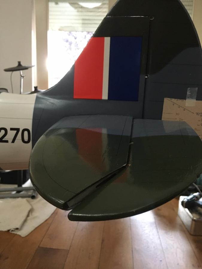

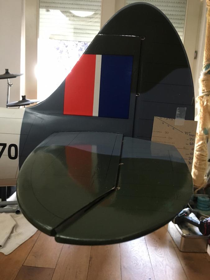

                              Note: I discoverd the Rudder servo needed to be rotated 180 from the two elevator servo's......suggest to assemble the rudder linkage first then work on the tail wheel pull pull.....otherwise foul language may insue as I had to cobble together some adhock repairs to my tail wheel cables after discovering this
                              Note: The tail wheel pivot arm may not clear the rear fuselage bulkhead thus preventing it from total movement. This also prevents the rudder from full travel and would eventually strip the servo. The remedy is to remove enough wood from the bulkhead to allow full travel of the tailwheel pivot arm. Additionally the cable crimp might need to be deployed forward of the bulkhead as it too might catch on the wood.....your kit and results may vary

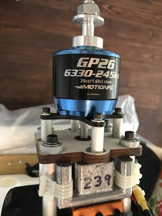

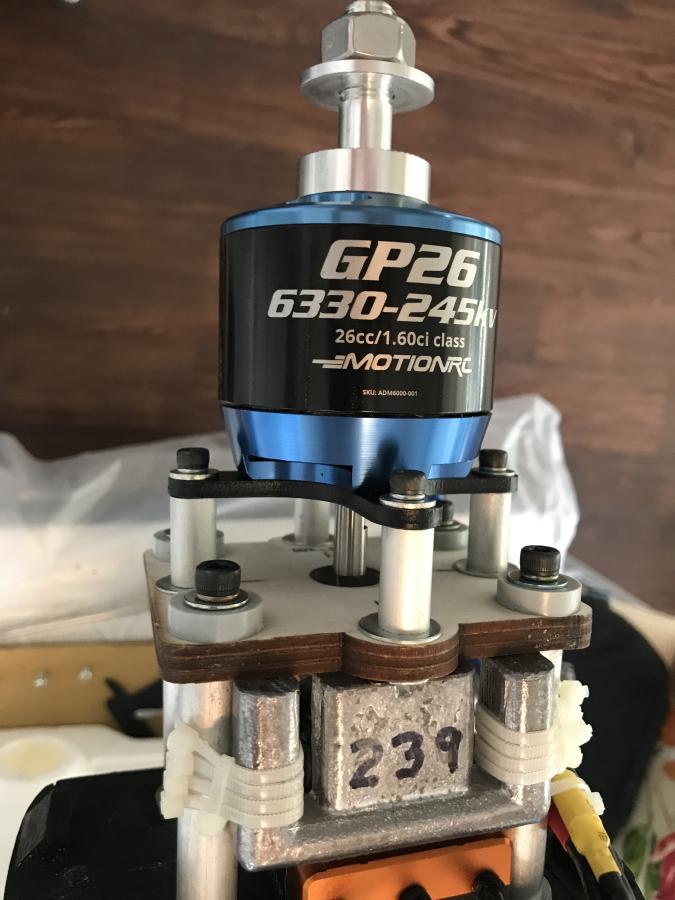

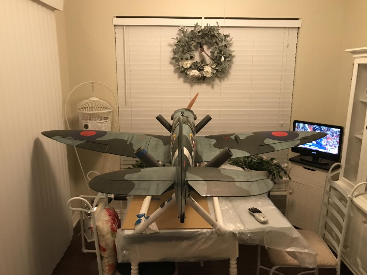

                                On the last stages of this moldels assembly....set my COG to 100mm using one half of a diver belt weight @ 239 grams right behind the motor. I am still waiting on the retract motor so no forward progress with the landing gear all the way yet. I need to se the pilot in, glue on the canopy, the start trying to come up with some paint detailing around the exhaust. CA did me no favors as I thought I would use a drop to help me get it held in place while I used FoamTac to set it all in....that plan failed. Removing the tape I used to secure the position while the glue set tore off the paint from the exhuast. Still need to figure out how I am going to attach the landging rear connectors each time at the field.....costom connectors or feed them through everytime.
                                TwistedGrin
                                • TwistedGrin
                                  Hobby Squawk..... CLEAR!!
                                  • 376

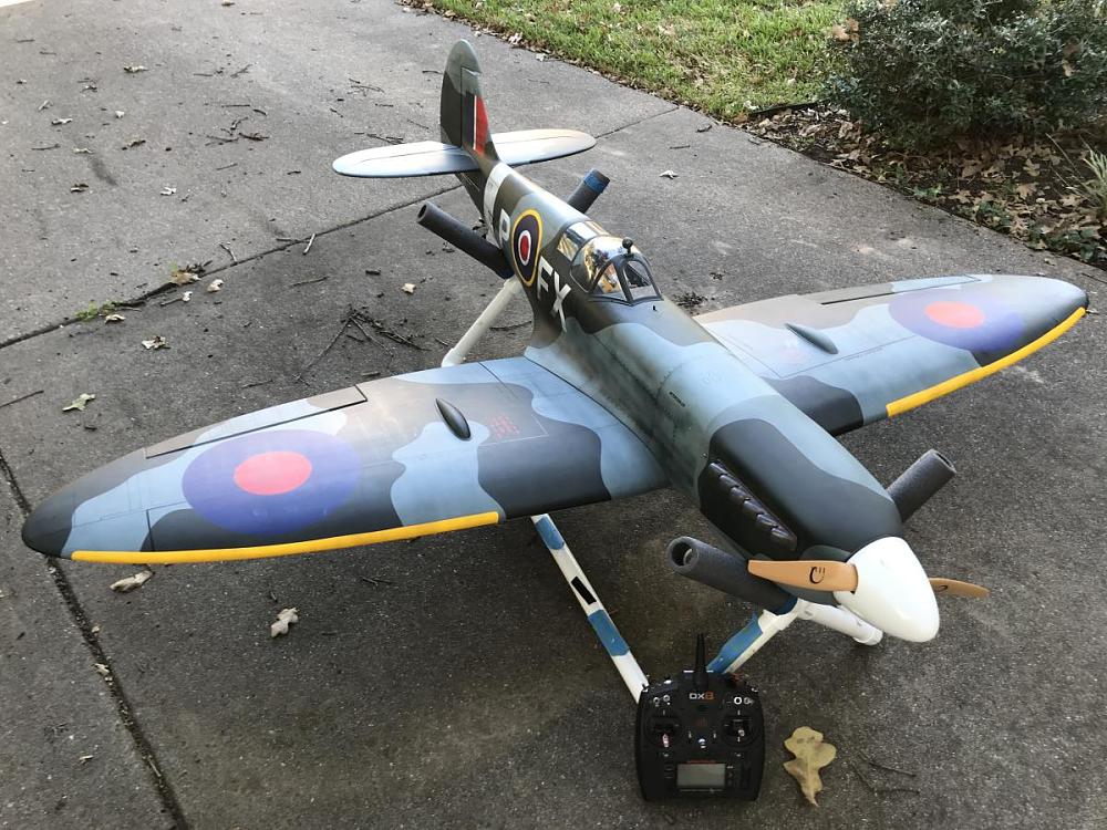

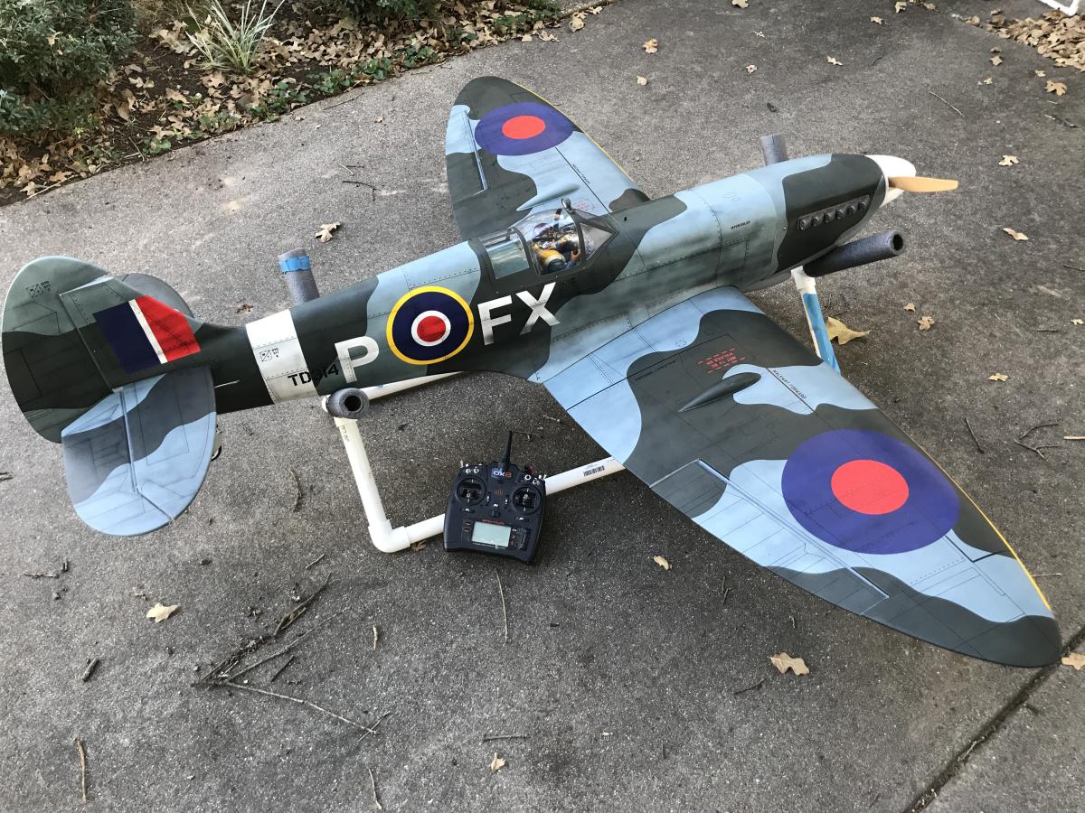

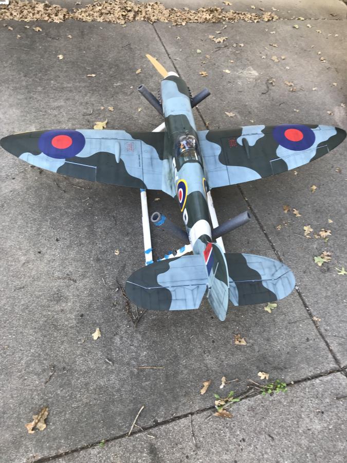

                                  #296

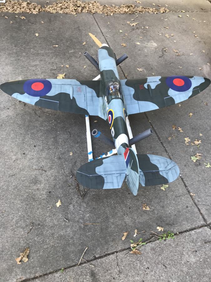

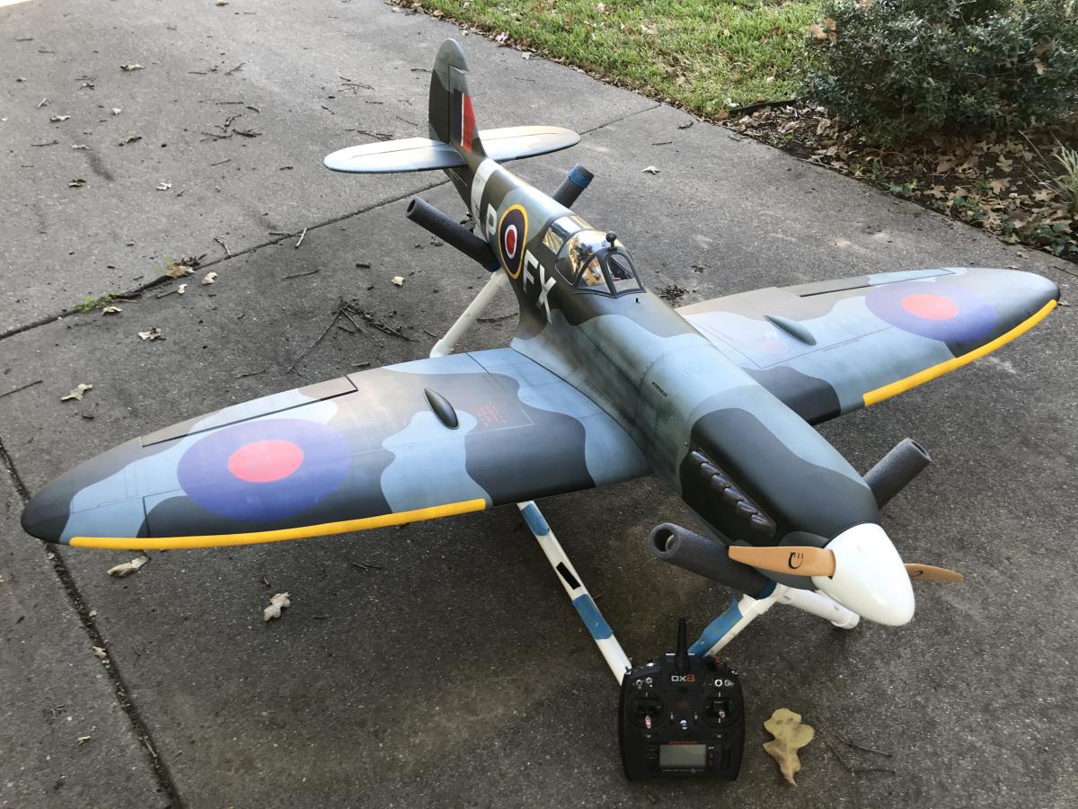

                                  Just waiting on replacement Electric Retract motor (DOA)...Blackhorse 78inch Spitfire.
                                  120amp ESC;
                                  10s 8000mAh LiPo / (2) 5s LiPo in series
                                  GP26-245Kv Motor / 78amp peak /
                                  2s 1300mAh Retract battery
                                  2s 2200mAh Life receiver battery
                                  Aura 8 to Spectrum Antennae reciever
                                  Falcon 18x10 W2E prop
                                  CG at 100mm instead of manual suggested 117mm
                                  18lbs total weight.
                                  Per eCalc: Level flight 73mph. This set up is calculated to provide 152watts per pound with an estimated flight time of 13minutes at 75% throttle.
                                  Click image for larger version  Name:	IMG_4228.JPG Views:	0 Size:	68.1 KB ID:	328191Click image for larger version  Name:	IMG_4233.JPG Views:	0 Size:	124.7 KB ID:	328192Click image for larger version  Name:	IMG_4239.JPG Views:	0 Size:	262.5 KB ID:	328193Click image for larger version  Name:	IMG_4241.JPG Views:	0 Size:	195.7 KB ID:	328194

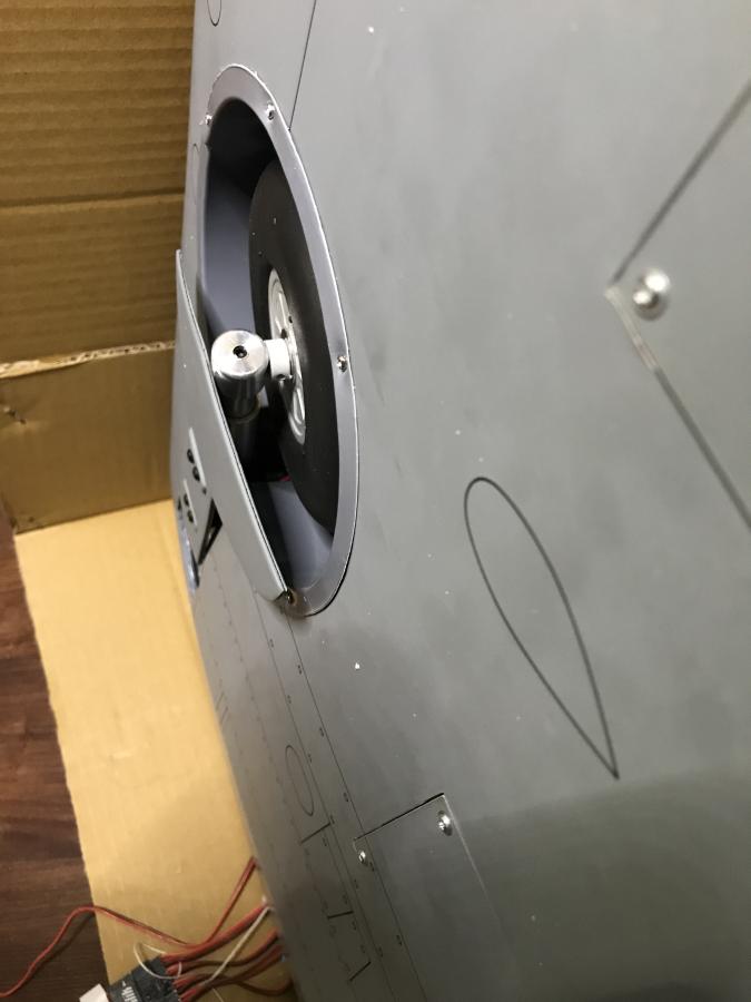

                                      Gents, What control throws are you flying with.....or betters stated - are the suggested throw rates provided in the assembly manual correct for this bird?
                                      I have three rates set up - Low (which is a couple MM higher than the low values in the manual); Mid (which is higher than the high rates in the manual); High (100% possible throw for taxi)
                                      Thanks in Advance,
                                      TwistedGrin
                                      Waiting for the retract motor Click image for larger version  Name:	IMG_4243.JPG Views:	0 Size:	100.8 KB ID:	328320
