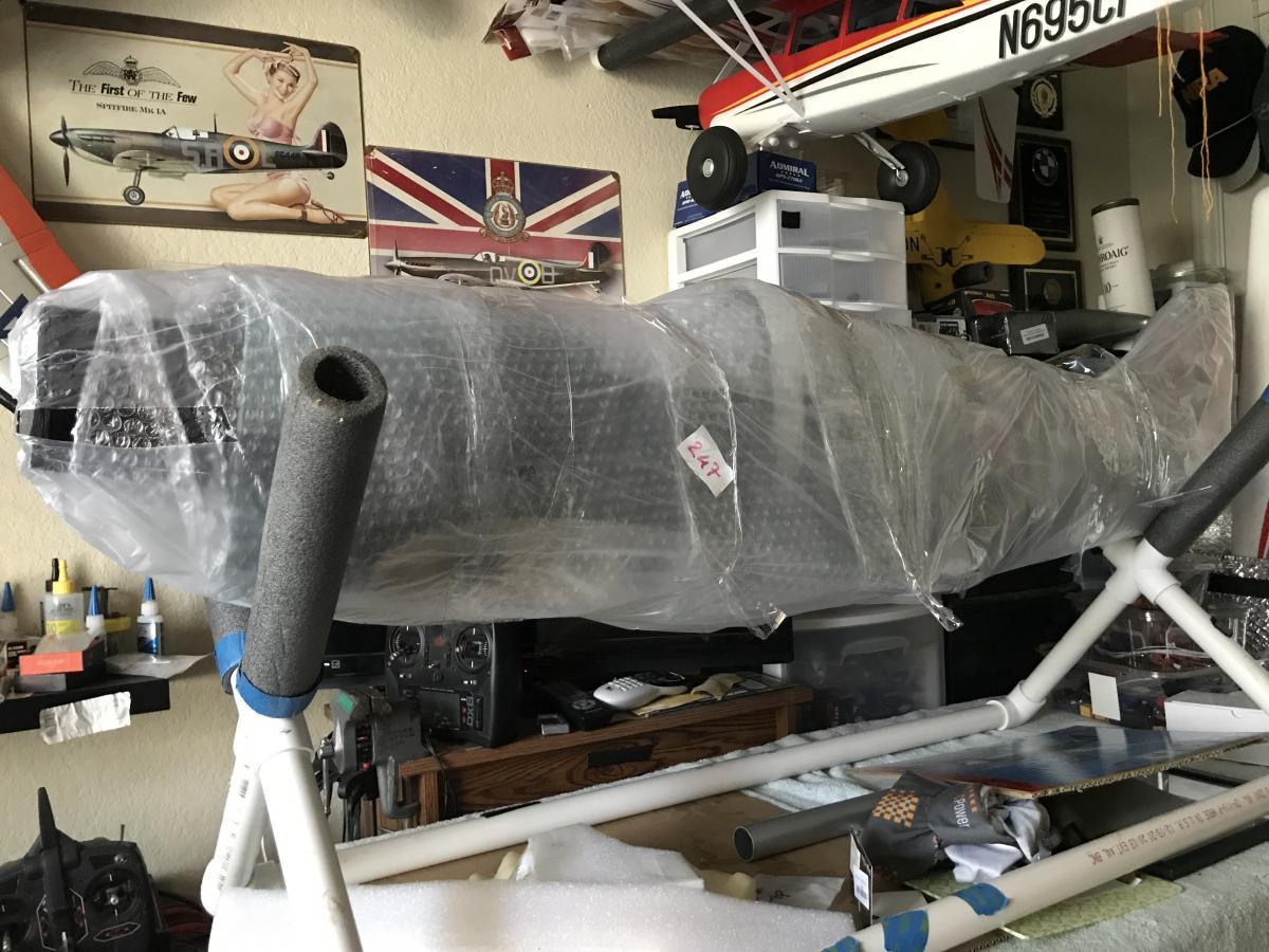

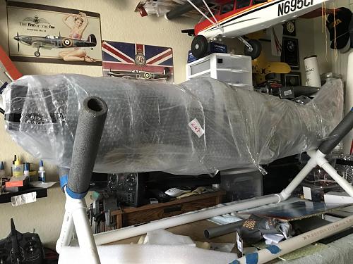

    I have made great progess with my assembly of this ARF....1. I have moved the box out of the barn ; 2. I have opened the box and set in in the office; 3. I have removed the fueslage and set it on a build stand.; 4. I have the assembly guide on my assembly table. Should be finished by January.

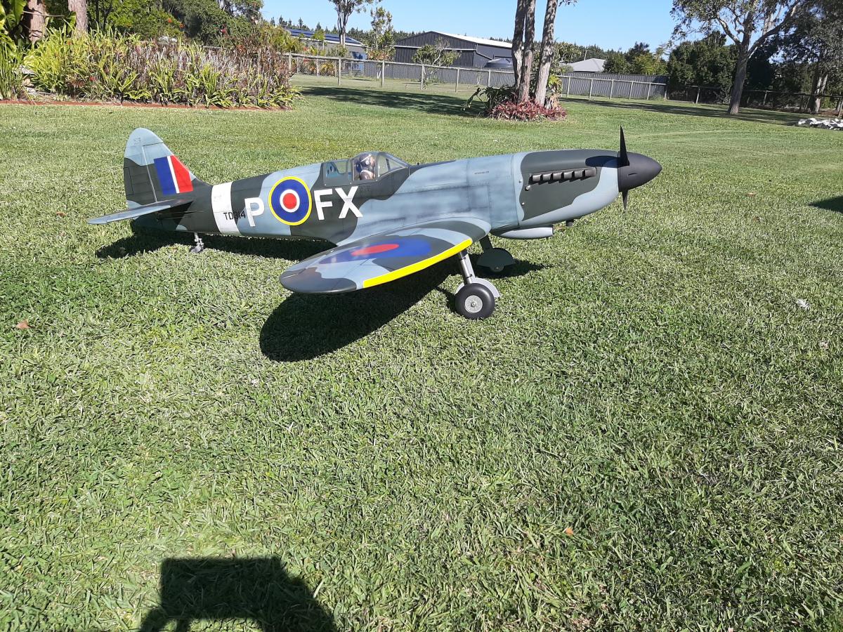

    Finally got a chance to maiden mine,
    So my COG set at 100mm from leading edge with empty tank. 8kg no fuel
    Ground handling and take off easy with with minor rudder input to keep her straight. Long scale take off with plenty of airspeed
    The plane itself flies nicely, 2 clicks of right aileron trim and was flying straight.
    I`m still having a few issues with my retract controller, 1 wheel sticks halfway up and has to be cycled again for it to go up all the way (Electric retracts)
    The DLE 35RA hesitated a few times so didn`t push my luck, i feel the power was down a little. Using an 18 x 10 prop
    No sign of ballooning with full flaps and landing approach was gentle with good elevator control. I could have landed a bit slower but was fairly nice.
    Will remove the cowl and recheck tuning this week
    Nice kit but keep it in the shade while not flying, was 30 degrees C yesterday and the covering was starting to wrinkle after about 10 min
    Ian
