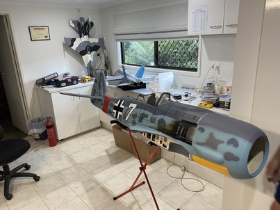

I had the BH Fw-190 come into my workshop noyt that long ago for a bit of a look see and measure up. Very light for it's size. I have been nothing but impressed with Blackhorse's building techniques of late.
Overall the finish is ok for an ARF. Without taking to it with a scale 3-view, I think the overall shape is not too bad, there is something not quite right with the gun troughs in the cowl and the gun hood lines could have been done much better. The Kit comes with a sliding canopy but the way they have done it leaves a lot to be desired in terms of scale. It's going to be interesting to try and fix/hide it.
The landing gear is a bit meh, I think they will be strong enough to do the job, but they do look a little cheap and nasty, and overall about 50mm shorter than the sierra 1/4 retracts which themselves are another 10-15mm shorter than scale at my rough measurements, but considering they come with the kit for the price...... bang for buck she is definitely very impressive. A set of sierras and wheels is is not that much less than the cost of this entire kit with the landing gear included!!
Lengthwise for the fuse she is roughly the same size as my ESM Fw-190D, maybe the A has a couple more inches in length only, but she is significantly larger fuse diameter as would be expected. width of the cowl at the firewall is a whopping 330mm!!
This one is powered by an EME120,, and is ready for it's maiden... the next 3 coming in will be powered by the new DLE-130. these flop about in the cowl its so big. I think it will be waaay to much engine for this model but hoping to use the excess power to spin a bigger prop. looking in the region of a 27-28" 3-blade with the 130's. Scale would be in the 32" range so should look the part.

Very tempted to strip and glass from the outset and try make it look a little more decent. I actually think it can be made to be a very decent looking model if the time is taken on the exterior. Those holes in the flap structure will sure add a fair bit of time to fill in.

Hi Dave, I hear you about some of the parts looking off. I would like to have a better spinner the prop bolts wanted to breakout on the backplate lightening holes. The plywood is not as hard as birch and I might zap a lot of it in the cut and mating joints. The Home Depot is selling the same plywood made in Viet Nam. I made my plane stands from it. The flaps I would use fabric coverite and paint. Adding weight aft of the c of g is rarely justified.Comment
Thanks for the heads up about the softness of the engine firewall. Adding glass/carbon is well justified then. Might have to look at doing the same myself. The next 3 kits are due to arrive in about 3 weeks time, and one of those will be mine.
I am working with a local guy who spins up the spinners and then machines backplates up to suit. He has a very scale shape for it now. He is just waiting for me to give him the final dimensions for the distance we need from the back of the prop to the back of the spinner and he will start manufacturing the first ones.
