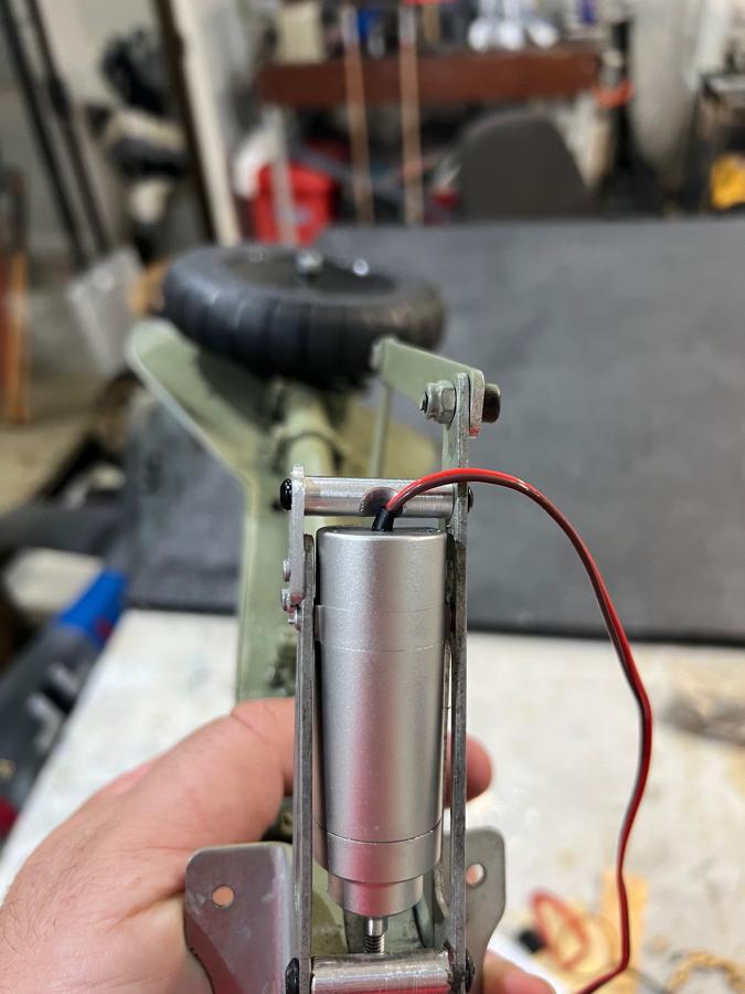

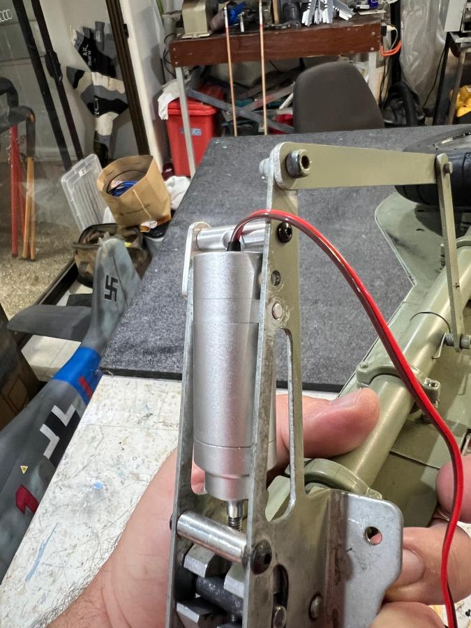

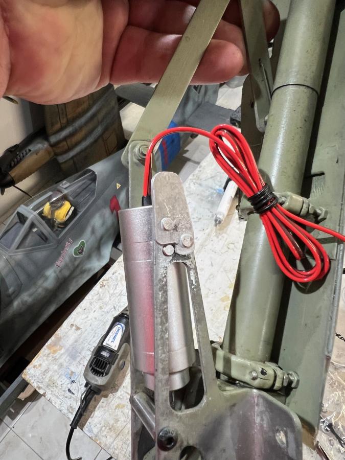

                            So after battling with the gear struggling to go up and retract fully in flight, I set about upgrading the stock retract actuators.
                            A bit of measuring and borrowing of a friends spares selection and the JP ER-200 actuators will fit and replace the stock ER-120's.
                            As you can see in the pic's as the ER-200 are longer, I had to make an extension plate to one side of the retract housing, and then I also turned up a joiner pin, but they all still fit into the wing without a problem. On the test cycles of the gear, I modded one Leg and left the other stock. Chauk and cheese, The stock ones labored and slowed down a lot and took about 3-4sec longer to cycle. The ER-200 leg did not hesitate at all.
                            Test flight should happen in the next few weeks if the weather plays nice for a change.
