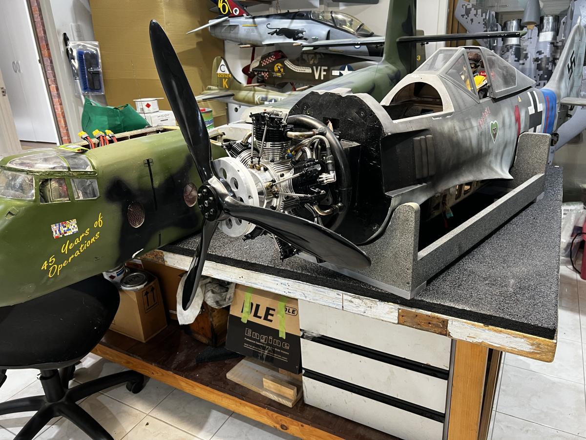

                #127
                Originally I flew mine with a DLE-130 and it was way too much power for it. I’ve also seen one fly with a 120 and again, it was more than plenty.
                as for balance. I put my battery’s just very slightly in front of the CoG. So no need to go crazy with nose weight with this one.
                when I upgraded to the radial, I’ve had to put all 3 batteries in the tail. Actually the packs are under the removable hatch next to the Tailwheel, so a little unusual for a big warbird.

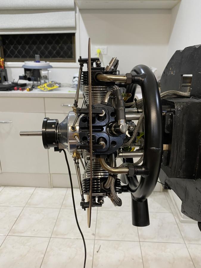

                                    I have a friend working on the Black-horse FW190 for me. He said there is a problem putting the UMS 180 engine on the firewall. I have looked at that great video someone has on YouTube with that engine on it. My buddy clued me in and if you freeze and zoom in the part where the engine is mounted and the cowl is off, you can see that the bottom left bolt on the engine mount is not there. Is that the way this was flown, what needs to be done to mount the engine? I know it is possible. Any help would be really appreciated.
                                    Thanks,
                                    Matthew
                                    Fox Valley Aeroclub, ST. Charles, IL

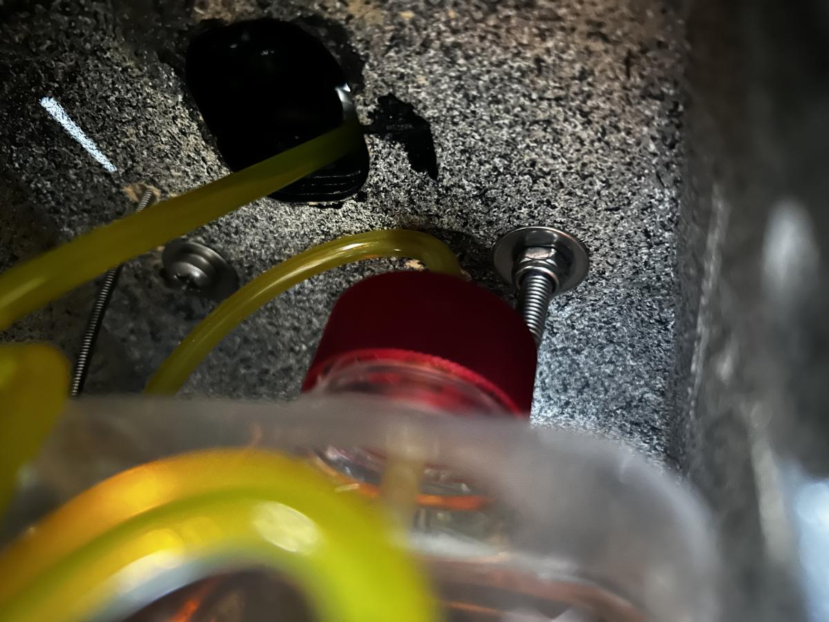

                                          #140
                                          Yeah that’s me
                                          No it never even ran in that state. The solution was just to have the head of the screw on the inside. From memory I also had to remove a little material from the engine sidewall plates that stuck out proud of the firewall plate. Not all of it but just the bare minimum to get the engine mounted flat.
                                          the firewall does compress a little so every 5 or so flights I rechecked the engine mount bolts. After the third check they had stop moving too much.
