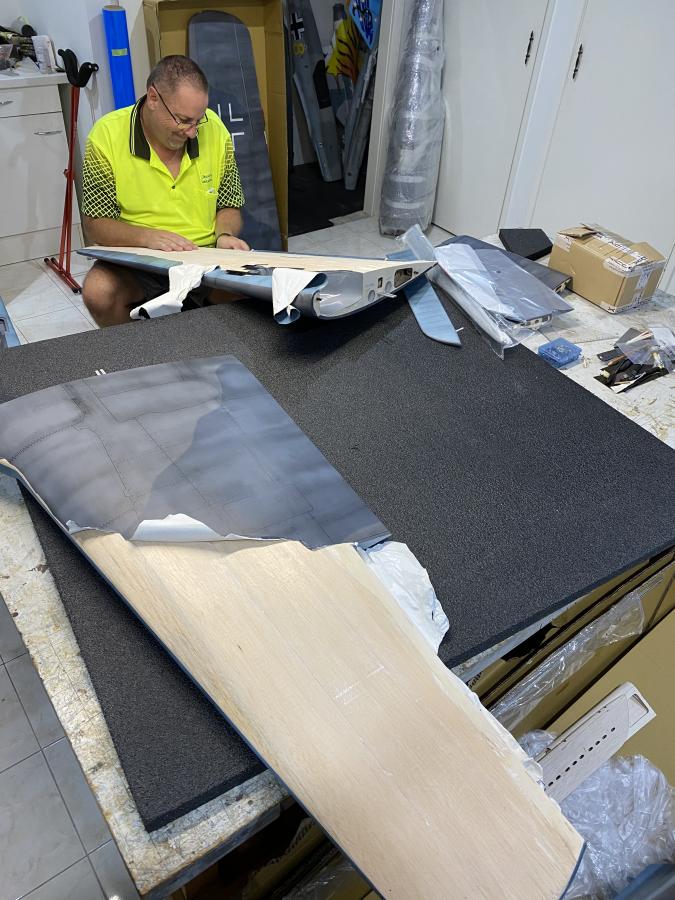

                              Haven't flown mine yet, in fact I've gone the opposite way with it to be honest..
                              I've got 2 buddies who are very close to being ready to fly. I'm hoping within the next week or so now that the model fields have opened up again post COVID.

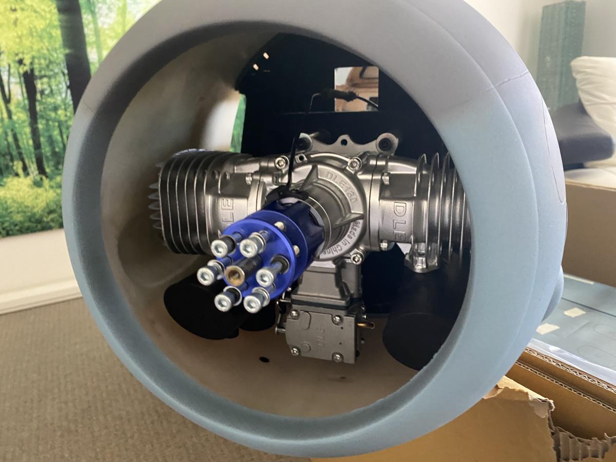

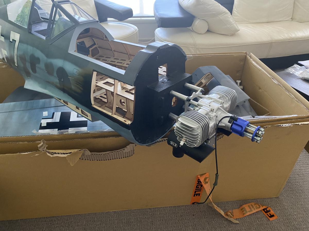

                              I mounted up the DLE130 to see how it was all going to fit up. It was all good and plenty of room in there as expected. The anchor nuts they have glued to the firewall do not accept the M6 engine mount bolts they supply in the kit! they look to be M5 maybe....???

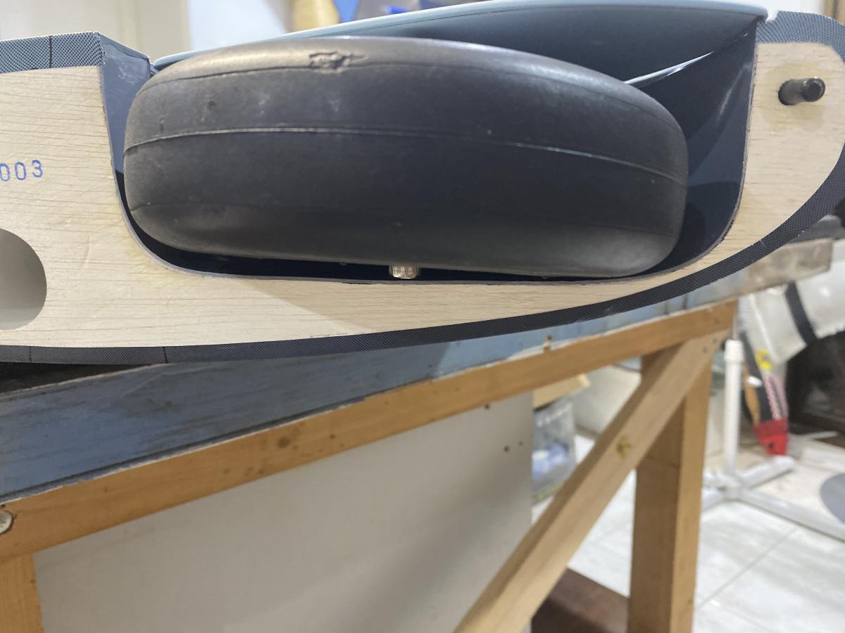

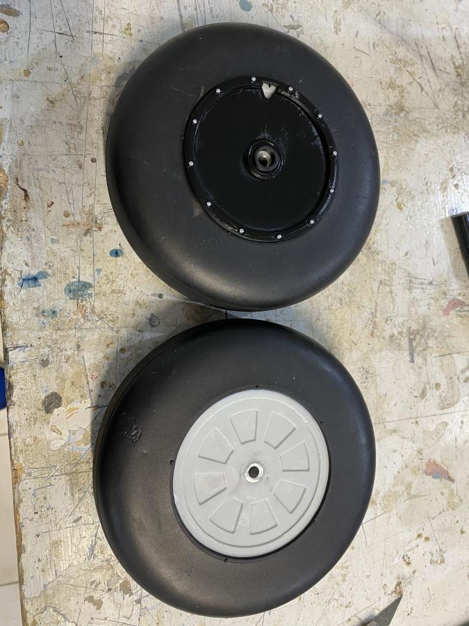

                              I've included a pic of the new wheels that come with the kit. They are better than the original ones, but they are very very fat tires. so much so that the wheel will contact the top of the wheel well so some shimming will be required to clear that and make the best of it. I'm still looking at better options for the wheels. In the mean time I have drawn up and 3D printed up some more scale wheel hubs that just stick over the kit wheels in case I do end up using them.

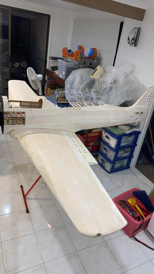

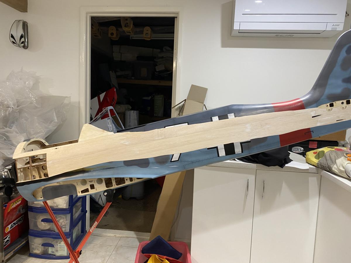

                              I then started stripping the covering off the whole model. AS you might be able to make out they have modified their lightening holes and they are now smallish ovals. lots of them.... on every surface... I have found a solution and will show what im going to be doing with those shortly. The covering didnt give too much grief to come off which im not sure if its a good thing or not.

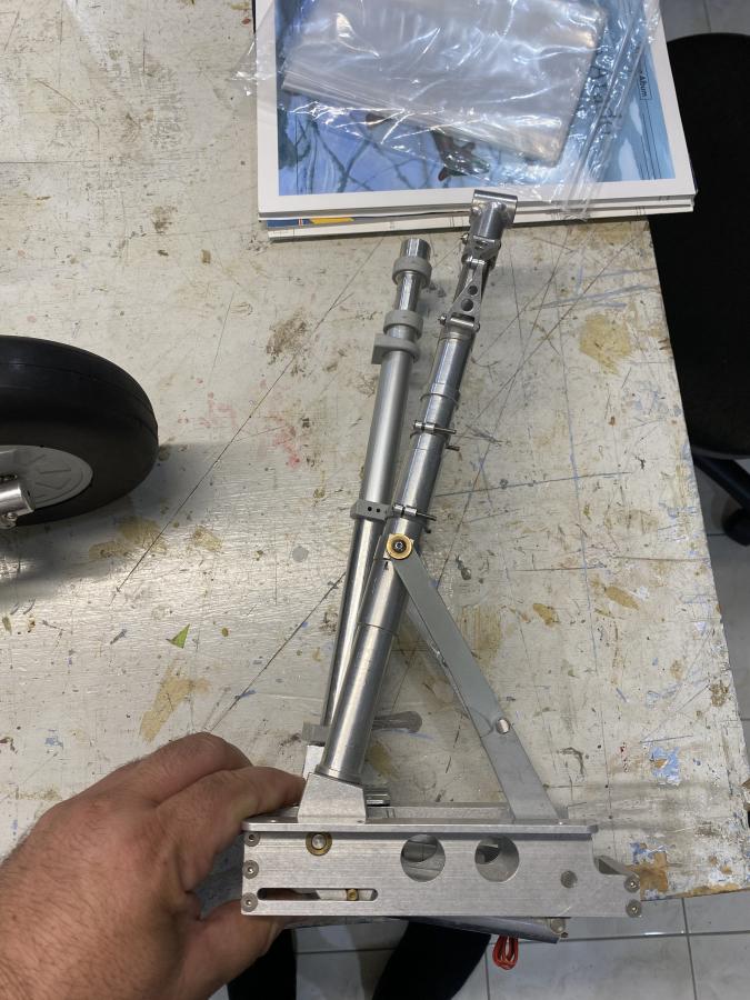

                                I then turned my attention to the new electric retracts... they seem to work nicely enough, will be good to see them in action and if they prove to be reliable. One thing I did notice straight away is how wrong all the angles are. I have overlaid the Sierra 1/4 Fw-190 retracts on top of the kit supplied ones. as you can see the model will end up with a very splayed out look about it. they are also a good 30mm shorter than the sierras ( which are also a little short for scale) so she might end up looking quite squat on her feet. I'll keep looking in to this and how we might be able to address and still use the stock gear.. again these would have been custom designed and maufactured for this model.. why didn't they just do a little more work and get them right. It's a lot harder to fix the issues now rather than at the design faze. I'm tossing and turning about whether I go and make the sierras fit in.

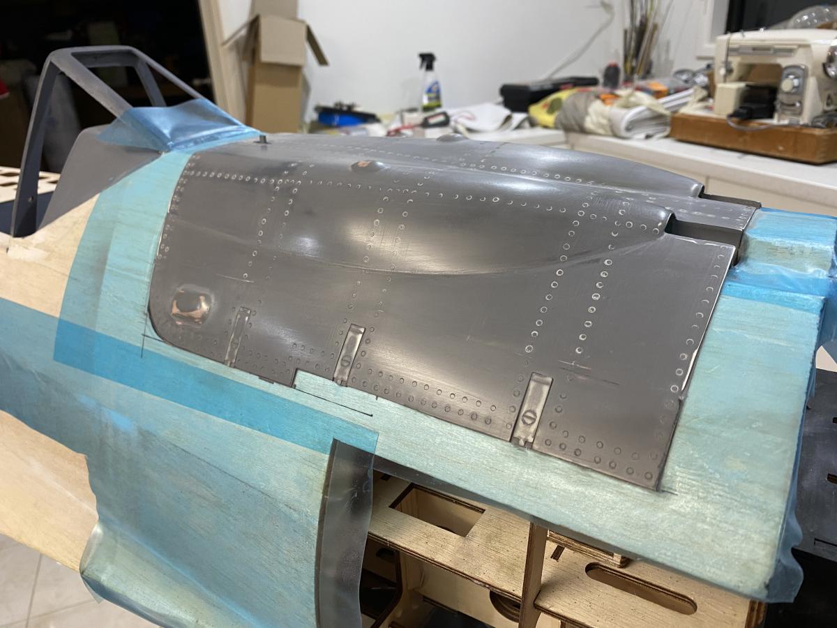

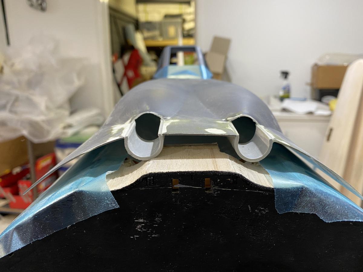

                                The other big bug bear with this kit for me is the gun hood. It's way to short and missing a lot of detail out of the box.
                                So I tacked the gunhood in place and began to add extensions to its sides, and then added the missing details like lumps, 3D printed latches and rivets. The plan is to take a mold off this and then make more durable fiberglass version.

                                          My friend has just flown his Fw with the DLE-130. It has plenty! of power. I would think that the MOKI 250 would be too much? it seems like even the Sist Fw-190 which are 5-7kg more flying weight than this model is over powered with the 250.
                                          Distance from the front of the firewall to the front of the cowl is about 255mm. I would need the distance from the prop hub to the diameter of 305 on the engine to check for clearance for you.
