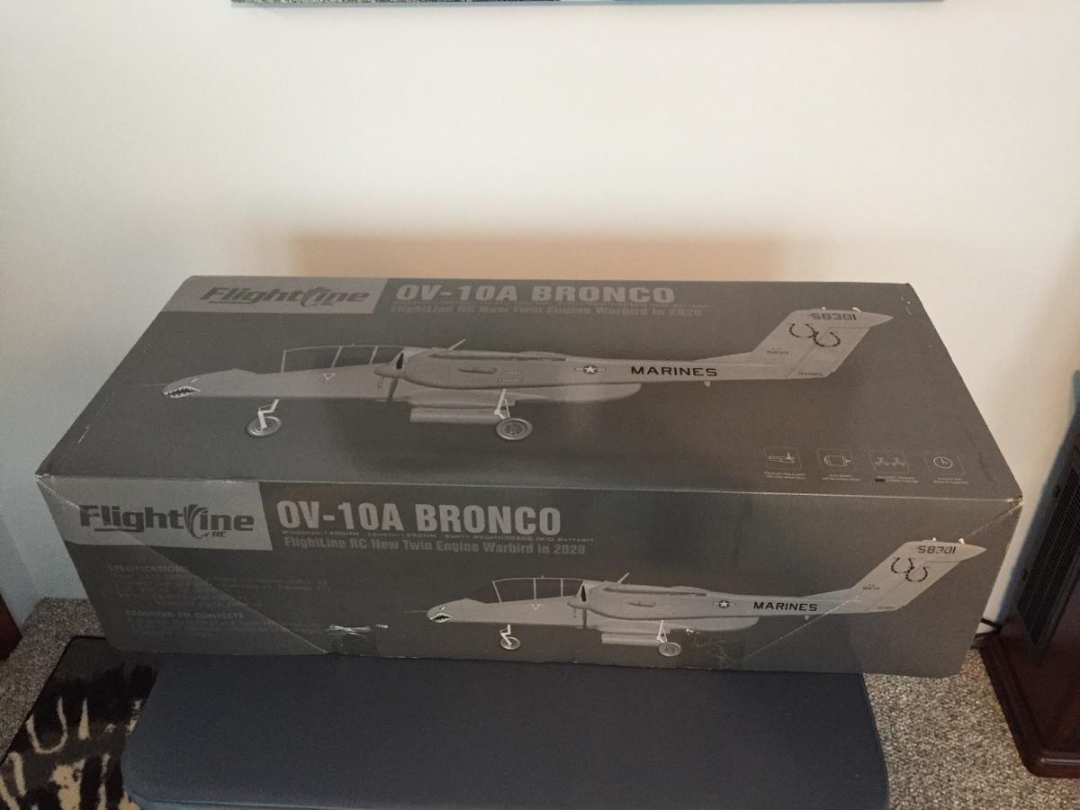

      Here is the first look after opening the shipping box. It is simply labeled OV-10A Bronco. Because this is the first and only foam Bronco out on the market, Alpha did not feel the need to identify it as the 1400mm(55”) Bronco.

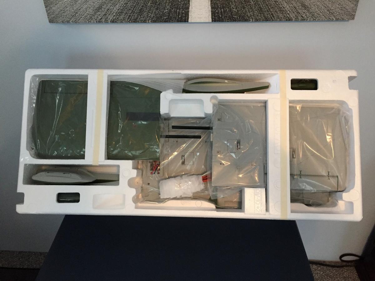

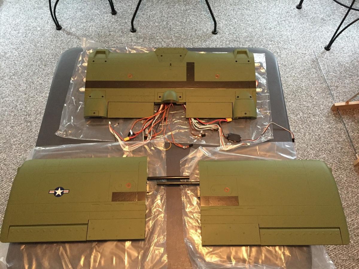

      The foam packaging is done in a upper & lower tray. The upper section contains the 3 piece main wing. As is the case with all Flight Line ARF’s, the main wing wiring is routed appropriately with a UBEC in place and XT60 connectors which appears to be the forthcoming standard on Motions Admiral 4S and less LiPo batteries.
      ​ Click image for larger version  Name:	IMG_1306.JPG Views:	1 Size:	103.1 KB ID:	248057Click image for larger version  Name:	IMG_1307.JPG Views:	1 Size:	196.9 KB ID:	248058 ​​

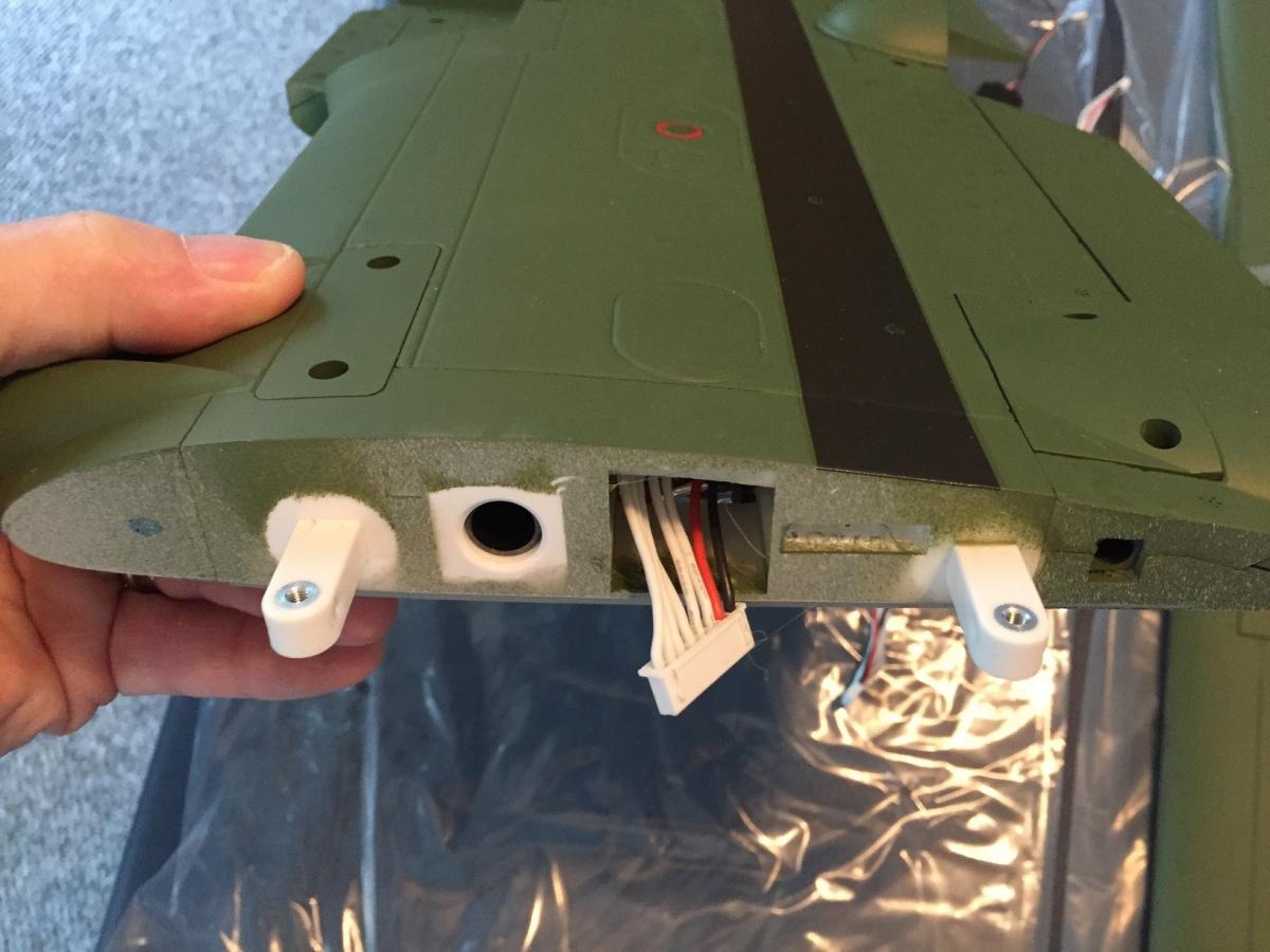

      Here’s the port outboard wing showing the male CF support tube, the quick disconnect circuit and the two female couplers.
      Click image for larger version  Name:	IMG_1308.JPG Views:	1 Size:	117.0 KB ID:	248059 ​

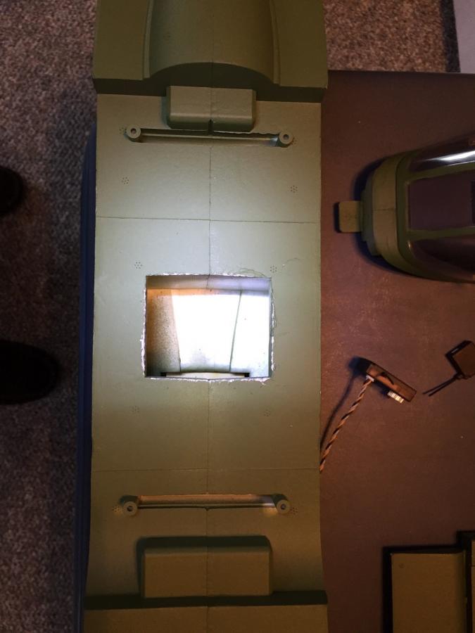

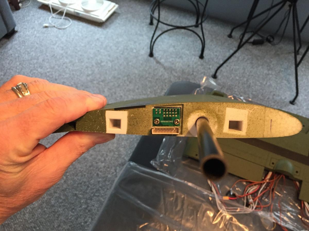

      Port side of the center main wing with the 2 male couplers, female CF support tube and the 8 pin male electrical connector.
      Click image for larger version  Name:	IMG_1309.JPG Views:	1 Size:	102.0 KB ID:	248060 ​

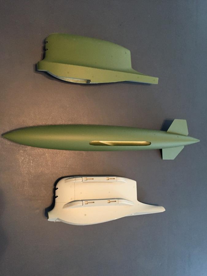

      Last bits from the top tray of packaging are the centerline drop tank and the port/starboard sponsons.
      Click image for larger version  Name:	IMG_1310.JPG Views:	1 Size:	45.3 KB ID:	248061 ​

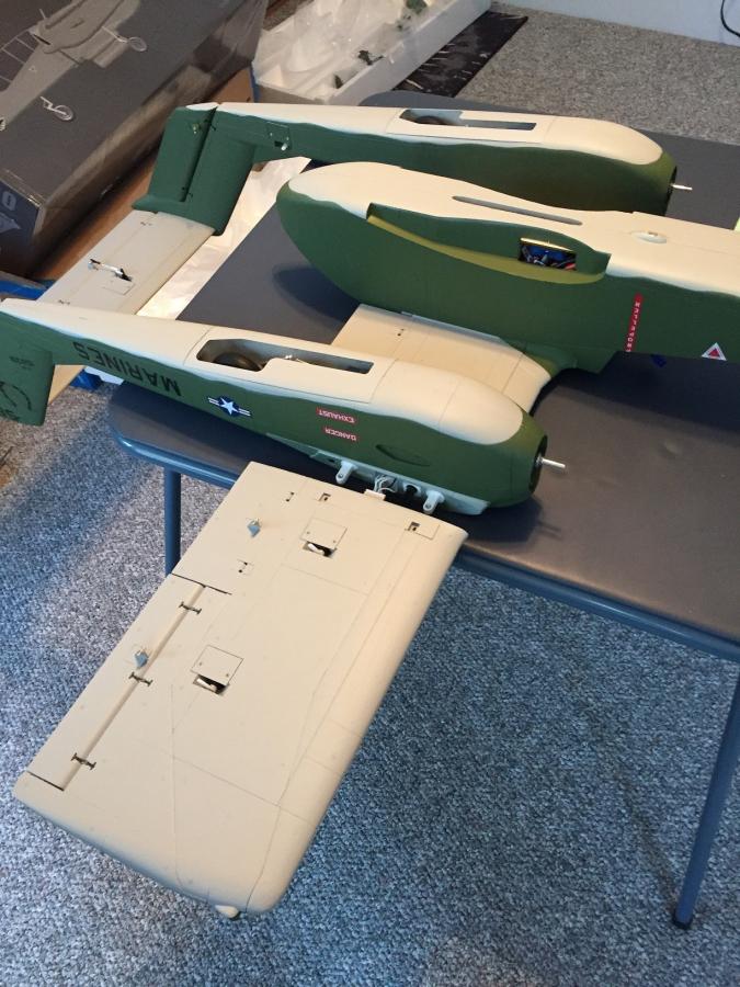

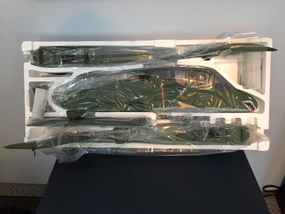

      The lower tray packaging contains the fuselage, two engine booms, horizontal stab, props/spinners, four 7 tube rocket launchers(Hydra 70 M158, “Zuni’s”), glue in goodies like antenna’s and guns for the sponsons and the hardware bag.
      Click image for larger version  Name:	IMG_1311.JPG Views:	1 Size:	100.0 KB ID:	248062 ​

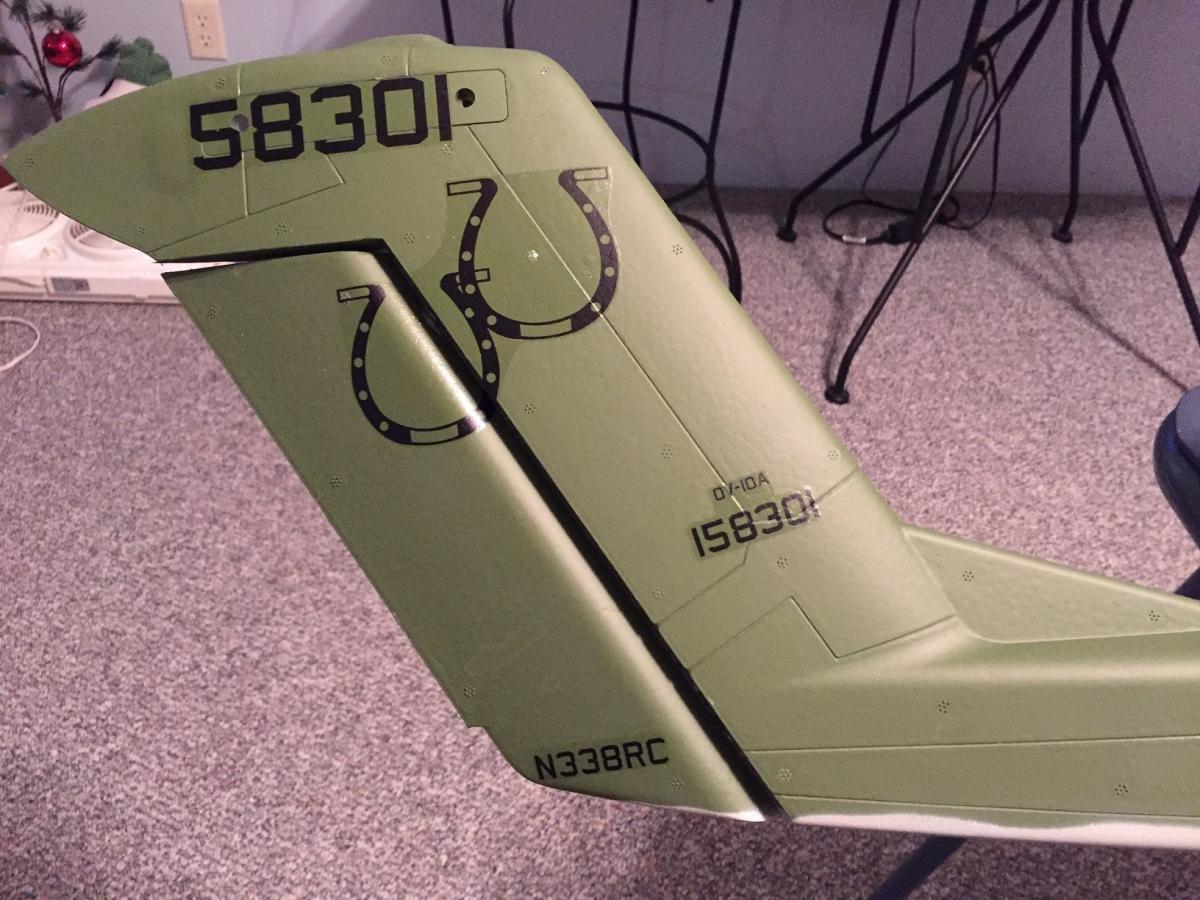

      This is the view of the pre-applied decals on the vert stab.
      I fired this pic off to Alpha to
      alert him that the application was inconsistent between port and starboard lettering whereas the bottom lettering details were not level.
      Since this was
      number two (James got #1) pre-prod run off the line hopefully this can be avoided
      down the full run line. Soaking with a damp cloth didn’t allowed for a reposition of the water slide decal which are all applied at the factory.

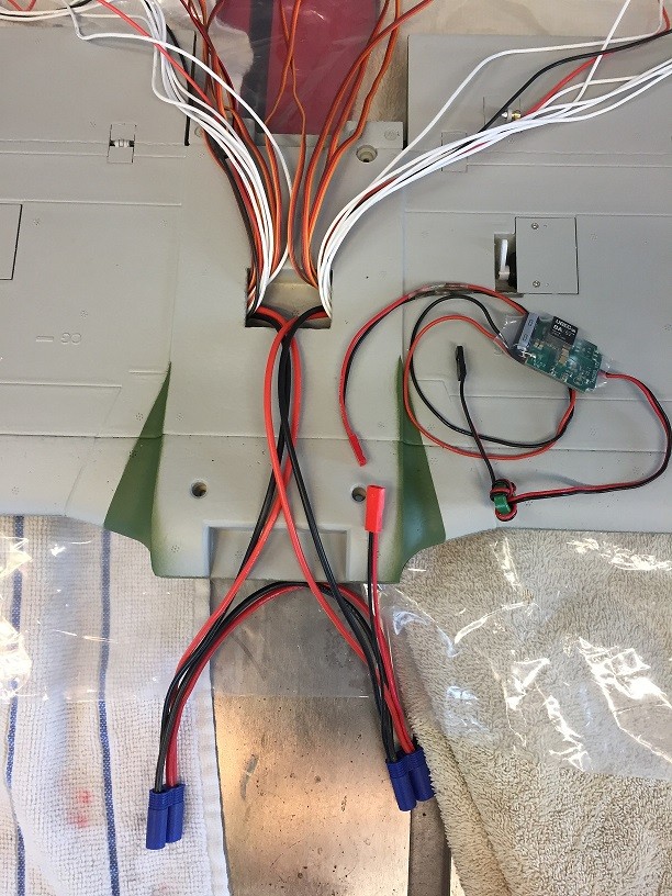

      Since my fleet battery structure is wired around the EC5 connector I need to remove he XT60 connector and replace with EC5’s in a parallel configuration.
      I didn’t want to use an XT60/EC5 adapter right after my EC5 serial adapter because I’m using two 2S 5000 in series.
      Because I am using 2 serial pairs in parallel I will
      have a total of 10000mAh for both motors.
      I always wire my twin setups in parallel so to avoid a catastrophic engine loss on a twin due to losing a battery dedicated to a single motor.
      Since I was soldering, also
      added a JST connector to the UBEC for easy replacement if/when needed.
      I went with a 8A UBEC, the stock one is a 5A and is wired off the starboard power leads.
      Click image for larger version  Name:	IMG_1313.JPG Views:	1 Size:	174.8 KB ID:	248064

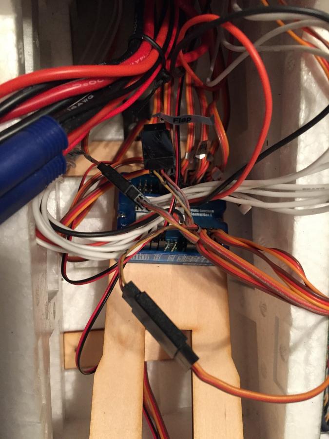

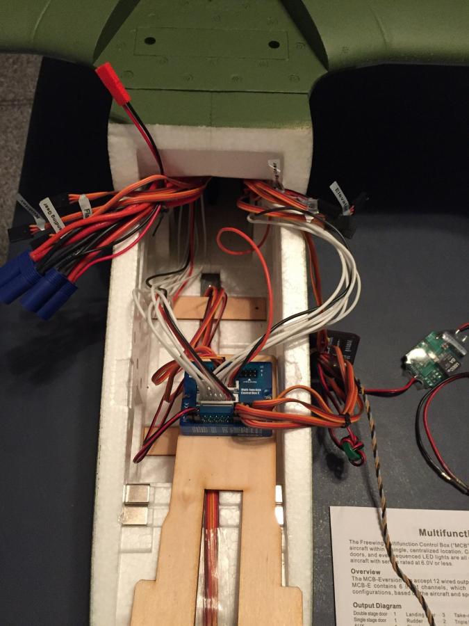

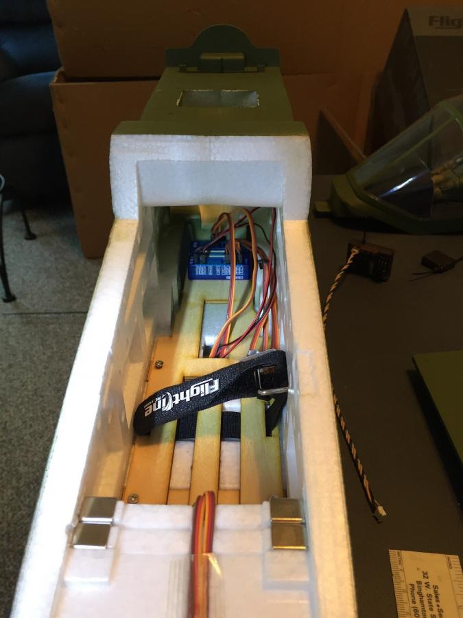

      Here’s the battery tray with the MCB-E control board. Trying to connect all those wires way back in there was going to be very problematic for someone like me with hands the size of a catchers mitt so I will be removing the four screws that hold the tray and pull it out.
      Click image for larger version  Name:	IMG_1315.JPG Views:	1 Size:	57.0 KB ID:	248066

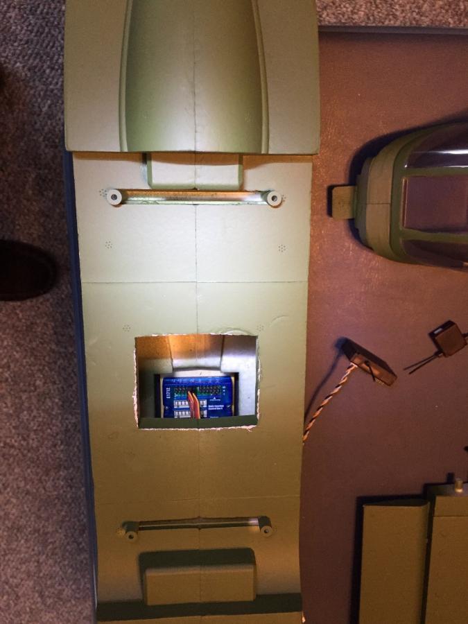

      ​Here’s a view of the MCB-E box down in the fuselage from the access where the wing wires are fed down in.
      Click image for larger version  Name:	IMG_1316.JPG Views:	1 Size:	61.3 KB ID:	248067 ​

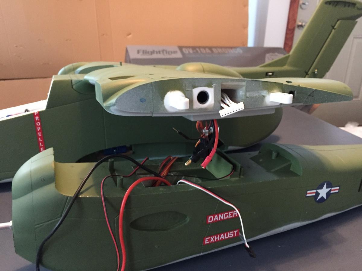

      The battery tray removed and pulled forward so that the wires from the wing that are inserted down into the fuselage can be connected easily.
      Click image for larger version  Name:	IMG_1322.JPG Views:	1 Size:	73.4 KB ID:	248069 ​

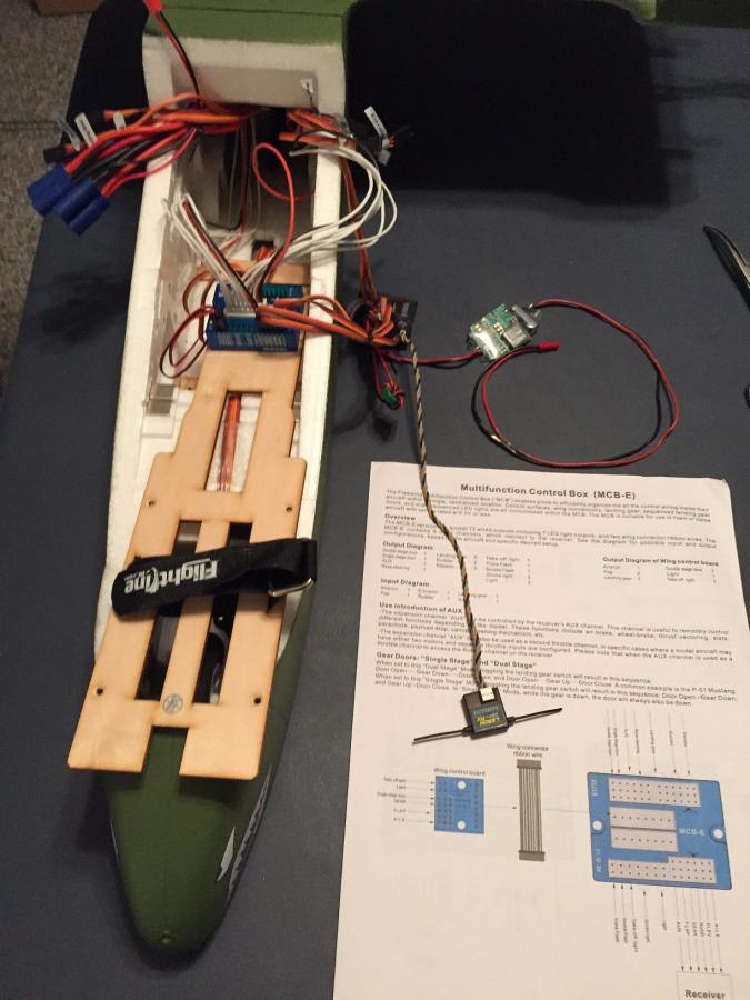

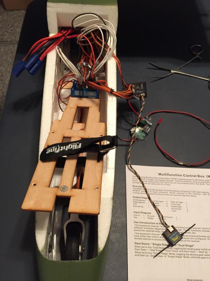

      This is the 4 page manual insert(one side English/other side Chinese) that shows the layout connections for the MCB-E and the MCB-D control boxes.
      The MCB-E is what is in the Bronco. Nice and handy during wiring.
      Click image for larger version  Name:	IMG_1323.JPG Views:	1 Size:	68.8 KB ID:	248070

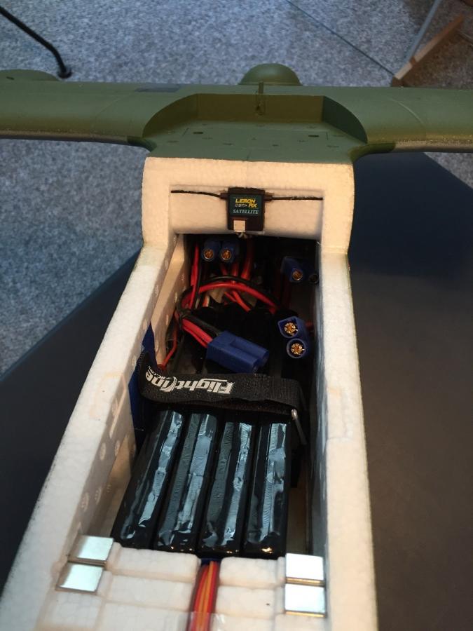

        #43
        Here is all the wires tucked in and secured. Those are my two sets of serialized 2S 5000mAh Admirals.
        The satellite to the Rx sits in a recess that I carved in the overhead bulkhead so that it didn’t interfere with the aft bulkhead of the canopy hatch.

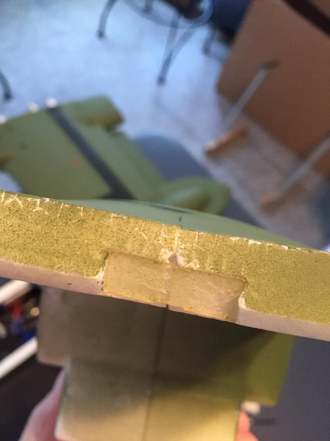

        Examining where the hatch securing pin engages.
        In the second pic the lower square area in the center has as plastic strike plate for the locking pin to run into the hole.
        Click image for larger version  Name:	IMG_1327.JPG Views:	30 Size:	63.9 KB ID:	248077Click image for larger version  Name:	IMG_1328.JPG Views:	30 Size:	51.9 KB ID:	248078 ​

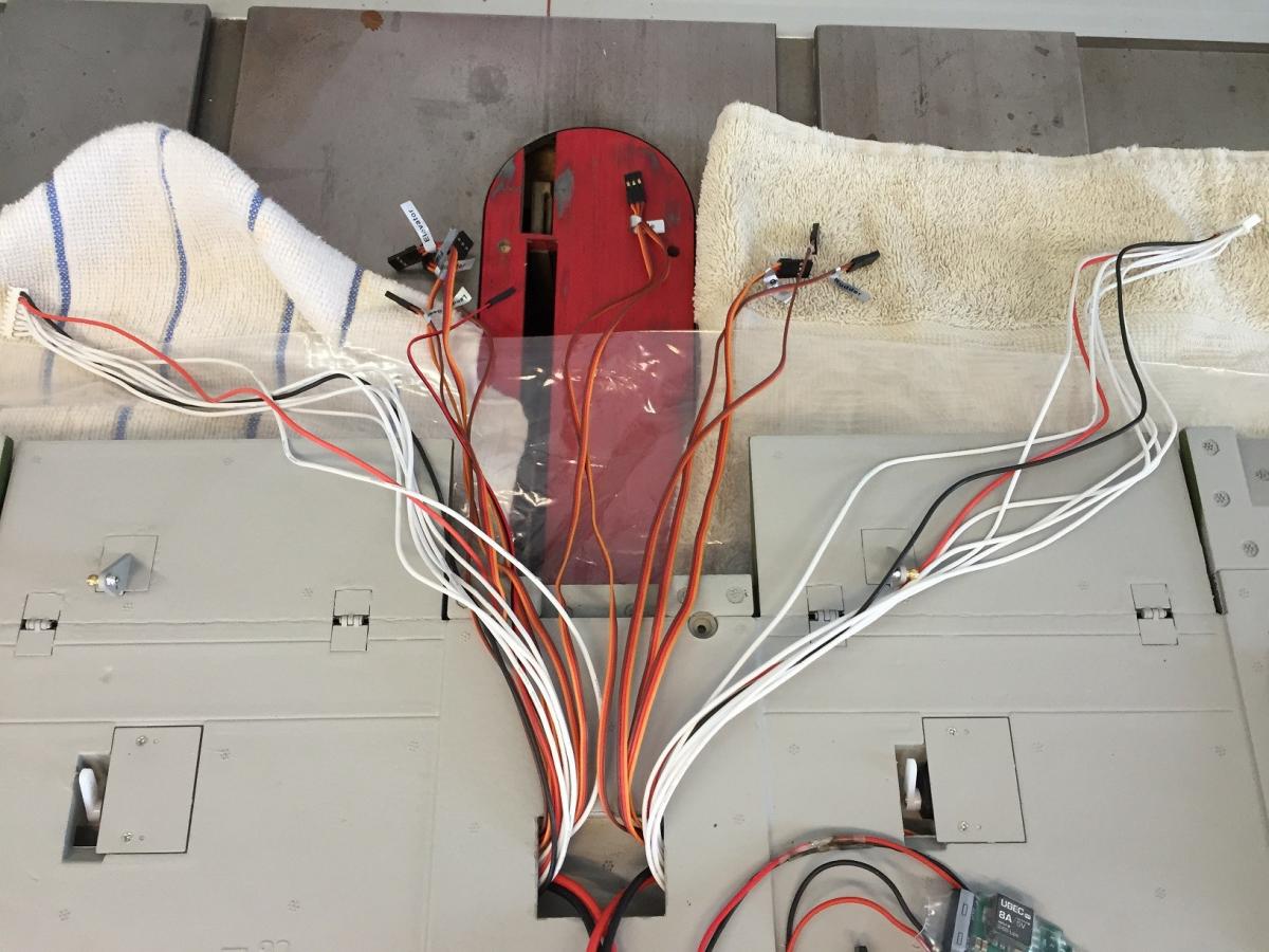

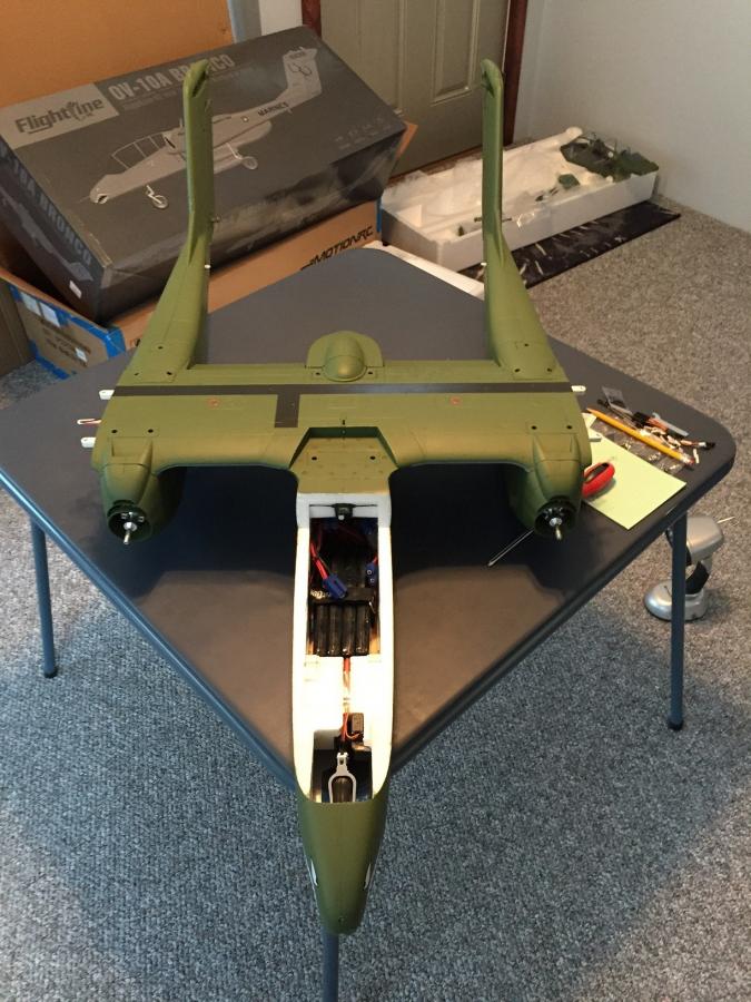

        To install the wing wiring into the engine booms was best accomplished by leaving the gear retracted and set the fuselage and booms on a padded surface
        (in my case a vinyl padded card table) then make the appropriate connections and then tuck all into the boom.
        2nd pic is of the booms that now have the screws(5 per boom) installed.
        Click image for larger version  Name:	IMG_1329.JPG Views:	29 Size:	91.0 KB ID:	248079Click image for larger version  Name:	IMG_1330.JPG Views:	29 Size:	99.0 KB ID:	248080 ​

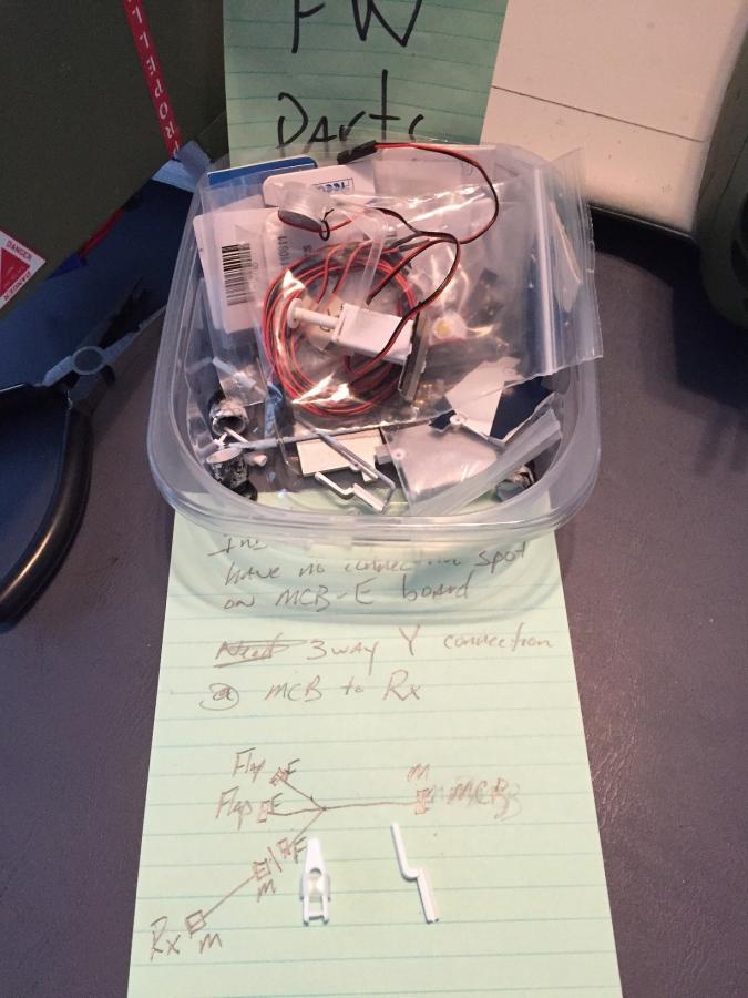

        I did come across where I was missing one of each, a clevis and a pushrod buckle.
        Fortunately I happened to have a little FW parts box with some in it.

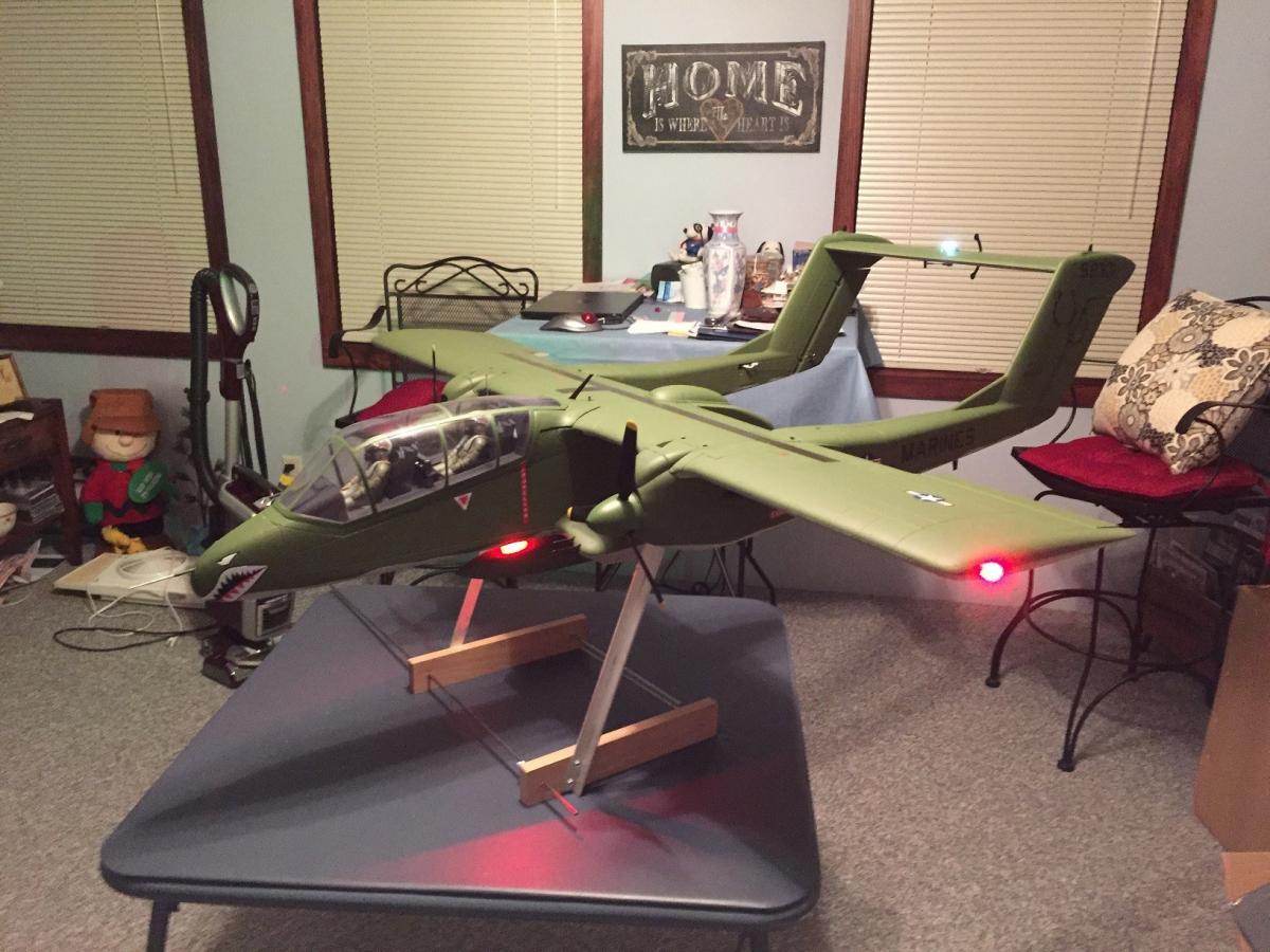

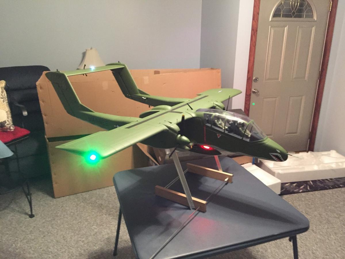

        ​Here’s pics of retracted gear CG’d per the manual spec.
        By this time James had
        already test flown his and he said the CG was spot on and the two 4S 4000 he used were all the way forward in tray area.
        Some great lighting going on here. Red strobe on bottom of fuselage and white strobe on top of the horizontal stab.
        Click image for larger version  Name:	IMG_1333.JPG Views:	30 Size:	103.5 KB ID:	248083Click image for larger version  Name:	IMG_1334.JPG Views:	28 Size:	142.9 KB ID:	248084 ​

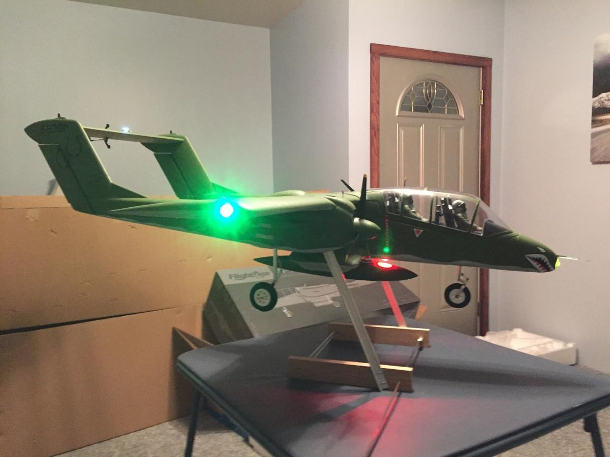

        ​Here’s the CG with slight nose down attitude with gear deployed/extended.
        Click image for larger version  Name:	IMG_1335.JPG Views:	30 Size:	88.6 KB ID:	248085 ​

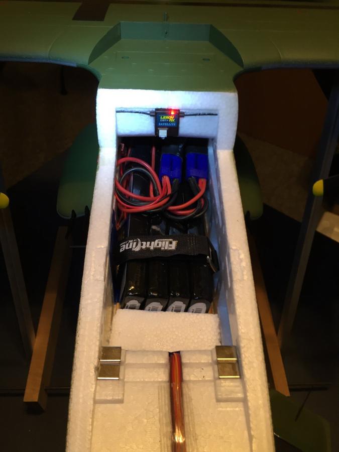

        This is where the 4 2S 5000 ended up in location at 1.5 inches aft of the forward bulkhead of the tray.
        I cut a piece of foam to keep the batteries in the aft location, I don’t like spaces where stuff can slide.
        Click image for larger version  Name:	IMG_1336.JPG Views:	31 Size:	50.2 KB ID:	248086 ​

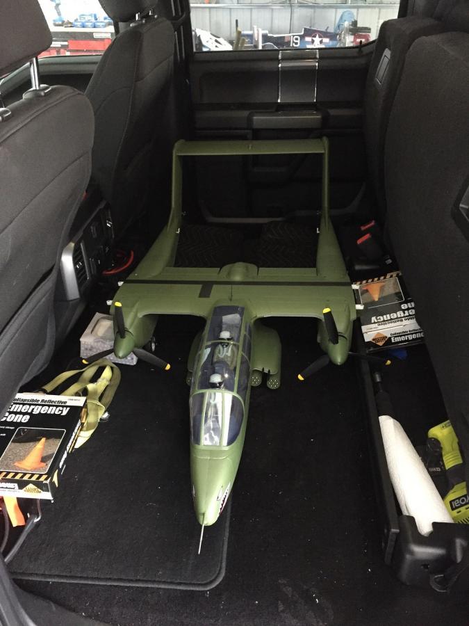

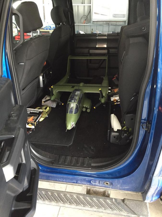

        And now the piece de resistance, with the outer wings panels removed for transport it fit into the crew section of the F-150 with room to spare.
        Any other 55” warbird would have to go in the box or have the wings removed.
        As I said in my intro, I hope that this will become the standard that FL does with all new stuff.
        Maybe a 1600mm F6F Hellcat to start the adventure on, a foam version of the TF giant scale where the wing panels attach outboard of the main gear.
        Click image for larger version  Name:	IMG_1346.JPG Views:	31 Size:	70.4 KB ID:	248087Click image for larger version  Name:	IMG_1347.JPG Views:	29 Size:	80.5 KB ID:	248088 ​
