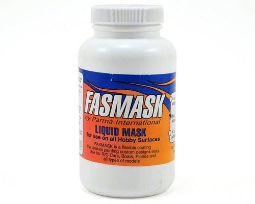

      #222
      Originally posted by Tronn
      Liquid paint mask is an awesome idea! Can you recommend a good brand of liquid paint mask?
      This is what I have used, I think its excellent (but I've never used anything else).
      Its available at hobby shops (ha, remember those) and ebay and other places on line.

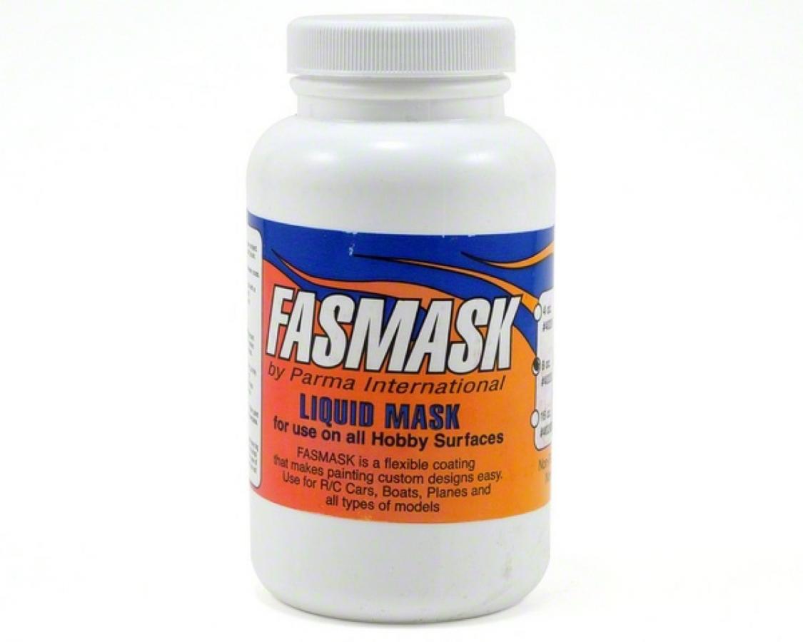

          #224

          Awesome, thank you

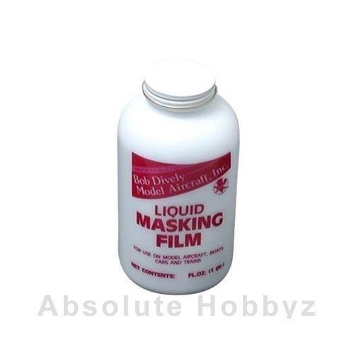

            #225
            Originally posted by MikeT
            I've always used Bob Dively's stuff. I used to to able to get it from Horizon Hobby's but they discontinued it. I've seen it online from other vendors.
            Mike
            Thank you
