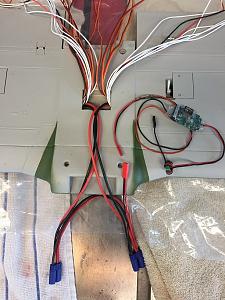

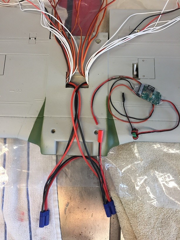

                                  • Last page back has Charlie's parallel ESC wiring which will be as "foolproof" as you can get. I had a twin 90mm A10,(WowPlanes), that i did the same thing on but after flying thr FW A10 and seeing other twin planes with independent wired ESC's Im still flying split ESC's on the FW A10 but will use the parallel wiring on both my OV10 Bronco's
                                    Ref Charlies pic here.

                                    • Originally posted by Styk View Post
                                      Hi Guys Needing a bit of help here. Can anyone please post a diagram of the wiring setup for using on the Bronco to eliminate the risk of losing a motor in flight. My technical experience is very limited and apologise in advance. If anyone can help me understand what I need to do with maybe a foolproof diagram that I can follow I would appreciate it a lot Thanks
                                      Hello, I’m Steve and I have had a few of the Motion RC multi-engine A/C. The P-38 engines develop enough power, far enough off center that the rudders cannot counter it. To minimize a single engine problem from one battery not providing enough power regardless of the reason (mis-charged, not well balanced...). This problem can be minimized by creating a cross over harness. With this harness you are looking to keep the battery voltage the same between the two engines. To do this you need to wire a harness that connects the two batters to the two motors. You need 2 male and two female plugs. You will need to wire both positive wires and both negative wires from the batteries and connect them to both speed controllers. This will keep the available voltage constant between the motors.
                                      Here is a pic of the one I made. Notice that the positive from #1 battery on one side is connector to the positive for the connector to the #2 speed control for the other. The same is true for the negative on the #2 battery is connected to the #1 speed control. You can loose one voltage in one battery resulting in lower voltage to both engines evenly. I tested this and it works great.
                                      FYI, this is not needed for the A-10 because of the location of the engines being so close to the centerline of the A/C. I actually lost power to one engine on the A-10 and noticed only a reduction in performance. I came and landed without issue and noticed that one engine was no longer turning. The A-10 is awesome.
                                      I hope this helps.

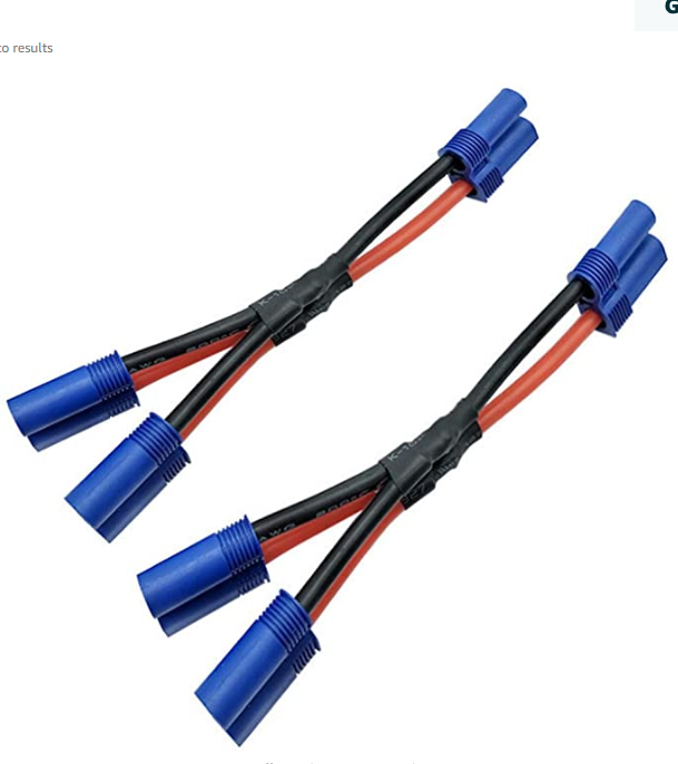

                                        • If you solder like me you might consider Amazon
                                          https://www.amazon.com/Serial-Parall...9729231&sr=8-5
