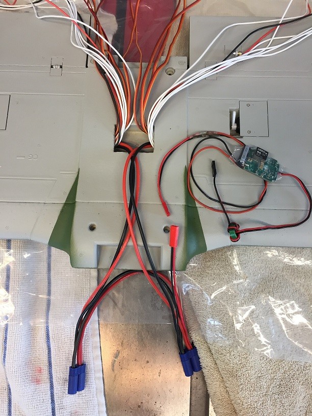

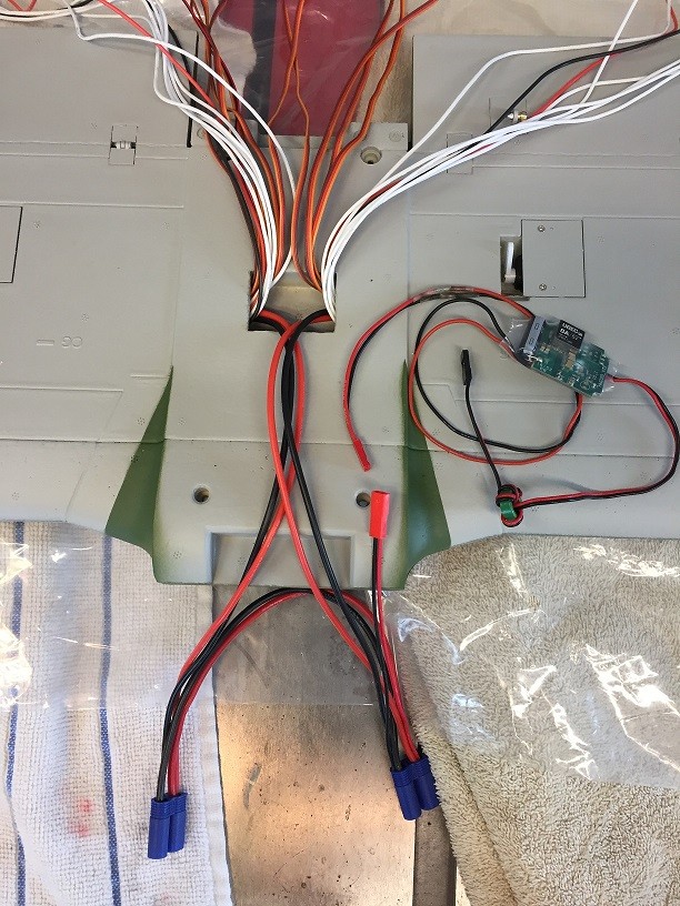

              Originally posted by OV10
              sam51401 Hello Sam, I am gonna throw the above underlined sentence out of the discussion because it is not accurate.
              (1)So on your statement of two 4000mAh (4Ah) batteries for each motor, that means you would have a total of 4 packs on this twin which physically is not possible.
              I believe you meant to say "Two batteries of 4000mAh each for both motors" and then the remainder of the sentence would be true.
              What James maidened with and flew subsequent flights with was one 4000mAh pack per motor for a total of two 4000mAh packs.
              The stock wiring has each motor powered by a dedicated pack which in this case means the max capacity per motor avail is 4000mAh or 4Ah.
              For your A-10 comparison, you indicated having your two batteries wired in parallel (lets again say 4000mAh each) which now puts a potential of 8000mAh total capacity available for both motors.
              Because both motors are sharing this capacity you are essentially dividing the total capacity in half to each motor to 4000mAh.
              Now for those that are unfamiliar with the science and ask why go through that wiring effort of parallel to still have the same mAh capacity per motor which equates to same flight time.
              The primary reason and the reason I have done it for years is for eliminating the one engine flame out on a twin which is a recipe for catastrophe.
              With dedicated batteries to each motor, if one battery collapses before the other does the effected power train also collapses and then the proverbial graveyard spiral is setup due to the uneven thrust factors. :astonished:
              When wired in parallel and sharing the same total capacity, if one battery collapses quicker the parallel systems capacity is still providing for but in a reduced capacity
              until such a time that the voltages which are also equal due to the parallel configuration collapse equally and the BEC's LVC shut down both motors at the same time.
              It is much better to dead stick than trying to figure out what just happen and counter the quick corkscrew your bird just presented you with.
              I have also found that doing paired battery sets for parallel configurations is not necessary if normal balance charging practices are followed.
              I appreciate you question and hopefully I answered it without too much rambling
              Best regards,
              So if I make 2 XT-60 connectors one to pair the my 2 4s bats and one to pair the esc' s and connect those together, will that work? This is my first twin and I want to avoid loss of an engine if I can prevent it. Thanks for any advise Warbird.
                #287
                boomer108
                Hello Boomer, yes but if you're gonna be making parallel adapters I don't quite understand why you wouldn't just convert the ESC leads into a parallel configuration.
                What you mentioned is two separate adapters which means more connection points of issue as well as additional wiring bulk to stow away.
                I seriously would recommend going the path I did...……….use the pic(from my build posting) as a reference except swap the EC5's with XT60.
                Just plug the 2 batteries in and everything is in parallel.

                  #288
                  +1 on Charlie's wiring as the simplest to do. That will also be the same for my Profly Bronco.

                    I knew I was asking the right person. Thanks Charlie that's exactly what I'll do.

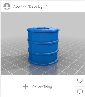

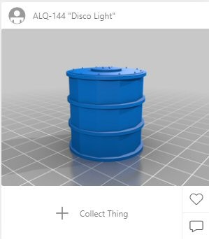

                      Getting a little ahead but I thought I'd prefab what I can before the OV-10 gets here.
                      This a my design for the ALQ-144 IR Jammer mounted on the later versions of the USMC Broncos. I'm not sure if the USAF birds had them. This is only the transmitter "Disco light" portion. There is a sizeable hump on top of the fuselage spine that this portion is attached to. I have yet to design that. That will be a little more challenging for me to design due to my limited skills. Dirty Dee? A little help? ;)
                      Here's the link on Thingiverse.com: Click image for larger version

                      https://www.thingiverse.com/thing:4342935

                        Charlie, are you just adding a + red jumper, 10g, and a - black jumper 10g, between the two separate connectors, ie JC5, from each respective motor, ie ESC.

                              Essentially yes :ok_hand: The ESC wires are only 14ga...…..not 10ga

                                Thanks Charlie, or OV10. Which do you prefer?
                                    Either way is good with me :ok_hand: (as well as Warbird )
