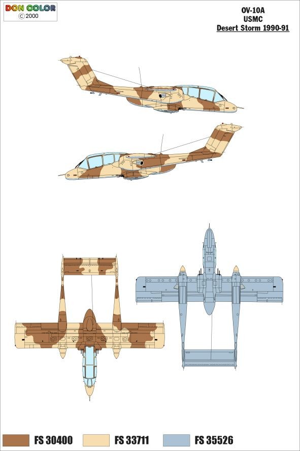

                          During Desert Shield/Storm, the USMC aircraft arrived in country in the then standard USMC Land Camouflage scheme of Green/Gray/Black. Once in theater, individual squadrons took it upon themselves to repaint their aircraft to a more appropriate camouflage for the desert environment. That is why, you’ll see a plethora of Marine aircraft camouflage schemes in country. Here is an example of a pattern for an OV-10. I don’t know what squadron it was. I do know that VMO-2 had OV-10D’s by the Desert Storm timeframe, but I’m not sure if they had a A’s in the squadron as well at the time.

                            Im working off the two model kits, Revell 1/72 A and Academy 1/72 D for ref and as Revell calls for a very light blue gray(mixed with no FS call out) and Academy is gray no ref to the blue was noted. I like the blue, its different and will be unique but didn't look in the right places to find a FS code. You found it so im good to pick up at my LHS. No on to doing the vinyl and maybe decals.
                            Not sure but was there ever a supplemental issued for desert camo that might have listed the "authorized" color codes for the nomenclature?

                              There was no directive that I am aware of in theater. I’ve heard that some squadrons even mixed their own colors with what they had available and there is no associated FS number.
                              I believe there is a Detail & Scale on the colors of Desert Shield/Storm that might help.

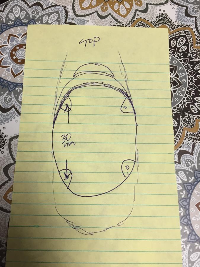

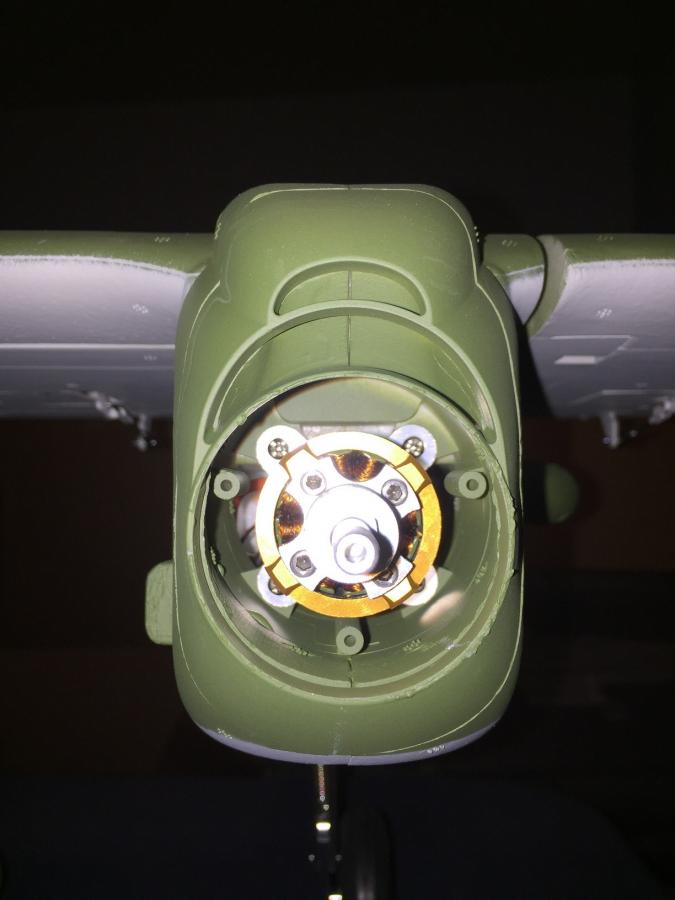

                                sam51401 I know it's not tomorrow but I hate having someone wait on me for info so here it is.:stuck_out_tongue_wi
                                Here's a direct look into the cowl and as you can see there is no solid firewall
                                but 4 tabs that extrude from the sidewall that the motor X mount fastens to.
                                *click to enlarge pics*
                                Here's a rough sketch to show the xmount / firewall hole spacing
                                And the dimension from the back of spinner to the back of Xmount is 56mm
